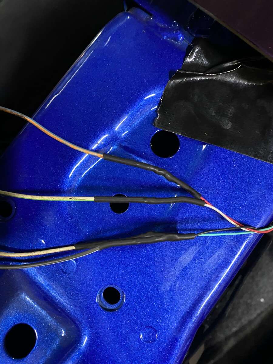

Had the trim wrapped bu my trusting wrapping friends at signs central who will be featured shortly here! they also bordered the squares for added feature. As I already have an interior lighting system and we only have two footwells I decided this would be a better use for the other two light units- so I cut and soldered two lots of extensions done in so I could reach the wires up to the rear strut bar, after tucking away the wires and trying to not stress the joints “being the heavy handed thug I am” I tried to press the body clips into position and cracked the one side! But ta da I’m happy with the overall product

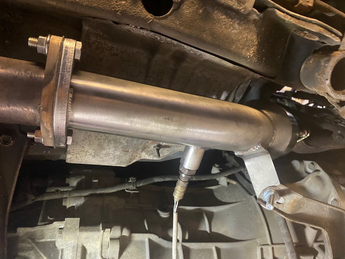

So… start to the big stuff, purchased these cobra sports cats off @Fluke ages ago, fitted them the day they arrived- 4 of the easy access nuts easily came off and of course the two rear facing nuts were hard as hell to get off, had to use a couple of long as hell extensions and a lot of brute force but they went eventually! Tie that up with some new flame ring gaskets and bolts n it was good to go! The lambdas came out good as gold bit of copper slip on the threads and cleaned the tips. Happy days!
the sound is just phenomenal combined with the single exit! almost deafening at 4k haha

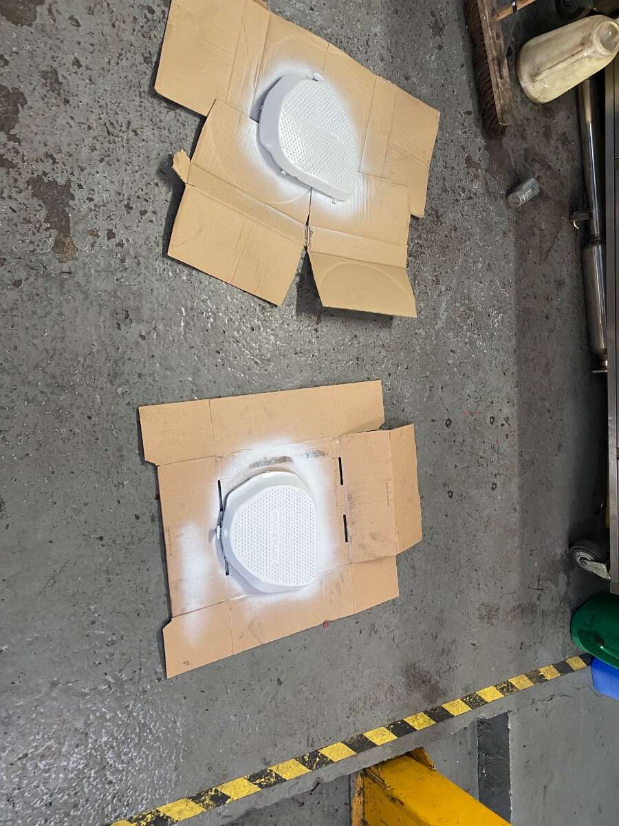

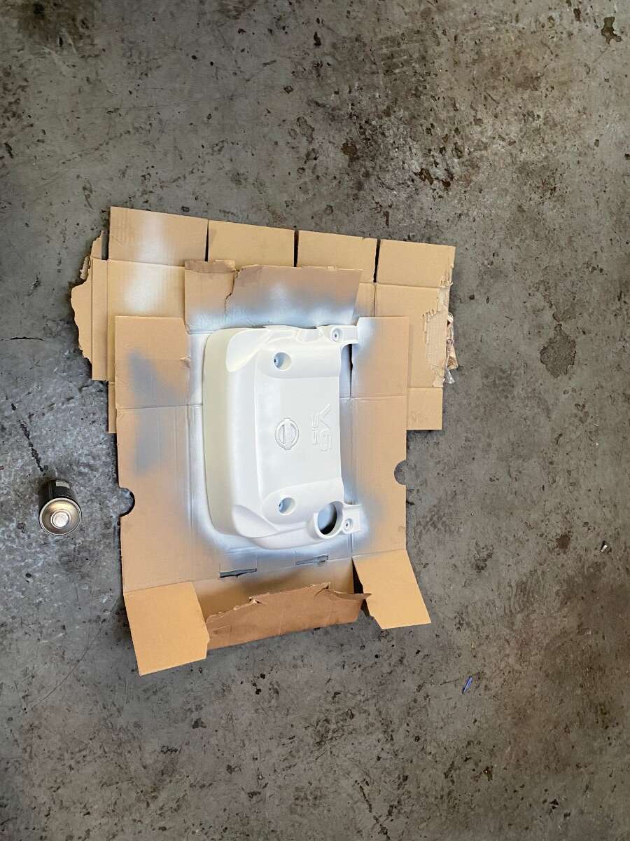

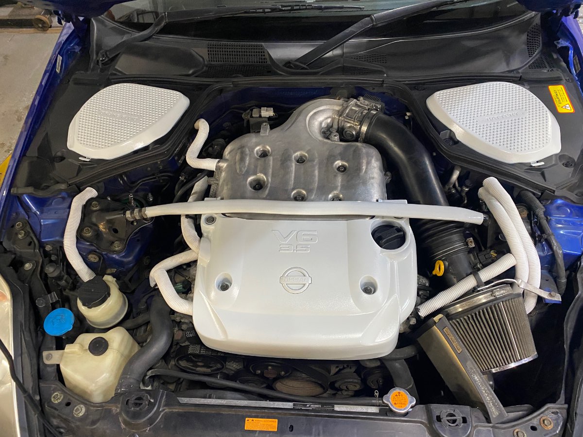

Continuing on- decided it was about time I atleast did something to address my dirty boring engine bay- with some ideas borrowed from Sam, I felt that I wanted to go a different route as not seen many people go white in the engine bay- volvo ice white to be precise- aswell some electrical convoluted tubing to help set off some of wiring- this was not fun to fit and also I’ll have to replace soon as it’s dirty already 😂😂

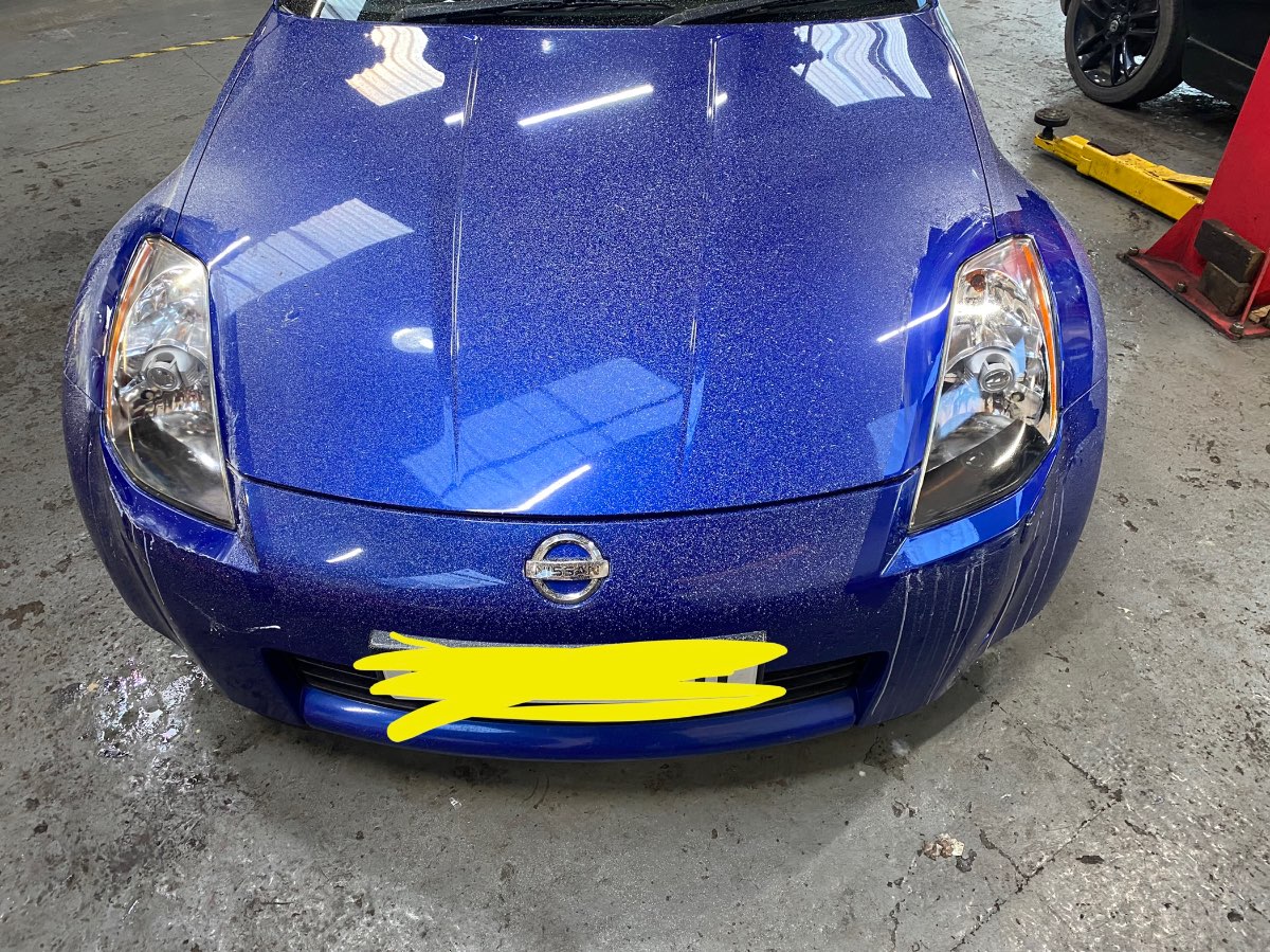

I went for Purple/black gloss, but this was only the start/base colours- took them a day or two and the worst part was me putting having to put the bumper back on without damaging it! they even did the wing mirrors-
They managed to do it in time for wheels on Wednesday too! I just didn’t have time to put the spoiler on!

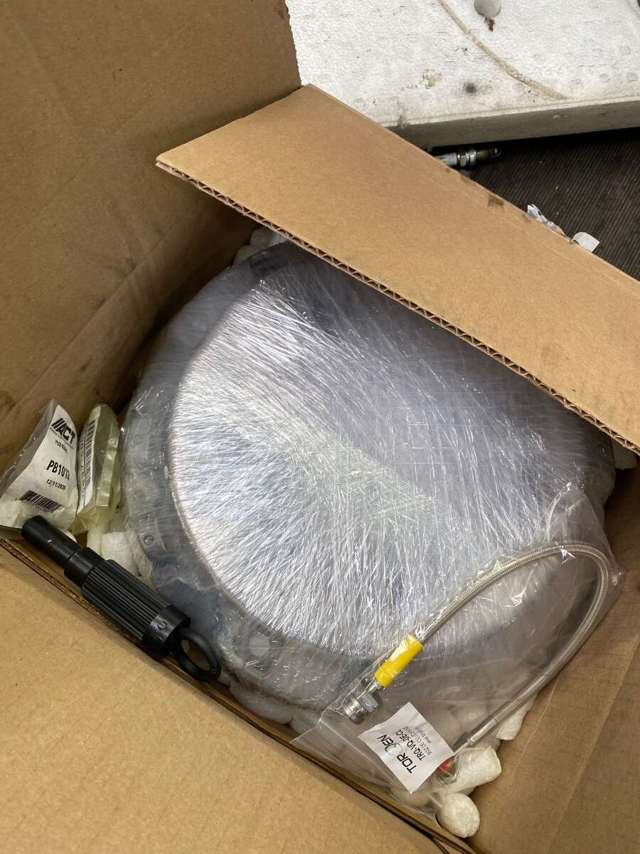

So… over the past few weeks I’ve noticed my clutch being a bit dodgy, over revving a bit and also seeming a bit higher than usual!
so naturally decided it’s probably about time to replace it, would rather just replace it so I don’t have to worry about it disappearing on me- so I got onto @Coz@TORQEN he recommended the JWT Clutch and modular flywheel kit, I had looked around to see what was best but Coz had advised me for what I wanted fastroad aswell as a bit of track action this was the kit for me! nice that they had included a braided clutch line, the previous owner must have already got there first as it was already braided.
I’ve had a clutch slave kit from @Tarmac@TarmacSportz in the draw for a while since I had clutch issues at one point and almost got stuck on top of the multi-storey carpark, so I had that all ready for the day I finally decided to do this. Obviously it’s a big help having a ramp and tools but tbh it was a nice a straightforward job, didn’t need to remove too much and it all came out pretty easy- just an FYI don’t pay all the attention to the horror stories you hear of non starts once doing clutches on these.

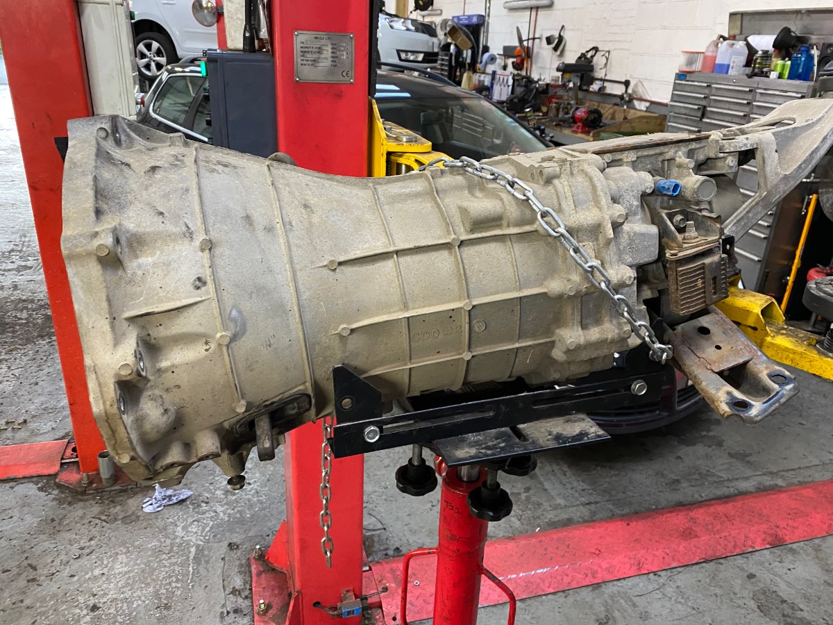

Decided not to remove the cats as it could be done without taking too much out the way, couple of bolts  for the bell housing removed and got the box out, always helpful having a transmission Jack but I have done one in the floor before and it wasn’t fun 😂

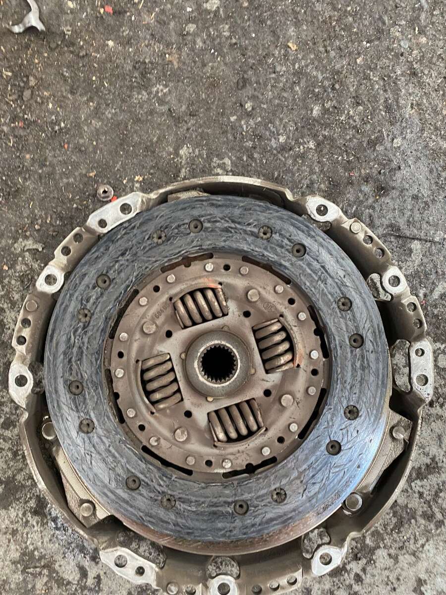

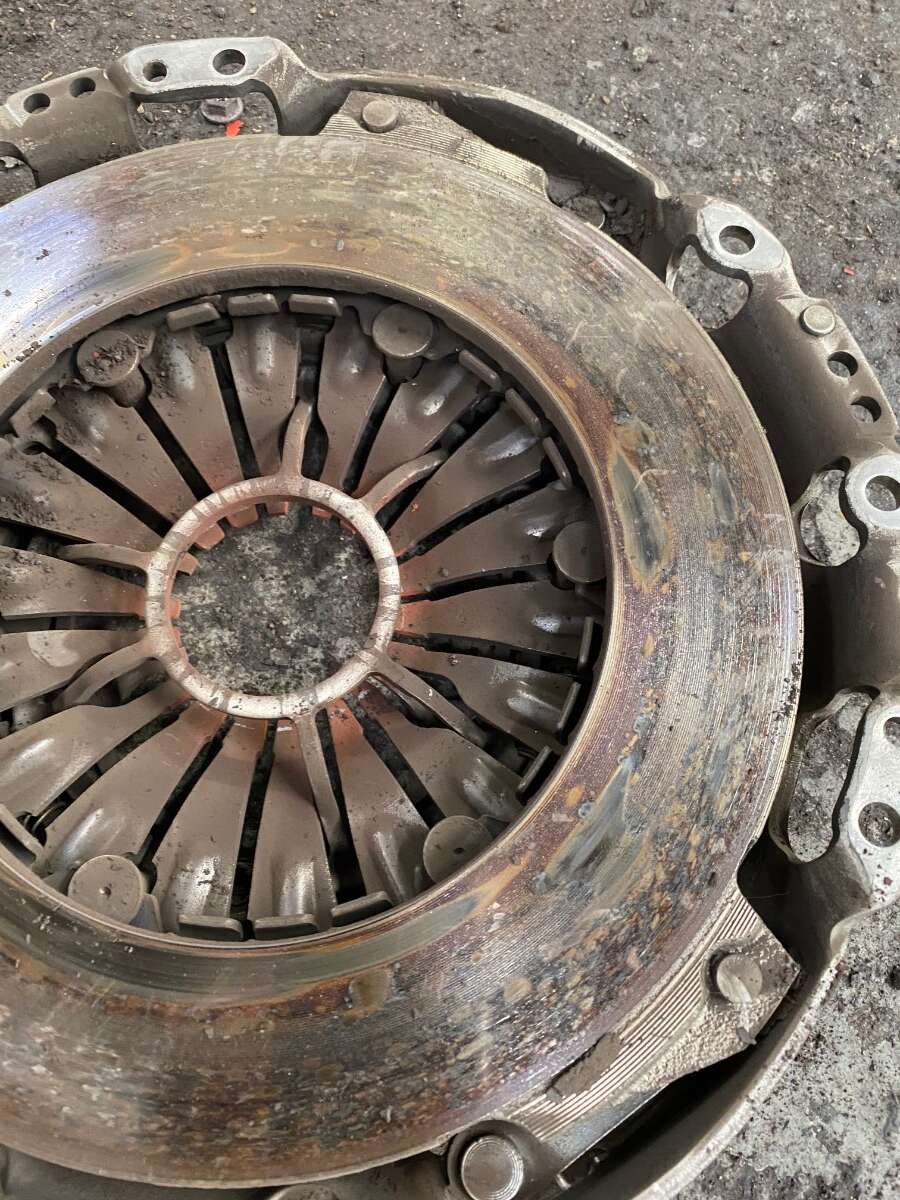

Thank god I had decided to do it when I did, as you can see part of the pressure plate retainer had broken off and the other side had cracked, once removed the friction plate still did have a bit of life left. The surface on the friction plate did look a bit nasty however quite a lot of hairline fractures, heat spots galore, and the flywheel was due for removal anyway as they have such a high failure rate so out with the old and in with the new!

Very nice work pal. Never seen a corroded pressure plate to be fair. The JWT clutches are meant to be mega, nice choice. Any pics of the new flywheel?
Cheers mate, I’m getting on top of it almost there haha! Then I’ll update everything as it gets done I swear 😂
 think it’s just the angle of the camera mate most of that is heats spots/soak aha I don’t give it much abuse so must be previous owner 😂 yes Exactly what I’ve been told too mate and so far so good haha, aside from the Zs clutch engagement point which I have adjusted! yes yes one moment-

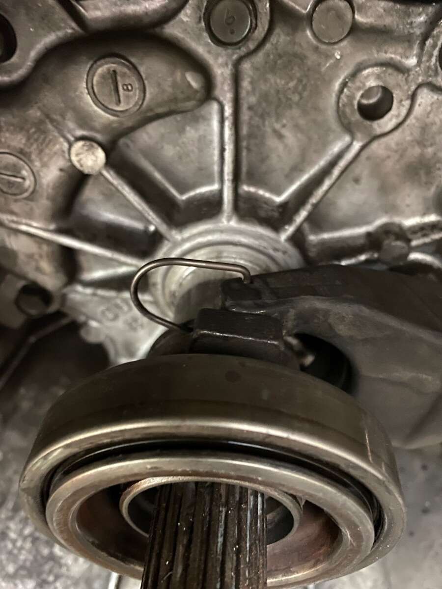

replace the release bearing, I had trouble with mine so I had to persuade it with the press haha!  Always lube the collar/ shaft it runs on inside the box.

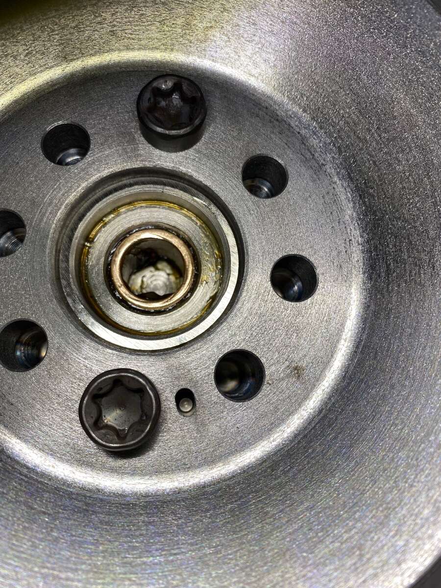

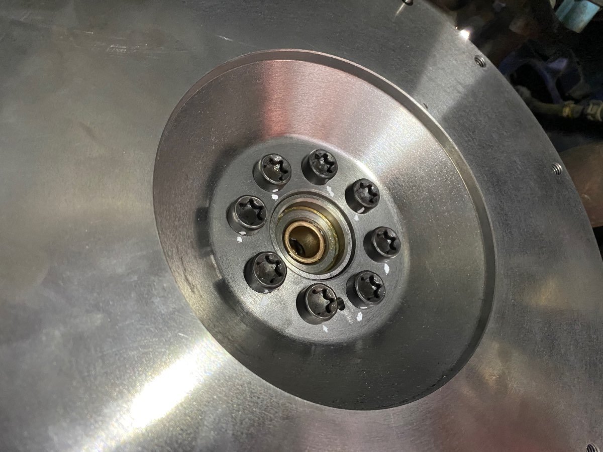

For the pilot bearing, do not lose hope! And don’t just say oh I’ll leave the old one in because if you’ve been given a new one you might aswell just do it!
1000% the best way to do this is to pack the hell out of it with multipurpose grease as much as you can, bare with me- get a sock and extension, believe it was either an 8mm or 10mm whatever that fits perfectly into the inside of the pilot bearing, pack out the inside of the socket with blue roll as much as you can, push it into the inside of the pilot bearing then **** it with a hammer.
obviously  the idea is that the only thing to move in this situation is the grease and the pilot bearing so don’t worry, keep going and once it moves you’ll have it out soon enough! then just clean out some of the grease, but leave some haha
Usually at work get stressed doing boxes on certain stuff as there’s a clock and a customer involved but I didn’t have that here as I really enjoyed the job due to the Japanese have some sort of method not cackhanded things made to be awkward for the sake of it.
Pilot bearing in, new flywheel on and bolts threadlocked and torqued, friction and pressure plate aligned and torqued on- important thing to remember is to clean off all components as some oil residue will be left over from machining.

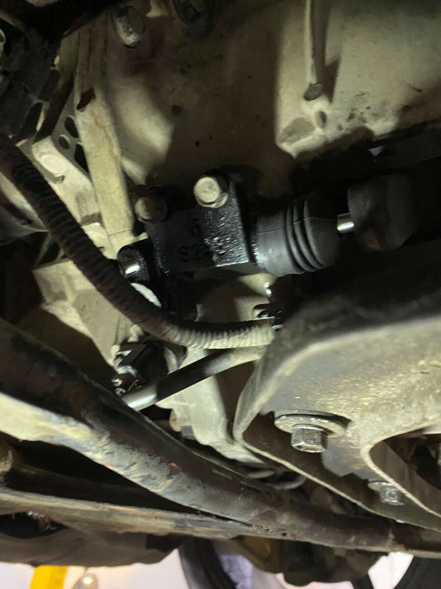

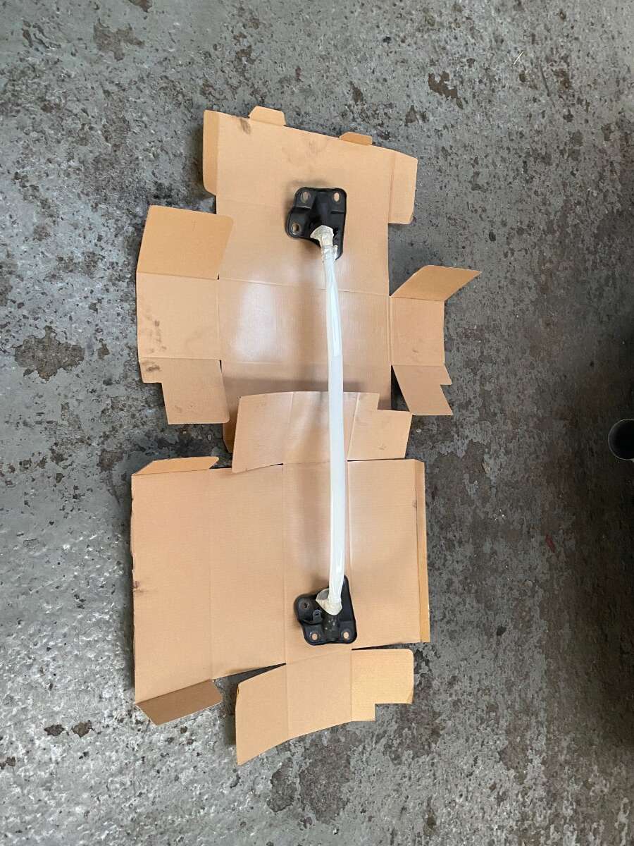

Yes replacing the clutch slave is one two bolts and replacing the banjo and fitting the braided line but that’s the enjoyable bit here’s for the next bit!
