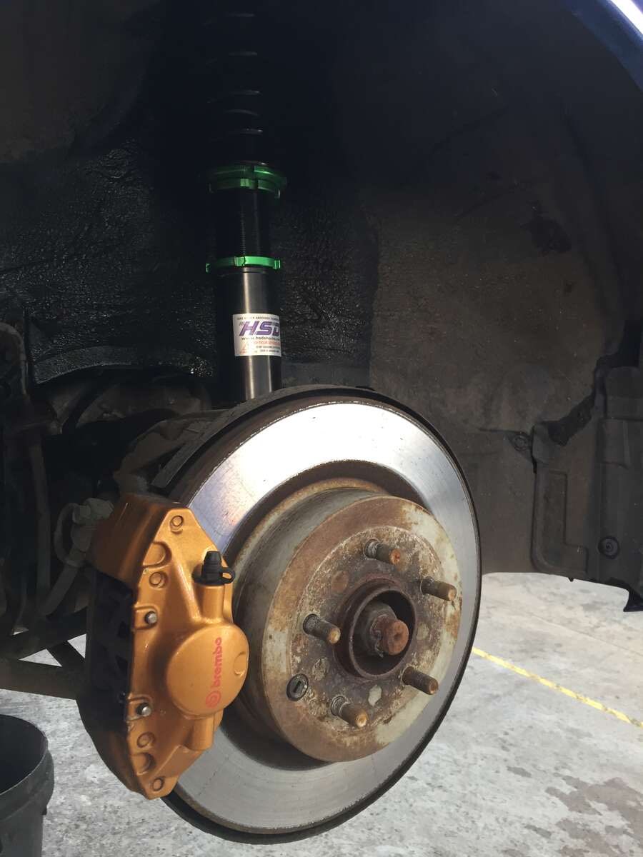

Azurez33 Posted September 27, 2021 Author Share Posted September 27, 2021 First things first…. Lots of research and checking bank accounts later, I made my way through various sites comparing coilovers, springs and bags to make my way to HSD, the current coilovers when I bought it were Hsd and the price was definitely middle of the road/ on the higher side plus I really like the look of them. I did look towards yellow speed, meister r or bc, I had heard mixed reviews about bc and the price was above that of the meister and yellow speed and in the end I was drawn to the hsds. What I wanted was Ohlins however my bank account said no! I opted for the softer spring rate as I was to be using this as my daily so 9kg front 6kg rear, with the 16 point adjustment I felt the point wasn’t lost by going for softer springs 2 years later I can say I’m still impressed with them. The original set up definitely took a while to make sure everything was right, checking the preload was just right so not too much tension on the spring but at the same time it wasn’t loose, I started by adjusting them to exactly on the middle and kept tweaking them from there! Eventually reaching a point where I felt my awkward drive wouldn’t catch anything important! 2 Quote Link to comment Share on other sites More sharing options...

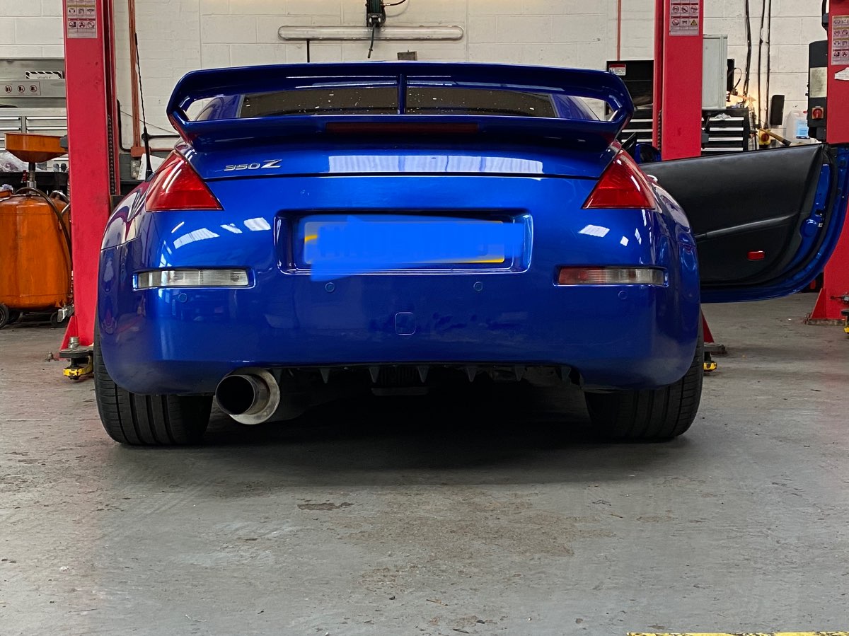

Azurez33 Posted September 30, 2021 Author Share Posted September 30, 2021 Continuing with the update, After having the Z for a couple of months I decided that as much as I loved my cobra sports back box and how symmetry is very pleasing, I also love a good wrench in the works. This wrench being an AAM competition single exit y section back, bought it off a very helpful chap on eBay and it meant I could just replace the cobra box and it payed for itself, obviously I made sure I polished it up with elbow grease and some autosol accompanied by some steel wool. Do love a shiny tip 😂, also replaced all the associated gaskets whilst doing this. I hadn’t really heard of AAM and tbh there wasn’t really much in the way of single exits for sale that I had the money for that didn’t require importing. So I did some research and found out that it was Defintely the exhaust for me. Here’s a snipped from their info on the exhaust: ” The AAM Spec 3" MaxFlow Single Exhaust is specifically designed for those with extreme volume and velocity requirements. The AAM Spec 3" MaxFlow Single exhaust is the highest flowing single exhaust available for the 350Z and is a perfect match for Turbocharged street/strip 350Z's or naturally aspirated/supercharged racing setups that require maximum flow.” My next issues, brakes and my y section that’s gone awol Quote Link to comment Share on other sites More sharing options...
davey_83 Posted September 30, 2021 Share Posted September 30, 2021 Looking good pal. Why did you buy coilovers when you already had coilovers? 1 Quote Link to comment Share on other sites More sharing options...
Azurez33 Posted October 1, 2021 Author Share Posted October 1, 2021 16 hours ago, davey_83 said: Looking good pal. Why did you buy coilovers when you already had coilovers? Cheers mate, only moving over the pics and compiling more info atm got lots of new stuff I’ve done that needs writing up! basically it had been left adjusted to on the floor which wasn’t suitable for me, corrosion had seized the bottom two locks. I’m also a big fan of knowing how old something is so I can service and clean regularly and not deal with someone else’s neglect. Also the monopros were true coilover on the rear as opposed to the latter on the dualtecs. I then cleaned them and managed to free them off and sell them to @Monkey1983 1 Quote Link to comment Share on other sites More sharing options...

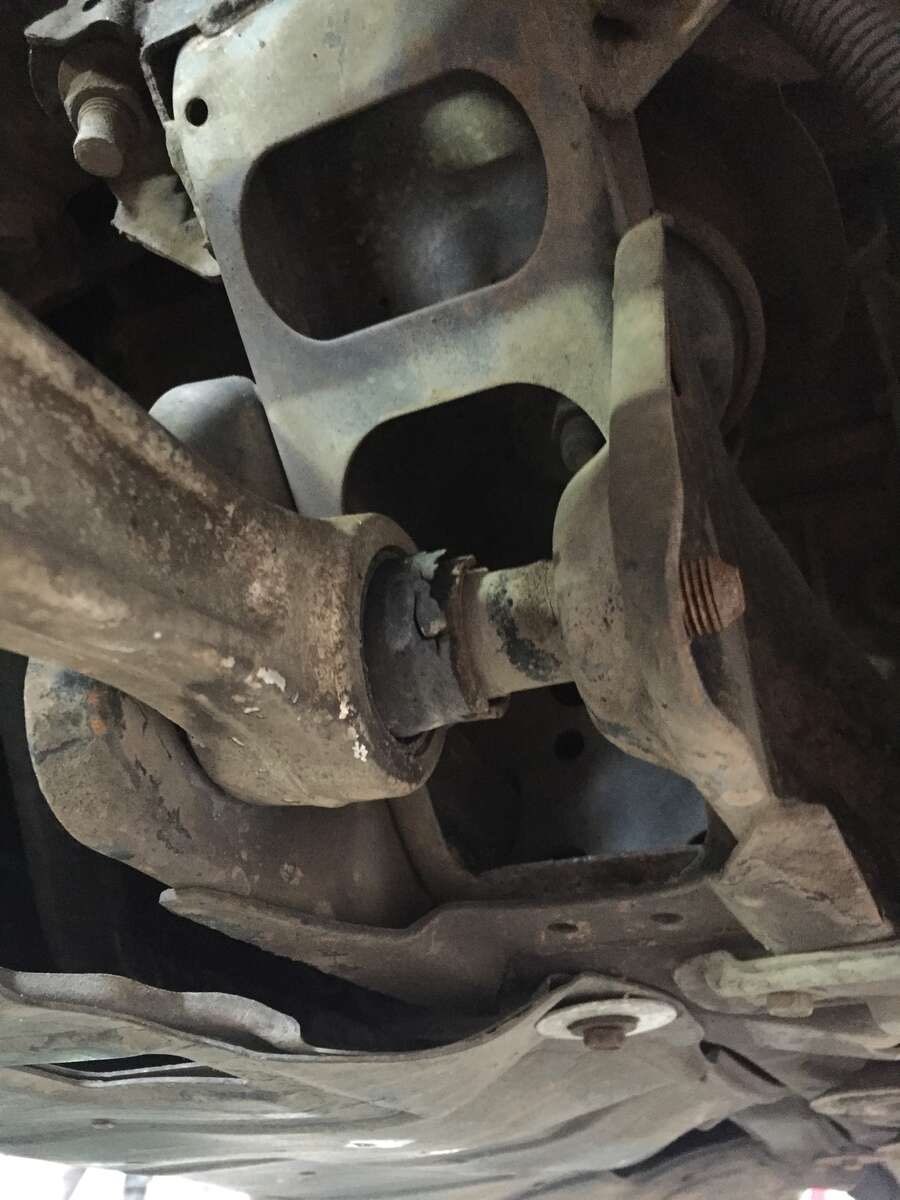

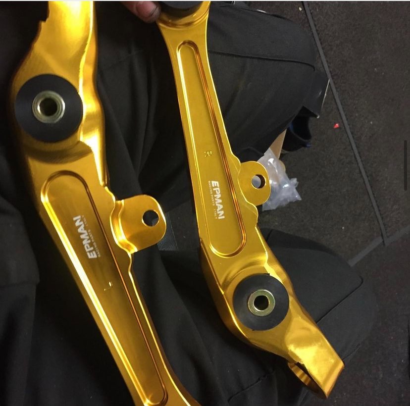

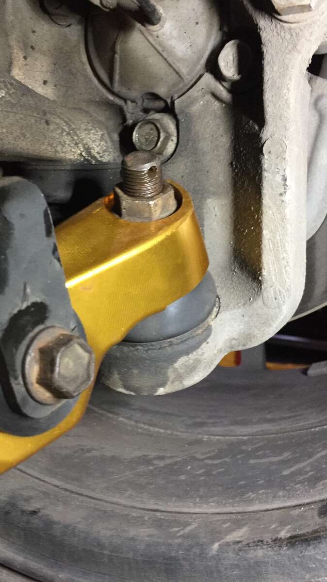

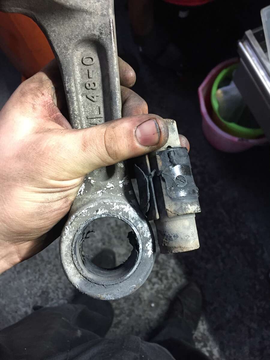

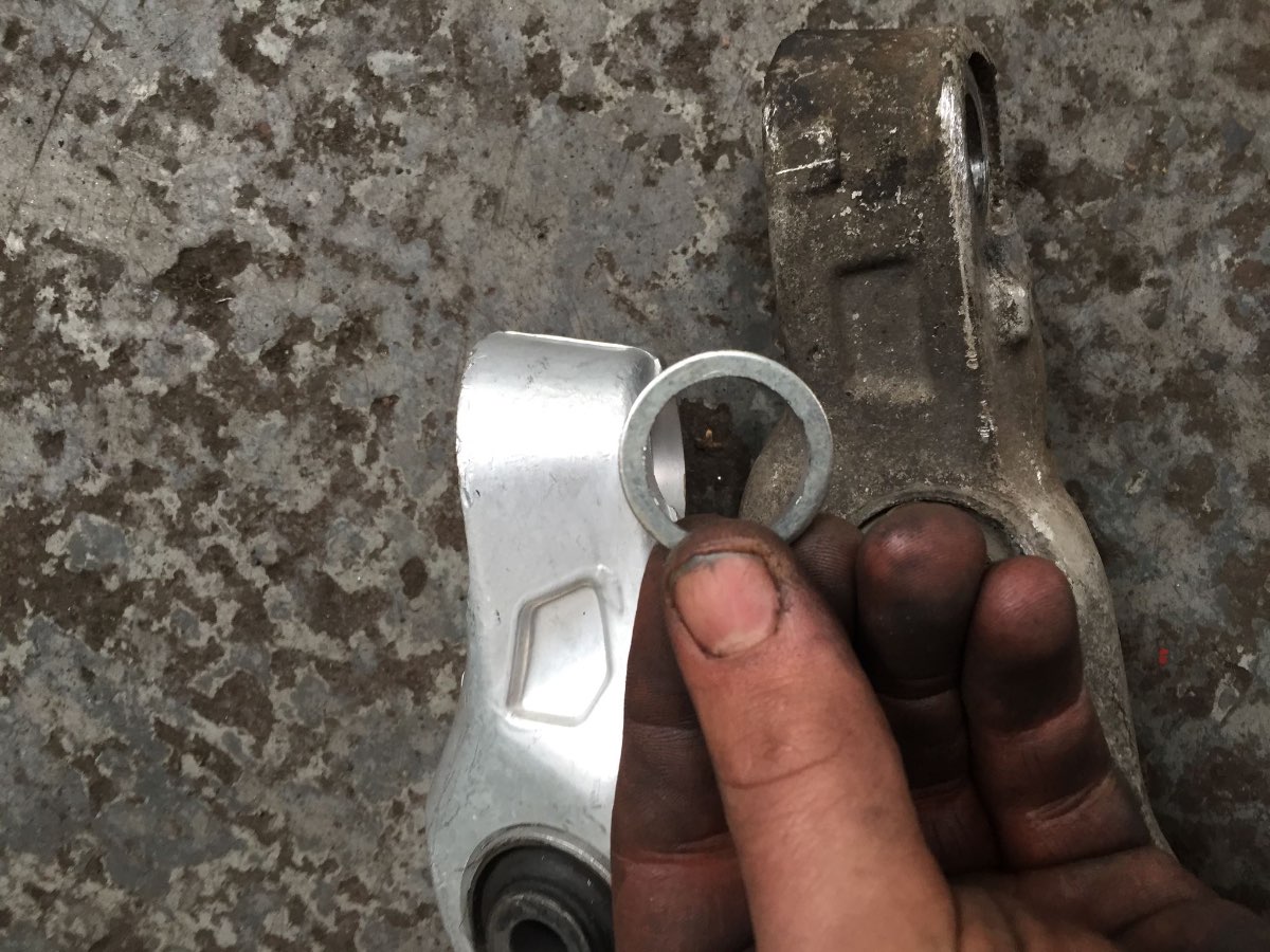

Azurez33 Posted October 1, 2021 Author Share Posted October 1, 2021 (edited) Another day, another story. Commonly on these beautiful cars at the age and mileage they love to destroy the lower control arm bushes, thankfully they can’t go anywhere but they make a hell of a noise. So I did a fair bit of researching and keeping in mind costs, I was weighing up removing my standard arms and polybushing them both, cost effective yes however I wanted to try a give the suspension a new lease of life and a different look! So I found these on eBay, granted it was a bit out of my comfort zone as they were from China and quality was something I was worrying about, however everything is made there these days and it’s only metal and rubber tbh so I though I’d risk it! FairPlay I was quite chuffed tbh because the quality was actually really good! a few cnc errors however- due to a recess where the nut for the bottom balljoint is- the bottom of the arm is lower than the bottom of the nut- at 8pm at night this was an absolute nightmare so I had to use a boron washer from a crank bolt- I lathed out the Center to raise the height of where the nut seats and finally it tightened up without any play! wohoo! FYI: the arm with the mock-up washer is silver because that’s what I fitted to @Monkey1983 Edited October 1, 2021 by Azurez33 1 Quote Link to comment Share on other sites More sharing options...
da.murf Posted October 2, 2021 Share Posted October 2, 2021 Keen to hear the exhaust. Thinking of moving to a single exit myself Quote Link to comment Share on other sites More sharing options...

Andy_Muxlow Posted October 2, 2021 Share Posted October 2, 2021 Looking good buddy. I am also thinking of moving over to a single exit exhaust. Quote Link to comment Share on other sites More sharing options...
Azurez33 Posted October 2, 2021 Author Share Posted October 2, 2021 14 hours ago, da.murf said: Keen to hear the exhaust. Thinking of moving to a single exit myself Well, not going to lie it’s such a deep deep tone it sounds awesome with just the box even my mate with a Subaru said god that’s a real deep tone, I’ve now got a cobra y section and cobra sports cats and it’s such an individual sound not really heard anyone else’s sound similar! I would kill for a tomei but think that would just be too loud! 😂 I’ll be at jdm castle Combe if you want to have a listen! 4 hours ago, Monkey1983 said: Looking good Deano , stop with the mechanics and show us the flashy bits 🤣 ( you know I’m a flashy bits whore ) Sorry Sam got to do the write ups properly, if I didn’t do the mechanics mate that wouldn’t help you very much would it 😂 I’ll get there mate got so much to add! 2 hours ago, Andy_Muxlow said: Looking good buddy. I am also thinking of moving over to a single exit exhaust. Thanks mate, it won’t disappoint dependant on what you get, I see tarmac have made their own now- problem with the single exits is there’s not overly much of them over here they’re all imported pretty much! 1 Quote Link to comment Share on other sites More sharing options...

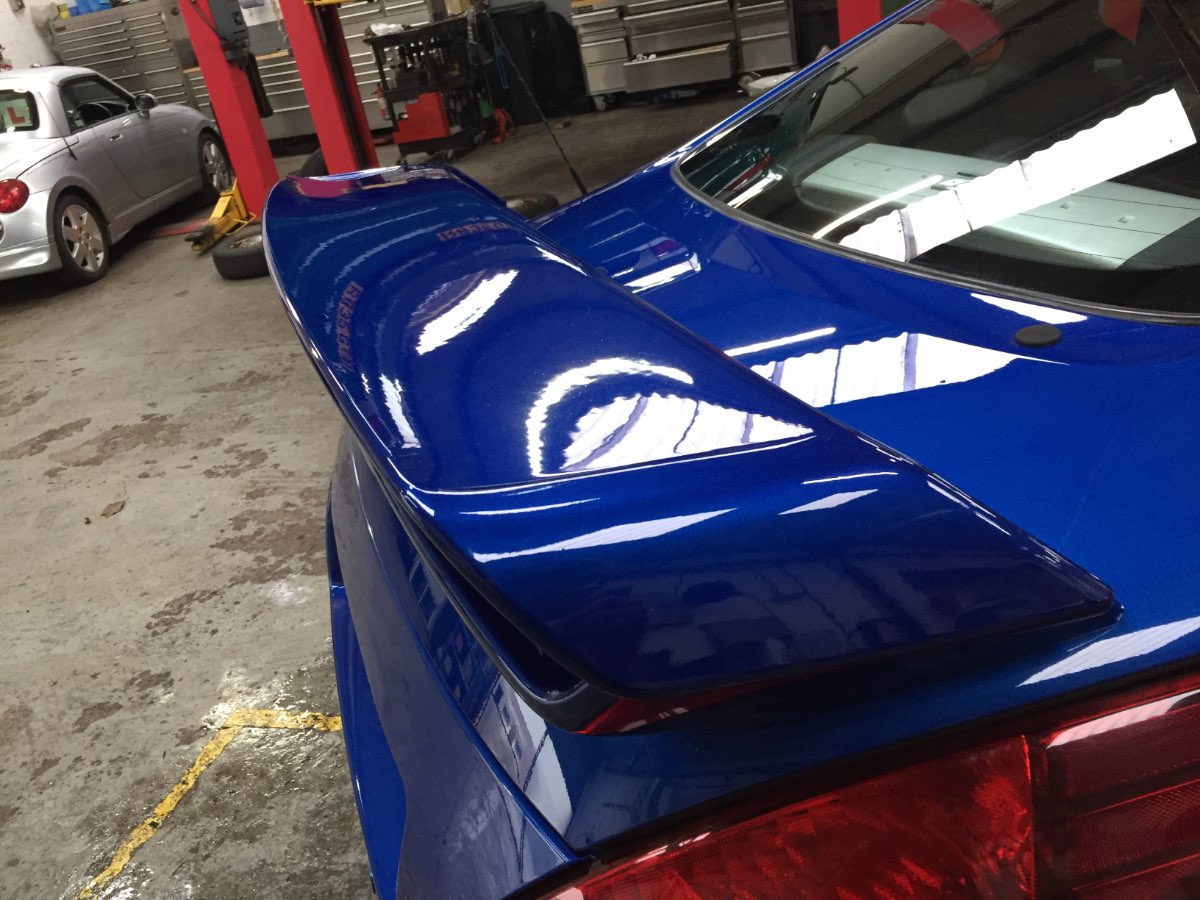

Azurez33 Posted October 15, 2021 Author Share Posted October 15, 2021 (edited) So continuing on, I’ve always felt that the back end needed something to set it off as the base lip just Wasn’t enough and I needed something a bit more, but at the same time something that flowed right with the body as I felt that a big wing just wasn’t for me- so I did look into ducktails however I felt they were just a bit too common for me! I do like ducktails but needed to be a bit different, so I started looking though and found a few eBay specials but was worried about fitment issues! I then found that tarmac sportz did replica Nismo spoilers- not that I want to make mine a fismo but I just genuinely liked the sleek look that move and blend with the body but also give the back end a big talking point. Funnily enough they had just had an offer in the v3 for a lower price as a preorder so I just knew this was a sign! Ordered and test fitted! was absolutely over the moon with the look! I got my boss to do me a fair job of painting it (god azure blue isn’t cheap) the worst pain in the ass was trying to fit the thing with all the 10 mounting bolts - an old tipex truck did save me a fair bit of time marking where the holes needed to be. Following this attacking the bootlid with a parking sensor hole saw to which I then checked the holes lined up to which thank god they did! silicones round the ends as they were open and didn’t want the bolts corroding and to make sure the water doesn’t get in the boot! also made sure I siliconed up the third brake light also siliconed round where it seats as an extra layer of protection (which hasn’t worked and now it’s bossed - current edit) feeding the wire through the boot was a challenge on its own! long grabby tool to the rescue! Also attached are some shots from my first three stage polish the week before the spoiler arrived! god they do shine up well! Edited October 15, 2021 by Azurez33 Quote Link to comment Share on other sites More sharing options...
Azurez33 Posted October 15, 2021 Author Share Posted October 15, 2021 It makes a hell of a difference Quote Link to comment Share on other sites More sharing options...
