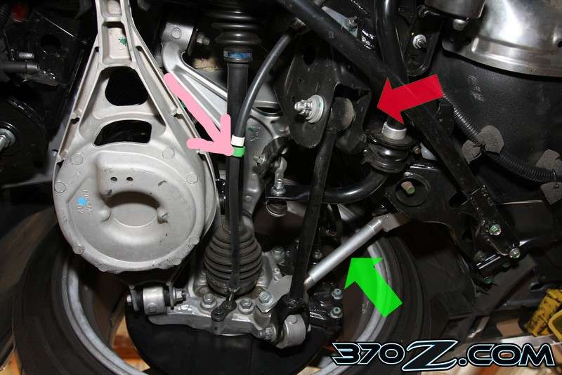

Hi everyone, I was wondering if anyone knows the part number I have marked with a pink arrow with the white and green markings, and if so the part number to replace.
Also looking for the W brace which has rusted out.
Any advice is also welcome.
Cheers

The red arrow is the camber arm, available here: https://www.torqen.uk/nissan/370z/suspension-steering/arms-links/44643-370z-z34-nissan-oem-rear-lower-control-arm-551a0-jk000.html
Green - Traction rod:  https://www.torqen.uk/nissan/370z/suspension-steering/arms-links/44639-370z-z34-nissan-oem-rear-traction-rod-arm-55110-jk00c.html
Pink: Are you referring to the cable or the shaft?
W Brace (in stock): https://www.torqen.uk/nissan/370z/suspension-steering/braces/11083-370z-nissan-oem-undercarriage-body-tunnel-w-brace-74870-1ea0a.html
7Zap is really good to use if you ever need to determine part numbers: https://nissan.7zap.com/en/er/z+zx/z34/2+904+1504/
Shows detailed diagrams and part numbers. Drop me a PM if you have any other questions or if you'd like me to check the warehouse for availability.
