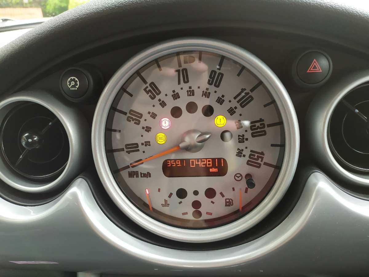

ballistic Posted August 19, 2021 Share Posted August 19, 2021 The dials on my main cluster are all reading at extremes. Sometimes after turning the ignition on and off multiple times they start to read correctly. Believe it or not. Im not out of fuel while at 9000rpm doing 250mph with 200 C temps. Im actually sat on my driveway. (Also i haven't done 600,000 miles) Tried replacing the air con control unit: Didnt help. Anyone experience anything similar? Any suggestions or advice appreciated. 1 Quote Link to comment Share on other sites More sharing options...

HEADPHONES Posted August 20, 2021 Share Posted August 20, 2021 I feel your pain Ballistic. This has been happening with our 2006 Mini for over 2 years Mine is related to moisture as it's more frequent after rain on initial start up. Normally goes away after a few minutes driving, but when my dash looks like this the AC stops working and the Speedo stays at zero with all the warning lights lit up like a Christmas Tree. My garage can't find the problem and the Mini forums say it could be a loose solder in the dash SOMEWHERE Quote Link to comment Share on other sites More sharing options...

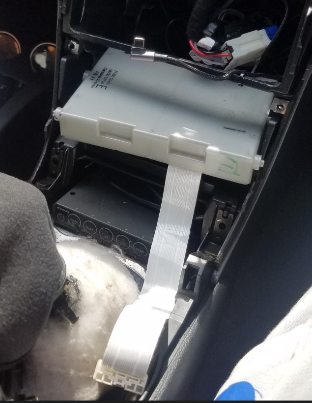

marzman Posted August 20, 2021 Share Posted August 20, 2021 Are the ribbon cables that go into the white AC control unit okay? Not folded or pinched or anything? Quote Link to comment Share on other sites More sharing options...
ballistic Posted August 20, 2021 Author Share Posted August 20, 2021 thanks guys. checked every fuse and rechecked the ac controller. No success yet. @marzman ribbons on both the old and new are fine. Going to replace my passenger hub tomorrow. After i will have a look at earths and take out the cluster and have a look. Quote Link to comment Share on other sites More sharing options...
