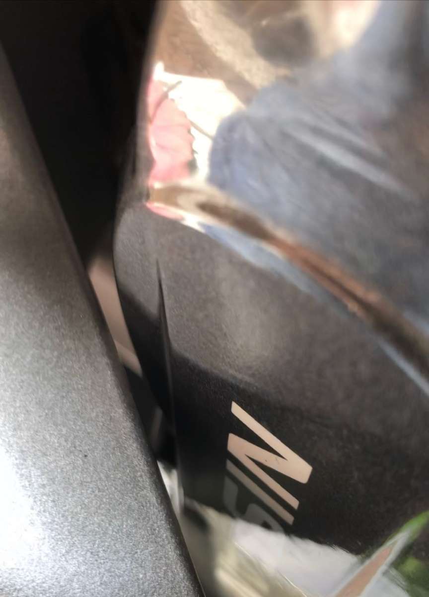

Bunning Posted October 13, 2021 Author Share Posted October 13, 2021 @Loadmaster Here ya go, if you want any specific pics I'm happy to take some, for info my car is running standard suspension (GT model obviously) I opted for these wheels as they are ever so slightly more aggressive than the Nismo rims (in poke) and they fit without spacers albeit tight on the front (see pic above) I have absolutely no rubbing scrubbing etc. 4 1 Quote Link to comment Share on other sites More sharing options...

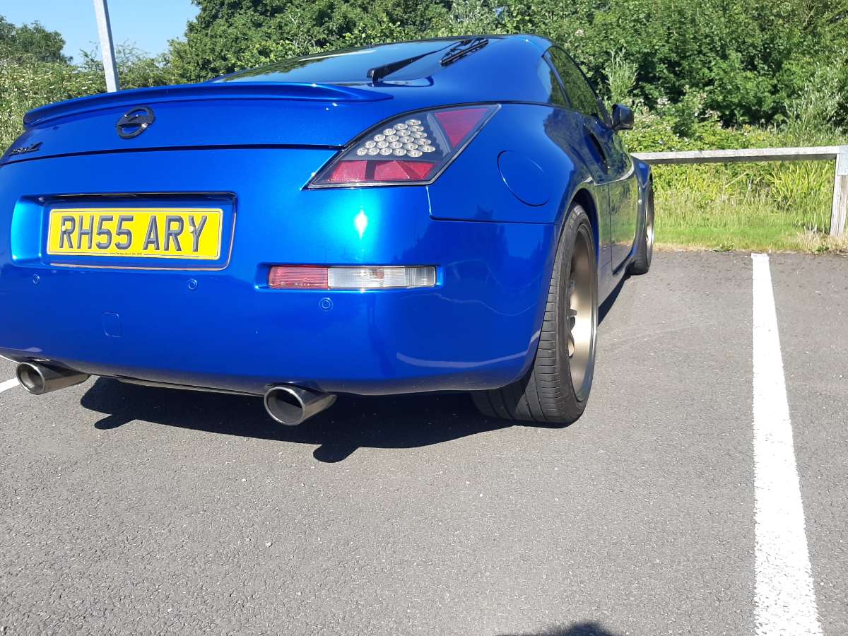

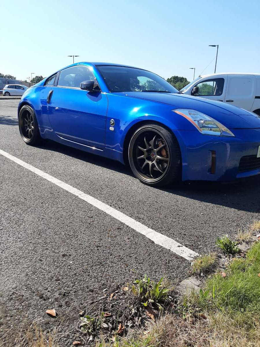

pintopete58 Posted October 15, 2021 Share Posted October 15, 2021 Hi all these are my D9r works wheels on my 350 that I've just sold o/s front +23 rear +30 and they are going on my 370 soon 1 Quote Link to comment Share on other sites More sharing options...
pintopete58 Posted October 15, 2021 Share Posted October 15, 2021 Forgot no spacers Quote Link to comment Share on other sites More sharing options...

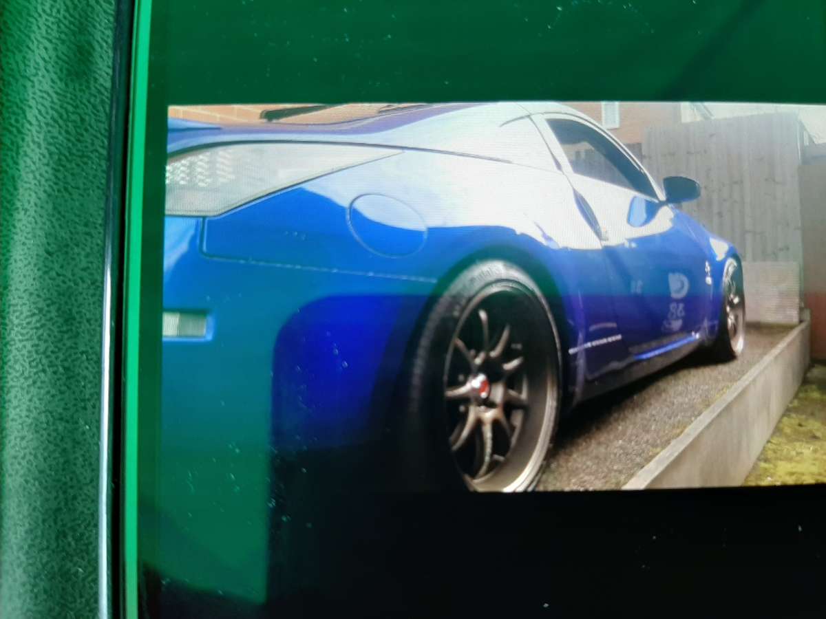

Loadmaster Posted October 18, 2021 Share Posted October 18, 2021 On 15/10/2021 at 21:05, pintopete58 said: Hi all these are my D9r works wheels on my 350 that I've just sold o/s front +23 rear +30 and they are going on my 370 soon I like those, a nice deep dish. Is D9R the brand? Sorry for dim question! Quote Link to comment Share on other sites More sharing options...
pintopete58 Posted October 18, 2021 Share Posted October 18, 2021 Yes mate d9r worksemotion Quote Link to comment Share on other sites More sharing options...
pintopete58 Posted October 18, 2021 Share Posted October 18, 2021 This might be a better picture Quote Link to comment Share on other sites More sharing options...
