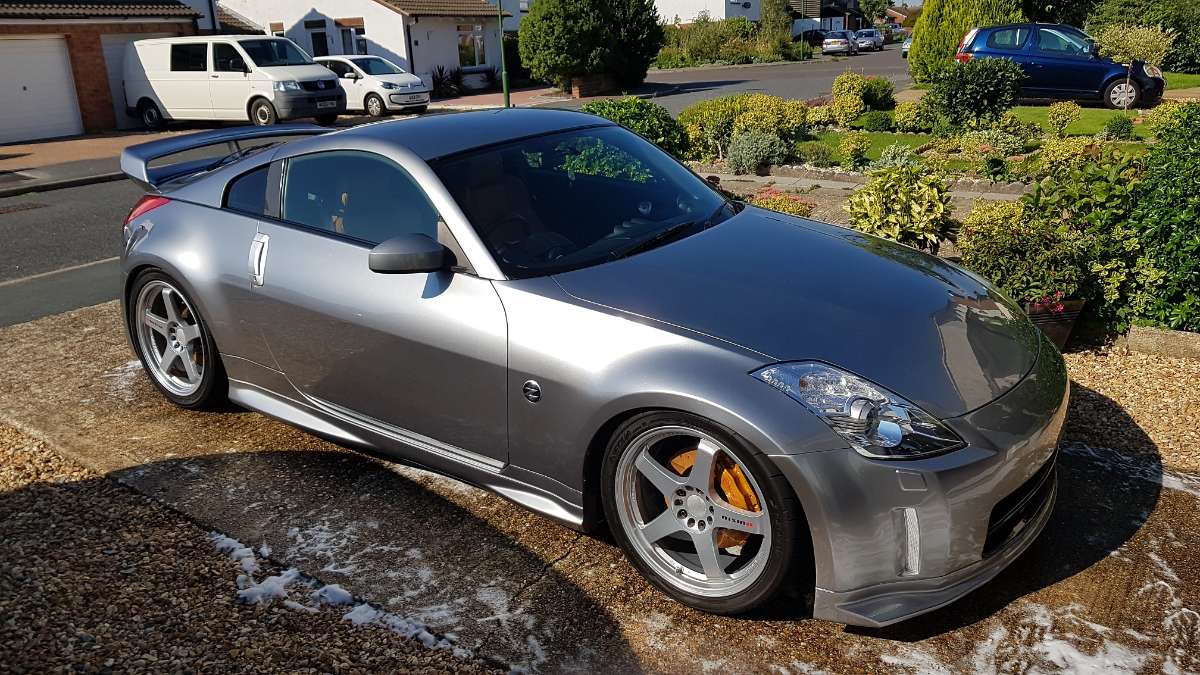

Olly350z Posted May 23, 2021 Share Posted May 23, 2021 14 hours ago, W8BGS said: Ah OK, yeah I think they did say the rear was seized. Freshen up the suspension probably a good idea, but after just spending £740 on tyres I can't afford anything major. I just spotted these. Do you think they will do the trick? https://www.torqen.uk/nissan/370z/suspension-steering/arms-links/12799-370z-moog-rear-adjustable-alignment-cambertoe-kit-k100152.html Anything more will have to wait otherwise until it goes to Centre Gravity in August, but if I can fix cheaply before then, then it's wise to get it sorted ASAP. Yes, I fitted a similar kit to my 350z and it worked a treat. Certain kits say you should notch the subframe for greater adjustment but I never bothered. I was pretty low on coilovers and once properly aligned never had any tyre issues. Must've done a good 15K on them and they look good as new, see photo I recommend plenty of rust buster to soak the nuts / bolts in and a long extension bar. Not the type of job you want to be doing on the floor as you won't get enough leverage and end up stripping the nuts 1 Quote Link to comment Share on other sites More sharing options...
