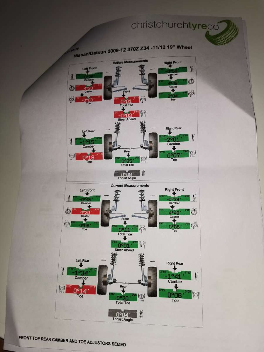

W8BGS Posted May 22, 2021 Author Share Posted May 22, 2021 I had the MPS4 fitted today and Christchurch Tyres did a front wheel alignment. The car definitely feels better. The tyres feel a lot firmer, which is good. The alignment is better now too. They said some of the front suspension parts are looking a bit crusty and the rear was seized, but I didn't think the rear was adjustable on the Zed? Either way I am looking forward to the drive to Seywell Circuit next Sunday now and also my trip to Centre Gravity in Aug. 2 Quote Link to comment Share on other sites More sharing options...
Olly350z Posted May 22, 2021 Share Posted May 22, 2021 The rear is adjustable, I'd imagine your toe bolts are seized hence why you still have toe on one side. Maybe time for a freshen up on the suspension Quote Link to comment Share on other sites More sharing options...
W8BGS Posted May 22, 2021 Author Share Posted May 22, 2021 19 minutes ago, Olly350z said: The rear is adjustable, I'd imagine your toe bolts are seized hence why you still have toe on one side. Maybe time for a freshen up on the suspension Ah OK, yeah I think they did say the rear was seized. Freshen up the suspension probably a good idea, but after just spending £740 on tyres I can't afford anything major. I just spotted these. Do you think they will do the trick? https://www.torqen.uk/nissan/370z/suspension-steering/arms-links/12799-370z-moog-rear-adjustable-alignment-cambertoe-kit-k100152.html Anything more will have to wait otherwise until it goes to Centre Gravity in August, but if I can fix cheaply before then, then it's wise to get it sorted ASAP. Quote Link to comment Share on other sites More sharing options...
Ekona Posted May 22, 2021 Share Posted May 22, 2021 You’ll need to get that sorted before going to CG, else it’s a waste of time if they can’t adjust everything fully. 1 Quote Link to comment Share on other sites More sharing options...
W8BGS Posted May 22, 2021 Author Share Posted May 22, 2021 1 minute ago, Ekona said: You’ll need to get that sorted before going to CG, else it’s a waste of time if they can’t adjust everything fully. Agree. Do you think the Moog or Eibach would do the trick. https://www.torqen.uk/nissan/370z/suspension-steering/arms-links/9778-370z-eibach-pro-alignment-rear-camber-bolts-572265k.html I assume Eibach is the way to go as long as they are fine with the rest of the set up being OEM. Quote Link to comment Share on other sites More sharing options...
