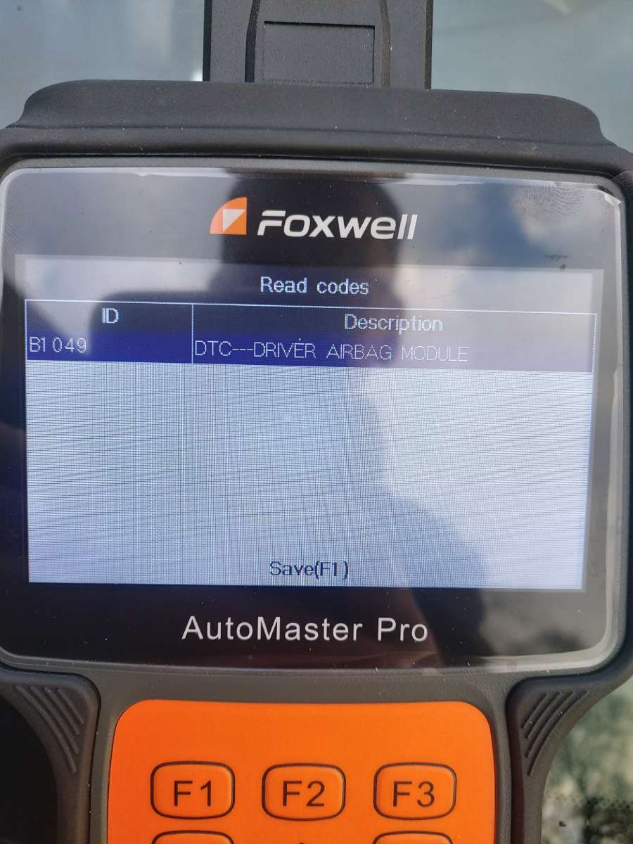

Johnno92 Posted April 26, 2021 Share Posted April 26, 2021 Hey folks, Picked up a HR in July last year finally got round to jumping on here now things are improving and can hopefully get out and about and meet some new people. At the time of buying it was the cheapest HR I could find. Obviously this is a foolproof way of buying a car and not a decision I would regret at all... Shortly after buying, it made the trip to Horsham developments to have the oil gallery gaskets changed. Unfortunatly I'd missed this issue in my pre-purchase research but at least is sorted now. Then a failed lower arm bush made a perfect excuse to swap for poly bushes. Compression arm bushes are still on the to do list. A morning underneath with jenolite and a wire brush identified a rapidly disintergrating exhaust, that will be adressed in before its next MOT and the bubbling arches in due time. And recently a steady flashing airbag light has appeared that will also need sorting. Its a B1049 code so from my research I'm hoping a clock spring change will resolve it. If anyone has anymore knowledge on that thought it would be most appreciated. All in all its become abit more of a project than I'd originally planned but its been a good learning experience so far. 😂 Quote Link to comment Share on other sites More sharing options...

Mikey_S Posted April 26, 2021 Share Posted April 26, 2021 Flashing airbag can usually be sorted with a few key turns. Ignition off, ignition on, wait for light to start flashing, ignition off. Do this 5 times, on the 6th, start it up and it should be gone, at least for a few months... There's a YouTube video that explains it better. 1 Quote Link to comment Share on other sites More sharing options...
stevezzz Posted April 26, 2021 Share Posted April 26, 2021 mine was doing this, and as mikey_s explained that was shown to me by the seller as I moved the passenger seat when buying, what I ended up doing was undo all the connectors under the passenger seat clean them with a contact cleaner and in 2 years it's never happened again 1 Quote Link to comment Share on other sites More sharing options...

Johnno92 Posted April 26, 2021 Author Share Posted April 26, 2021 1 hour ago, Mikey_S said: Flashing airbag can usually be sorted with a few key turns. Ignition off, ignition on, wait for light to start flashing, ignition off. Do this 5 times, on the 6th, start it up and it should be gone, at least for a few months... There's a YouTube video that explains it better. 1 hour ago, stevezzz said: mine was doing this, and as mikey_s explained that was shown to me by the seller as I moved the passenger seat when buying, what I ended up doing was undo all the connectors under the passenger seat clean them with a contact cleaner and in 2 years it's never happened again Thanks guys, I had seen about that reset, never actually tried it as the code would come straight back after being reset so I assumed it wouldn't work either. I'll give it a go. Code came up as driver airbag though, do the drivers seat connectors have a similar issue? I usually move the seat forward and back getting in and out. Although the light originally started pretty randomly in middle of a drive. Quote Link to comment Share on other sites More sharing options...
stevezzz Posted April 26, 2021 Share Posted April 26, 2021 it was explained to me it was the passenger seat as I said it has never reoccurred Quote Link to comment Share on other sites More sharing options...
HEADPHONES Posted April 27, 2021 Share Posted April 27, 2021 Worth a try as it's worked for me a couple times over past 16 years 1 Quote Link to comment Share on other sites More sharing options...

HEADPHONES Posted May 2, 2021 Share Posted May 2, 2021 YOU JINXED ME!!!!!!! Had a passenger for the first time in a year today. Nothing under the passenger seat but when I moved it back and forward today for the missus......boom...... airbag warning light flashing. 30 seconds of ignition on and off 4 times and it's gone Quote Link to comment Share on other sites More sharing options...
