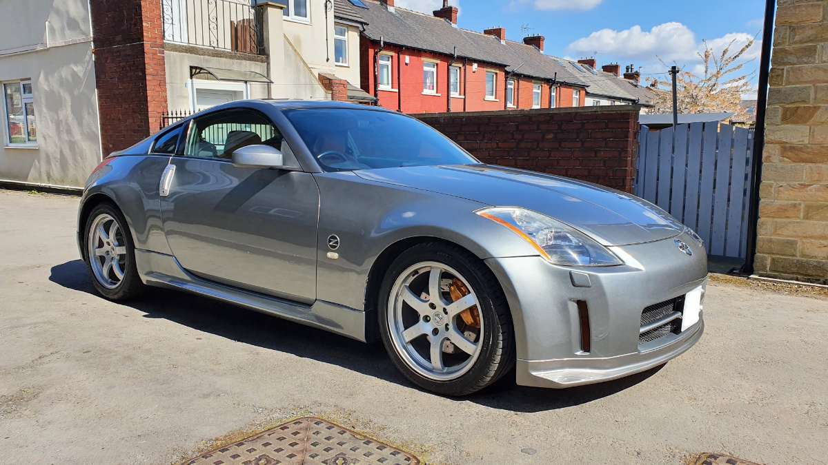

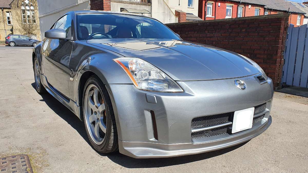

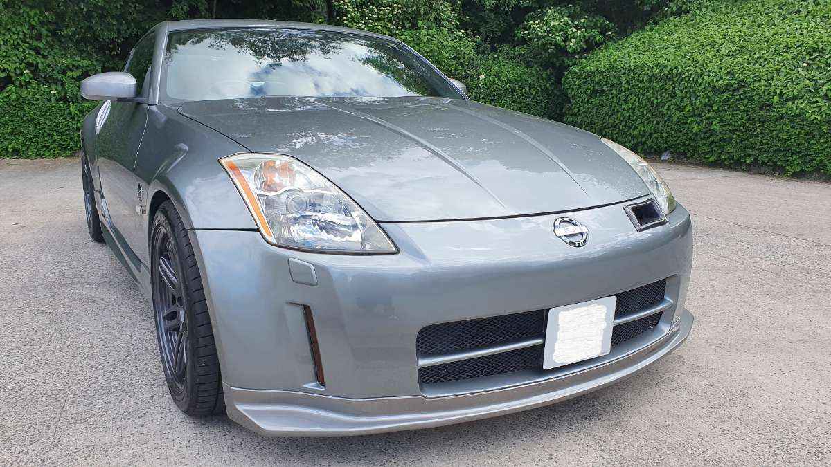

Loki Posted April 15, 2021 Share Posted April 15, 2021 Hi there, welcome to my build thread. I've been the proud owner of a Zed for the last 6 months and despite some odd little issues I'm very happy with my purchase, though there're things I feel could be improved. So I decided to start this thread so you guys and girls can ride shotgun along with me. Hopefully we'll all learn something along the way. Okay, let's get to the good bit; My Zed 05' DE 81K GT Spec/Rays with Tan leather option Gunmetal Grey Manual Bridgestone Portenza S001 F225/R245 Tesco Momentum 99 3 Quote Link to comment Share on other sites More sharing options...
Sim Posted April 15, 2021 Share Posted April 15, 2021 Look's great Quote Link to comment Share on other sites More sharing options...

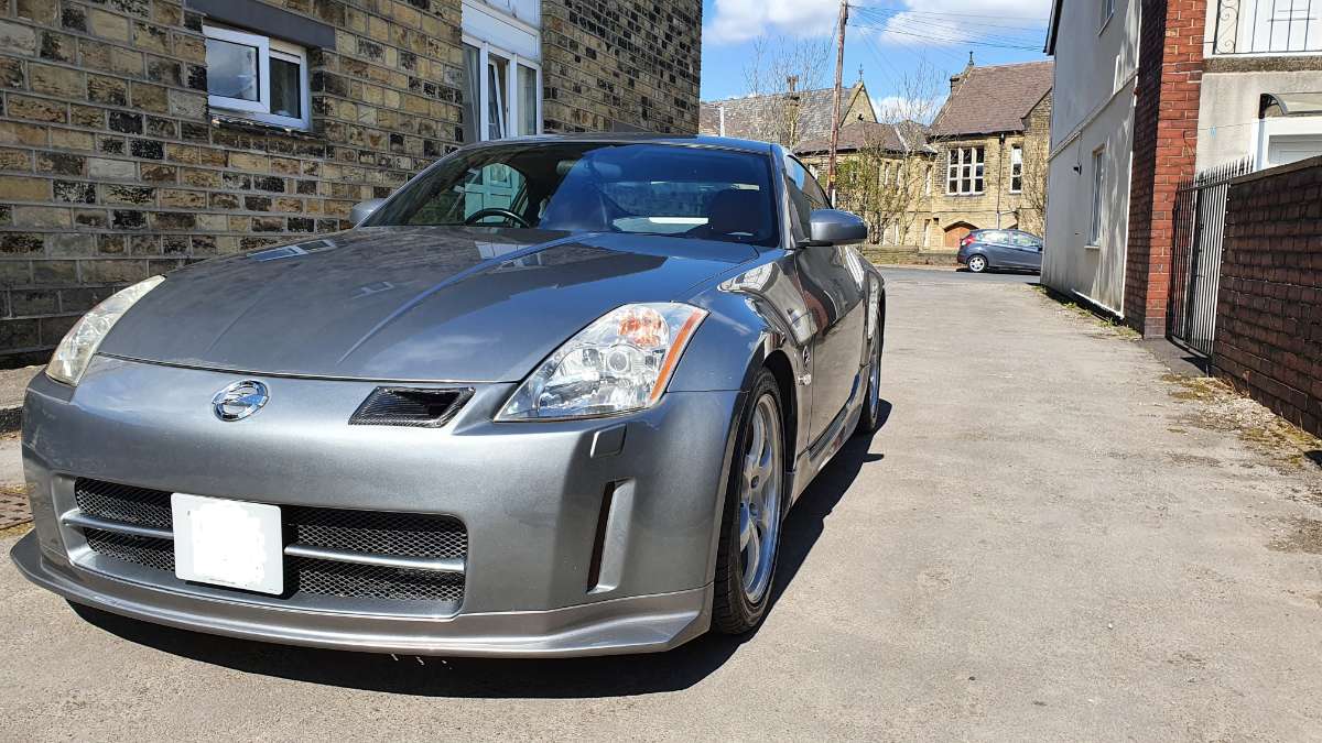

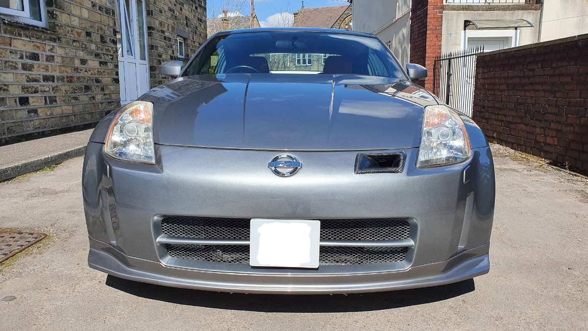

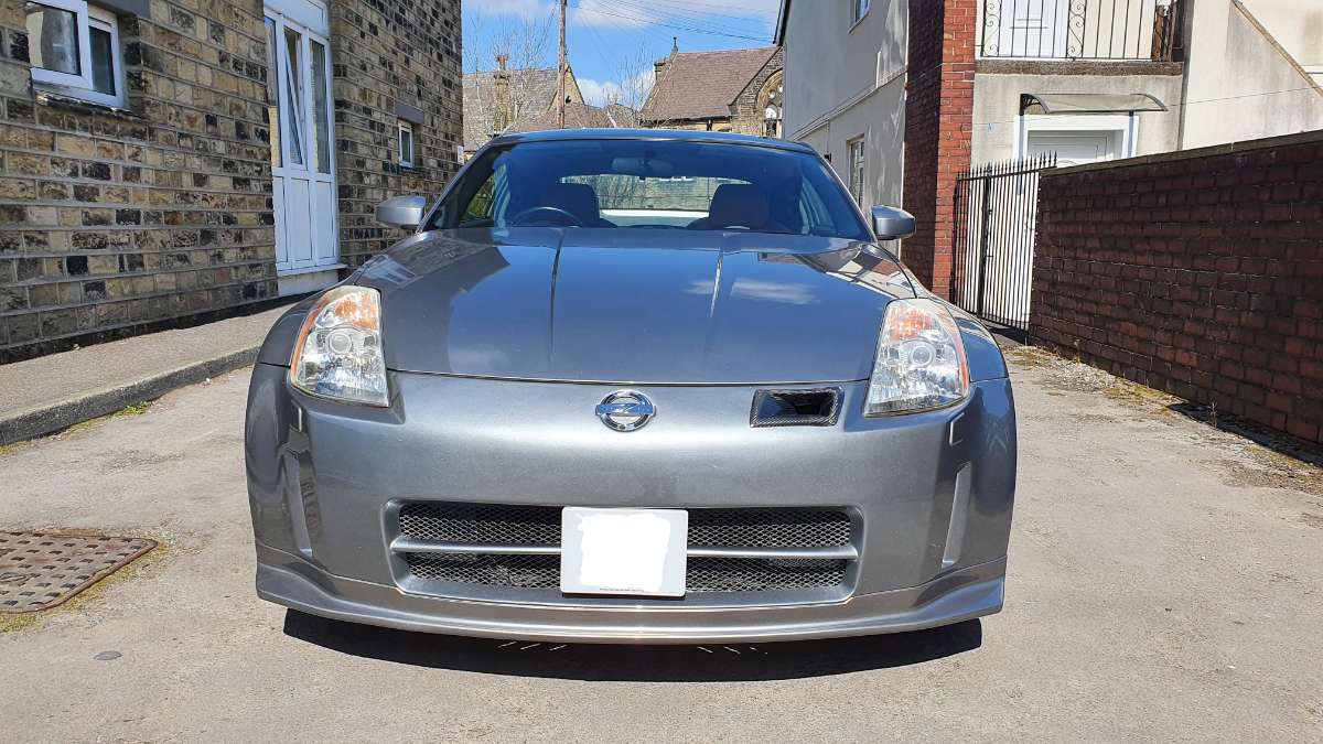

Loki Posted April 15, 2021 Author Share Posted April 15, 2021 (edited) As you can tell this isn't the start of the project, so I'm going to bring you up to speed. The Nismo bumper was on the car when I bought it, fairly sure it's a replica, definitely fiberglass and in all honesty it could do with a respray at some point. It also has a strange upwards curve to the bar across the grill, reckon the square plate is to hid this intentionally because it isn't a imported car, I will be swapping back to a shortened standard plate soon. The side skirts I know very little about, bought off ebay second hand and resprayed. I do like the look of them though, they remind me of the skirts on the 370Z. What I do know is that they are moulds stuck onto factory sills, which is why they're not quite flush. Rear spats are the G35 style from Tarmac sports and needed the rear bumper painted when they were fitted. Lastly the exhaust, this is a Maganflow B1 with high flow cats (that have switched on the engine management light so essentially de-cat), resonated cat back. Before it sounded like a fast Nissan but now it has a much lower growl to it when I've got my foot down but still quiet in traffic which is exactly what I wanted. This was also second hand from ebay but cost under £450. Edited April 15, 2021 by Loki 3 Quote Link to comment Share on other sites More sharing options...
Loki Posted April 15, 2021 Author Share Posted April 15, 2021 20 minutes ago, Sim said: Look's great Thanks 😁 Quote Link to comment Share on other sites More sharing options...

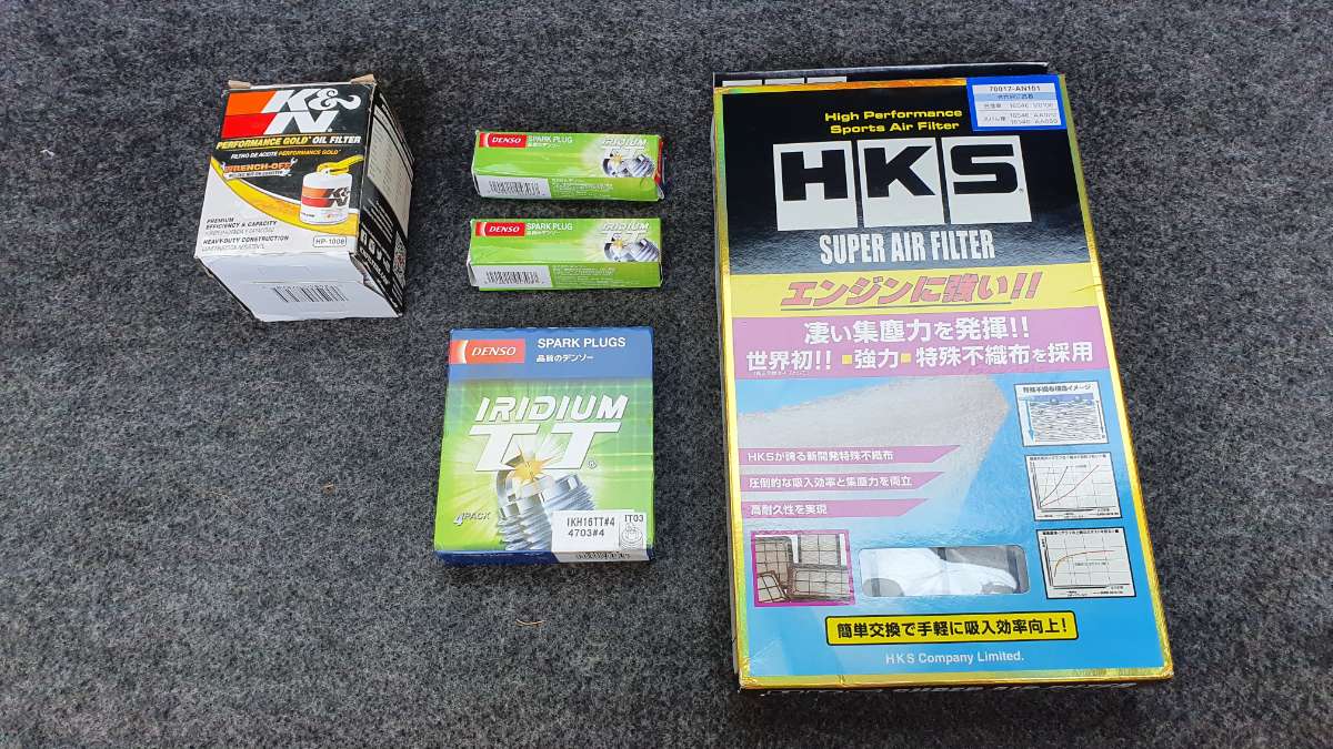

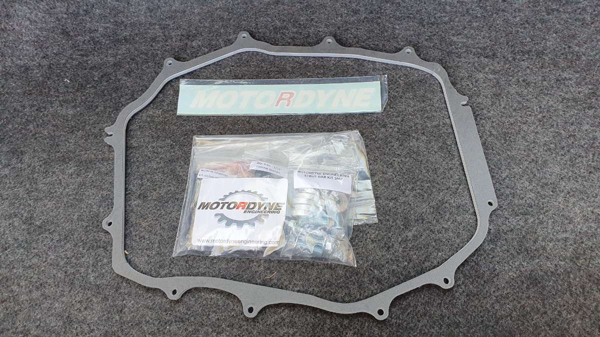

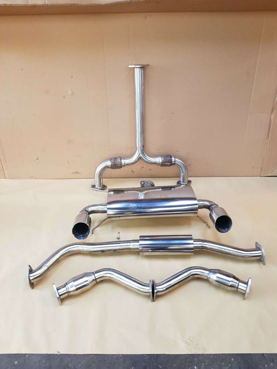

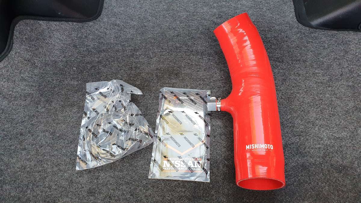

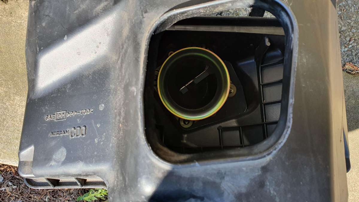

Loki Posted May 8, 2021 Author Share Posted May 8, 2021 (edited) Now the initial issues with the Zed are resolved it's now time to bolt on some bits and get the motor in optimal condition for a future remap, and maybe gain a pony or two. So without further ado let's get into it. Firstly, servicing a few bit's can go along way when your wanting push the limits on a dyno, it definitely won't hurt. HP-1008 K&N Oil Filter fits Nissan 350Z 3.5 V6 2003-2009 https://www.ebay.co.uk/itm/381713555729?fits=Car+Make%3ANissan|Model%3A350Z&hash=item58dfe6a111:g:OUUAAOSwXN5amm6l DENSO IKH16TT IRIDIUM TT SPARK PLUGS https://www.ebay.co.uk/itm/163183041006?epid=19026917692&hash=item25fe7799ee:g:3u8AAOSwP4FaCrNW HKS Super Air Filter https://www.ebay.co.uk/itm/303349669616?fits=Model%3A350Z&epid=26035665498&hash=item46a10c9ef0:g:XdwAAOSwmlZfF-QX Castrol Edge 5W-30 LL 4L 4 Litres Full Synthetic Car Engine Oil Titanium FST (4.7 Lt needed) (Massive link, just search it) Since the garage already had some of the engine bay disassembled because of the spark plugs, it was the right time to gain some BHP Motordyne Nissan 350Z VQ35DE 5/16" Basic Plenum Spacer (Claimed 11-13 (W?)BHP gain) https://www.tarmacsportz.co.uk/motordyne-nissan-350z-5-16-basic-plenum-spacer.html A little thread about why I choose this spacer 2006-07 Rev up Air Box with velocity stack (Claimed 5 BHP gain) And just to help it breath a little easier Mishimoto Silicone Air Intake Hose Kit - fits Nissan 350Z VQ35DE - 03-06 - Red (Claimed 2-3 BHP gain) https://www.ebay.co.uk/itm/154368939052?epid=3012505299&hash=item23f11b142c:g:kY0AAOSweANgS4ko I choose this inlet pipe because it's silicon and won't be effected by heat sink like plastic and especially metal are, also it's ribbed (FHP😉) so it won't contract under load either. According to to manufactures I've gain as much as 21(W)BHP not including the supposed gain from the air filter which I'm not counting since it already had a K&N panel filter in. So whats the verdict now I've had chance to get some miles done, I have to say I haven't noticed much of a difference, it might rev a little easier, there's no dramatic change though, I know I'll need a remap before getting the best out of these mods and this has just been the ground work for whats to come. But I have to say I'm more excited about having the delayed throttle response in 1st to 3rd removed with the tune than I've been with these bolt on's, which to be fair with the Zeds ECU dialing out the upgrades gains, I've got pretty much exactly what I expected. The remap can't come soon enough. (Have my old '05 air box with K&N filter up for sale, if anyone's interested. Going to post it in the correct thread soon) Edited May 8, 2021 by Loki 1 Quote Link to comment Share on other sites More sharing options...
Loki Posted May 20, 2021 Author Share Posted May 20, 2021 Big things are coming! Quote Link to comment Share on other sites More sharing options...
Andy_Muxlow Posted May 20, 2021 Share Posted May 20, 2021 Very nice build thread. Keep the updates coming. Quote Link to comment Share on other sites More sharing options...

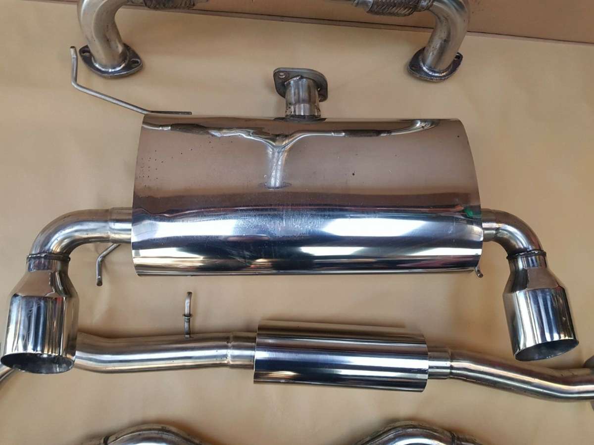

HEADPHONES Posted May 21, 2021 Share Posted May 21, 2021 Can't believe I've overlooked this thread til now. Zed is coming along nicely. That exhaust no way looks second hand........just TOO GORGEOUS......looks box fresh. As for the undertray, only last week my friend discovered that the garage cut a hole in his so they could do the oil changes on his C Class without the hassle of removing and refitting it Quote Link to comment Share on other sites More sharing options...
Loki Posted June 16, 2021 Author Share Posted June 16, 2021 On 21/05/2021 at 18:33, HEADPHONES said: Can't believe I've overlooked this thread til now. Zed is coming along nicely. That exhaust no way looks second hand........just TOO GORGEOUS......looks box fresh. As for the undertray, only last week my friend discovered that the garage cut a hole in his so they could do the oil changes on his C Class without the hassle of removing and refitting it Thanks for reading, glad your enjoying the tread. Yeah got lucky with the exhaust, had been saving for a new one, then spotted that, really enjoy the sound as well, the more I modify the better it gets. Quote Link to comment Share on other sites More sharing options...

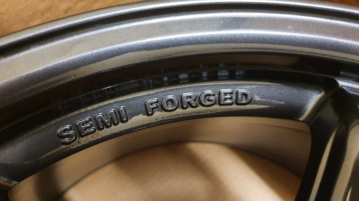

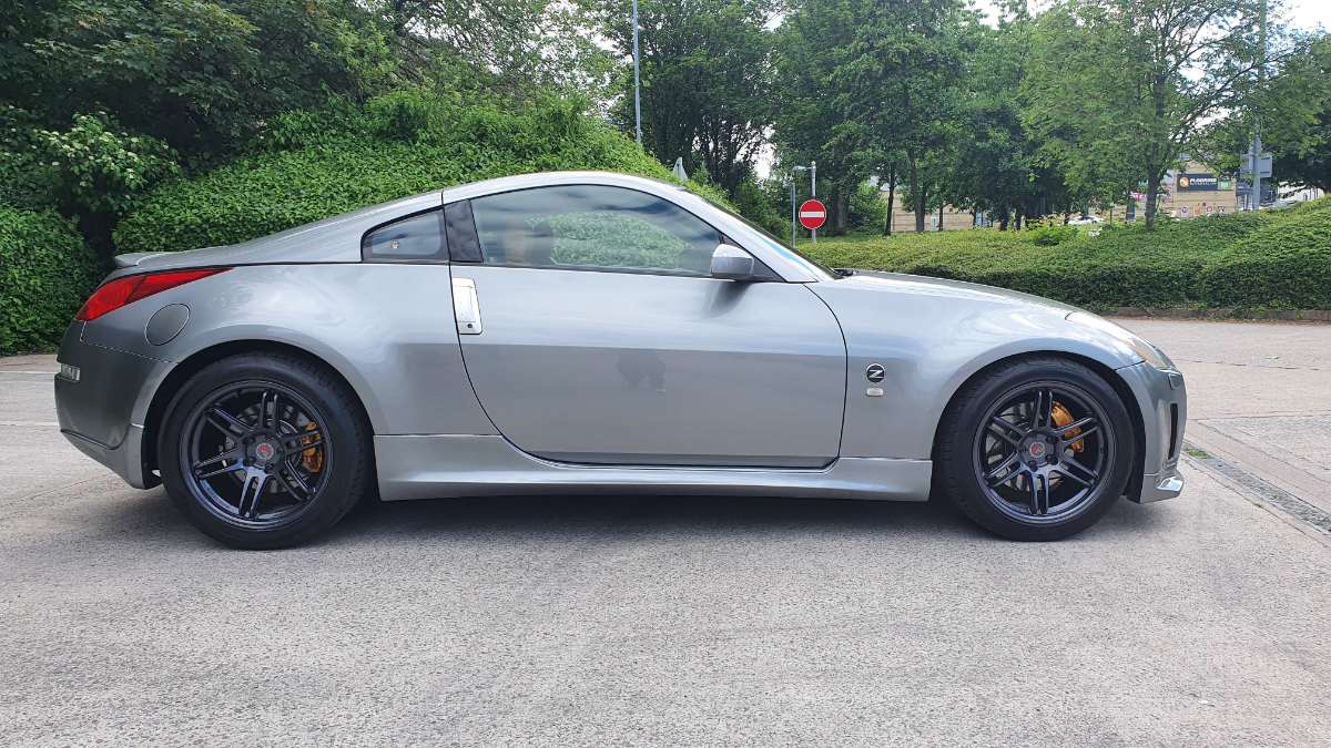

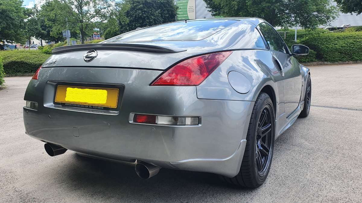

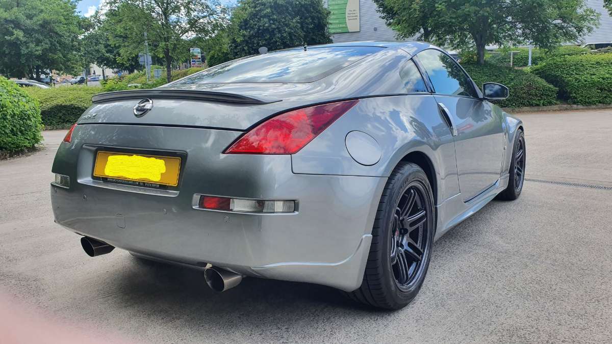

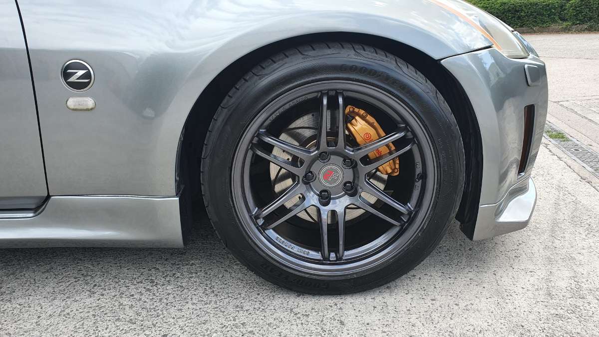

Loki Posted June 16, 2021 Author Share Posted June 16, 2021 As promised I can finally post some pictures of my new wheels. Take a look and read this after, you know you want to.... They're 2Forge ZF5's semi-forged Gloss Gunmetal Front 18x9.0 Offset 17 8.4 kg (Approx) 255.40 Goodyear Eagle F1 Supersport Rear 18x10.0 Offset 25 8.8 kg (Approx) 275.40 Same as above (Rears have a deeper design) What makes these special is they are a rotary forged universal race wheel made to order, but to keep costs down they are designed to have custom PCD's drilled and offsets shaved instead of having to re-engineer for each individual stud patter, meaning I paid about £225 a corner for very light wheels. The weight is approx because it's what they weigh at full offset of ET35, but with the difference between the 9.0 and 10.0 being only 0.4kg I doubt it's far off. So, what do I think? Well I've had them on for a couple of weeks and I noticed the extra grip straight away, there's a almost cork screw like road near me and it's a good place to test both front and rear end grip and I can feel the extra "G" as neither end loses adhesion. Turn in doesn't feel quiet as crisp but once the lateral force is on the side of the tyre it just keeps holding on, I do think there's still grip on turn in, it's just feels numb some how, but not in a bad way because it only happens for a fraction of a second the it's back sticking to the road again. Looking forward to some wet roads to see if she still slides. I will admit I bought these mainly for the looks, the OEM Rays are alright but they just don't fill the arches and it does spoil the look ever so slightly, filling those gaps is probably the best cosmetic mod for the Zed and I have to say I am very happy with the result, especially the rear end, it's such an aggressive stance. 4 Quote Link to comment Share on other sites More sharing options...
davey_83 Posted June 17, 2021 Share Posted June 17, 2021 Looks really smart, not seen those wheels before - hhhmmm eagle F1 Supersport The difference in feel on the front end most likely will be coming from a 225 section tyre, up to a 255. What's next? Quote Link to comment Share on other sites More sharing options...
Andy_Muxlow Posted June 17, 2021 Share Posted June 17, 2021 Nice looking wheels for sure. I have never tried goodyear tyres so can't comment on those. They suit the car really well. Quote Link to comment Share on other sites More sharing options...
Loadmaster Posted June 17, 2021 Share Posted June 17, 2021 (edited) Interesting thread, thanks for taking the time to post it all. Great looking rims, spot on there. Edited June 17, 2021 by Loadmaster Quote Link to comment Share on other sites More sharing options...
Loki Posted June 19, 2021 Author Share Posted June 19, 2021 On 17/06/2021 at 12:06, Andy_Muxlow said: Nice looking wheels for sure. I have never tried goodyear tyres so can't comment on those. They suit the car really well. Thanks for posting and for the compliment, the reason I went with Goodyear is because of their performance in the wet. The biggest drawback of going wider is the drop off in the rain but the F1 Eagle Supersport are by far the best in this comparison/review video in slippery conditions. I'm hoping they will offset the loss from the wider track. There're also not far of the best Michelin and Continental in the dry either, possibly making them the best all rounder. Check out the video it's quiet interesting if your looking into some new ultra high performance rubber, they test most of the popular brands. 1 Quote Link to comment Share on other sites More sharing options...
Loki Posted June 19, 2021 Author Share Posted June 19, 2021 (edited) On 17/06/2021 at 12:49, Loadmaster said: Interesting thread, thanks for taking the time to post it all. Great looking rims, spot on there. Your welcome, glad your enjoying it. I had been looking at some Enkei RPF1 wheels but after spotting the 2Forge, which are very similar, I thought lightness would be the way to go. Edited June 19, 2021 by Loki Quote Link to comment Share on other sites More sharing options...
Loki Posted June 19, 2021 Author Share Posted June 19, 2021 On 17/06/2021 at 11:26, davey_83 said: Looks really smart, not seen those wheels before - hhhmmm eagle F1 Supersport The difference in feel on the front end most likely will be coming from a 225 section tyre, up to a 255. What's next? Thanks, I am enjoying the new rubber. I think your probably right, don't know if it's something I'll just get used to or not though, but I'll sure enjoy finding out. What's next? Well funny you should ask....*Spoiler Alert* It's a remap. See below 😁 Quote Link to comment Share on other sites More sharing options...
