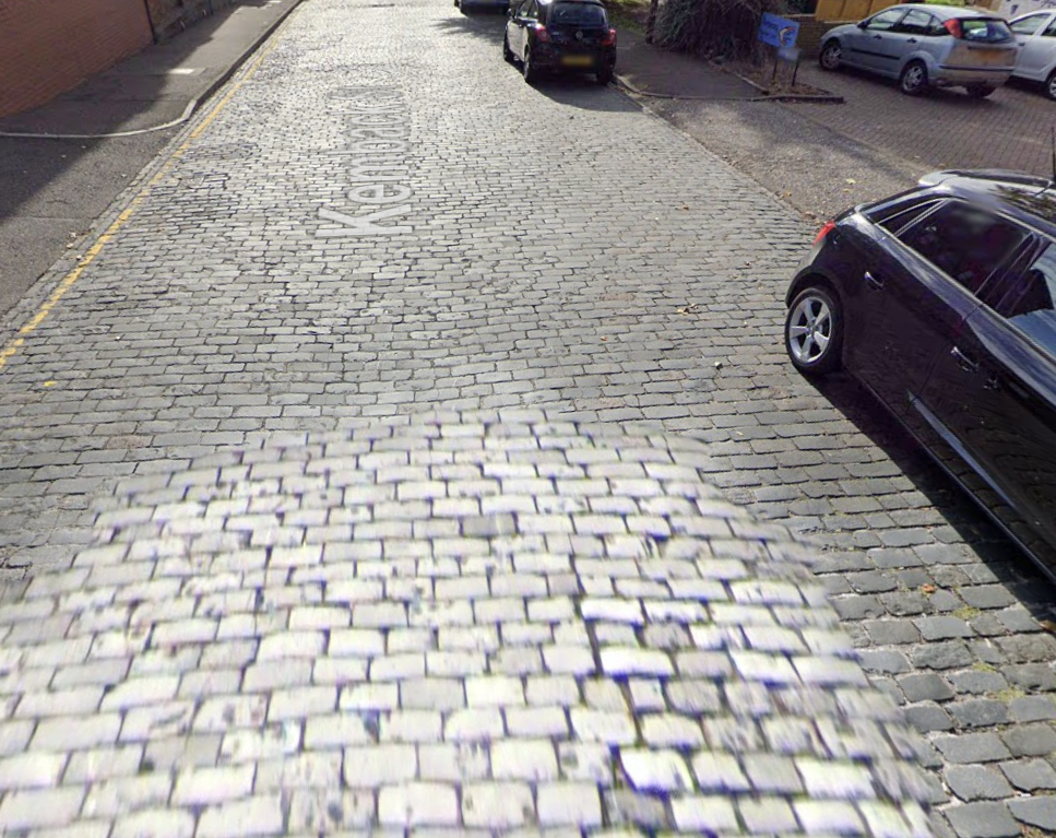

iTurniCar Posted March 9, 2021 Share Posted March 9, 2021 (edited) - Rattling/clunking sound, sounds as if something is 'loose' and about to fall off. A very repetetive sound when it occurs ie. a constant rattle until you're onto a smooth surface... not just one or two clunks. - Most audible at speeds below 30mph, and on rough roads. - Fades away or completely disappears under braking. -------------------------------- I have all the same symptoms - It almost goes away completely when braking, just the odd noise slips in. 'Play Video with volume up' This is when I'm driving on the pictured road 'nice and bumpy'. When the road is smooth .. no noise unless I hit a pothole or something. Is this the sound of a bad banana arm? - The Garage I took it to has checked the suspension etc and said its all fine, nice solid car and can't see anything loose etc. But I read the banana arm goes undetected. Video Link - https://streamable.com/ibiqnj Picture - Edited March 9, 2021 by iTurniCar More info. Quote Link to comment Share on other sites More sharing options...
Stutopia Posted March 9, 2021 Share Posted March 9, 2021 Obvs hard to be certain from a vid but this is not dissimilar to the sound mine made for banana bar. Upon inspection with a pry bar, I was also advised everything was ok, but that a pry can’t always simulate the weight and movement of a heavy car on that kind of surface. I changed them because I knew they would need doing eventually and it cured it. If you can budget for them now and the drop links are definitely fine, I’d just do them. 1 Quote Link to comment Share on other sites More sharing options...
davey_83 Posted March 9, 2021 Share Posted March 9, 2021 Sorry to hear this, does sound really bad and must have been getting worst and worst. If the noise goes away under braking, I would say yes the banana arm/s have worn, either rubber bush side on the body or ball joint at the hub end. 1 Quote Link to comment Share on other sites More sharing options...
ATTAK Z Posted March 9, 2021 Share Posted March 9, 2021 Definitely the B A N A N A B A R (compression rod ball joint end) - a well known problem that can only be fixed by fitting new ones - a £500 fix for both sides to do it properly. ... for some reason the LHS goes first; and yes, it does your head in until it's fixed 1 Quote Link to comment Share on other sites More sharing options...
