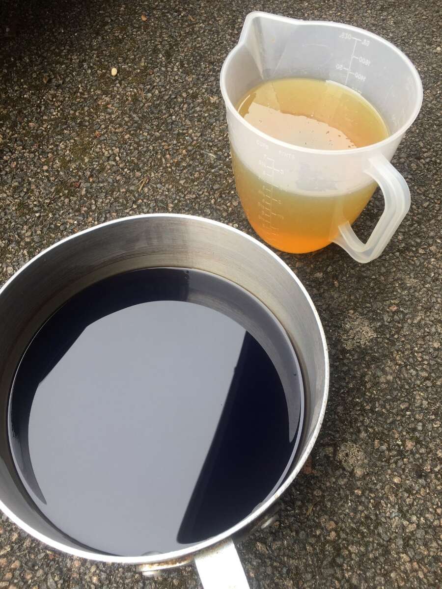

Ps the oil was disgusting smelling, my MRS wasn’t happy stinking out my dinning area but oh well.
