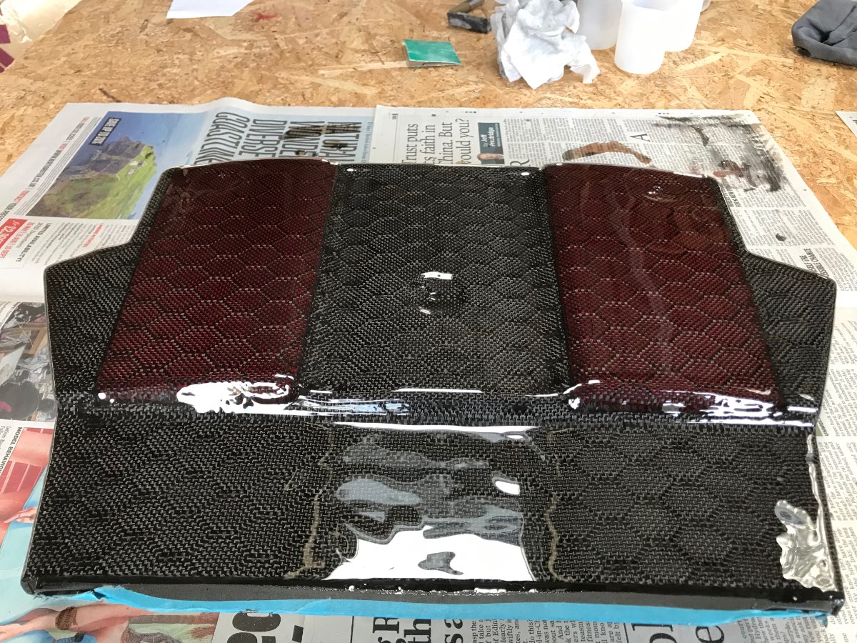

Nino Posted February 1, 2021 Share Posted February 1, 2021 Hi, I’ve had a go at carbon skinning my engine cover, I’ve use a red and black honeycomb fibre. They still need a final rub down and then a clear coat. 2 Quote Link to comment Share on other sites More sharing options...

Nino Posted February 2, 2021 Share Posted February 2, 2021 The red & black engine cover, I carbon skinned myself with carbon fibre fabric. There are companies out there that do it. But I thought I’d have a go myself and I’m pretty pleased with the outcome. I’ll have a go at the interior when I’ve got a bit more time on my hands. I’ve got too many projects on the go for my zed and not enough time, work keeps getting in the way Quote Link to comment Share on other sites More sharing options...
P15UL T Posted February 2, 2021 Share Posted February 2, 2021 On 01/02/2021 at 19:47, Nino said: Hi, I’ve had a go at carbon skinning my engine cover, I’ve use a red and black honeycomb fibre. They still need a final rub down and then a clear coat. Expand That looks awesome. Did you post cure it to withstand the temps? Quote Link to comment Share on other sites More sharing options...
Nino Posted February 3, 2021 Share Posted February 3, 2021 On 02/02/2021 at 23:07, P15UL T said: That looks awesome. Did you post cure it to withstand the temps? Expand Hi, no I didn’t post cure it. It’s just a wet lay up and left to cure a room temp. The heat from the engine shouldn’t be excessive enough to cause a problem. Fingers crossed Quote Link to comment Share on other sites More sharing options...
TheOracle71 Posted February 4, 2021 Share Posted February 4, 2021 On 02/02/2021 at 23:07, P15UL T said: That looks awesome. Did you post cure it to withstand the temps? Expand That honey comb pattern looks lovely. Please could you post a link where it may be purchased? I’m sure I read somewhere you used lacquer from Halfords but can’t see that post now. I’m thinking of having a go myself at some carbon wrapping but before I do I’m trawling the forum for posts, guides links etc and learning by watching YouTube guides. Quote Link to comment Share on other sites More sharing options...
Nino Posted February 4, 2021 Share Posted February 4, 2021 On 04/02/2021 at 13:34, TheOracle71 said: That honey comb pattern looks lovely. Please could you post a link where it may be purchased? I’m sure I read somewhere you used lacquer from Halfords but can’t see that post now. I’m thinking of having a go myself at some carbon wrapping but before I do I’m trawling the forum for posts, guides links etc and learning by watching YouTube guides. Expand Hi, this is the epoxy resin I used. https://www.easycomposites.co.uk/carbon-fibre-skinning-starter-kit They also have some good videos showing you how to use their product, on the site. There are also plenty of YouTube videos on carbon skinning. I’ve not heard of anyone using a lacquer for this. It’s only use would be as a final clear coat. The carbon fibre I bought from eBay, but there are loads of places to purchase it from. 1 Quote Link to comment Share on other sites More sharing options...
