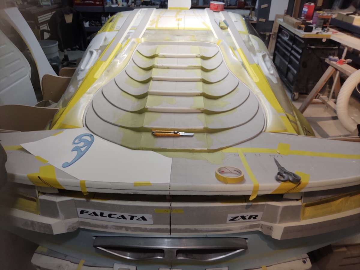

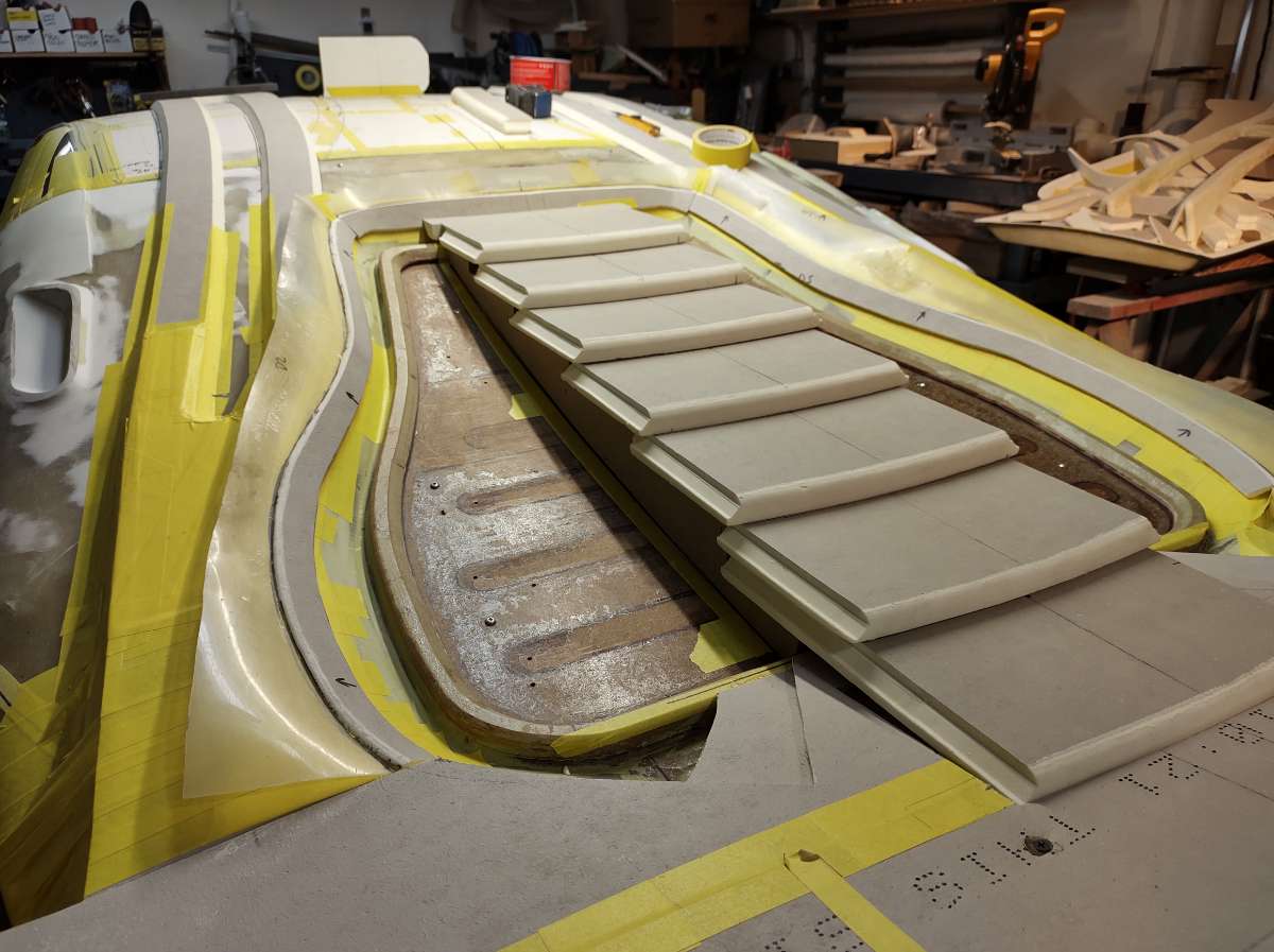

Been busy it seems to me , I know I built a mock up trunk to build the trunk and make it function off the car but it's hard to know if it looks right off the car , so I have been doing some mock up stuff .

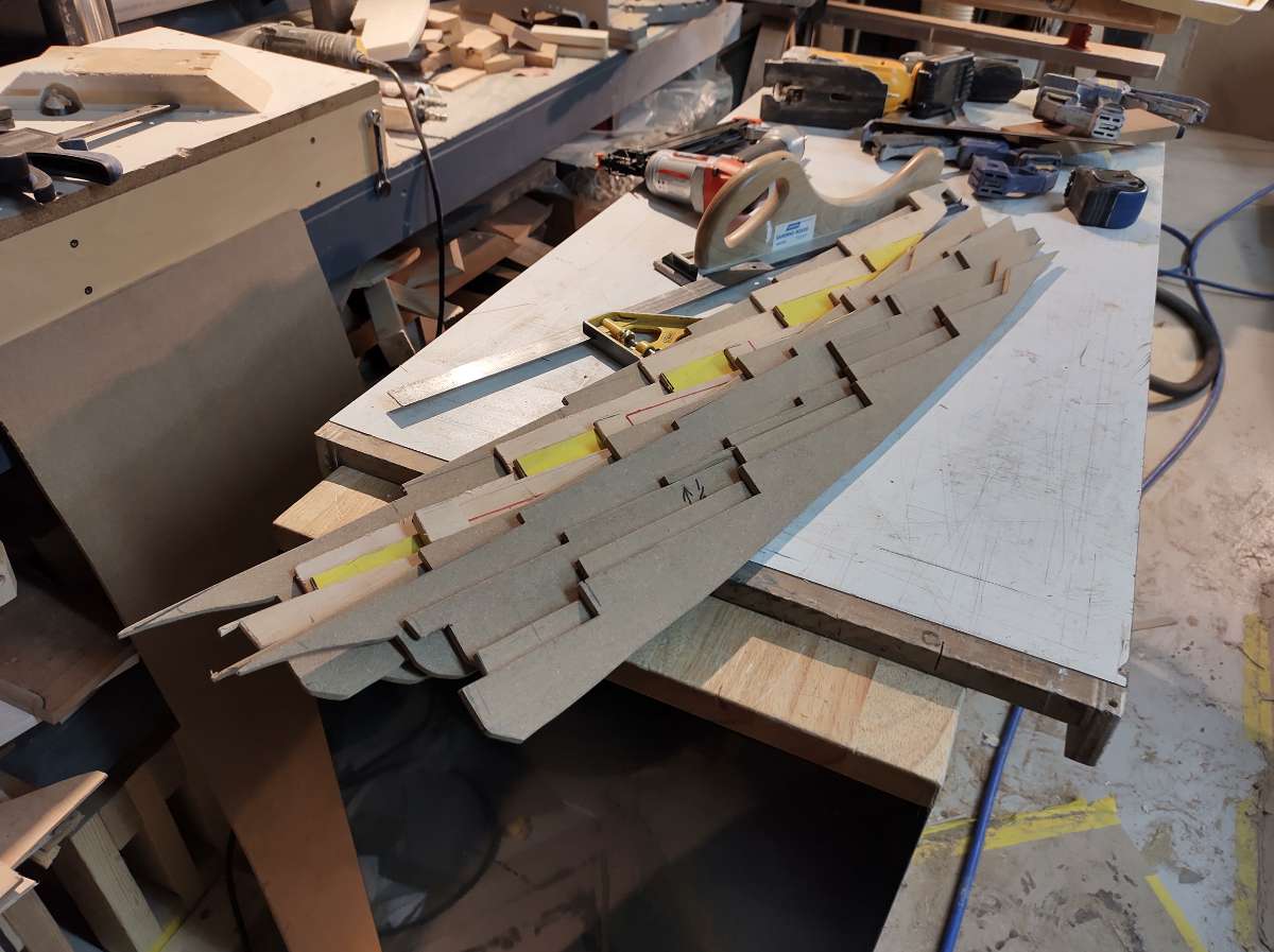

My original plan was to make each louver in one piece , it is too difficult , so this is what I am thinking .
This was the original idea ......

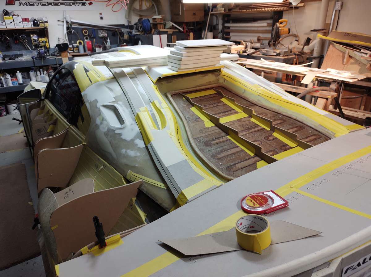

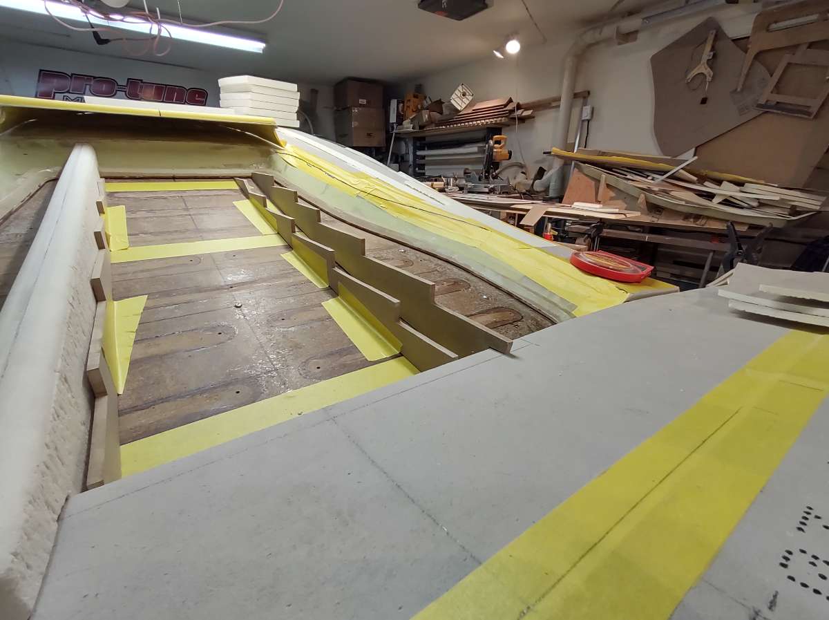

Made up some parts

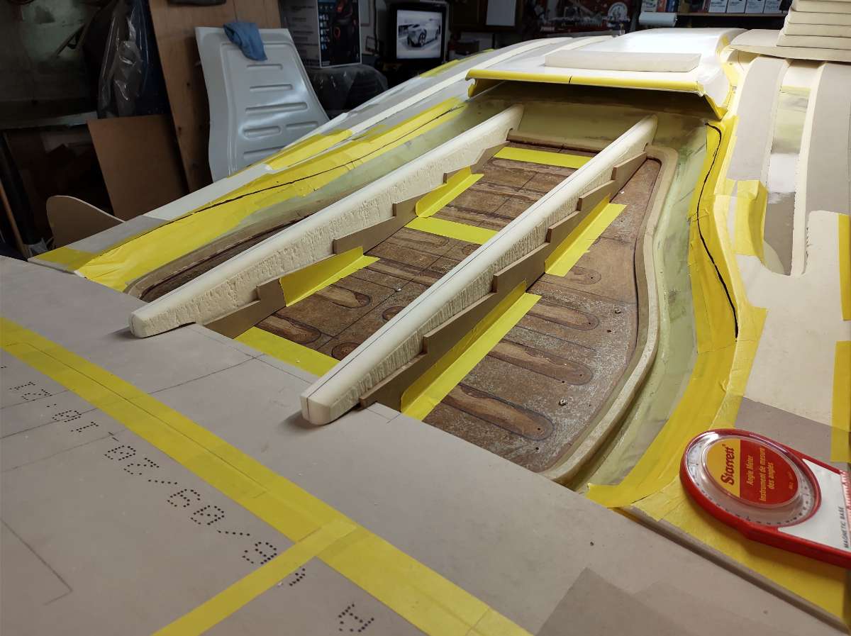

And a couple of stringers to lay the louvers on
It requires a stringer for the center louvers and a second one for outside the divider at a different scale because they are thinner , thinner to be able to have some contour .
The center going in , this is just a mock up , if I don't like it i will change it .
So you have to have some imagination here to see this all body worked .

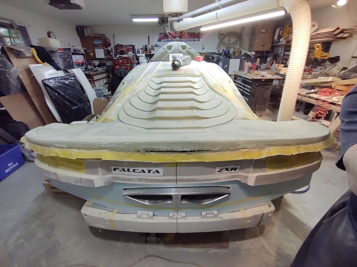

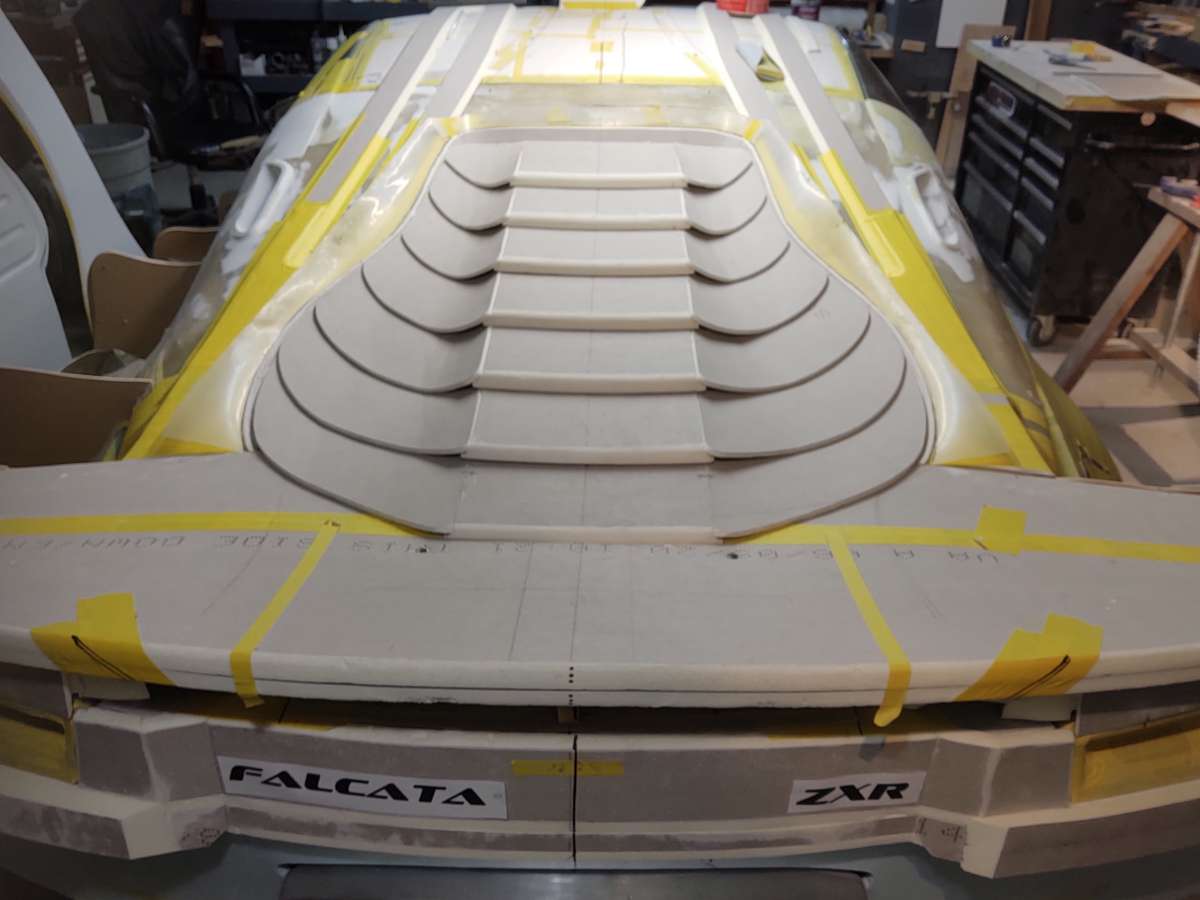

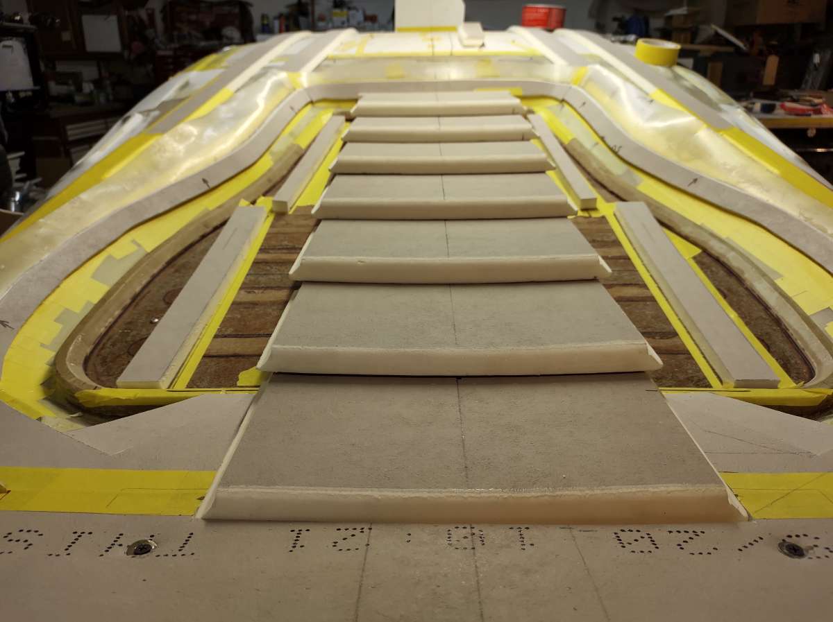

Well I didn't like the bars going down the middle , and it would be a nightmare to sand .
So I came up with an idea to make my original idea work , of course I had to make all new pieces ....
It's getting there  , the plan is to lay up a few thin layers of fiberglass mat and then cut the part where the trunk lid opens . then I can finish the trunk lid off the car with the mock up
rear body part I made for that purpose , I know it's all a bit confusing .
So hang in there !!!
This is how many times I tried different ratios of height and length to get what I thought was right , just like CAD ( computer assisted drawing ) only WAD  wood assisted drawing
LOL LOL
Just the top to sort out and then filler and fiberglass

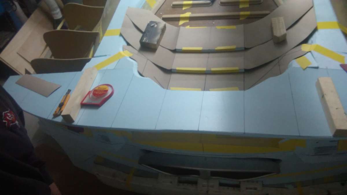

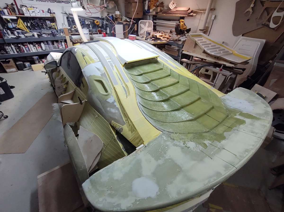

Fist couple of pics finishing the foam at the top and filling in the gaps .
I tried this for the first time yesterday , it's known as Rondo a mixture of Fiberglass Resin and body filler Bondo , blend and you get Rondo .
It helps to seal the foam for easier fairing ,sanding , filling and fiber glassing .
Seemed to go well , will know later today .

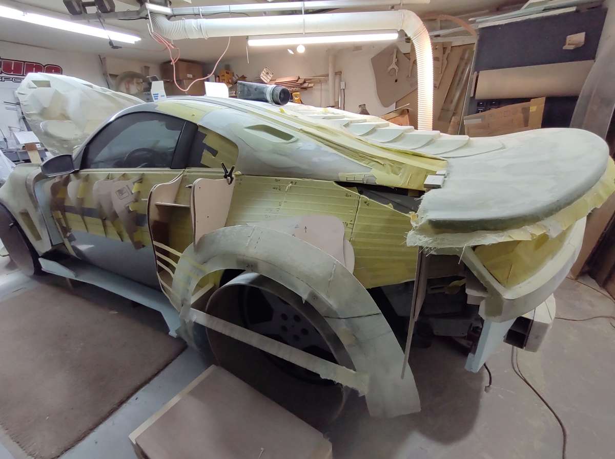

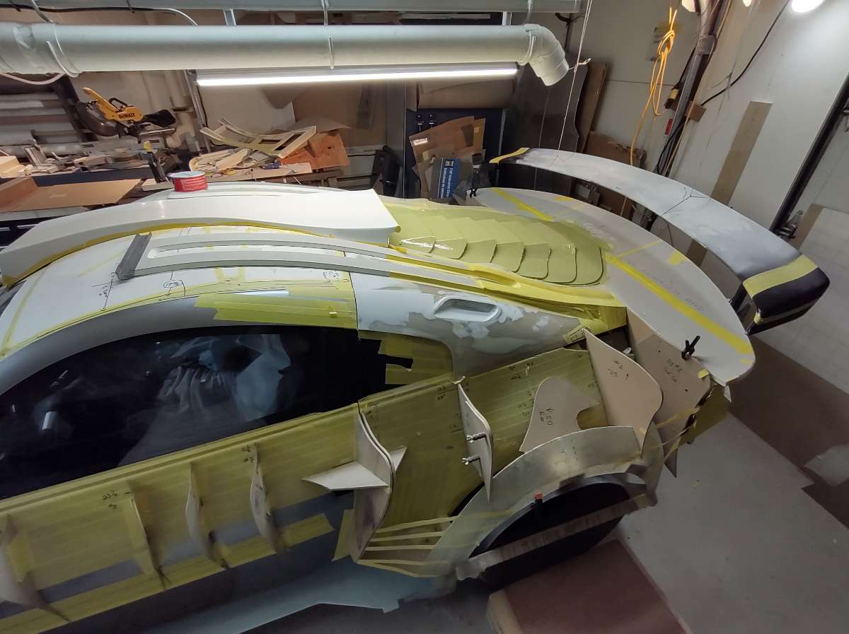

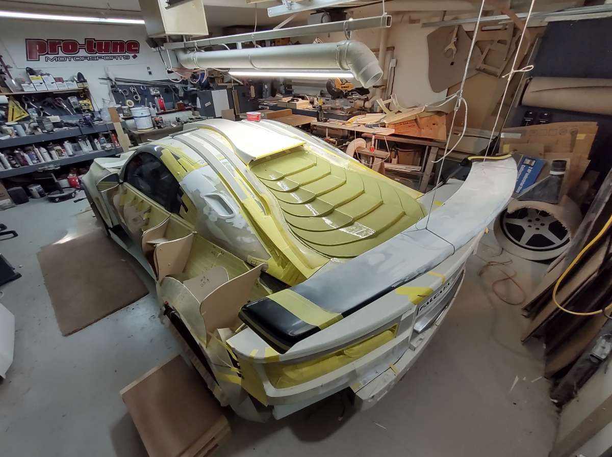

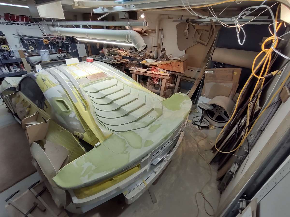

I set the roof scoop on and hung up the wing to see how it was coming together

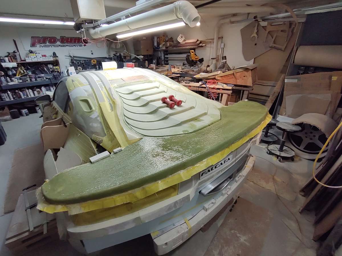

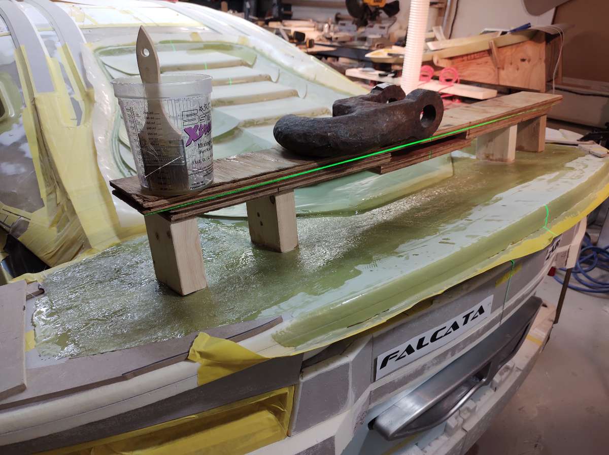

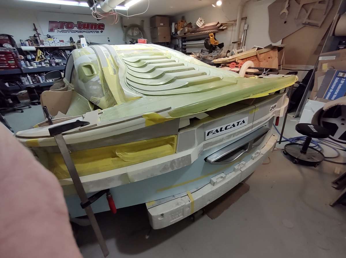

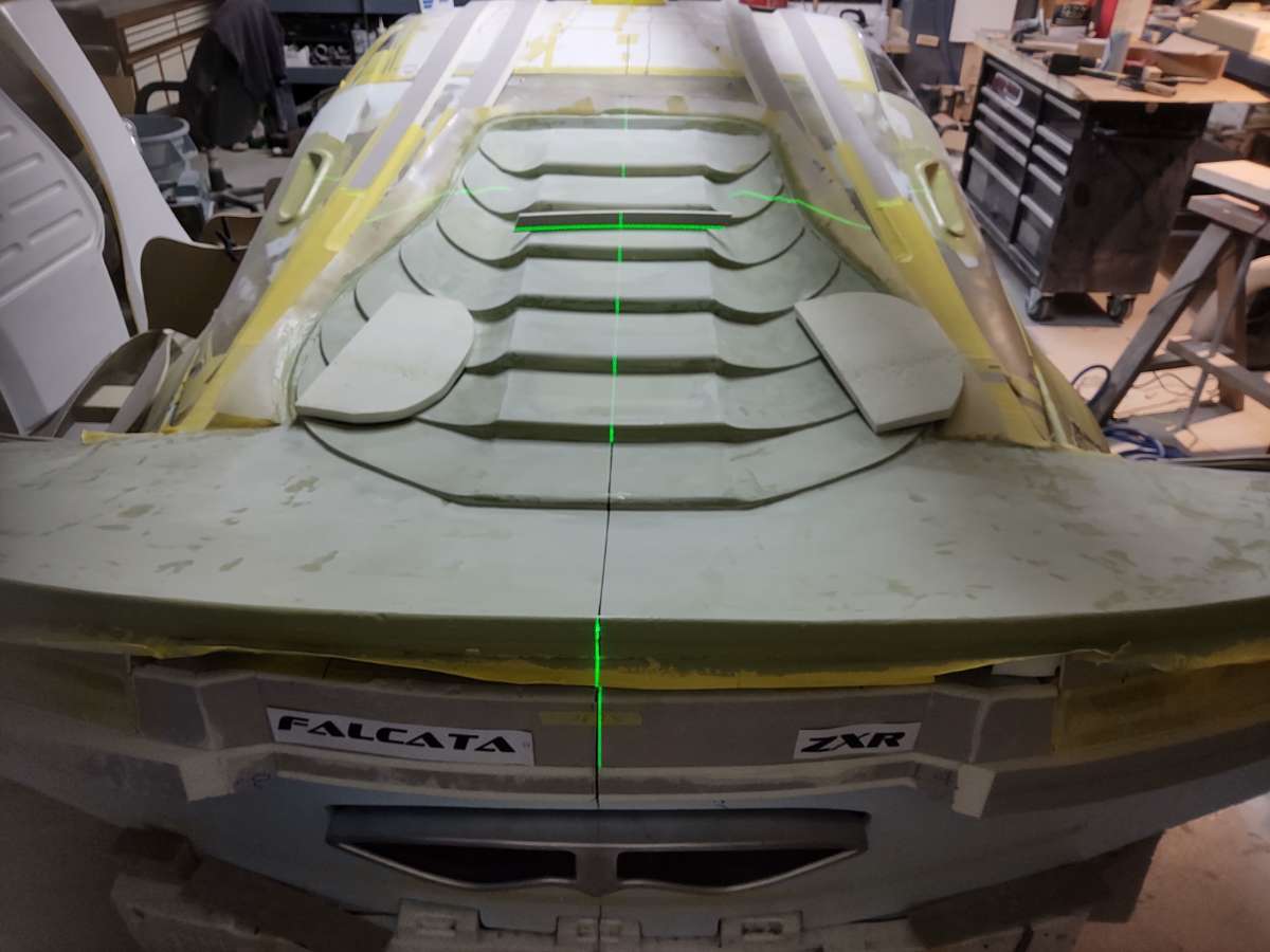

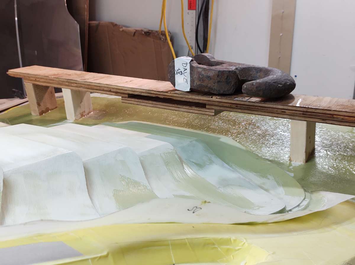

Some more on the the rear deck lid .
After clamping down the back and a coat of Rondo on the deck area  , I discovered a bump on both sides where it should be dipping down .in the deck  , there is no way to hold it down , so I came up with a way to hold it in place .
Then a couple of layers of fiberglass mat .
I used the laser to make sure it was even on both sides , the two inner boards are shorter to help make the contour I was looking for .
I call my helper Dave .........maybe I have been in the forest too long lol
Here you can see the shape is looking sweet
Another coat of Rondo  , helps to hold and seal the foam .
Next is to fill the rises in the hips of the quarters .
Here you see two pieces of foam laying on the louvers , they will get glued down and shaped to fill the low spot .

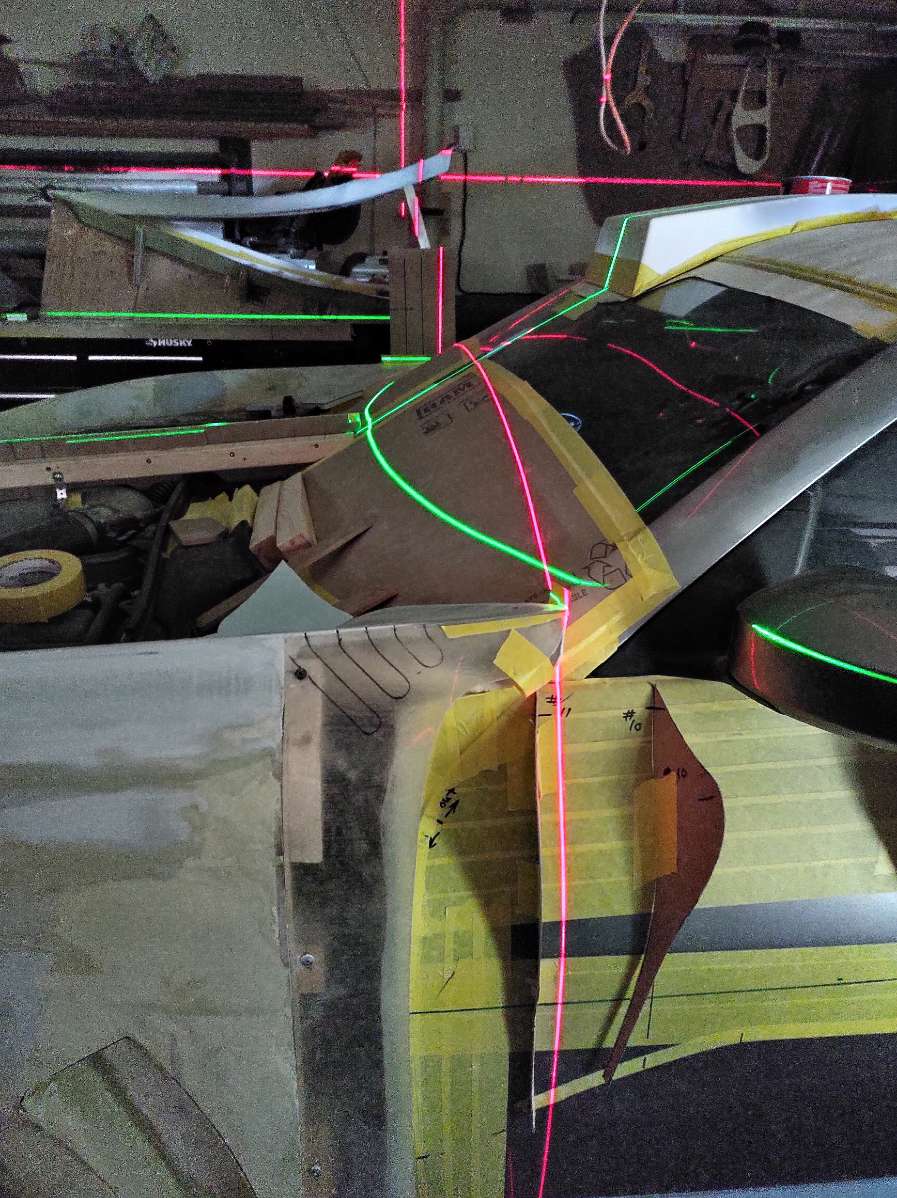

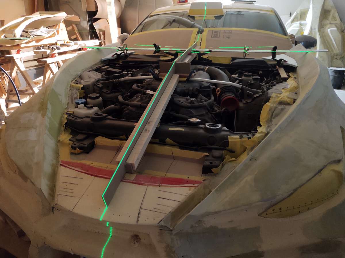

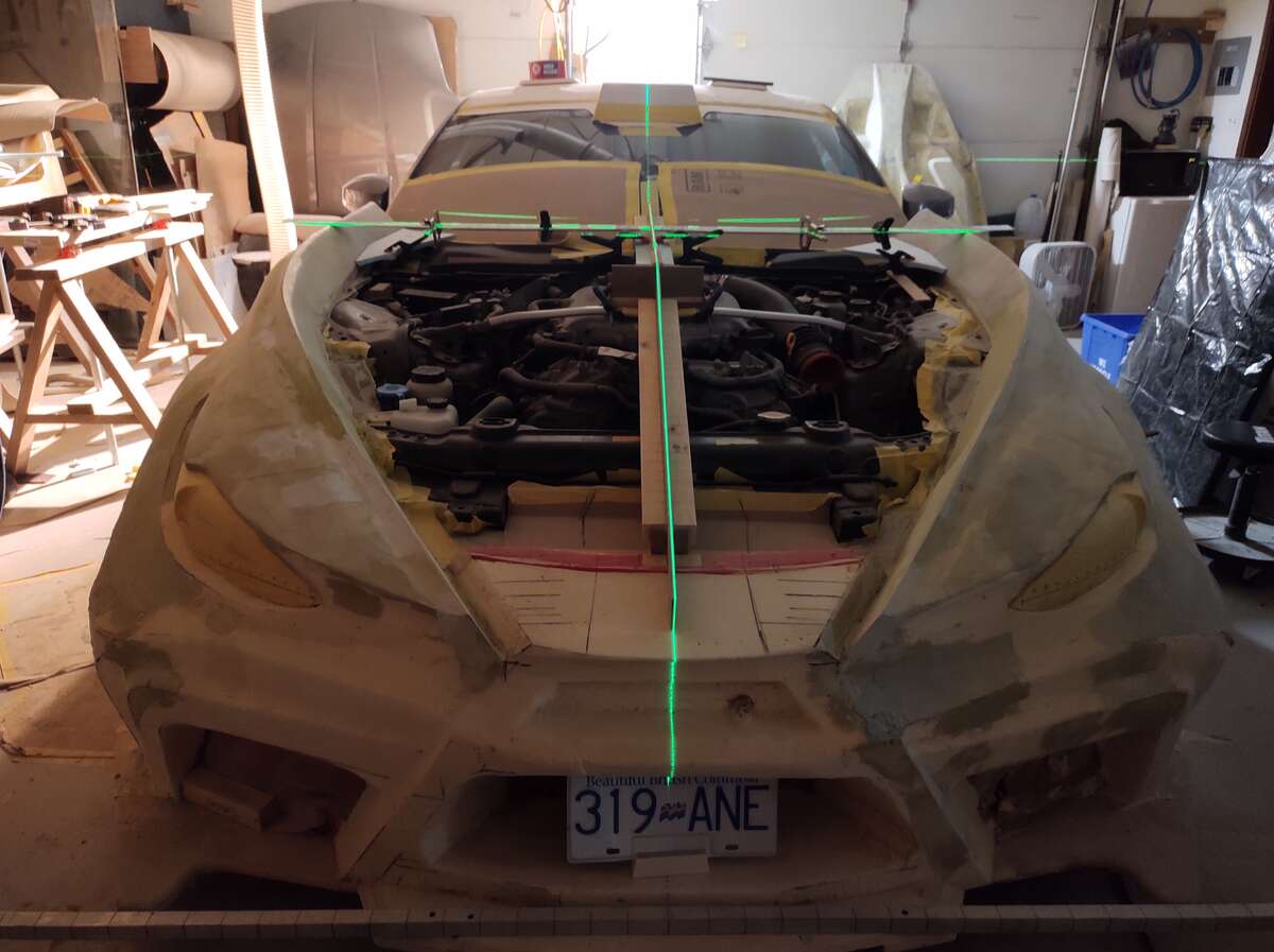

with calibration posts I made for the front of the car , I am double checking the height of the fender bucks with the laser to insure they are level
Here you see the foam glued down and a coat of rondo , this will get some filler and shaped .
next will be laying out the cut lines for the opening of the trunk lid .

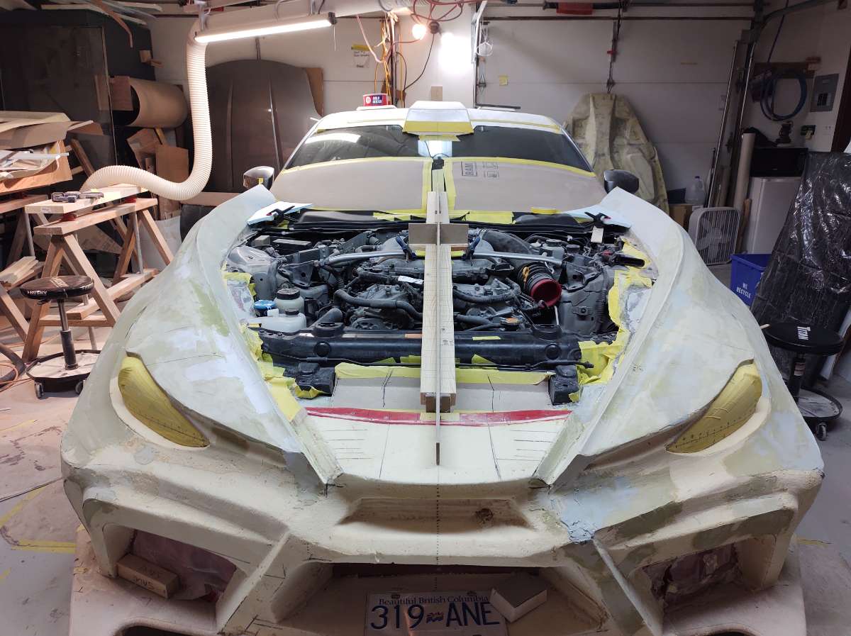

I have an update , I jumped back on the front of the car , been busy with everything really .

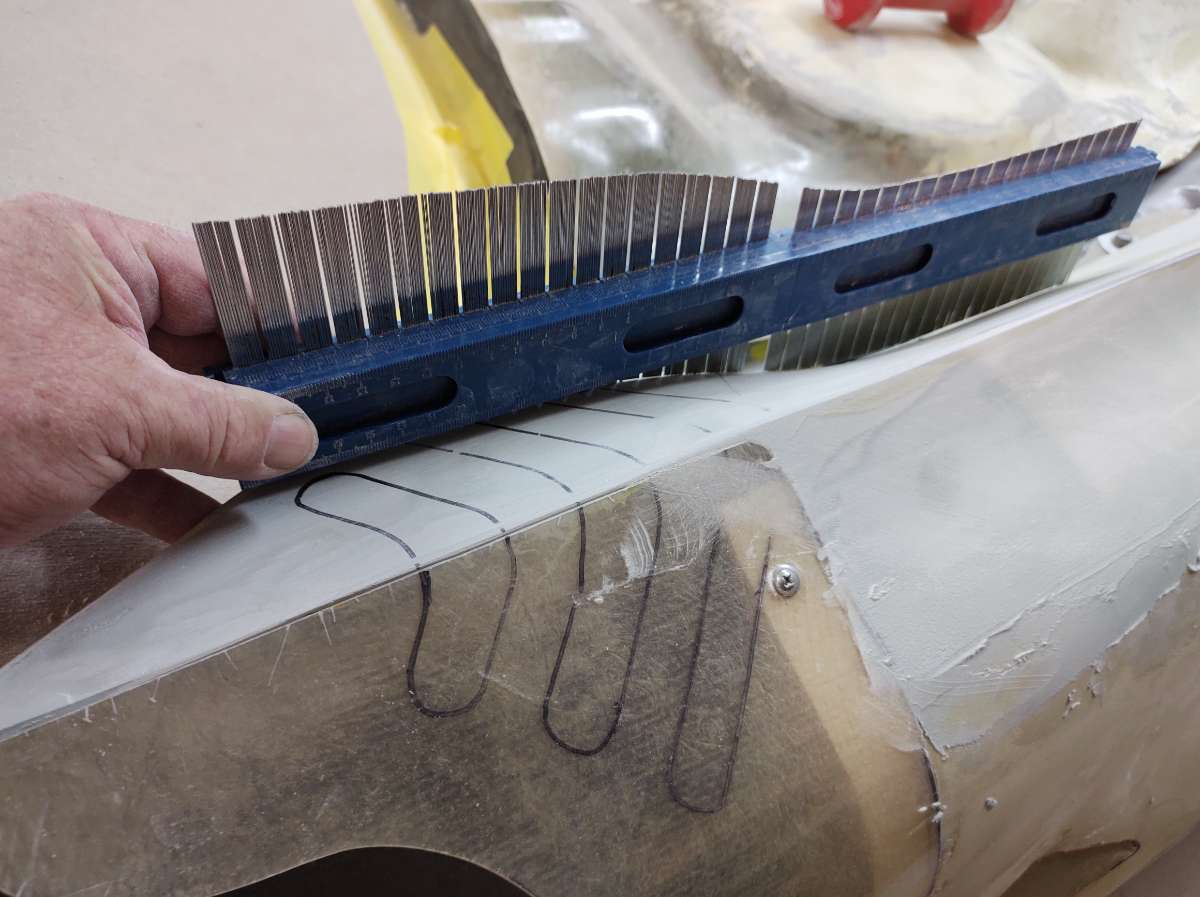

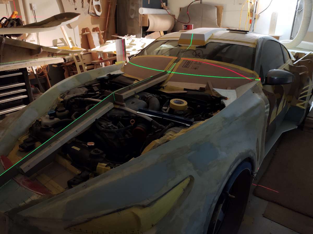

So I built a system for measuring the front fenders , so I have been tuning up the fenders to get them equal in height , width and inside angle .
So next will be dialing in the rest of the front and painting it with Rondo then fiberglass it , then put the bottom part of the hood back on and finish the edges of it so I can make the top part of the hood .

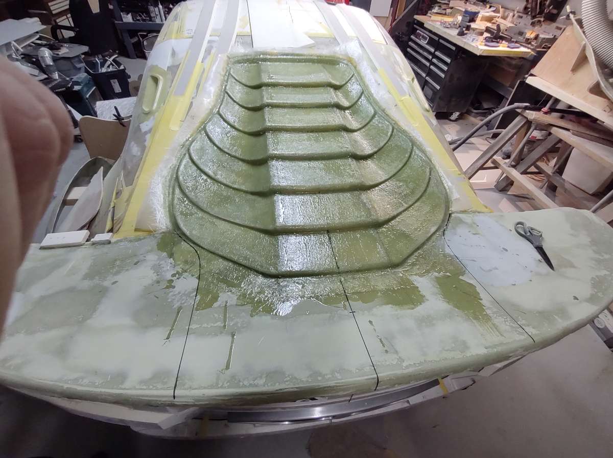

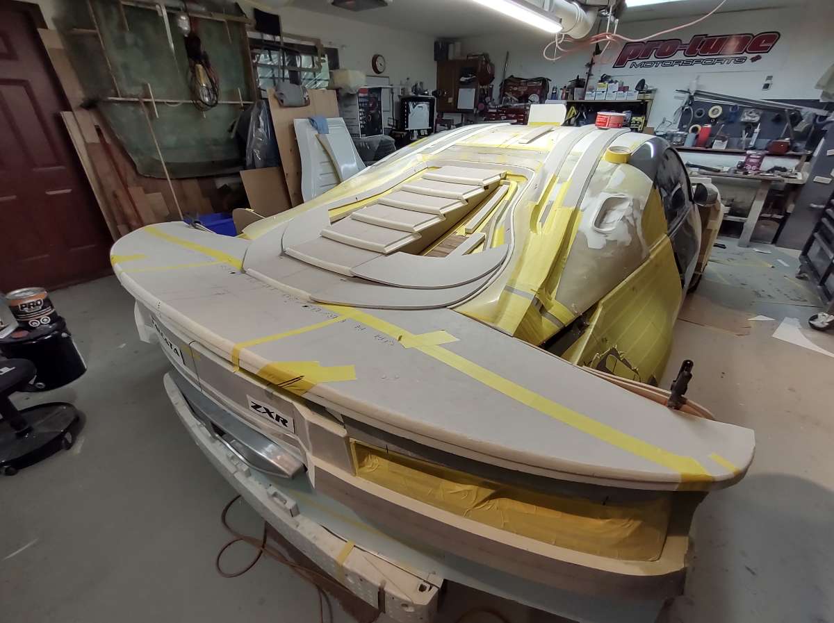

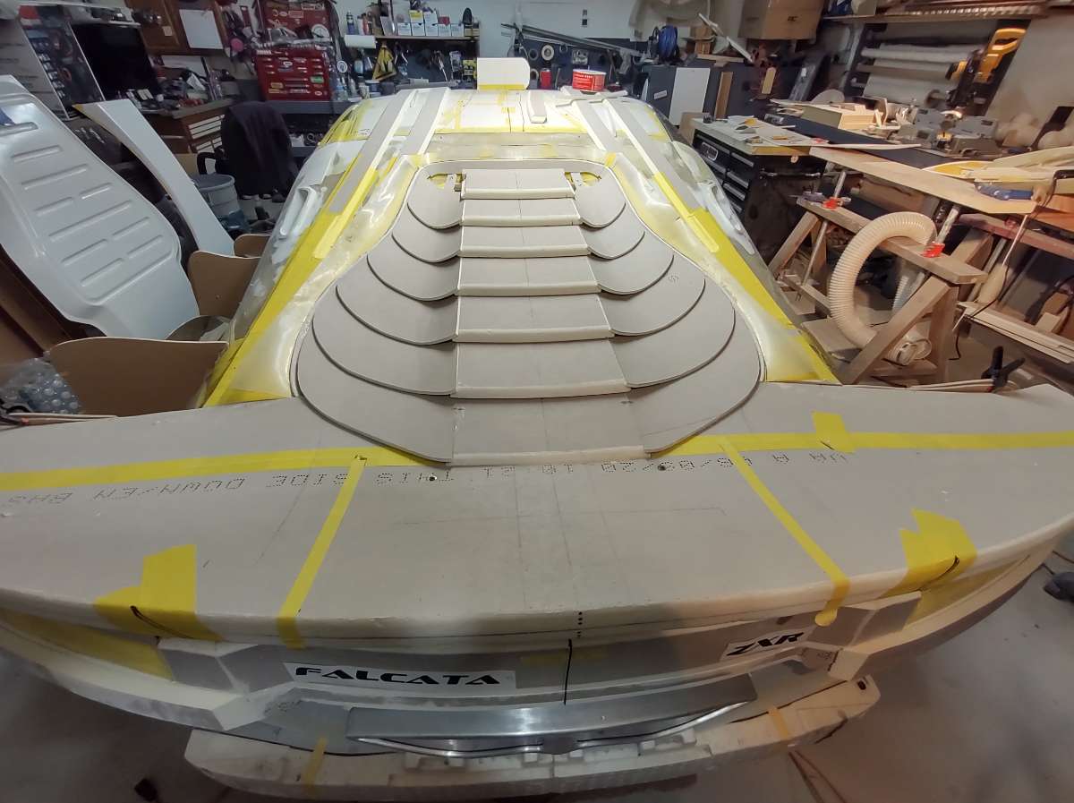

Back with another update , more pic's and progress on the rear deck lid .
Getting the foam shaped and filled
Glassing , a couple of layers of mat to give it some strength
Sanding and a quick fill and sand .

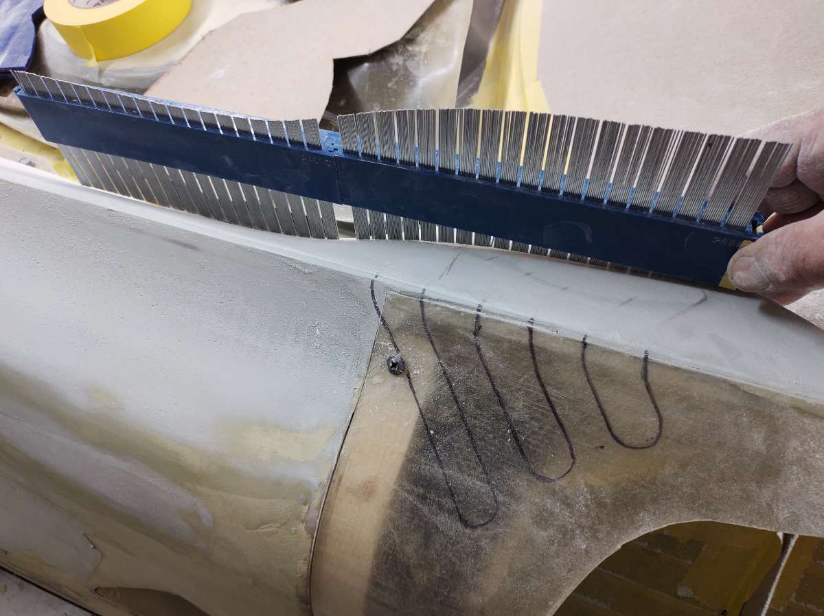

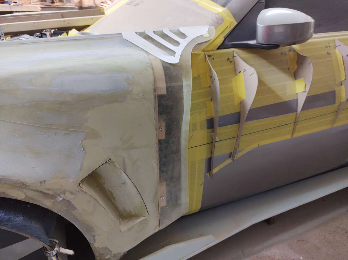

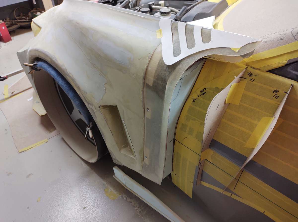

and some more on the front fenders , they are shaping up nicely .

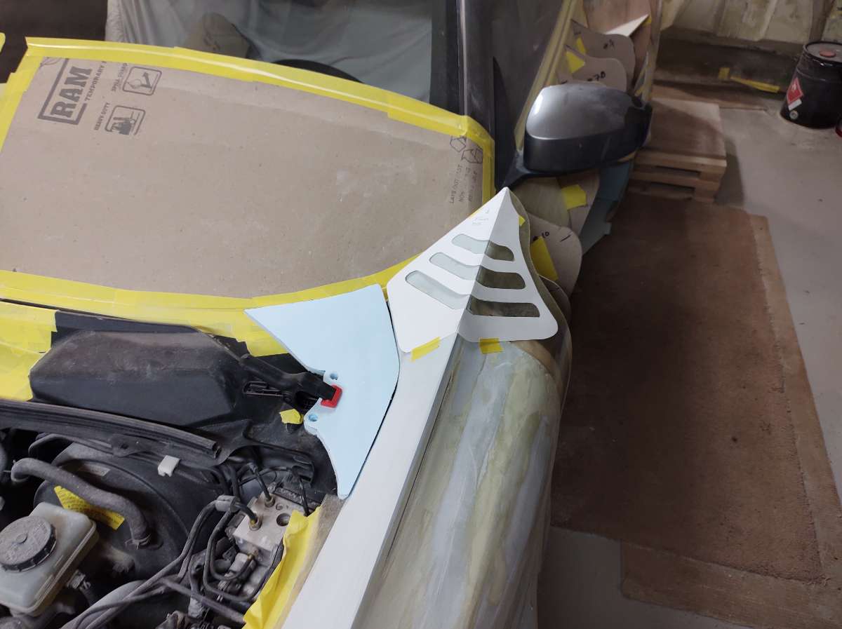

There will be a vent here at the top to let the air from the front splitter escape that get trapped in the wheel well  .
Making the pattern
You will be able to see it from inside the car also

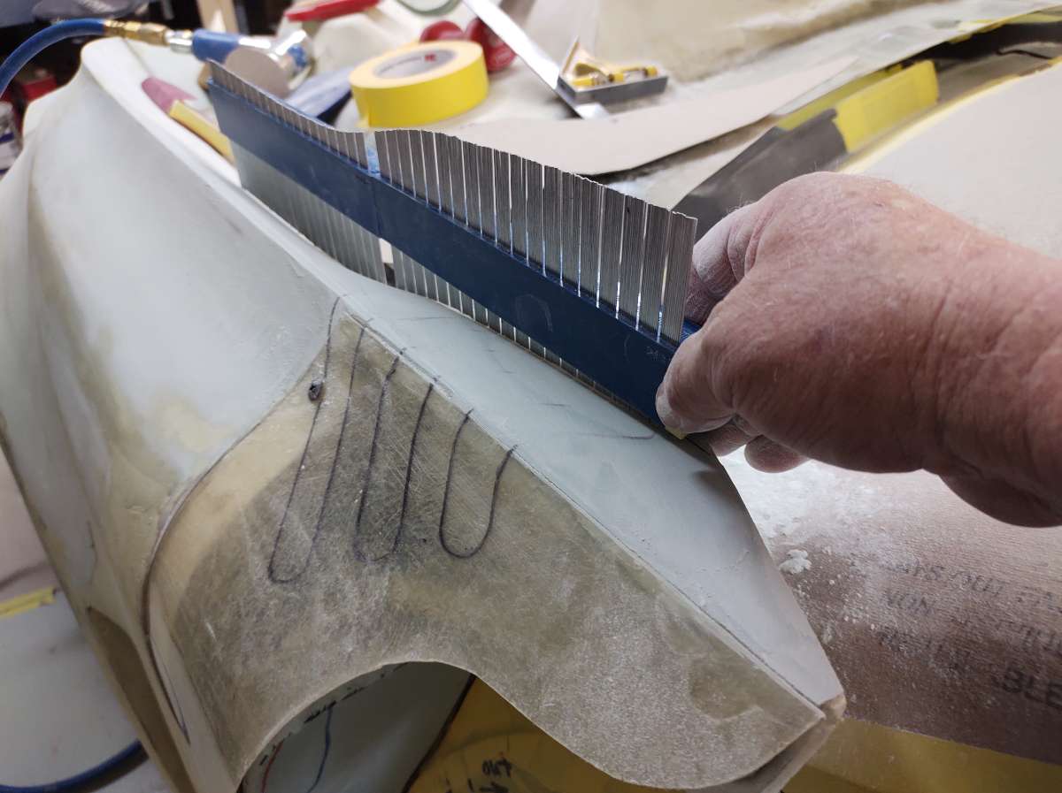

A small update on the front fenders
The top of the fender have so much shape , this was really difficult to get them the same .
Making sure things stay symmetrical
This is the top of the hood line , it will step up to hide the wipers ... you will see soon .
Here you can see the shape at the top , this will give me room for the door to open and have the fender vent protruding down into the fender , as well as looking hot !!
and the passenger side
Really starting to come together .

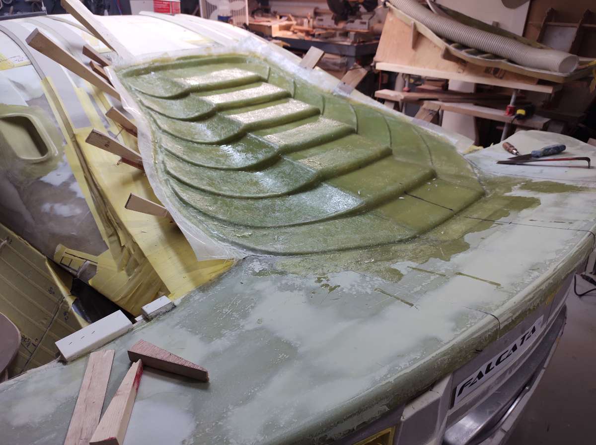

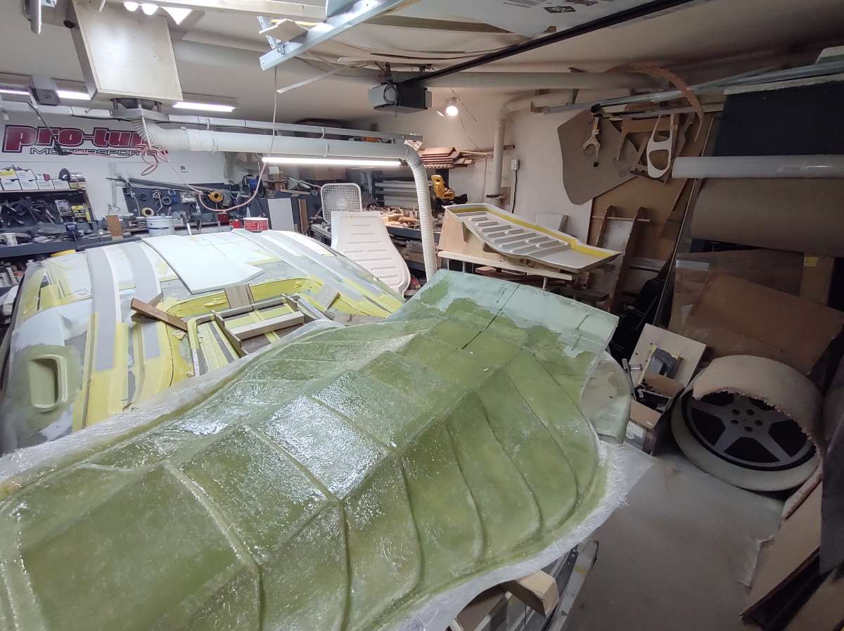

also got the trunk lid glassed and off the back of the car and rough trimmed .
glassed the louvers
cut the opening lines on the back
and using wedges to carefully bust it out
got it free
now it needs to be trimmed , remove and clean up the temporary structure
this is the lid upside down for trimming the edges
back on the car for a look
this gives you an idea of what it will look open
this shows the lines of the opening
