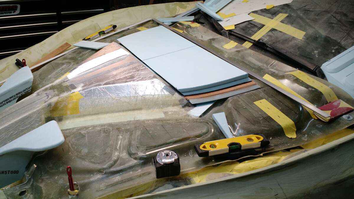

More work on the bottom half of the hood , got one unit of glass on it and a skim of Rage Gold filler .
Still more to add the this part , the sides where it meets the fenders and the top at the windscreen , I would like ti to hide the wipers .

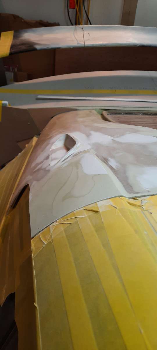

Ok got some stuff done on the car , crazy week , my wife is having a knee replacement tomorrow , so been super busy getting thing ready for her recovery .

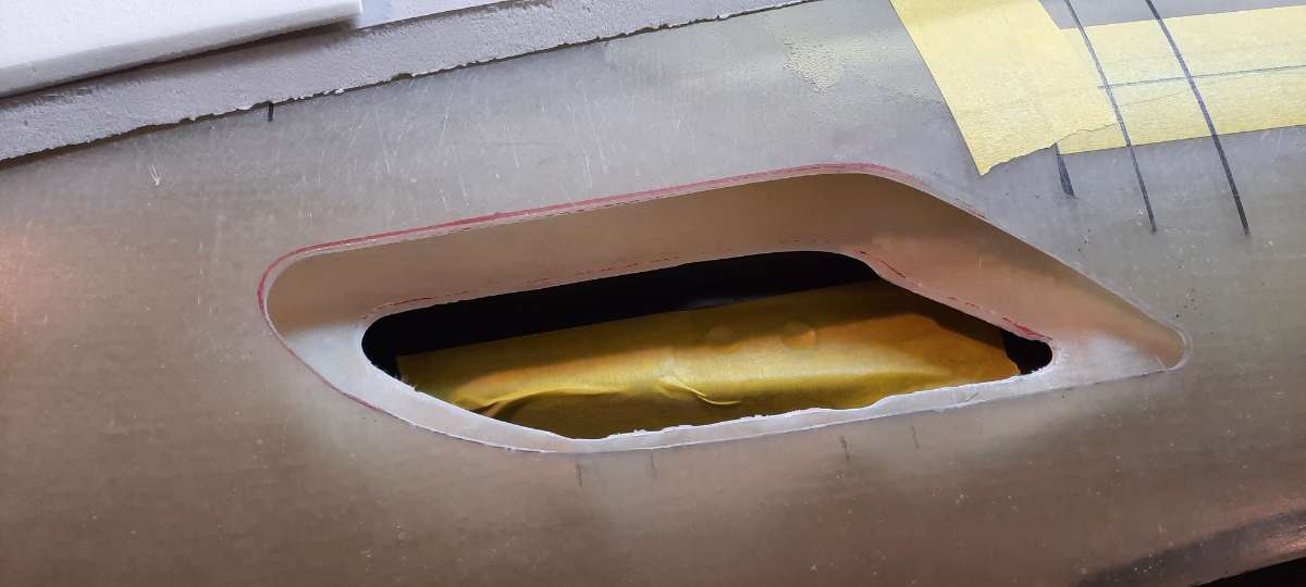

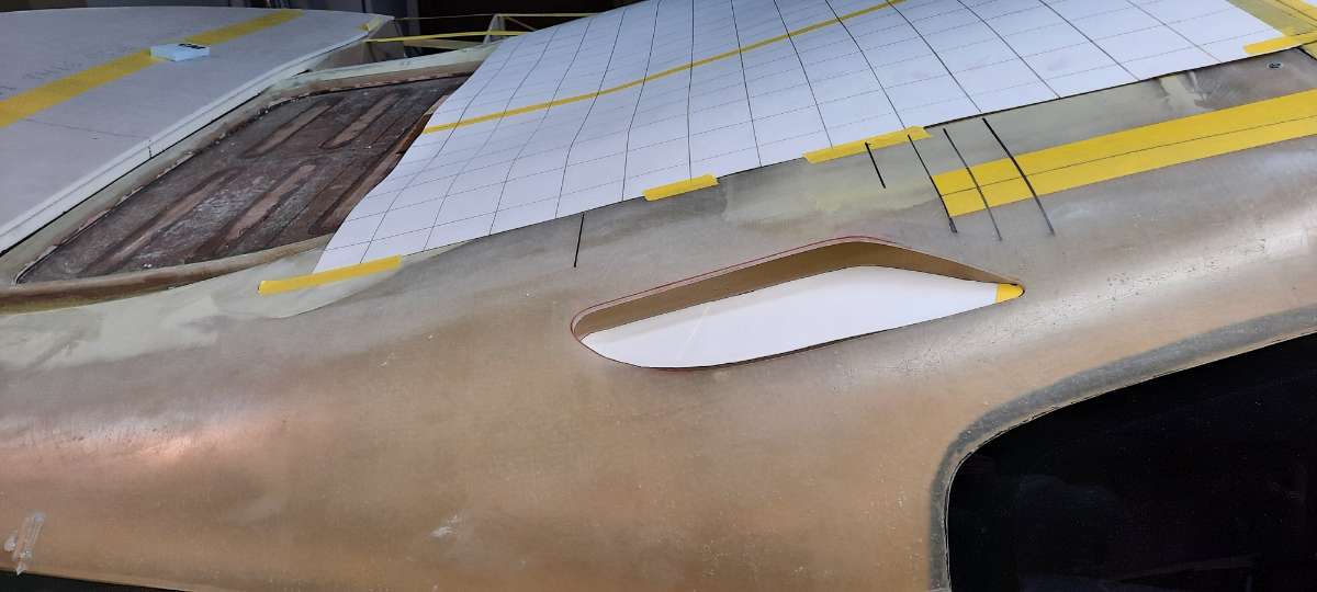

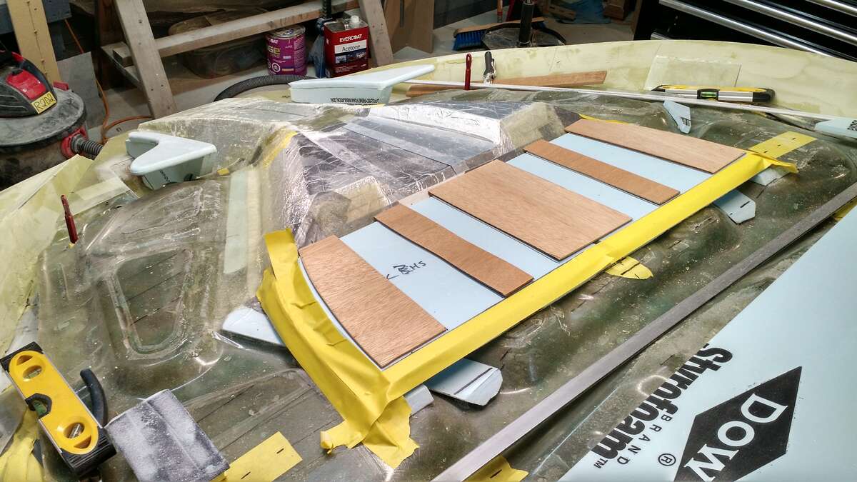

So I think I mentioned the way I will be attaching the rear clamshell .
Originally I was going to use the original hatch hinges , but thought that would be too difficult to access .
Now I am going to use the rear strut mounting holes , and would like to disguise them by creating a foe vent .
So next will be to fill these with foam and contour to the yellow tape

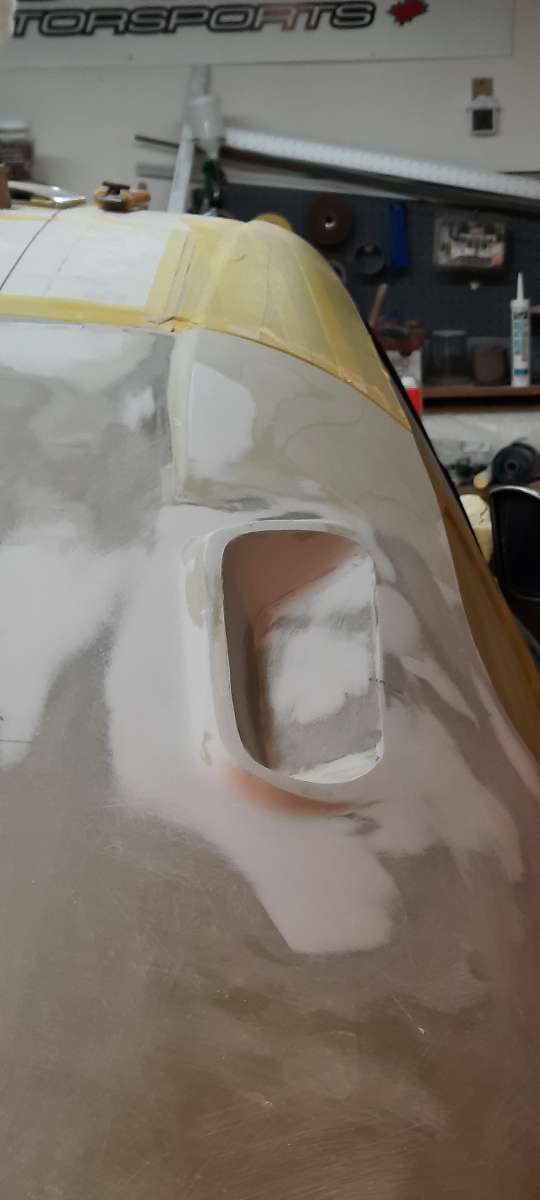

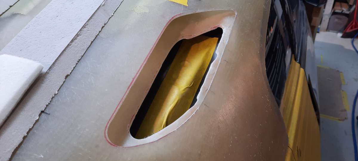

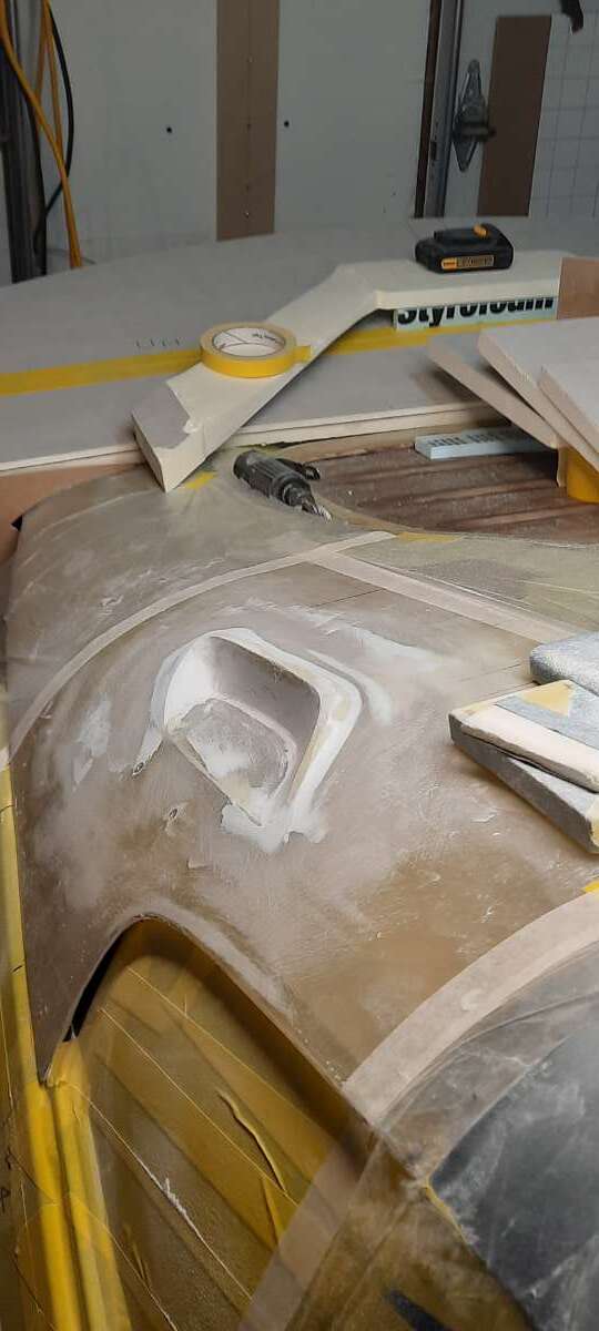

Well been busy looking after my wife , probably a couple more days before I get to my other shop , I have been doing some stuff for the build at my home shop on the milling machine making a mold out of aluminum for the front turn signals .

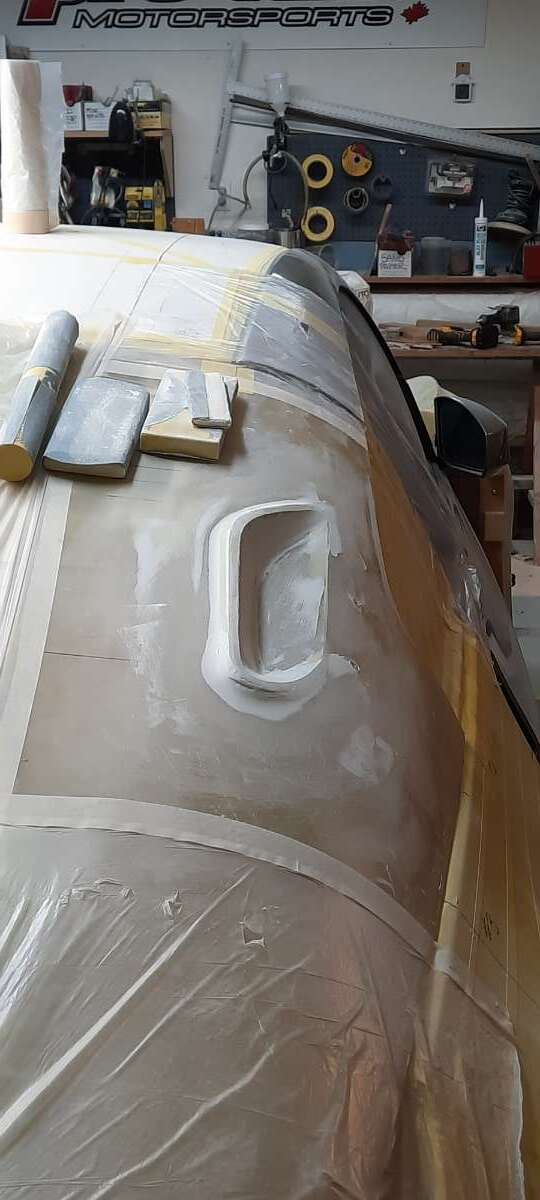

Here is the last pic's of the vent foamed and roughed in
  • Like 3

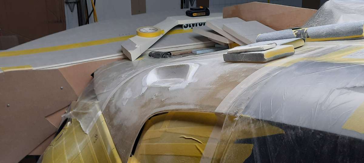

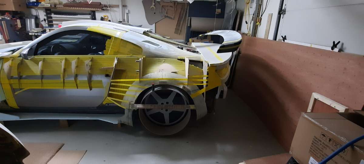

So just some more filling and sanding on the rear deck vents .

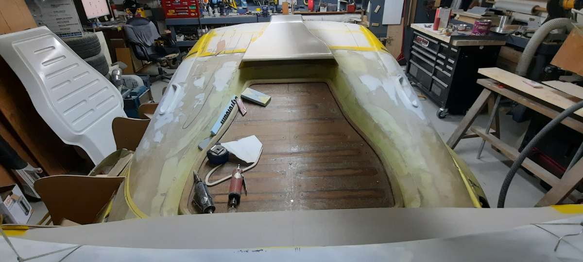

Hi guys & gals
Been a while , must be getting old almost forgot how to post stuff on here lol .
I have missed some time from the car ( obliviously ) you know the usual stuff in the forest on an Island , power outages from wind storms and freak snow storms , life etc .

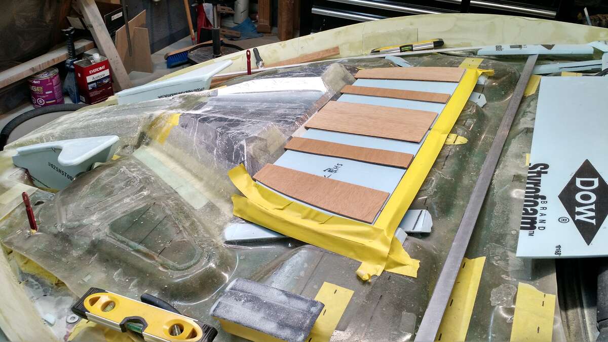

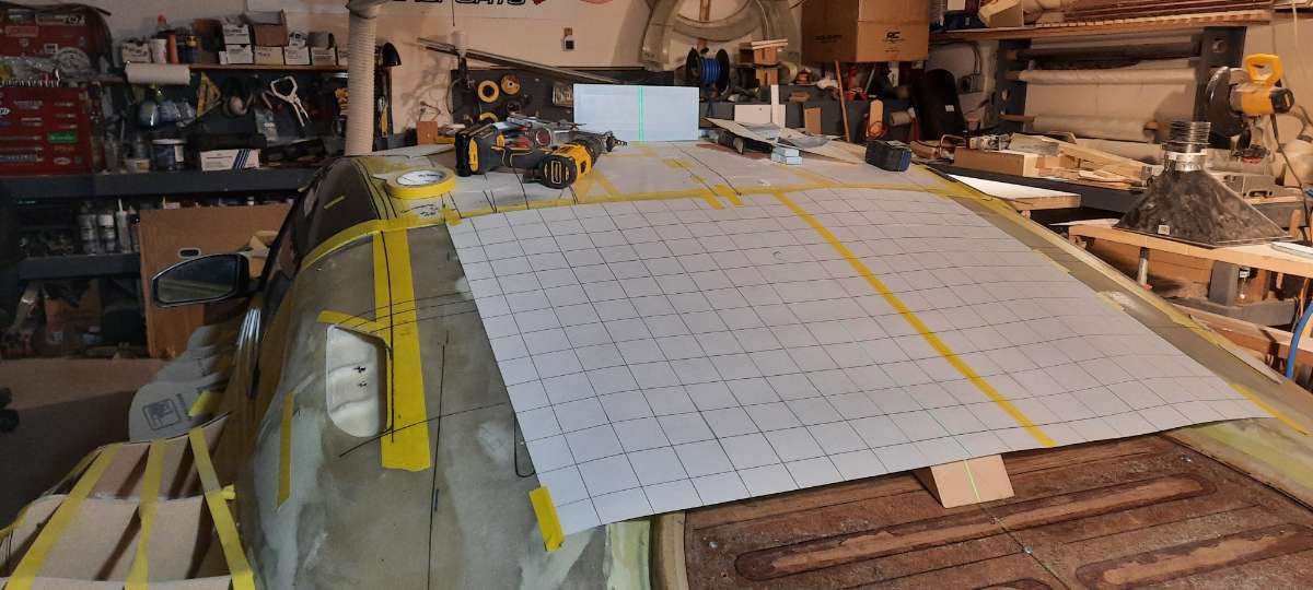

So I have been plugging away at the rear deck lid fake vents and prepping the roof scoop mounting . the roof will have a small foam frame that will be part of the roof to position and fasten the scoop .
I will try to post more this weekend
Cheers
  • Like 6

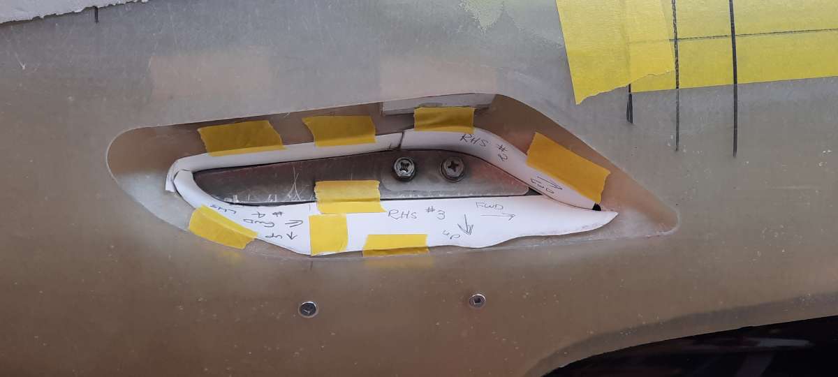

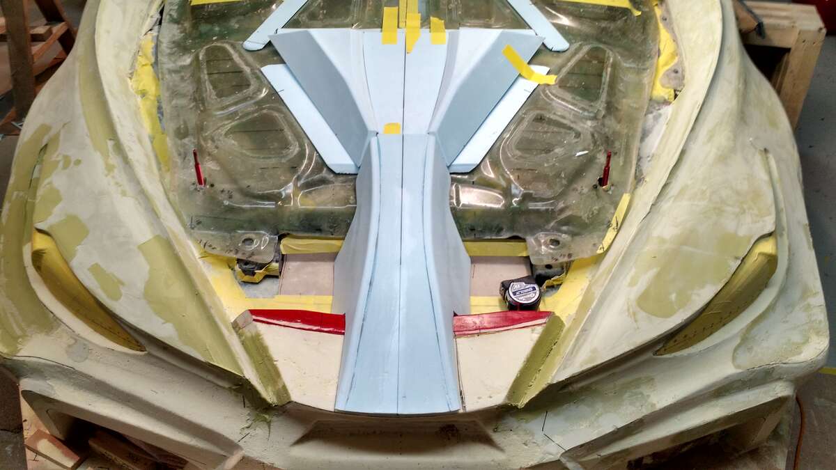

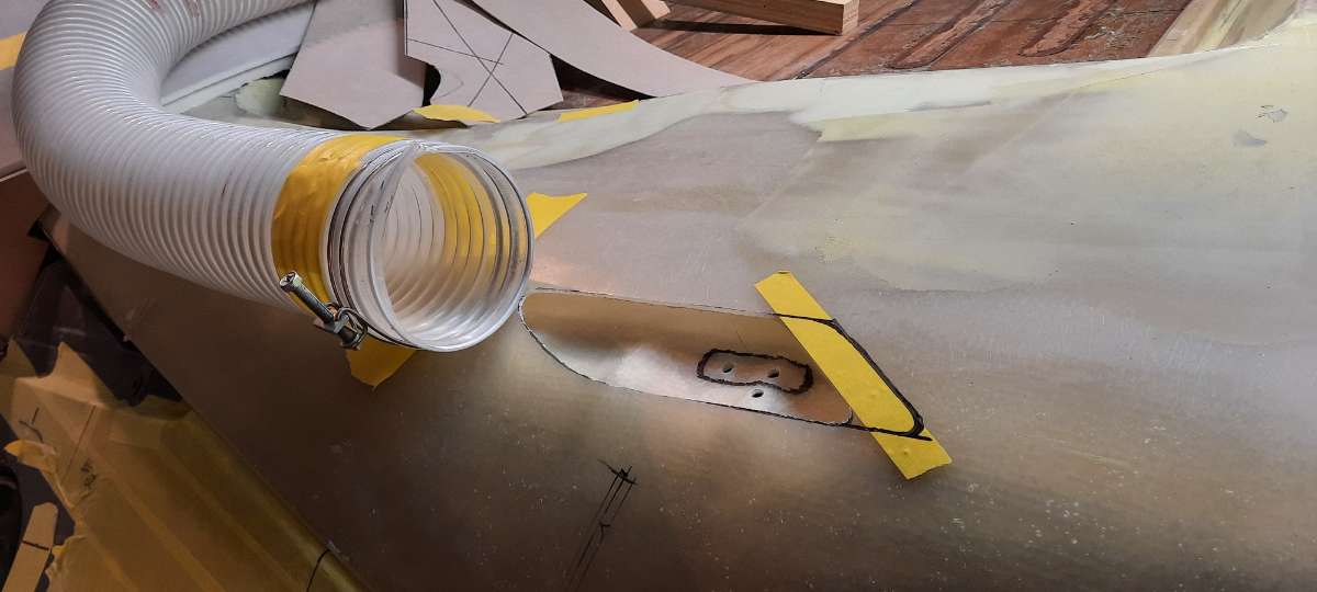

Hi

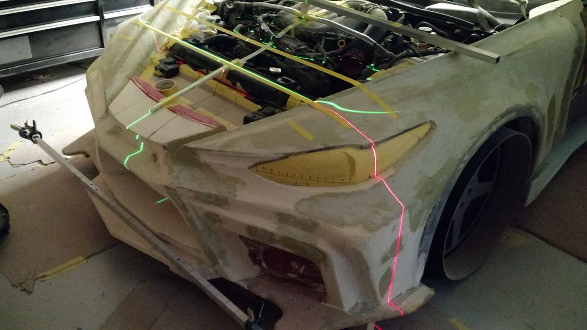

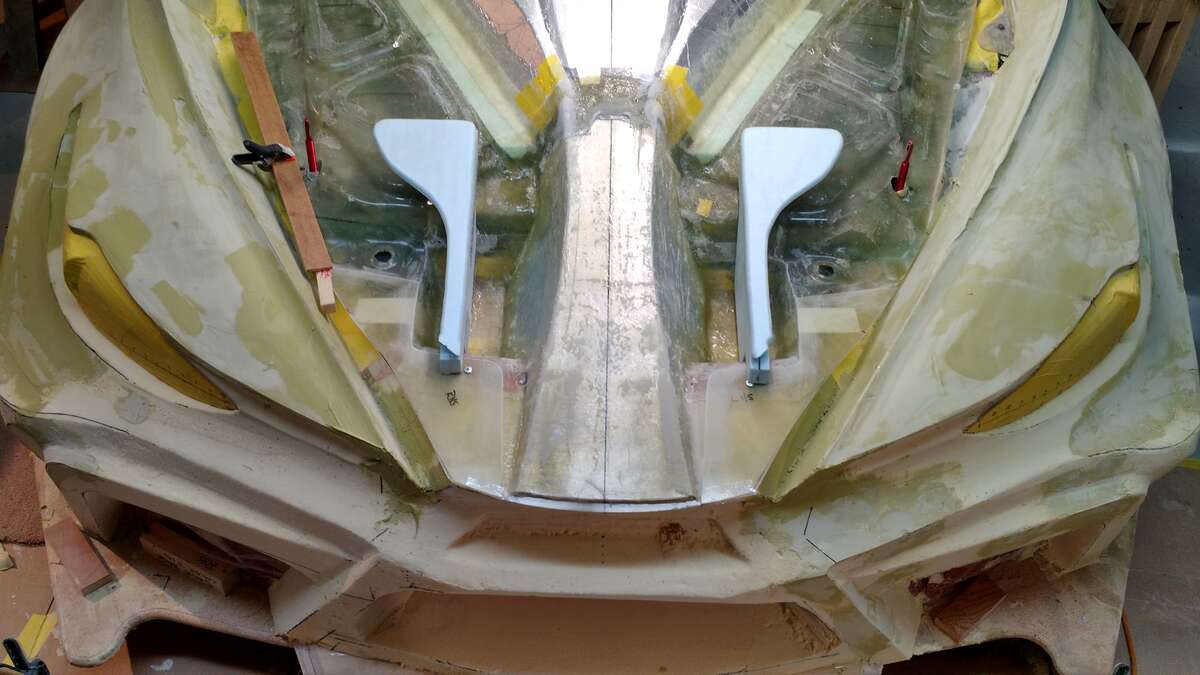

I finally got my turn signals , they are really cool , they have low beam  ( DLR ) day time lights , high beam DLR and Amber sequential signals , I ordered a few sets and the shipping company lost them !!!!
Had to order again .......
So I will be working on there spot in the front Dam , this should be a right pain to make also ... but worth the effort .
They are aftermarket up grade for the new Honda Civic Type R
So they go in and you only see the raised part of the light .

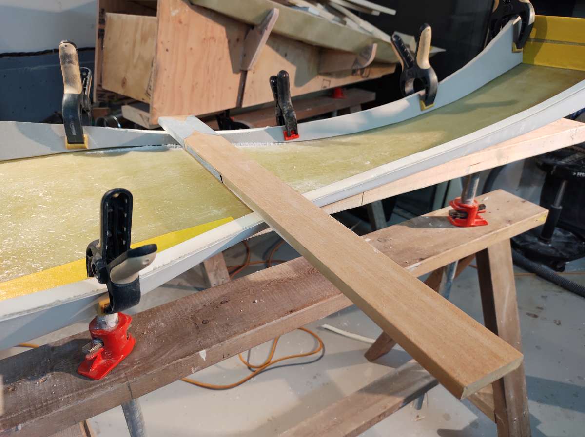

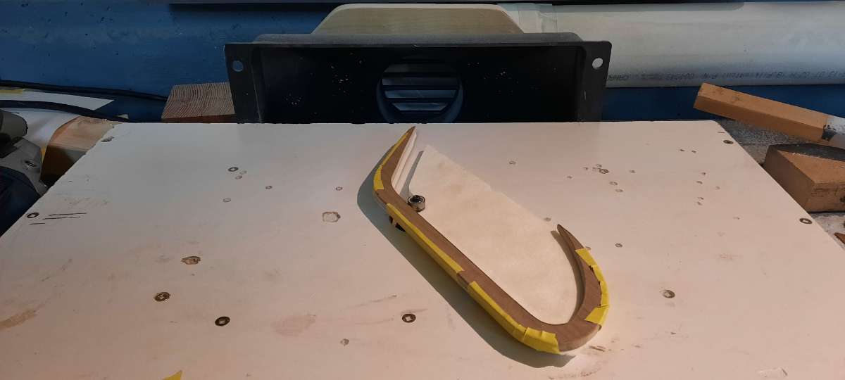

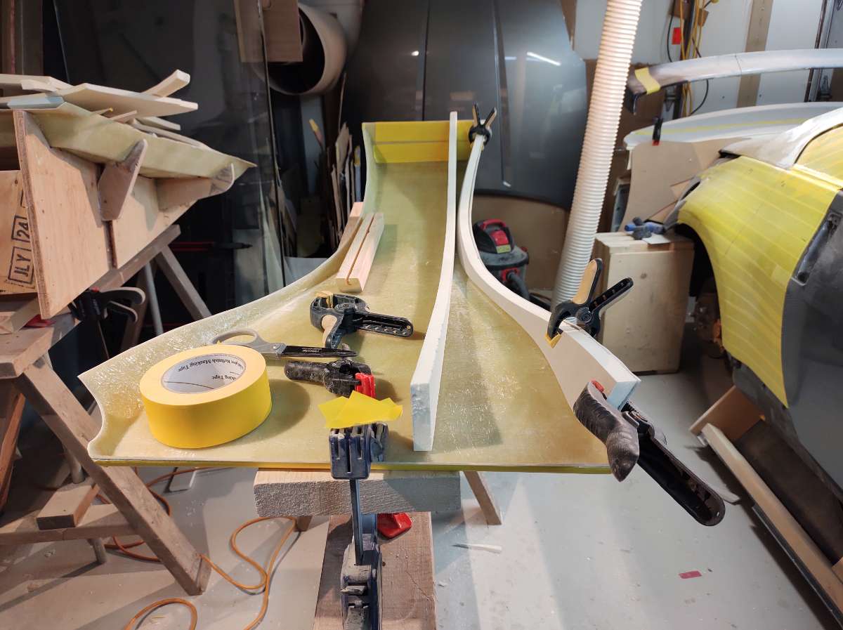

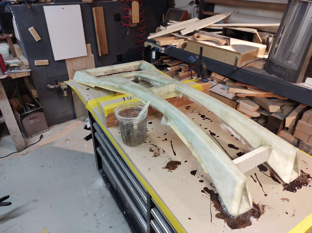

Hi

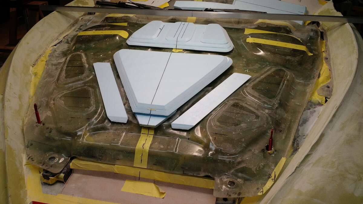

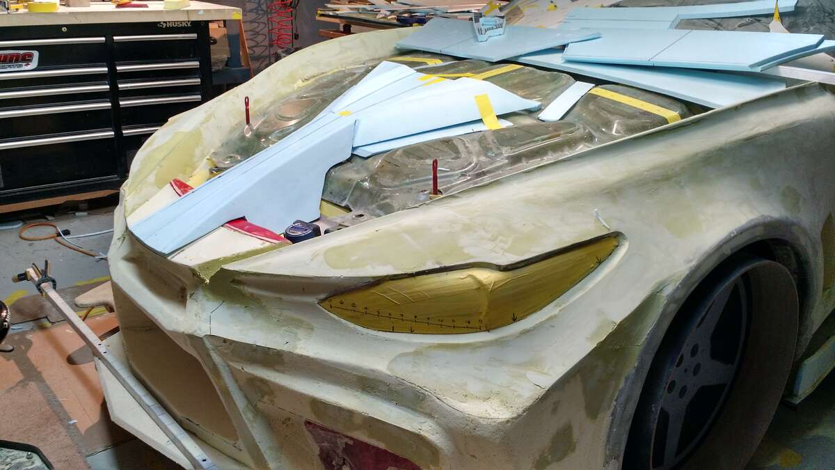

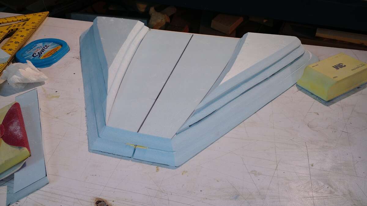

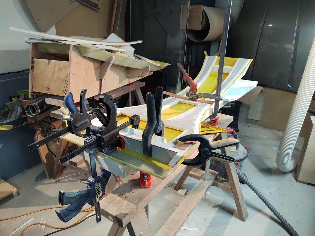

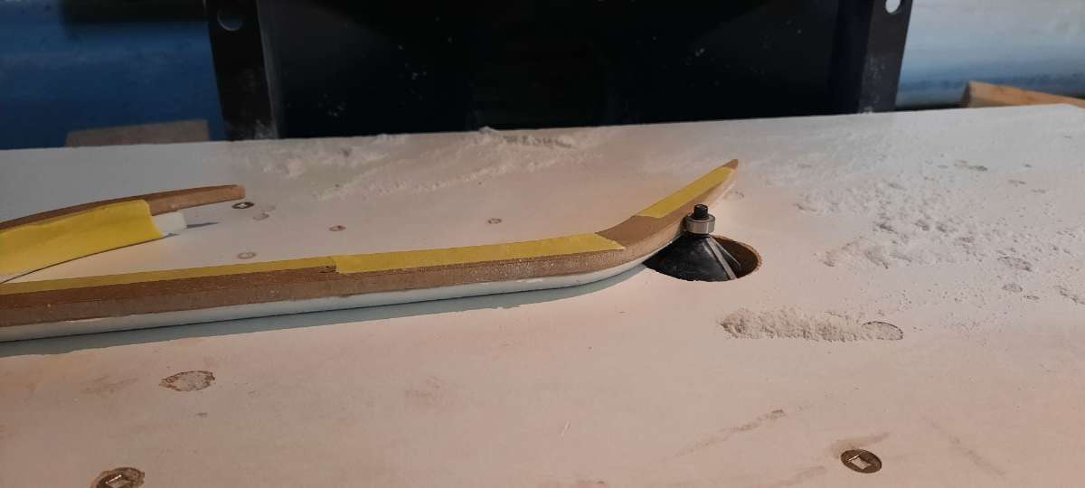

I am back with an update , I have been working on a few things .
The roof scoop frame that will be the mounting point and will be part of the roof .
This was a tricky piece to make ......like everything else was easy lol .
The part that covers the top of the windscreen will be made with the whole roof and cut off after , so the roof scoop frame will need to be cut also , and the nose of the frame will be attached to the part that goes over the glass , for easy removal for windscreen replacement .
