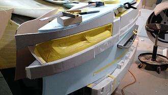

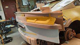

LRF4N Posted January 21, 2021 Share Posted January 21, 2021 The front has an alfa giulia vibe about it. What are the tail lights from? I thought corvette when I first saw them 2 Quote Link to comment Share on other sites More sharing options...
ShortPaul Posted January 21, 2021 Share Posted January 21, 2021 Just wondering what rims do you have in mind to fill those arches with 1 Quote Link to comment Share on other sites More sharing options...
Falcata Posted January 22, 2021 Author Share Posted January 22, 2021 (edited) On 21/01/2021 at 19:02, LRF4N said: The front has an alfa giulia vibe about it. What are the tail lights from? I thought corvette when I first saw them Expand the tail lights are from a 2017 Camaro , the ones on the car right now are the stock ones ,they were brand new take off's which I picked up to build the car with .these are the lights that will go on the car when it gets assembled . They are sequential ,they also come blacked out . I am a dealer for them now and they are a little expensive so I didn't want to use them for building the car. Edited January 22, 2021 by Falcata 3 Quote Link to comment Share on other sites More sharing options...

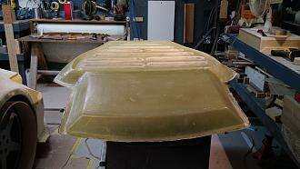

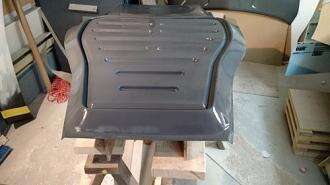

Falcata Posted January 22, 2021 Author Share Posted January 22, 2021 Back to the rear deck lid or trunk , I needed to make a copy of the deck lid trunk area so I can build the trunk lid top and bottom off the car , it's so wide that it's just too awkward to build on the car . So I prepped the area with wax and PVA as usual , but something went wrong , still not sure what happened , as I was laying up the fiberglass on the third layer, I was half way down the lid and it started kicking off and I wasn't going to be able to steel roll out the air !!! So I was freaking out thinking it's going to be a big mess with air pockets and voids !!! I would have to grind it all off so I pulled all the layers off and tossed them away , leaving a bunch of little glass hairs everywhere to deal with . I got it cleaned up as best I could and re glassed it. Here you see popping it off the car Here you can see the blue foam melted from the heat and some resin got past the plastic and tape , and the part was not great and needed a ton of body work to rescue it I built a base for it , makes life so much easier to work on it . so now this will get glassed and become the the simulator for the rear trunk area , so I can work on building the lower and upper halves of the trunk lid with out hanging over the car for hours . 4 Quote Link to comment Share on other sites More sharing options...
Falcata Posted January 22, 2021 Author Share Posted January 22, 2021 the trunk area copy , now this will be easier to walk around and work on . Here is glassing the part Yes another base this one is important because it will also hold the part at the proper angle so it will look right on the car . Here are the two pieces being separated from one another . 5 Quote Link to comment Share on other sites More sharing options...

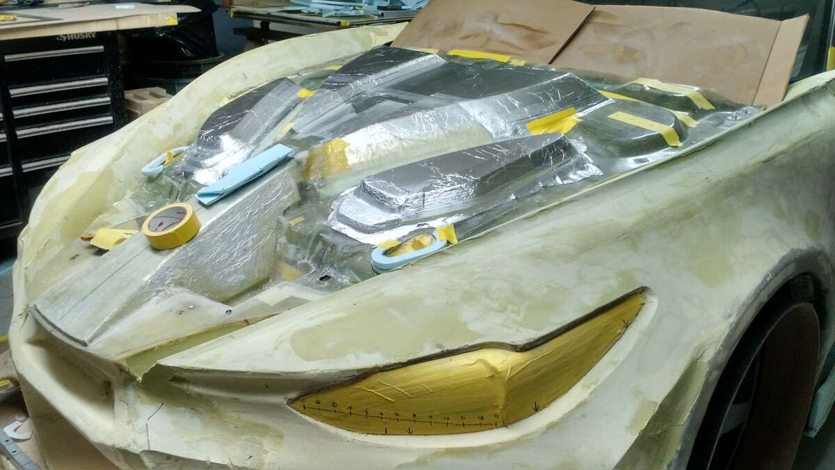

Falcata Posted January 23, 2021 Author Share Posted January 23, 2021 (edited) Should have a look at the hood . I mocked this up with the blue foam , was a long time ago now , this was the original plan for the hood , Vintage Maserati kind of style . The two outside petals were going to cold air intake slots underneath were the air box's are . but as time goes zooming by and the amount of work to build molds for all these parts is just unrealistic , it's been over 2 years now working every day . The other thing is it doesn't make any extra room underneath for extra goodies . But I really liked it !!! Edited January 23, 2021 by Falcata 3 Quote Link to comment Share on other sites More sharing options...
Falcata Posted January 23, 2021 Author Share Posted January 23, 2021 This is the bottom half of the hood , makes lots of room for goodies , I plan to buy another Zed later and build a beast with a supercharged LS3 6 or 7 hundred horsepower , full cage , bare minimum , so I want some room for stuff , this new hood design will allow room for twin turbos or LS style air intake . So I had to build this with the blue foam , so happy to done with the blue foam , it's truly a pain in the butt ,having to seal it up with foil and tape . now remember is is the bottom half .....so the top will be a lot different 2 Quote Link to comment Share on other sites More sharing options...
