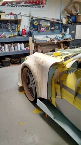

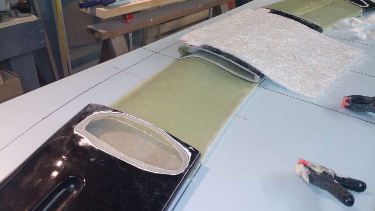

Next is the bucks for the shape , I made patterns out of Ram board ( its used to protect flooring when doing construction in homes )
Comes in a 50 or 100 foot rolls x 38 inches I believe . excellent for large patterns .
2096638178_IMG_20200415_135606456_HDR(500x281).jpg.a797dddf29edb6a727208aca3e1f34f6.jpg

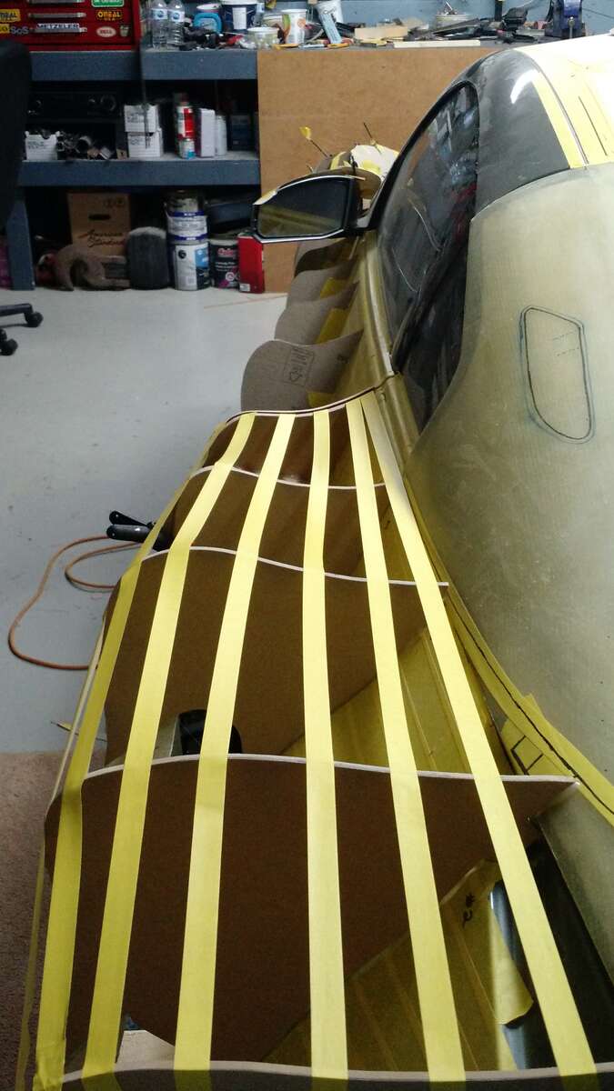

Once the shape is how I like it I make the bucks out of 1/4 inch MDF
Here you can see I made the fender cover the top of the light , makes it more sinister looking .
These were tricky to make as the light has a lot of shape .
 the bucks were made to interlock , this gives it some real strength for sanding and working with the foam
The difference between the ram board and the real wood , made for some challenges for left and right and angle etc
This pile was not making the cut so to speak ....

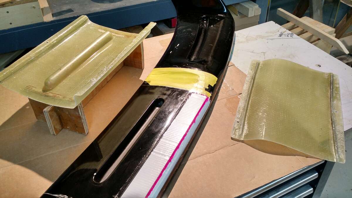

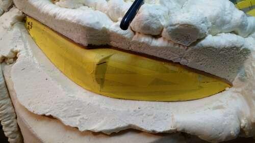

I used aluminum flashing to make the shield for the foam around the headlights
this long silver part is ram board covered with aluminum tape and release wax to prevent it from sticking

All prepped and ready for foam
2068143010_IMG_20200507_170004295_HDR(500x281).jpg.f6cfc30441e73ece3934f2c10e9a3357.jpg
here you can see how the flashing around the headlight prevented it from being buried

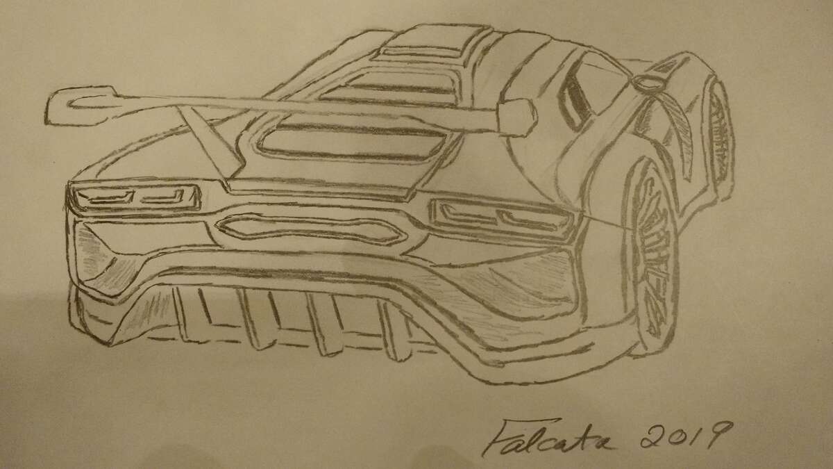

Are there sketches you’re working to or are you winging it

Hi and thanks  ...........not looking for the poor mans roller look here , it's going to be raw GT3 on the street !!
I did make a few renditions the one for the front has changed , but this is the one for the back , I am no artist .

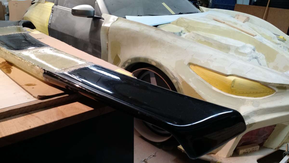

Alright some more on the front fenders .
Here is a view from inside
Still just roughed in here , this is why I didn't totally finish the nose , in case I wanted to make a change or lucky for me , I had some problems with the foam on the drivers side and it ate the foam below the headlight and I had to redo it.

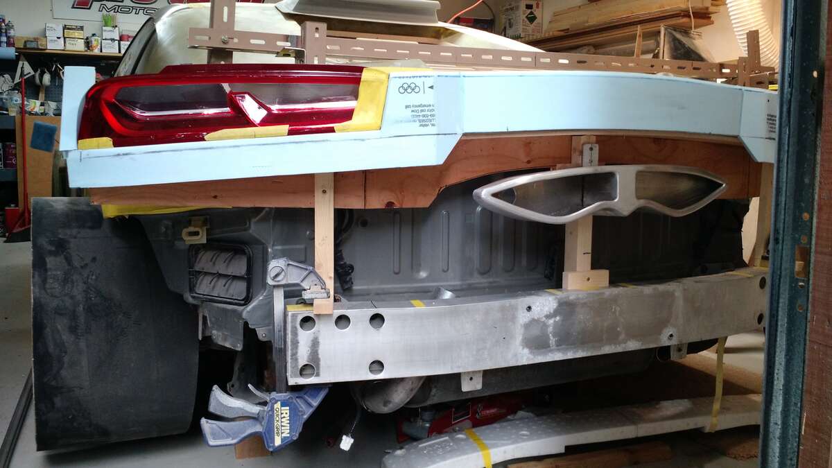

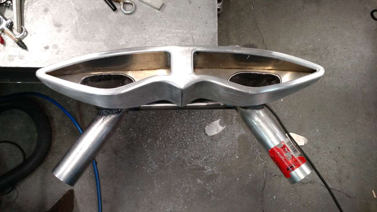

Ok lets go to the back of the car for a change of pace .

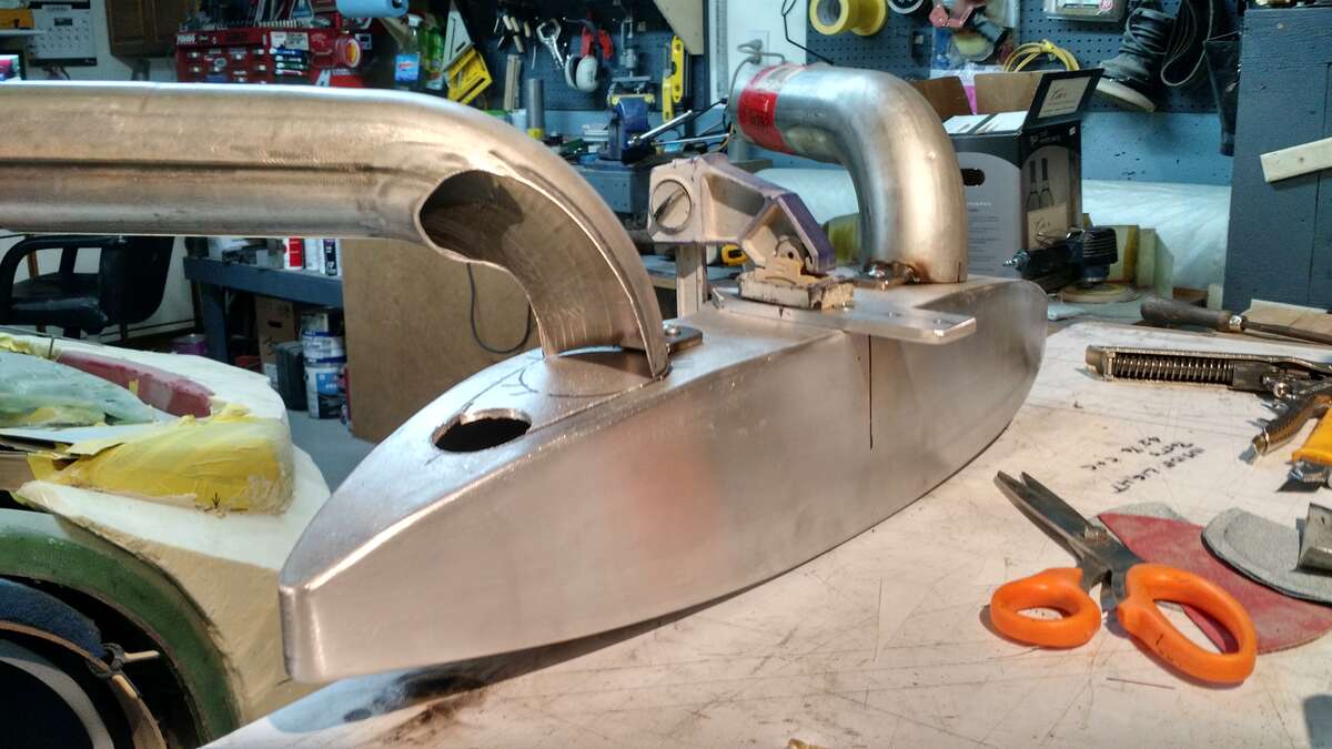

Falcata is the name of the car , I named it after a Spanish Sword It was considered a very deadly weapon .

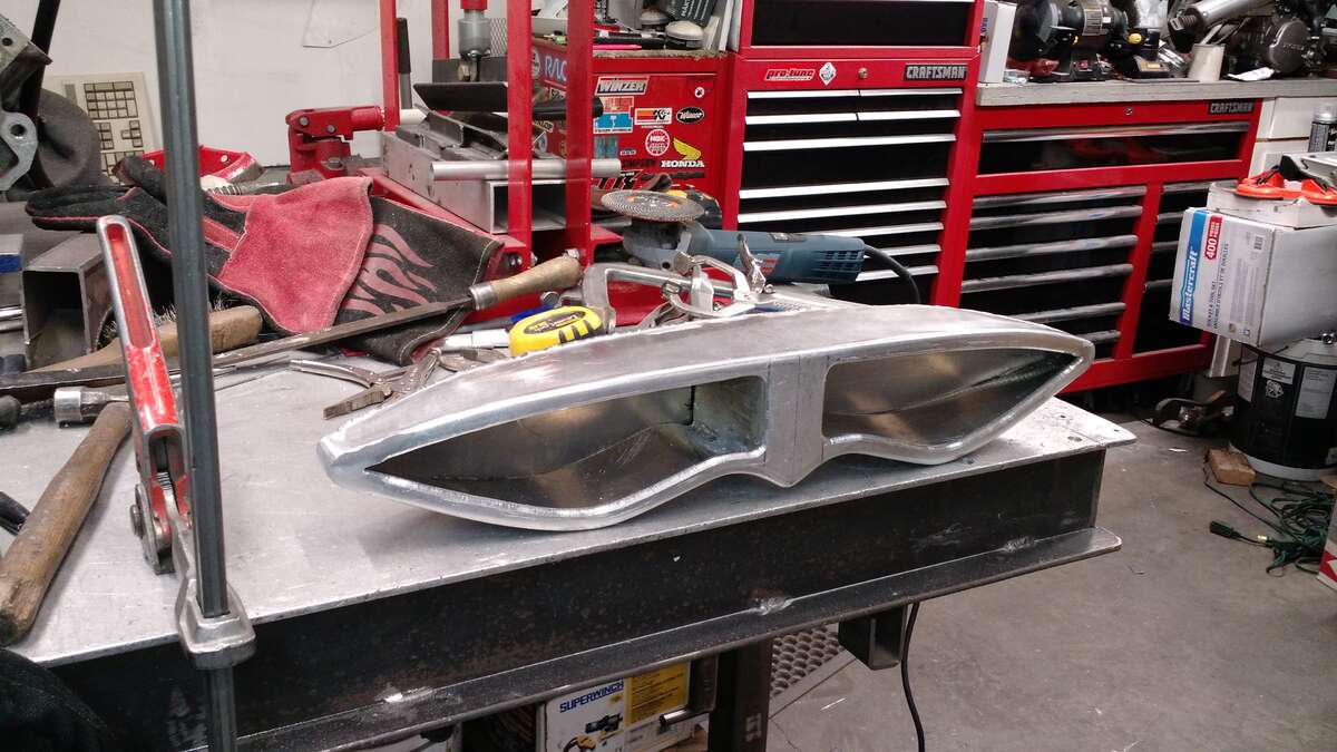

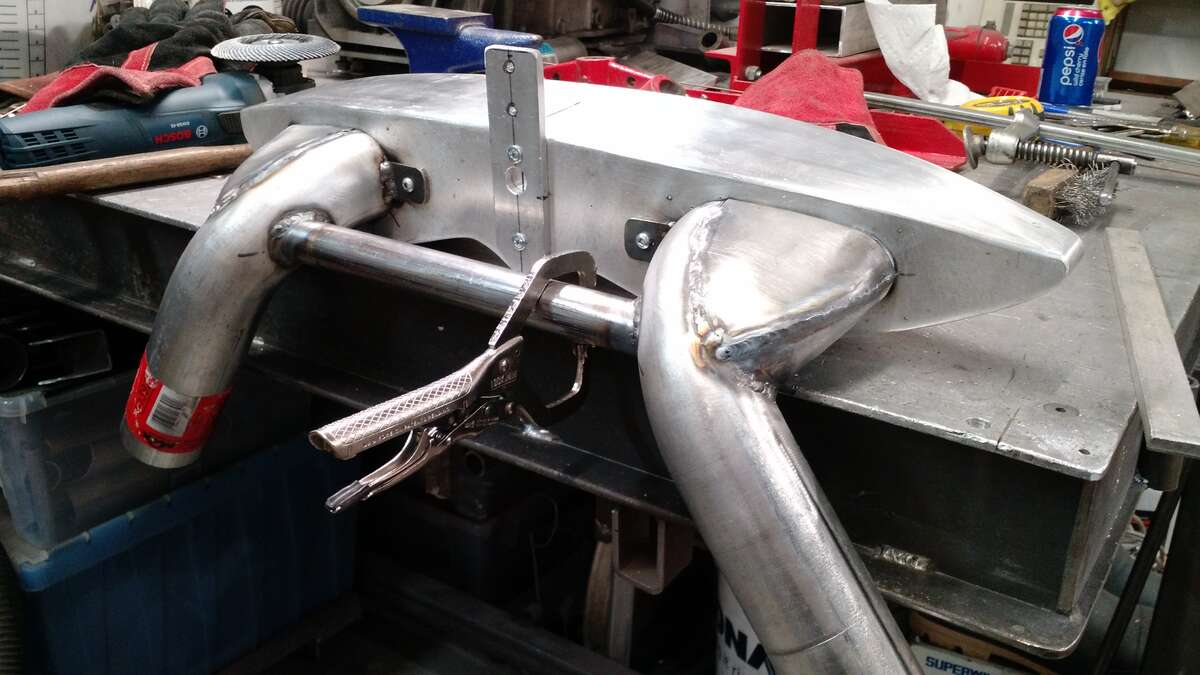

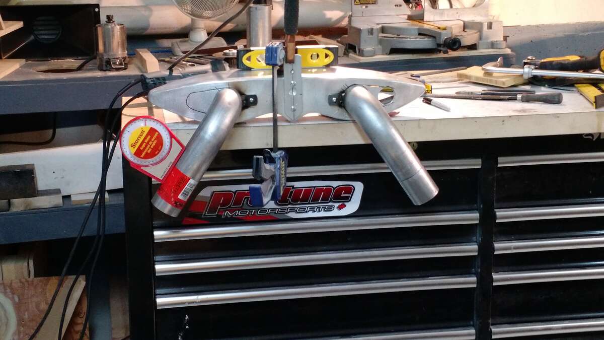

So the logo (emblem or Badge ) for the car is two sword ends put together , I designed the exhaust tip from this idea , the first pic is a little solder holding a Falcata and here is the signature exhaust .
It's 24 inches long and 4 inches tall

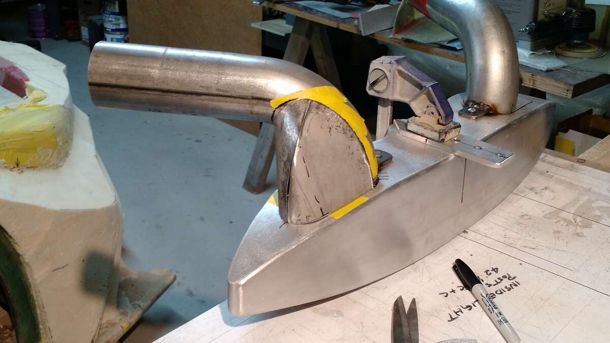

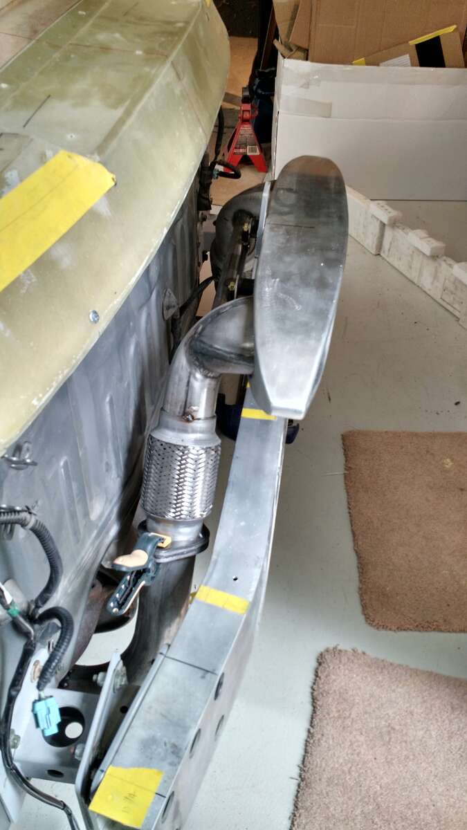

First I built some spacers to extend the rear bumper out 3 inches to make room for the pipes to go up

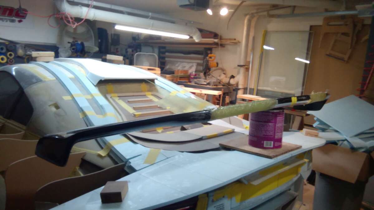

IMG_20190629_154502821_HDR.jpg.848d4068b0a13f7b15967cab5e369bce.jpgIMG_20190630_115834247.jpg.32e57290674efead86f00ae480f18b65.jpg

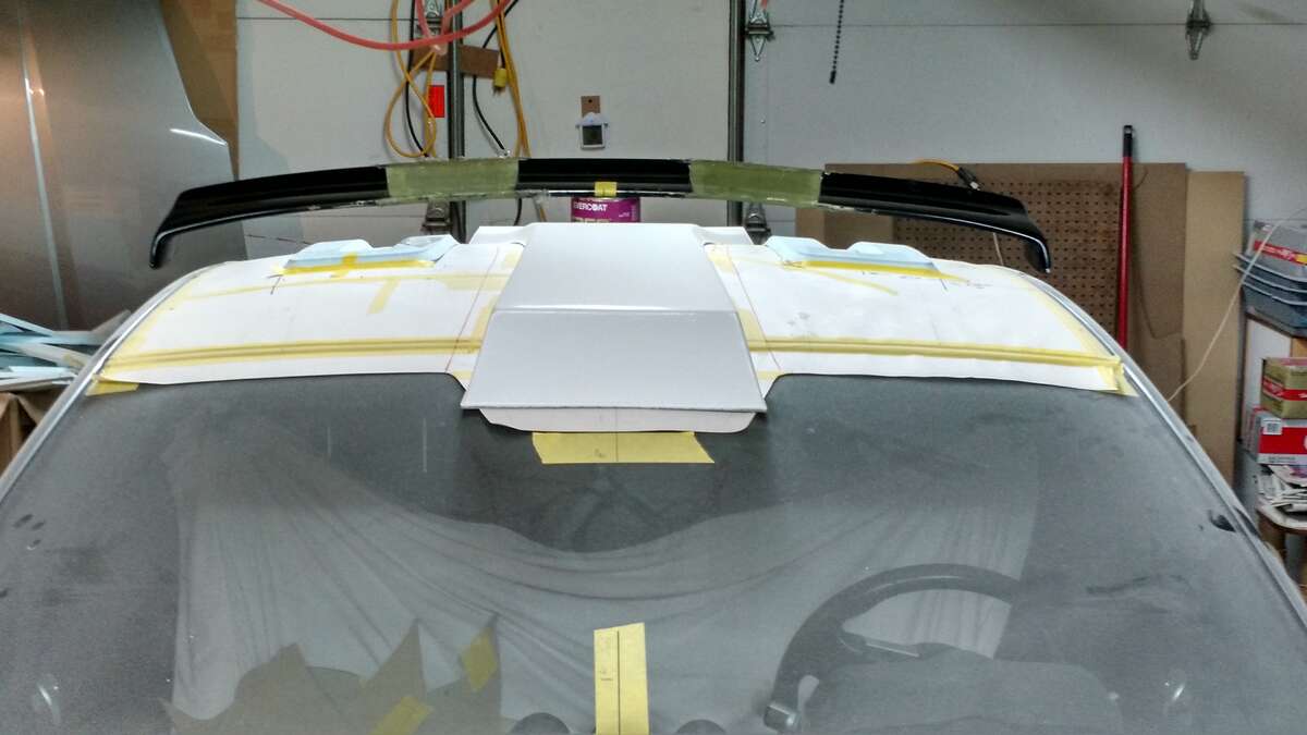

More on the back of the car , the quarter panels , I designed the shape of the quarters to be able to accept the use of the factory Gas door .
The yellow masking tape is for me to get a visual of the contour .

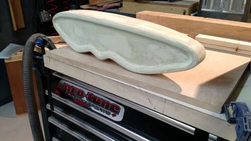

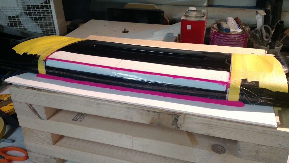

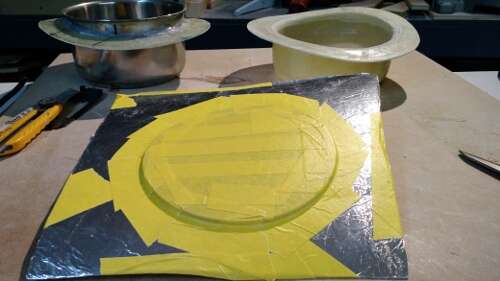

Next is the Exhaust surround , because the back panel below the taillights is curved the exhaust tip needs a surround to make it more of a feature , instead of it just sticking out of a hole .
So i built a plug for that piece and when i make the rear mid panel i will insert it into the panel .
So you can see in the first pic at the outside edges of the tip there is a gap , so the surround will fill that and still maintain the look of it sticking out of the mid panel .
Once the mid panel comes out of the mold the center of the surround will be trimmed out .

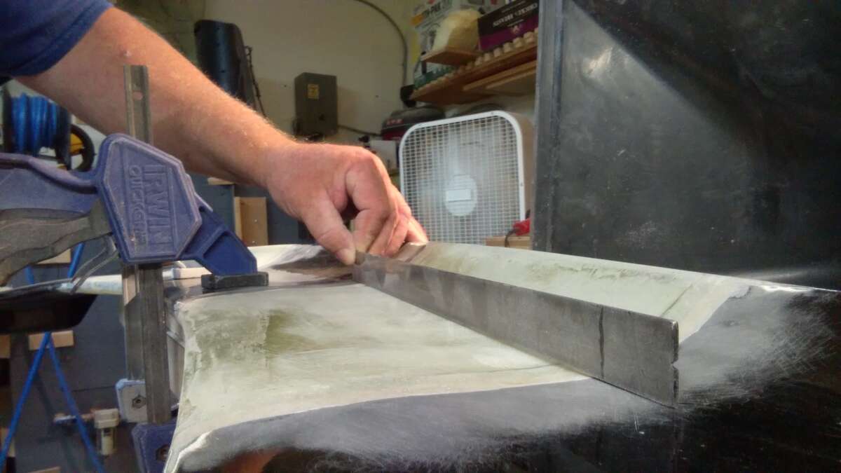

Ok this blue foam as i mentioned earlier is a bit of a pain , because everything melts it , unfortunate because it machines very well , flexible but firm and the best part is it's $ 8.00 for a 2 foot X 8 foot sheet .
Through networking a Wayne and Don fellow Canadian car builders have introduced me to another source for some Polyurethane foam which is fiberglass etc friendly But , yes there always a But .
I will explain in my next post .

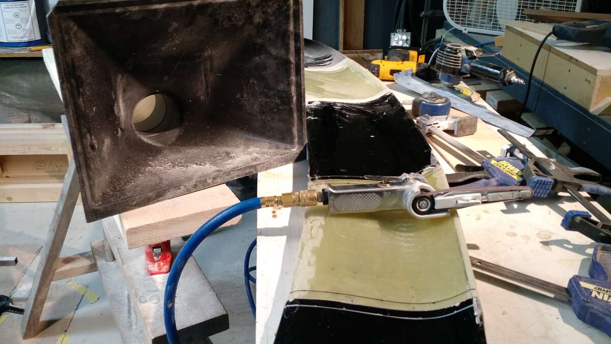

So decided to build my own Foam Saw from scraps from my shop .
Here is a link to a video of it and version 2.0 lol
