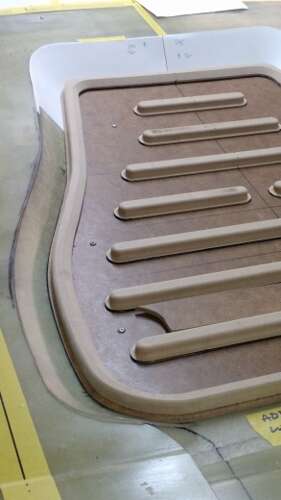

Ok this piece is a buck to make the cover for the rear suspension tower brace .
I was originally planing to have a small rear window , but I just couldn't get the the water to flow over the suspension brace , so with all the rear view camera tech out there I decided to delete the window all together

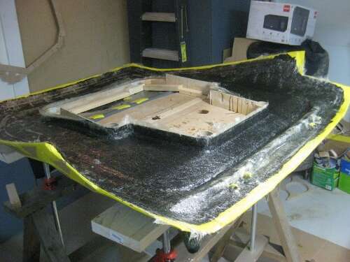

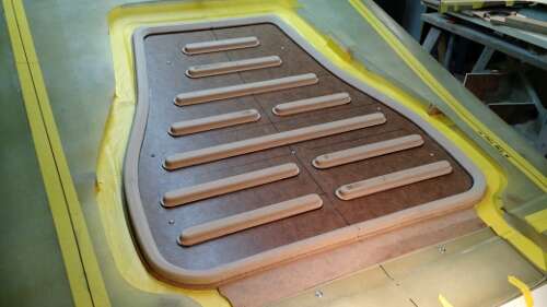

Building the trunk ( rear bonnet ) opening
This raised perimeter once glassed will be cut so that there will be a standing edge for the trunk seal to slid over

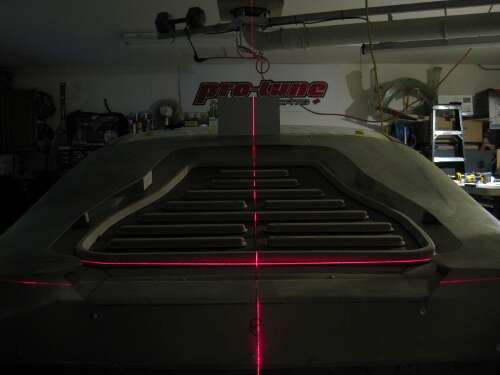

my plan was to cut this guitar shape out after the rear deck was finished and it would become the bottom of the opening lid .
Next is adding some stiffening to to this piece with some bars going across .
I use lasers levels to help keep everything as level and symmetrical as possible .
  • Like 4

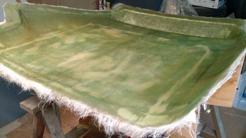

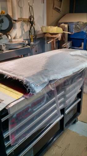

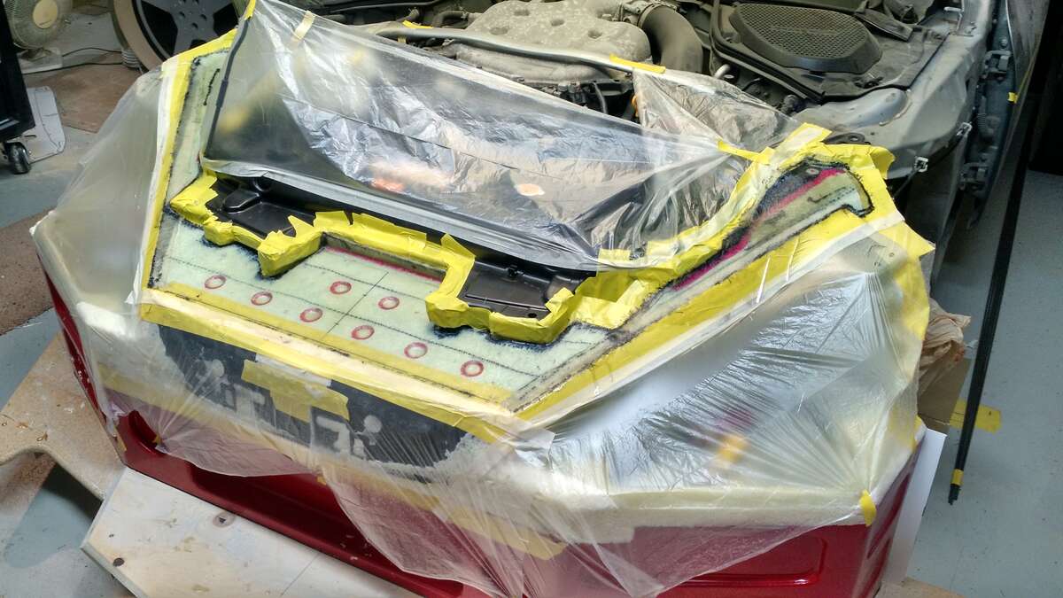

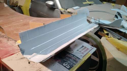

 Some more on the rear deck area .
Taping up the underneath in case any resin gets through

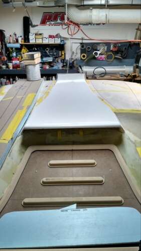

here I am making patterns to trace onto some super thin fiberglass sheet that I made to go in here
Here is the thin glass
1599550641_IMG_20190416_120339978_HDR(281x500).jpg.73ae432b2b9ae72746aed0aedd96f9ae.jpg    297744705_IMG_20190415_175700459(281x500).jpg.0020cc8622e8d032a2a3cee17092bdda.jpg
937137149_IMG_20190416_163803963_HDR(500x281).jpg.3a191e934981a5e5cb1f3f2c299b7a1f.jpg
  • Like 4

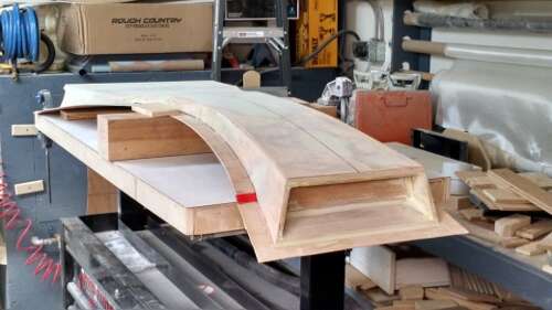

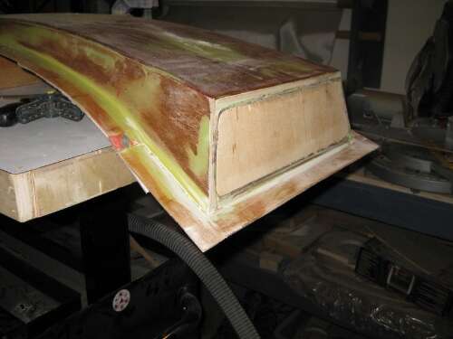

Roof Scoop , this sounds easy to make ......first the cardboard mock up then foam board , we can't get the green foam board the guys in the US get which you can glass right over , the blue stuff melts with just about anything you touch it with , so i cover it with tinfoil first , what a pain , because it's great to work with you can cut shape sand all very easily .
The roof scoop is just for the cool factor plus it helps keep the roof rigged , and will be removable to change the windshield if required , and house the third brake light .
I have to say now in retrospect , if I was to build this again I would not have done it this way , it took way too long .
But it turned out ok in the end .
  • Like 4

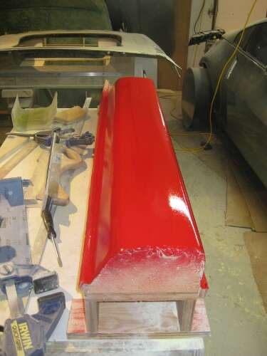

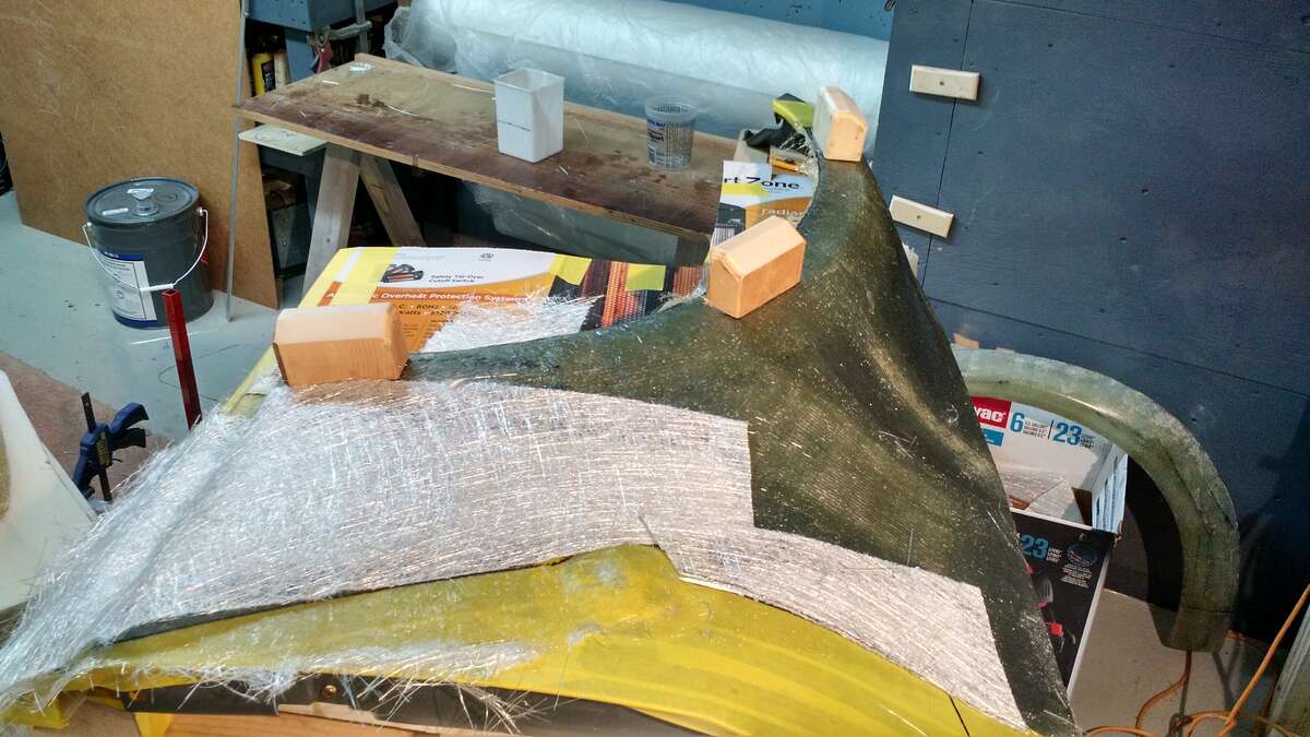

I decided to make the mold two parts so I wouldn't bust the part trying to get it out .
I made the end cap removable
here I am taking the plug out
Here is the mold with the black tooling gel coat
the mold prepped to make the first one
white Gel coat
1161166810_IMG_20200120_100520023_HDR(500x281).jpg.23dca31487404a575aa43dd2f9667817.jpg
966616297_IMG_20200120_112540661_HDR(500x281).jpg.11f11d5def8173d485904497e5cd006b.jpg
laying up the fiberglass
979878929_IMG_20200120_113029447_HDR(500x281).jpg.6572b832705c6a37feb28d5119b55c4e.jpg
removing the part
562648931_IMG_20200121_104833491_HDR(500x281).jpg.8c757ce0074a1220b59caafc26f09766.jpg

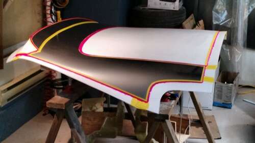

roughly trimmed up and on the roof
2103932621_IMG_20200121_121448519_HDR(281x500).jpg.d3d5dd0f3d638ca13b20170770609e24.jpg
412336595_IMG_20200121_121556170_HDR(500x281).jpg.8f6c22535bd71695f05e9a84a91e5176.jpg

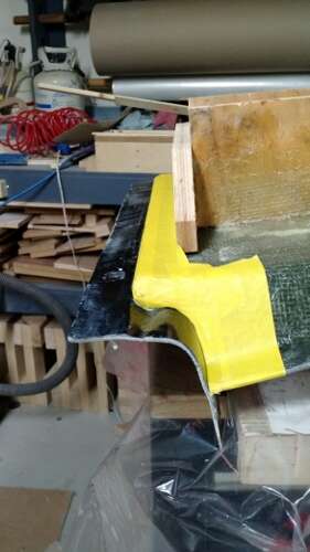

I made this part in the winter and had some issues but it still very serviceable
  • Like 5

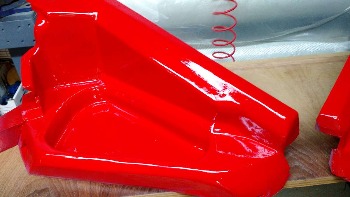

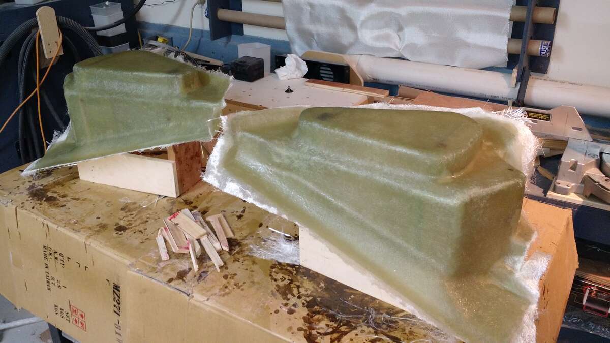

Headlights are Mazda 3 the aftermarket Angel Eyes Projectors
Had to make pots for them to bolt into , I tried to make the Plug for pots with two part foam , that didn't work very well , so I made them out of wood , as usual that was a pain in the butt , and a ton of work to make one part , as these pots will become integral with the substructure .
IMG_20181115_190456549.jpg.9e3c179ae3117d68afda34139256623f.jpgIMG_20181120_182116955.jpg.263fbb86a010380d75256404f290bd0b.jpg
  • Like 3

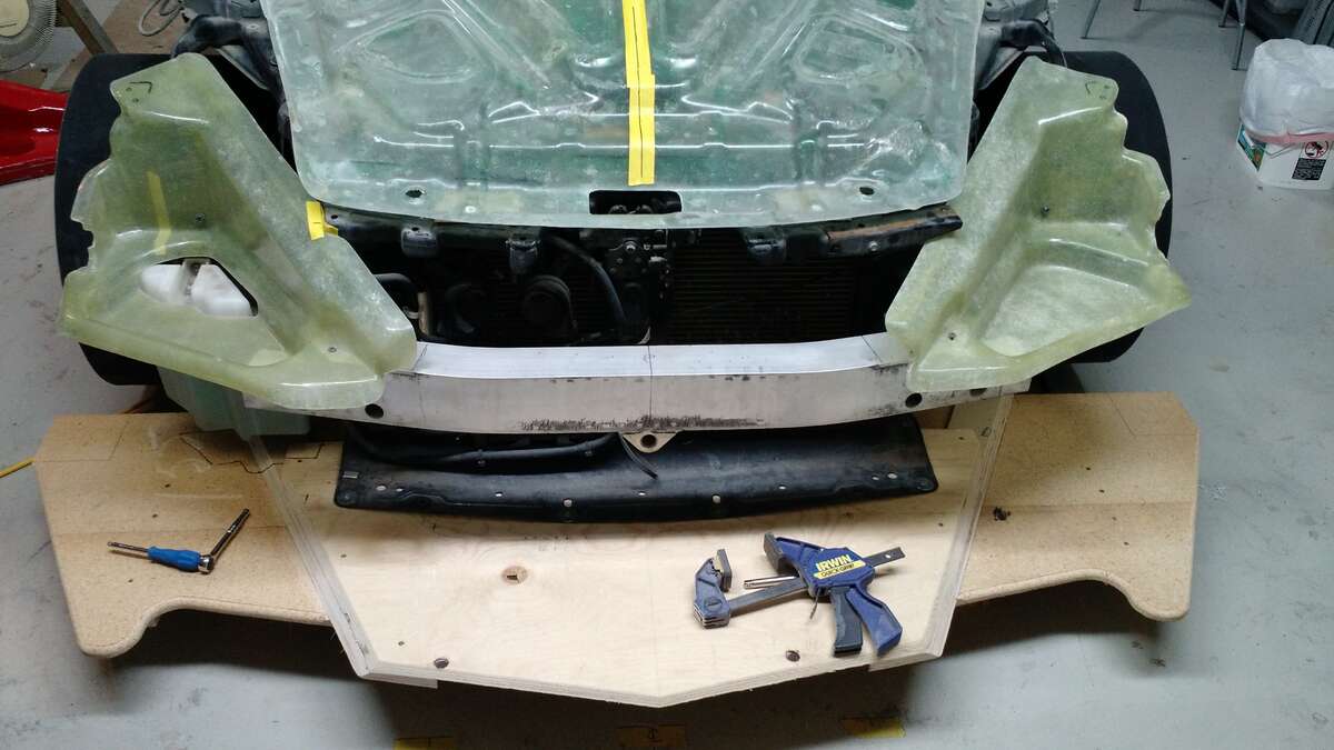

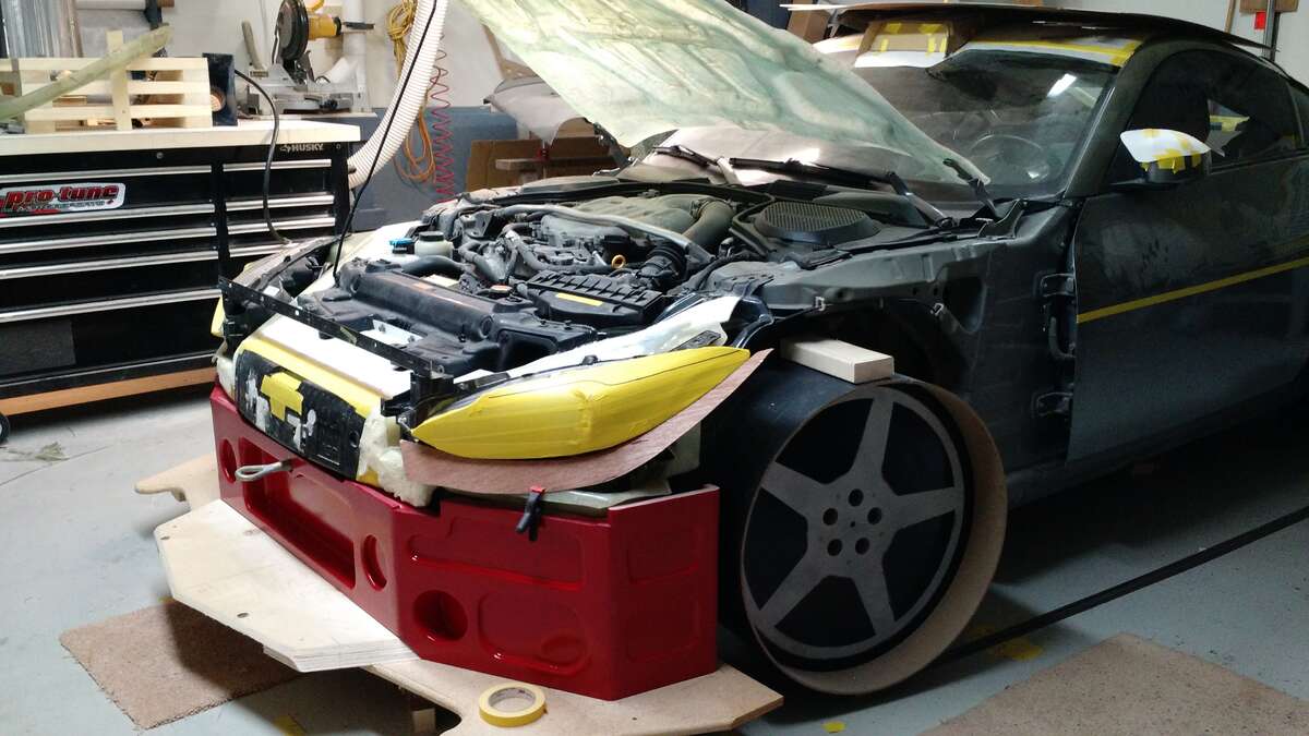

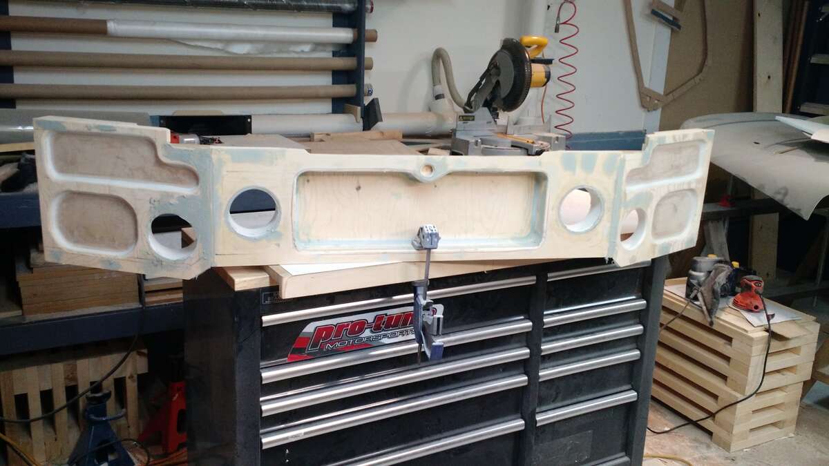

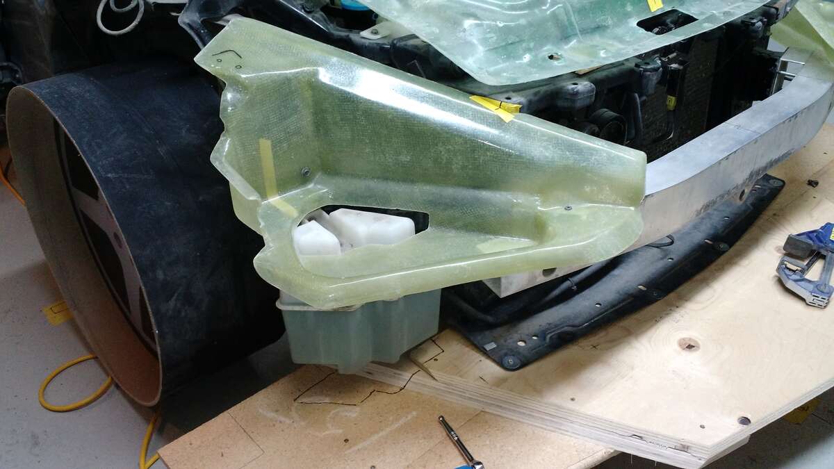

More front end , i decided to build a one piece structure to support the headlights and the front fenders and the bumper cover and the splitter , with fixtures for the air ducts .
Again wood.....not the best because it's so porous it soaks up everything so it needs to be sealed before filling , painting etc .
I have spaced out the factory bumper 2 1/2 inches to make extra room for inter coolers and or oil coolers .
The factory impact foam will be retained also
it's a shame all these pieces being made to form the fiberglass all go in the bin when the car is complete
847398198_IMG_20190112_162740667(281x500).jpg.07bc597a79a64f87ac17334dddd5fb5e.jpg  2084851708_IMG_20190112_163249669(500x281).jpg.489feecb9e07b7d396357a0b75ec8b22.jpg
I made a copy of the bottom of the factory hood so I could see for clearance to add or remove space , I had some old resin that had some chunks in it from being in the cold , so the quality is bad but is going in the bin later anyway .
Also retaining the factory tow hook !!!

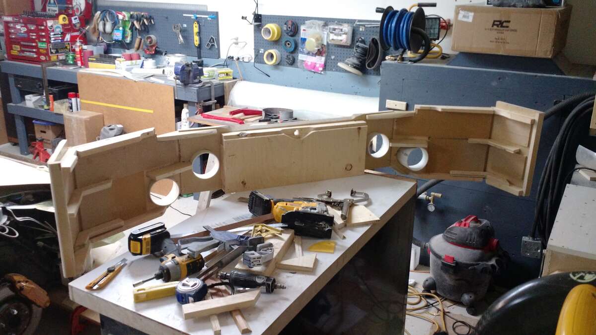

This is the upper section of the substructure .

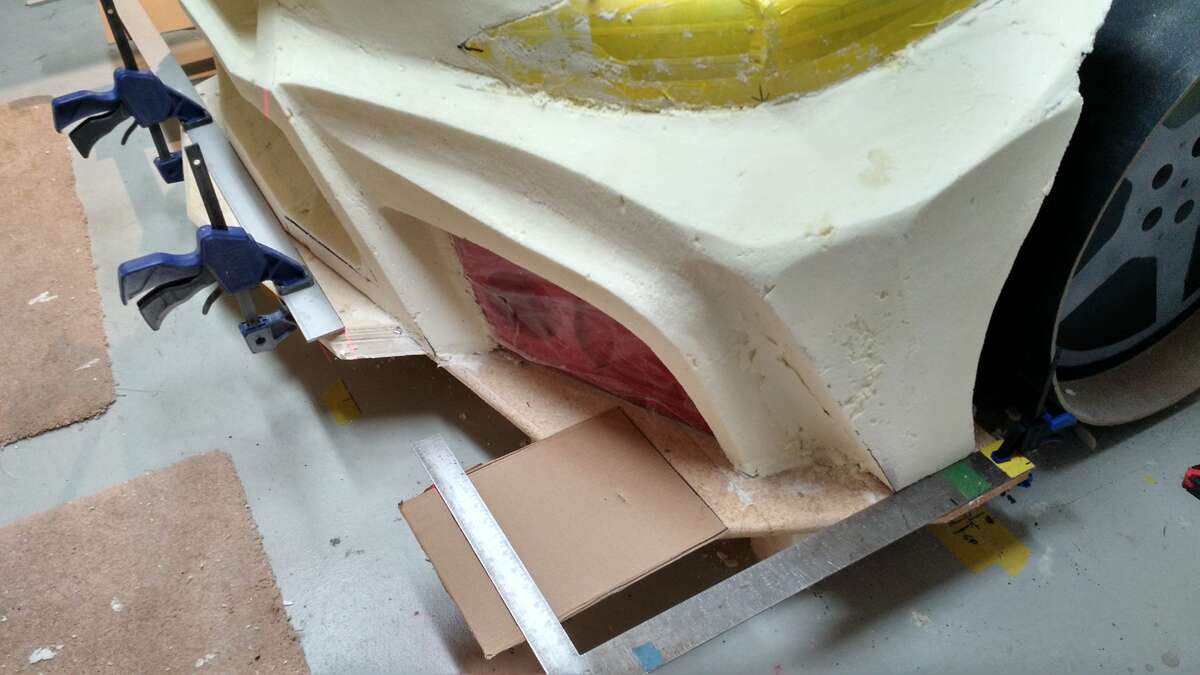

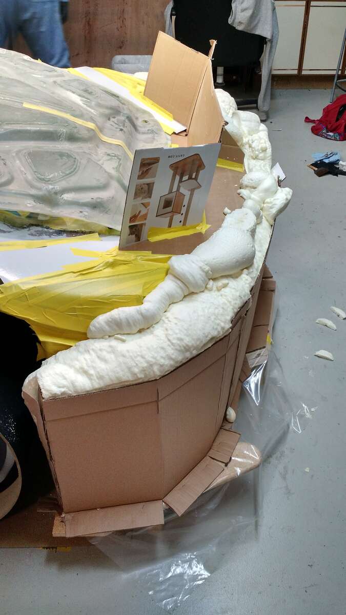

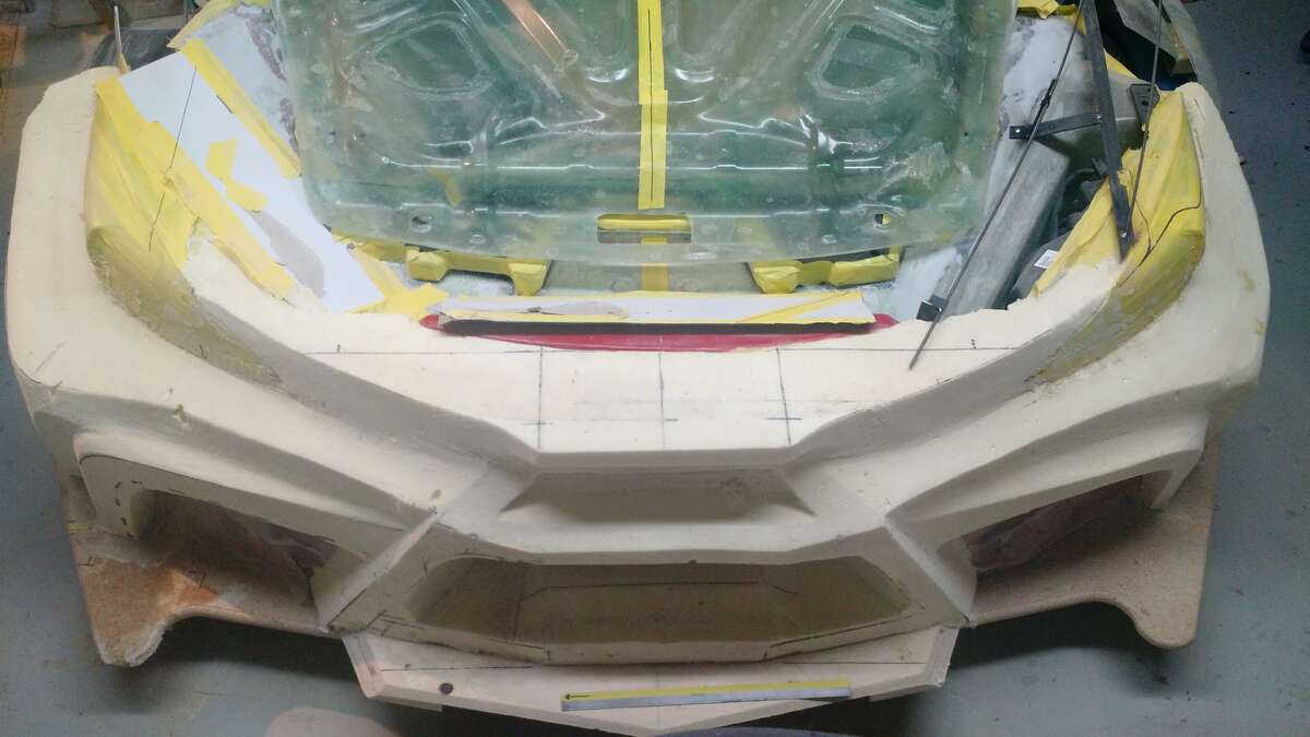

More front end ....Fun with foam !!!!!!
the foam cuts and sands like butter , it's very easy to go too far .
Here you can see making a moat for the two part Polyurethane foam
I carved this all by hand , a large bread knife works quite nice for the initial shape

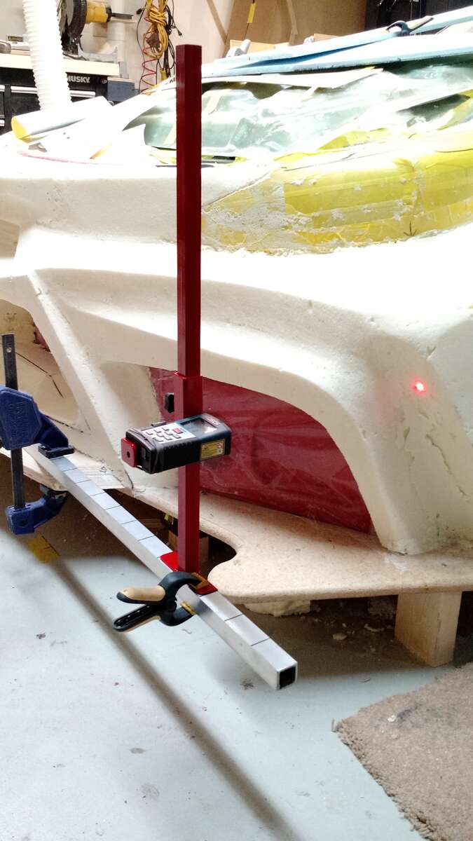

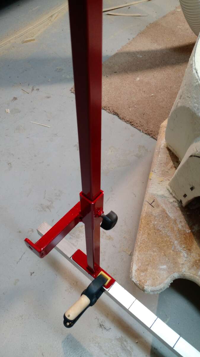

I built a device to measure , its like trying to measure an egg .
Edited by Falcata
  • Like 5

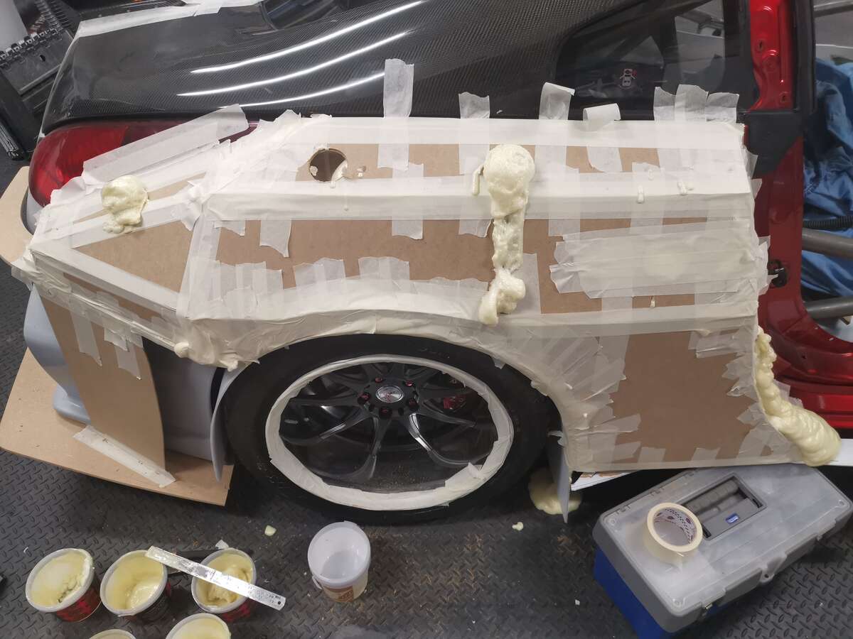

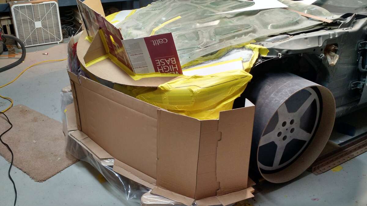

Hi Fellow Foamer
Wow , you are pretty trusting not to get that foam on the wheels or anywhere else , nothing takes it off !!!! I got some on my tool box and its there for good , I will check out your car after i post some more stuff .
I don't know if you have tried this but I learned a trick when doing my front fenders , take the time to put that clear packing tape on the inside of your cardboard dam and put mold release wax on it , helps the foam spread and stops the cardboard from sticking !!! comes out smooth .

I built this device to measure to insure both sides come out the same .
I might look int lasers and scanning before the final filling and sanding .

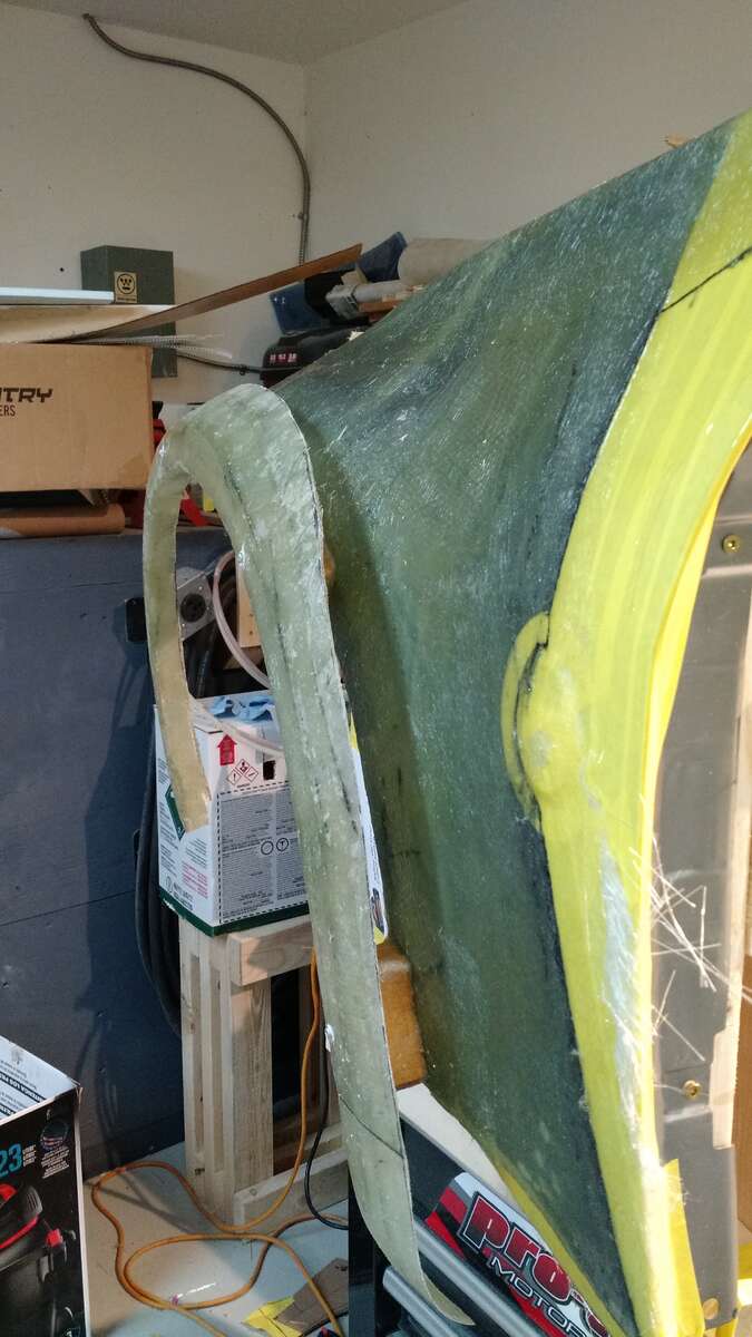

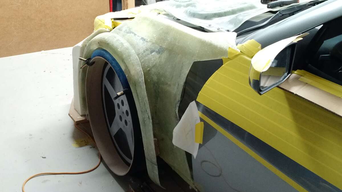

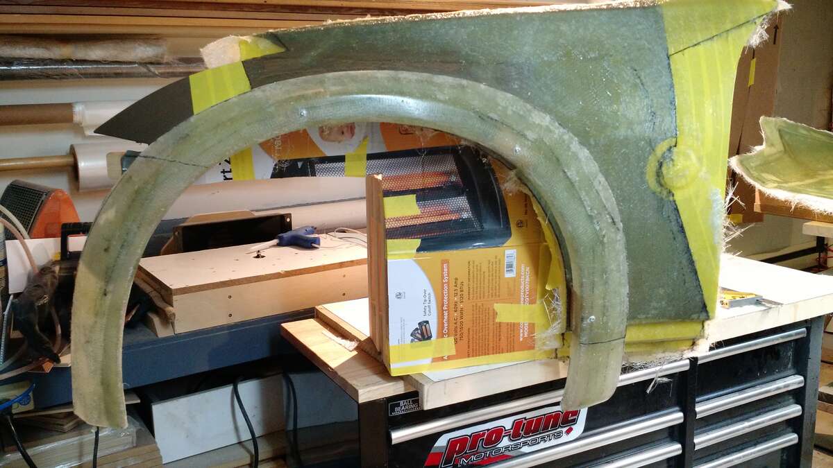

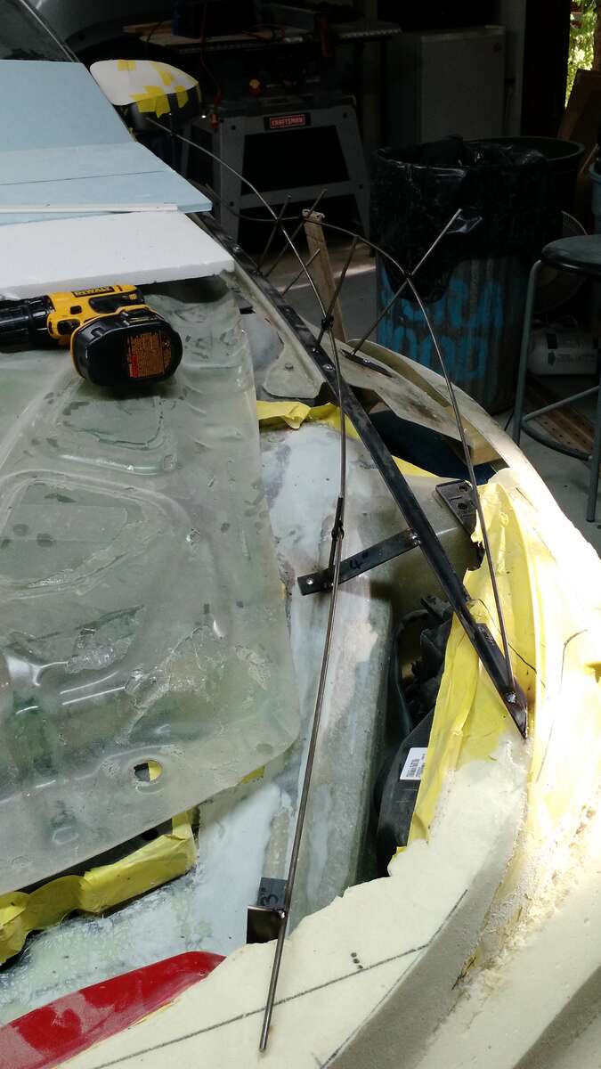

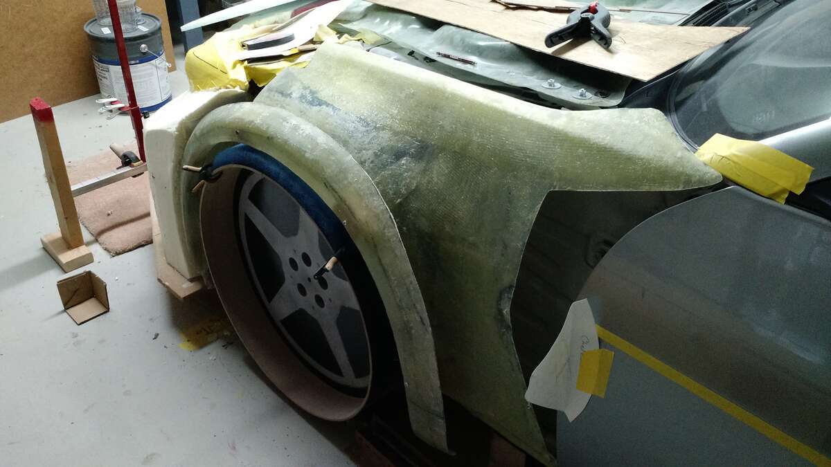

On to the fenders
I made copies of the factory ones for a couple of reasons .
First I want to use the factory fastening for most of the top and bottom , and second the wheel arch size  , shape and it helps with location for the new one .
Next I used some 1 x 1/8 flat bar and 3/16th round bar to set the shape of the new fender , once I was happy I tack welded them in place .
  • Like 3
