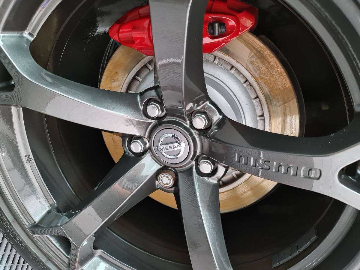

Also managed to swap my wheel nuts out for some new ones from Z1, no more rusty locking wheel nut! 20220723_111442.jpg.217ad6cfcf3ffdcfd74ce11ae3091835.jpg
Wheel area now complete!

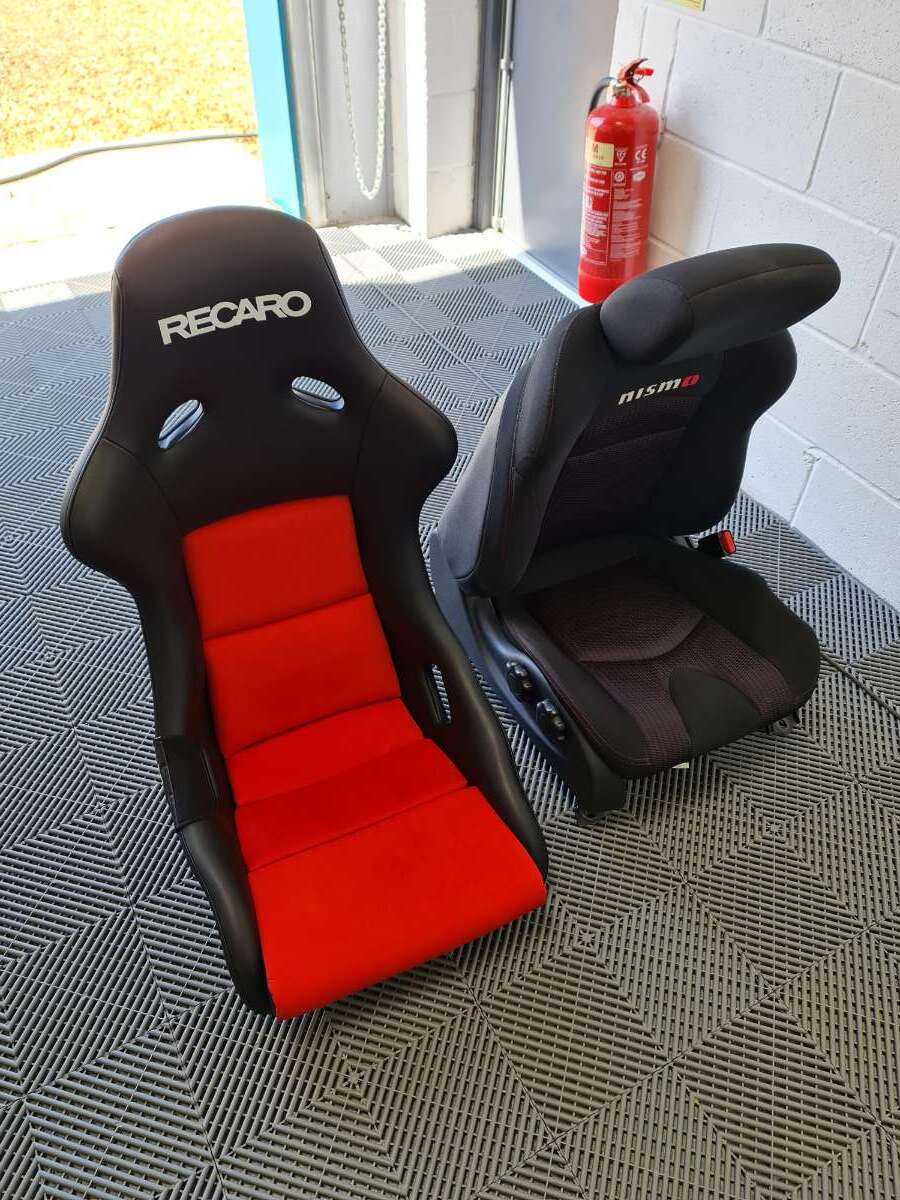

Finally found some time to install my Recaro Pole Position I bought last year.
Seat out, always satisfying to be able to clean areas that are usually blocked.
Now anyone who has fit aftermarket seats know that you have to bypass the airbag plug, I've seen people solider and splice their own. I didn't fancy that and managed to find a airbag by pass resistor kit on ebay which is plug and play. Worked a treat, no air bag light!
The weight difference between the two is incredible, didn't have a scale to compare but must be 10lbs or so
I bought Buddy Club rails as I wanted to still be able to move the seat back and forward, plus no need for me to be 'on the floor as I'm only 5'10 in height. Can't fault the Buddy Club rails for the most part, good quality, great fitment. Had an issue with one of the studs but the company I bought it from quickly sent me a replacement so all good. I couldn't get the brackets on the lowest setting on the seat as it would block the rail lever that moves the seat back and fourth so I'm at second from bottom.
Test fit, all good, I'm sure I'll do some miles and adjust if needed. So happy with the look, definitely what this car was missing from factory! In the future I would love to send them to get stripped and the Nismo logo embroidered on the headrest like the mk2 CS seats.
Quick blast out with my friend on his motorbike to test out the seats, all I can say I was blown away with the difference a good bucket can make to the driving experience, feel so much more connected to the car and makes already a great car feel even more analog!
Plan is to get the passenger seat further down the line, I literally never have a passenger so would rather prioritise other things I would like to get for the car.
Next up exhaust system I think, after two years of enjoying the stock system I think its time to unleash the beast. I've banged on about a Motordyne system forever but could never justify the price now. Also looked at the Torqen system and Greddy so toss up between the two! Hope everyone is well and look forward to seeing some of you at the National Z event in a couple of weeks 😎
