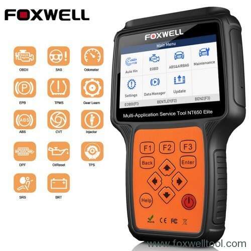

ZMANALEX Posted December 11, 2020 Share Posted December 11, 2020 1 hour ago, Jack94 said: Never heard of these kind of problems when just changing a steering wheel, unless yeah your clockspring is knackered Any thoughts @ZMANALEX? The first thing to do is reset the SAS. You should not have to do this however if you moved the clockspring then this will be your issue Out 1 spline will throw the SAS out by 10 degrees and give you all the issues that you mention. If you have rotated the clockspring excessively then you may have damaged it. Try the SAS reset first. 1 Quote Link to comment Share on other sites More sharing options...
bluethermal Posted December 11, 2020 Author Share Posted December 11, 2020 Quote Thanks All, I take it resetting the SAS is a main dealer job? Will I have to trailer it or can it be driven there? Quote Link to comment Share on other sites More sharing options...
ZMANALEX Posted December 12, 2020 Share Posted December 12, 2020 have a read at this, it is fairly accurate and a DIY: http://www.foxwellsupport.com/how-to-reset-nissan-350z-srs-light-on/ Also, this actually does work pretty well: https://www.ebay.co.uk/sch/i.html?_from=R40&_trksid=p2380057.m570.l1313&_nkw=Foxwell+NT650&_sacat=0 1 Quote Link to comment Share on other sites More sharing options...
