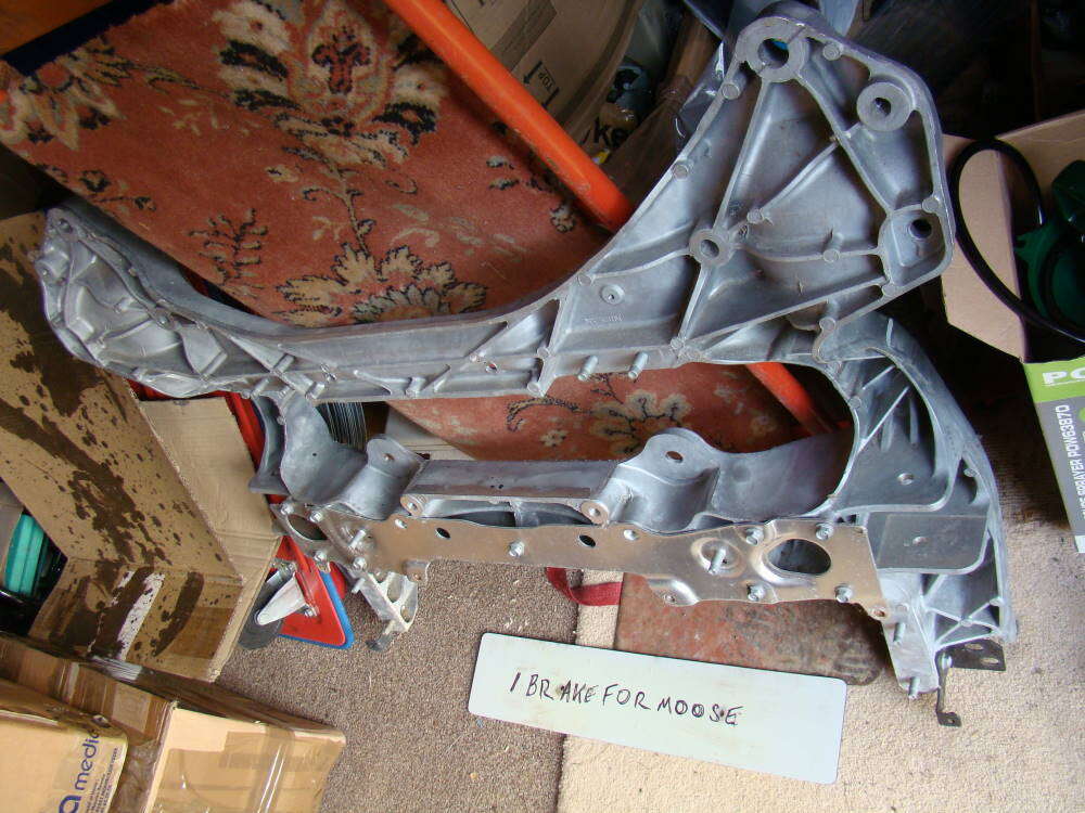

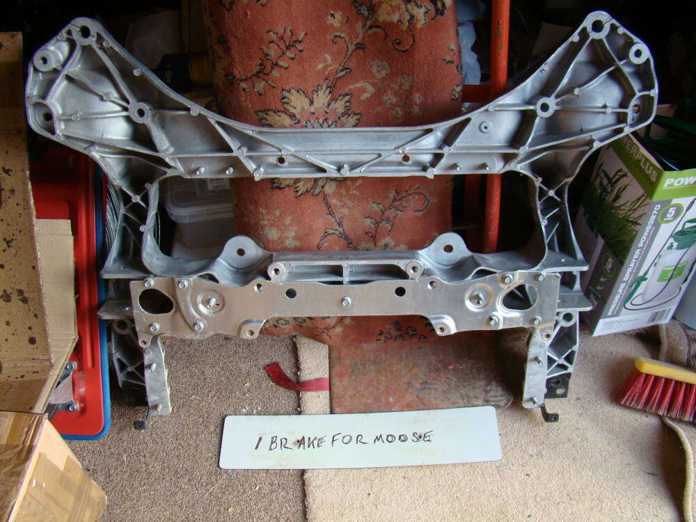

ibrakeformoose Posted November 6, 2020 Share Posted November 6, 2020 (edited) I was recommended to buy this by my local Nissan dealer and funnily enough (not!), it turns out the problem was not related to the front subframe at all.. So, now surplus to requirements and taking up room.. bit dusty now.. Cost me about £900, does £250 sound enough of a bargain? Edited January 13, 2021 by ibrakeformoose 1 Quote Link to comment Share on other sites More sharing options...

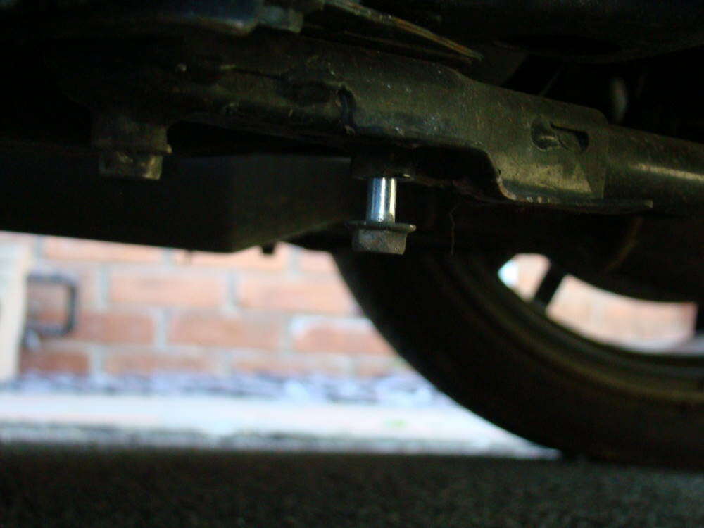

ibrakeformoose Posted November 9, 2020 Author Share Posted November 9, 2020 They won't take it back, unfortunately.. After repeated days and days of diagnostic work they couldn't find the issue with the car (only 3,000 miles old, but been stood for a long time inside). They did managed to alter the geometry of the car and also leave subframe bolts at the rear of the car undone, so they nearly fell out.. I have some pics on my phone and I'll try and upload them. Success.. here's when I looked under the car after a 35 drive home from the dealer.. I stripped all the bushes, bolts and mounts out, greased them all and had it realigned (again) and now.. silence, no clicking or clonking at the front. 2 Quote Link to comment Share on other sites More sharing options...
Jack94 Posted November 9, 2020 Share Posted November 9, 2020 (edited) Glad your issue is sorted, but bloody hell that's worrying how they left your subframe bolts. They sold you (very expensive) parts you didn't need and gave your car back to you in an unsafe condition... And people wonder why I'm so against main dealers. Edited November 9, 2020 by Jack94 1 Quote Link to comment Share on other sites More sharing options...
