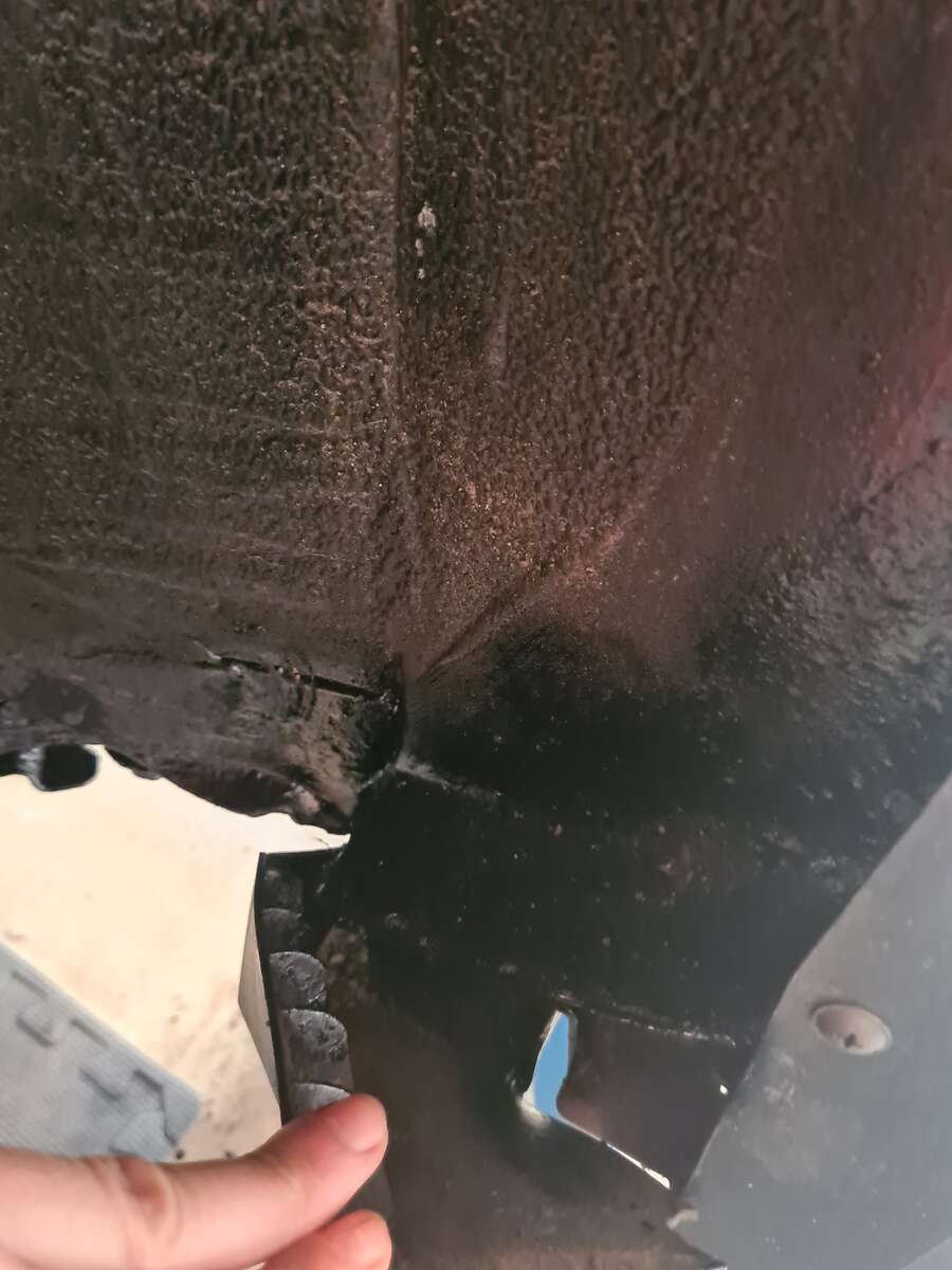

dave_7 Posted November 6, 2020 Share Posted November 6, 2020 this has got me paranoid another spot to look out for is at the front of the rear wheel arches, there is some sort of plastic cover, that rather tha keeping the dirt out just acts as a muck trap and get filled with all sorts of muck. Its easy to pull it out they way and clear all the crap out when you have the wheels off. I'll try and dig out the pics of when i tackled mine during the first lockdown 2 1 Quote Link to comment Share on other sites More sharing options...

dave_7 Posted November 9, 2020 Share Posted November 9, 2020 this is mine after i treated the rust... followed by a couple of coats of rubberised paint and some underseal. Would recommend having a look as its far easier to deal with at the early stages. 1 Quote Link to comment Share on other sites More sharing options...

Lewis Schwier Posted January 9, 2021 Share Posted January 9, 2021 When I was inspecting my arches and giving them a good clean I noticed they had kept quite a few things that were the same design as the 350z. One being what @dave_7 mentioned. That Black rubber bit that seals the front of the back arches. It is literally a dirt trap and as usual was FULL of mud. Secondly I noticed the amount of water that gets trapped between exactly where you said, between the rear panel and side skirts. I used the blow dryer couldn't believe how much trapped water came from that area. Another poor design from Nissan unfortunately. Shame these cars weren't under sealed from factory. 1 Quote Link to comment Share on other sites More sharing options...
