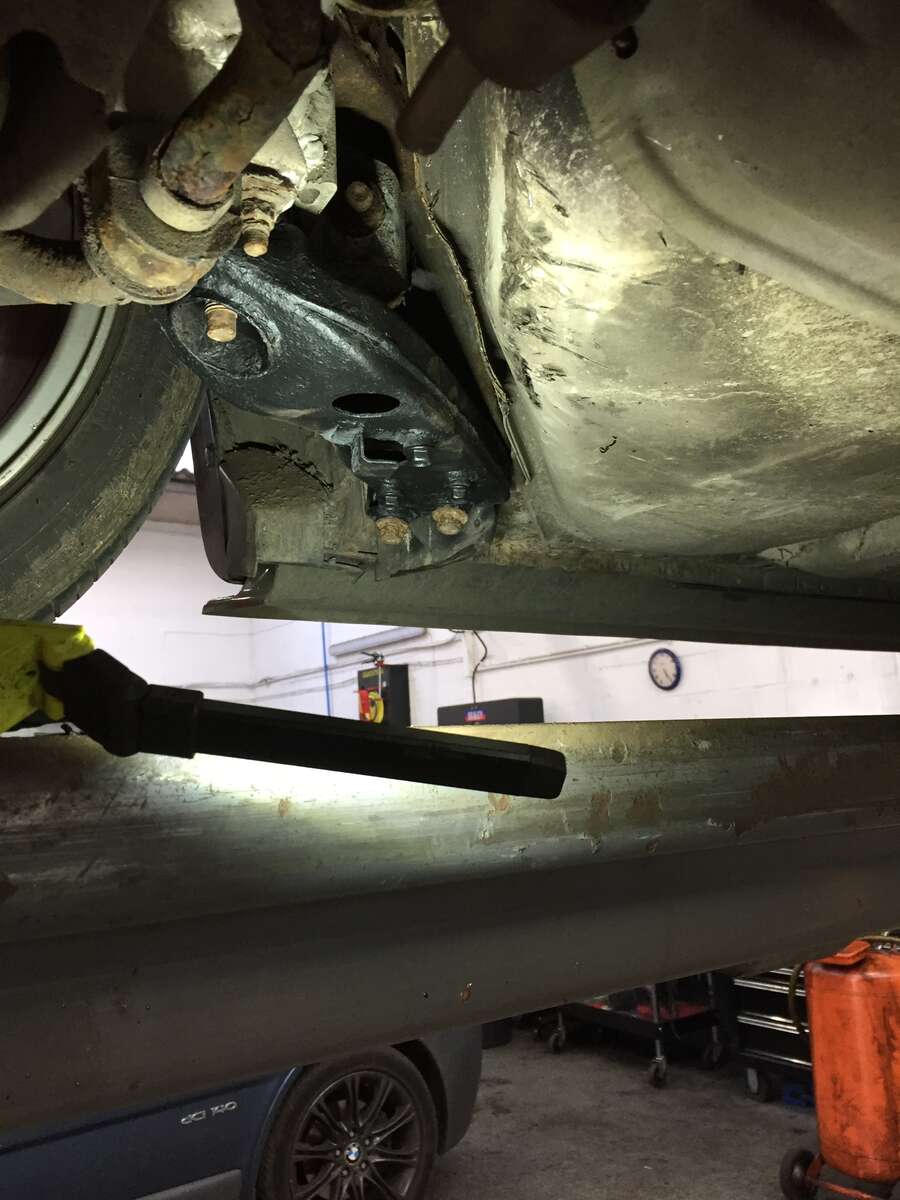

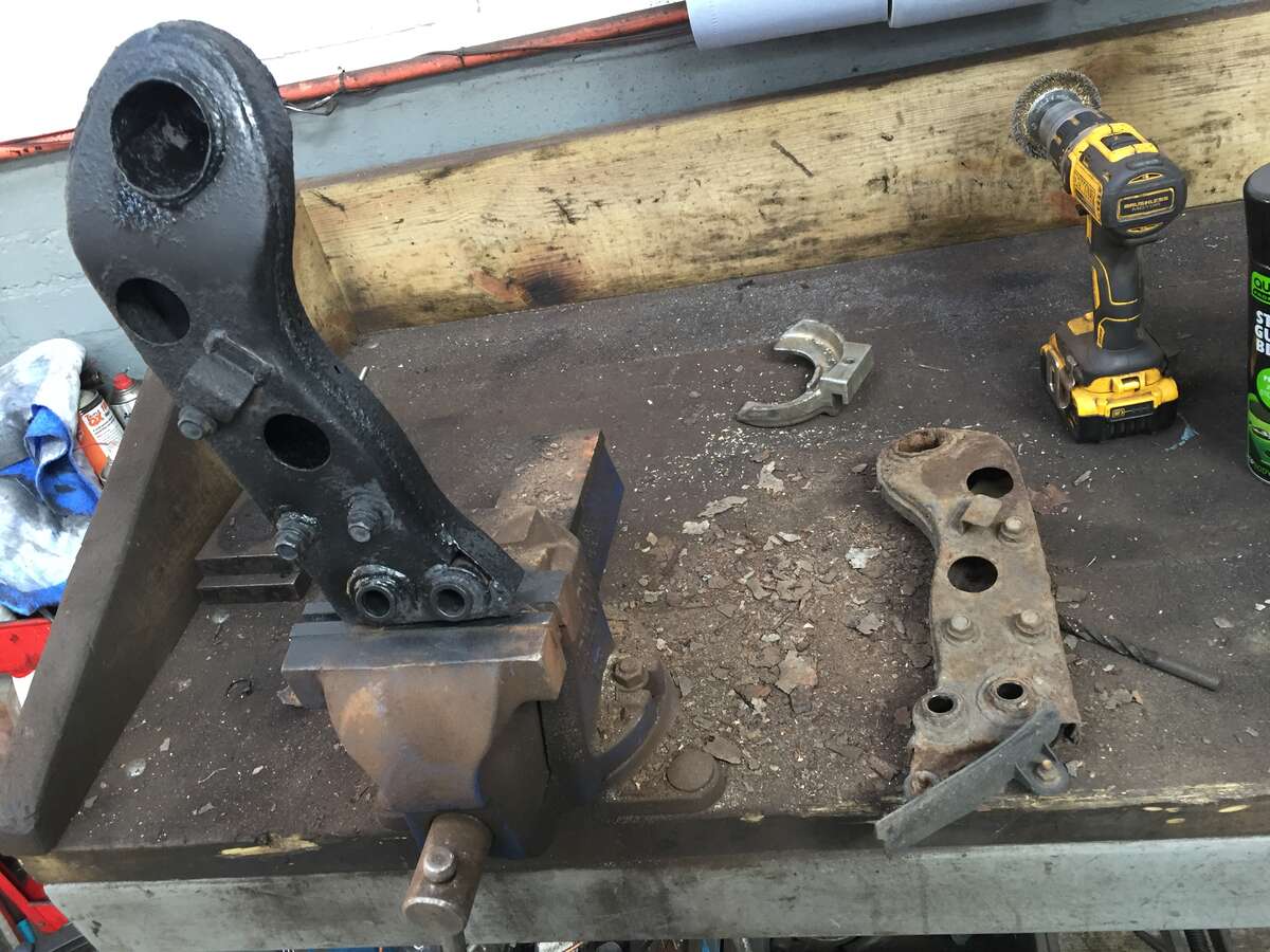

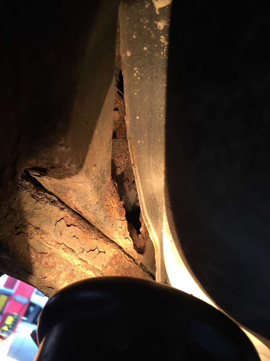

Valandile Posted October 17, 2020 Share Posted October 17, 2020 (edited) Edit: Passed the MOT, thanks to @ZMANALEXfor the parts and to Simon from Nis-Tec garage in Swansea for taking this on and doing a great job. Spent 3 days drilling out all the bolts and doing other bits of work. Back on the road and loving the Zed again Hey all, had some bad news on my MOT and now I'm without my Z I'm not sure how this wasn't picked up in previous MOT's because there's no way this has rusted like this within 12 months. I would have changed this before it got this bad if I knew. I've tried searching for existing posts but I don't know the name of this part. I have a few questions if anyone can help as I'm a bit stuck. What's the name of this part? (The W bracket/brace at the rear underside). Anyone stocking it or able to recommend a site? I've heard that getting car parts is difficult with COVID delaying shipping from abroad. Any recommendations of who can do this type of work in South Wales? Anyone had a similar problem? The MOT garage said they wouldn't do this type of work and they don't know how far the rust has spread. Edited January 17, 2021 by Valandile Update Quote Link to comment Share on other sites More sharing options...

Azurez33 Posted October 17, 2020 Share Posted October 17, 2020 Yes that’s the W brace the two kidney braces and the panel that goes behind the fuel tank, all are easy enough to remove and shouldn’t be bank breaking to replace I did one recently Quote Link to comment Share on other sites More sharing options...
Azurez33 Posted October 17, 2020 Share Posted October 17, 2020 Rust won’t have spread any further just that panel and the braces usually go badly like that as zmanalex warned me! The brace and kidney braces are a fail the panel above it isn’t because it’s bolted to the body Quote Link to comment Share on other sites More sharing options...

Valandile Posted October 18, 2020 Author Share Posted October 18, 2020 13 hours ago, Azurez33 said: Rust won’t have spread any further just that panel and the braces usually go badly like that as zmanalex warned me! The brace and kidney braces are a fail the panel above it isn’t because it’s bolted to the body That's a relief to know it's been done, thanks for sharing the photos. I was a bit worried because the MOT station said they've never worked on a Z before so they have no idea how bad it is. Mind you it's the same where ever i take my Z all the mechanics say they've never worked on one before so it's always a new problem for them and they are all unsure. Quote Link to comment Share on other sites More sharing options...

Azurez33 Posted November 22, 2020 Share Posted November 22, 2020 Jesus, it’s not a bad job at all, I was originally a bit worried to start with but honestly took me a couple of hours to sort the whole thing for @Monkey1983 , you should try telling them it’s literally about 4 nuts and 2 bolts to remove it and you only need to re fit the new kidney braces and w brace and you’re golden Quote Link to comment Share on other sites More sharing options...
