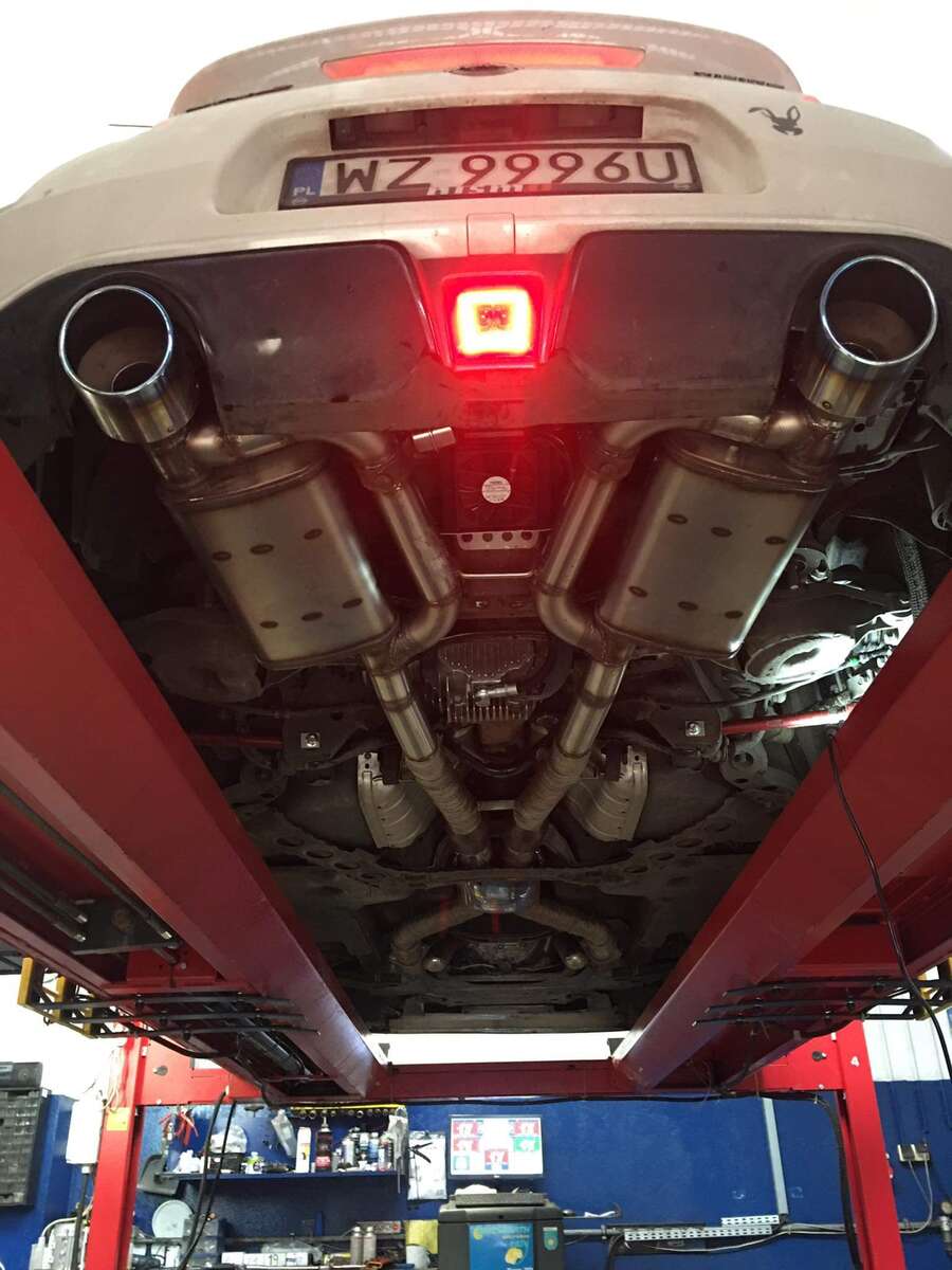

Custom Build 2.5 inch X-pipe Valves Controlled Exhaust

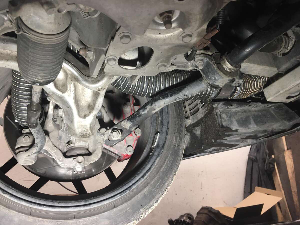

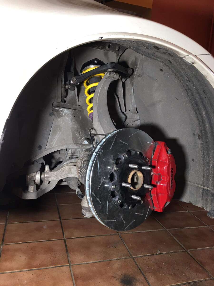

As requested more pictures of brake cooling kit. It it fully custom design, but proved to be highly effective on the race track.
93129117_709679903170535_5210657759481036800_n.jpg.b88f3f23ca356951261e5ee6cfb2ab15.jpg
92912988_230460628297094_3447844138563665920_n.jpg.4f74259aede5d9b58d41e46b3fa70e9c.jpg
93198757_656269914934803_7979836072446132224_n.jpg.f74e2ff1340690e4a9b1fc69bfda95d7.jpg
93102842_241903970332445_5529893032096169984_n.jpg.48e7737b0c9b307d8c60ed544486b354.jpg
Titanium brake pads shrims - they are suppose to reduce temps of brake fluid and to protect the brake calipers from high temperature. So far I think they have been working out pretty well. My brake calipers are in great condition and never really overheated my brake fluid yet on this set up.

thanks for the extra detail, looks a really good set up. And its great to see another 370z used in anger round a racetrack
I really like this car and you clearly only fit the best parts. If money was no object for me my car would end up something like this!
I suffer with burning up the dust boots in the front calipers alot. I spent 2 days stripping the front caliper down and replacing them along with the seals while I was at it, only to burn them up again on the next track day! Which was annoying to put it mildly!  I actually find the the stock calipers very good with the right pads and brake fluid in and they take the abuse really well, however extra cooling would make this even better. Plus if the titanium shims can keep some heat sway from the caliper its self that great for the caliper and the fluid.
Apparently most track guys in the US don't even run with dust boots anymore and many manufactures of aftermaket calipers aimed at track/race use dont have them in either as they just cannot take the heat.
I currently take the pads outs the clean inside after every trackday to keep any crap from getting at the seals. Key is to never push the caliper pistons back in until its all clean in there, that ways you never draw any muck into them and reduce the risk damaging the seal or piston. Its not perfect but i did inspect all the pistons when i did a full strip down to replace the seals and they were all still perfect.
