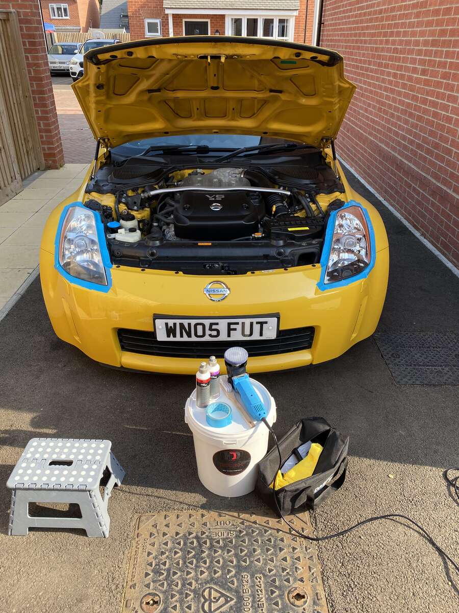

alexgv1 Posted September 16, 2020 Share Posted September 16, 2020 Took to this task myself today as my headlights were starting to get hazy. I used Koch Chemie H9.01 on a DA polisher and it all went after one test pass. There are still some fine scratches but as with all thing detailing wise, I got the results I wanted so thought I’d call it a day as I’d managed to avoid wet sanding. Followed up with Koch Chemie M3.02 which didn’t do much as they were already pretty much crystal clear. Just in between coats of Carbon Collective Platinum Trim. I’ll report back on how well it does and how long it lasts but it claims UV protection for up to two years. Before and after is below. 2 Quote Link to comment Share on other sites More sharing options...
Sim Posted September 18, 2020 Share Posted September 18, 2020 On 16/09/2020 at 16:48, alexgv1 said: Took to this task myself today as my headlights were starting to get hazy. I used Koch Chemie H9.01 on a DA polisher and it all went after one test pass. There are still some fine scratches but as with all thing detailing wise, I got the results I wanted so thought I’d call it a day as I’d managed to avoid wet sanding. Followed up with Koch Chemie M3.02 which didn’t do much as they were already pretty much crystal clear. Just in between coats of Carbon Collective Platinum Trim. I’ll report back on how well it does and how long it lasts but it claims UV protection for up to two years. Before and after is below. How is your engine bay not covered in white flecks? I made the mistake of not covering the rest with a dust sheet and it took an aged to get it cleaned up, in fact I bet there are still a few specs I missed. 1 Quote Link to comment Share on other sites More sharing options...
alexgv1 Posted September 18, 2020 Share Posted September 18, 2020 5 hours ago, Sim said: How is your engine bay not covered in white flecks? I made the mistake of not covering the rest with a dust sheet and it took an aged to get it cleaned up, in fact I bet there are still a few specs I missed. Luckily the Koch compounds aren't too dusty. Some did get onto the plastics but I brushed it off. Saving a proper engine bay clean for another day 1 Quote Link to comment Share on other sites More sharing options...
