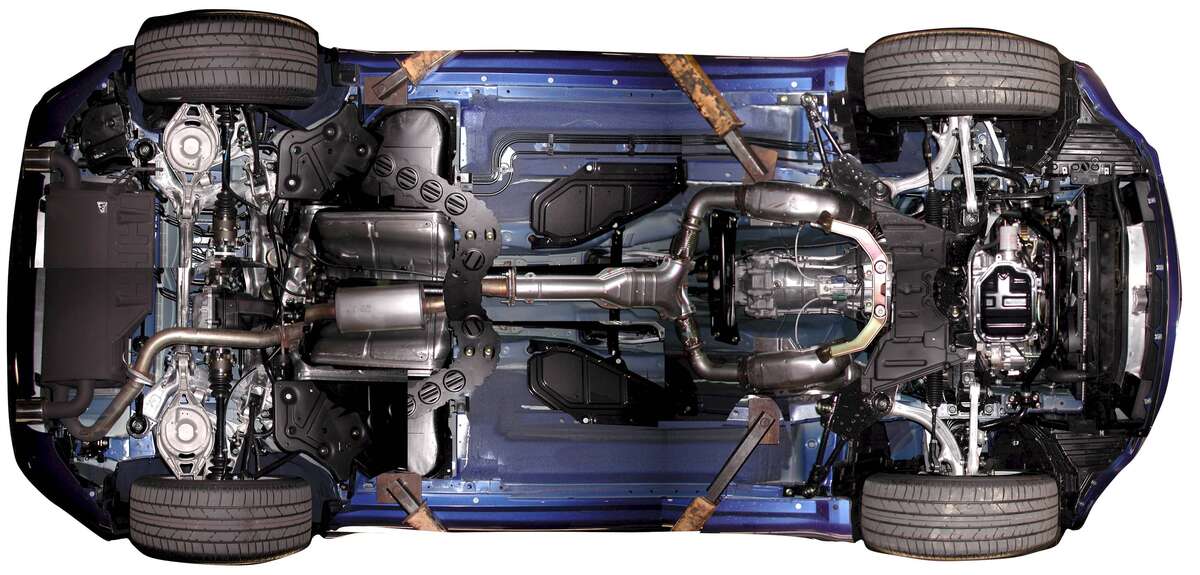

davey_83 Posted August 18, 2020 Share Posted August 18, 2020 This is the underside of a 350z for reference 2 Quote Link to comment Share on other sites More sharing options...
Azurez33 Posted August 18, 2020 Share Posted August 18, 2020 Green is the support brace which is massively abused by corrosion but I’d doubt by the wording on the Mot the tester means that, in red is the panel my self and another member have had rust through on us and Alex helped us out by showing us it’s literally a separate panel, you can’t really see it on the diagram but here’s the picture Alex sent us below, it sits behind the kidney braces the W strut mounts to 1 Quote Link to comment Share on other sites More sharing options...
