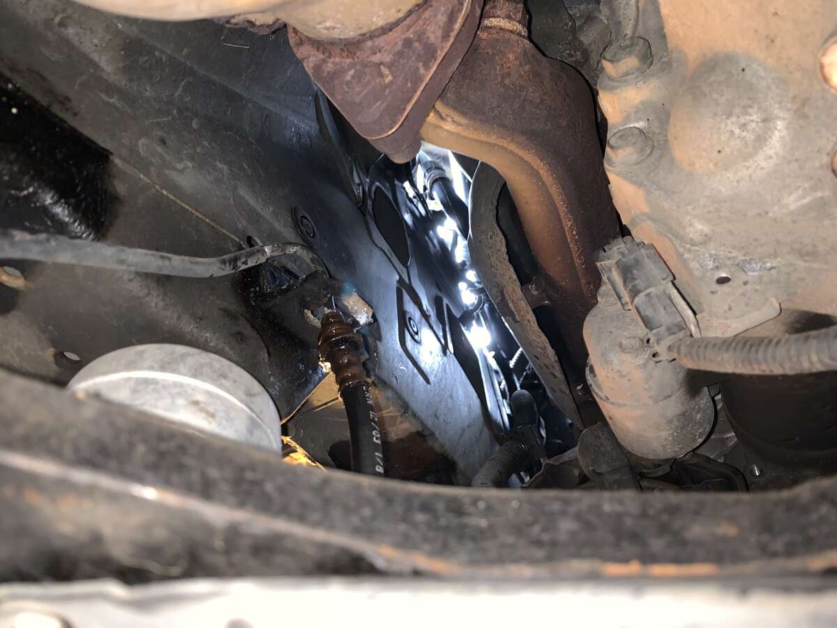

Ry-B Posted August 7, 2020 Share Posted August 7, 2020 Hi all, Replacing the slave cylinder and also swapping to a stainless steel line, hit a bit of an issue trying to get the OEM line off from the hard pipe, I’ve got the clip off but assume it’s threaded with the 10mm nut which I can’t get to budge . Any advice on how to do it? Many thanks Quote Link to comment Share on other sites More sharing options...

Ry-B Posted August 7, 2020 Author Share Posted August 7, 2020 4 hours ago, davey_83 said: Sorry to hear this, put the clip back on as this will support the hard pipe as you try to slacken it off. Thanks Dave, managed to get there in the end but did put up quite a fight, now having the fun task of trying to bleed the clutch which of course isn't going to plan Quote Link to comment Share on other sites More sharing options...
