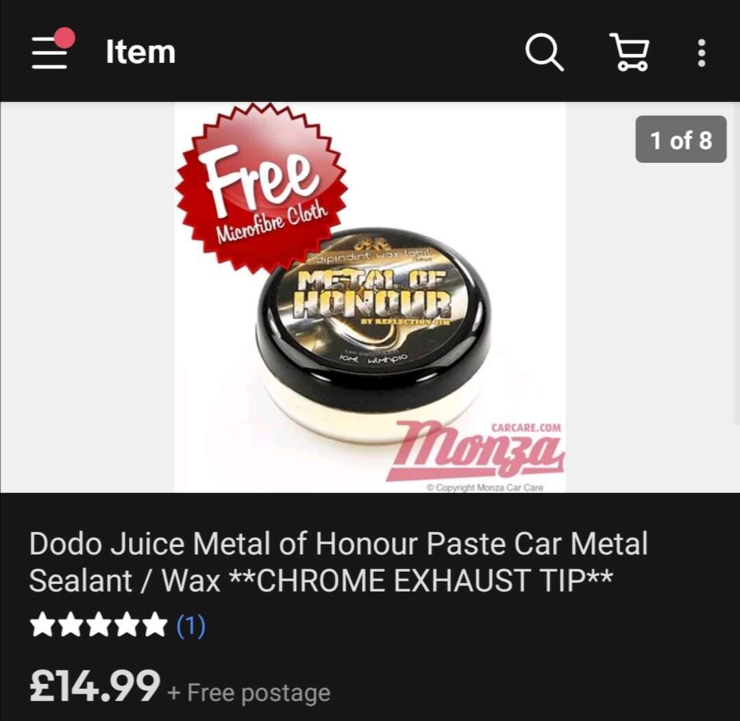

vq35de.sam Posted July 20, 2020 Share Posted July 20, 2020 I'm trying to find something ASAP to keep my new ISR single shiny (the backbox and tip) the inside too so that the black soot can be cleaned off easily as well.., if that's possible. I've used autosol on my last car but it never kept the tips nice for any lenght of time.. So I'd like something for protection and longevity. I've come across a product on ebay on a quick search called Dodo Juice metal of honor sealant wax.. Any one have any say or recommendations to something else? Quote Link to comment Share on other sites More sharing options...

ilogikal1 Posted July 21, 2020 Share Posted July 21, 2020 As Davey says, to keep it clean requires regular washing/polishing. Protecting it will make it easier though. Waxes like the one you've linked are better than nothing. Sealants like Britemax will last a bit longer than wax. Coatings (like this, or this) will last considerably longer, but you'll still need to wash regularly - for the inside, depending on how much you drive the car you might have to wash it as often as use it. Clean, polish, IPA wipedown then apply your LSP of choice for maximum protection (with the exception of the Britemax twins which are designed to be used in conjunction). Quick wipe-over every week should then keep it shiny for a good while. Quote Link to comment Share on other sites More sharing options...
