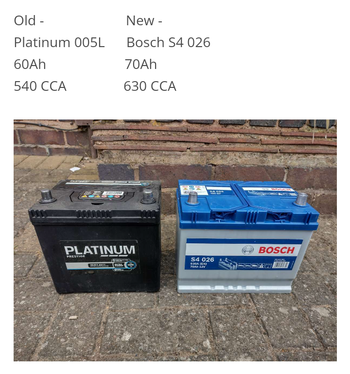

neo Posted March 1, 2024 Author Share Posted March 1, 2024 Battery arrived, well packaged, now if the monsoon outside would stop I'll fit it 🤣 Quote Link to comment Share on other sites More sharing options...
neo Posted March 1, 2024 Author Share Posted March 1, 2024 Finally got a break in the weather, easy to get the panels off but how heavy and awkward to get the old battery out 🤬, weighs way more than the Bosch one and no handles either, anyways got the new one in easily, 3 clips broke when putting them back in as they were quite brittle so need to source those, also had to do the window reset, seems to start much better 😀 1 Quote Link to comment Share on other sites More sharing options...
GranTurismoEra Posted March 5, 2024 Share Posted March 5, 2024 Glad i fitted mine myself a bit of a pain but hey ho. The new owner got to enjoy 5 year bigger bosch battery lol Quote Link to comment Share on other sites More sharing options...

davey_83 Posted March 6, 2024 Share Posted March 6, 2024 I didn't realise you had a 70z lol Quote Link to comment Share on other sites More sharing options...
neo Posted March 6, 2024 Author Share Posted March 6, 2024 2 hours ago, davey_83 said: I didn't realise you had a 70z lol well its gone in and seems to work so all good 1 Quote Link to comment Share on other sites More sharing options...
