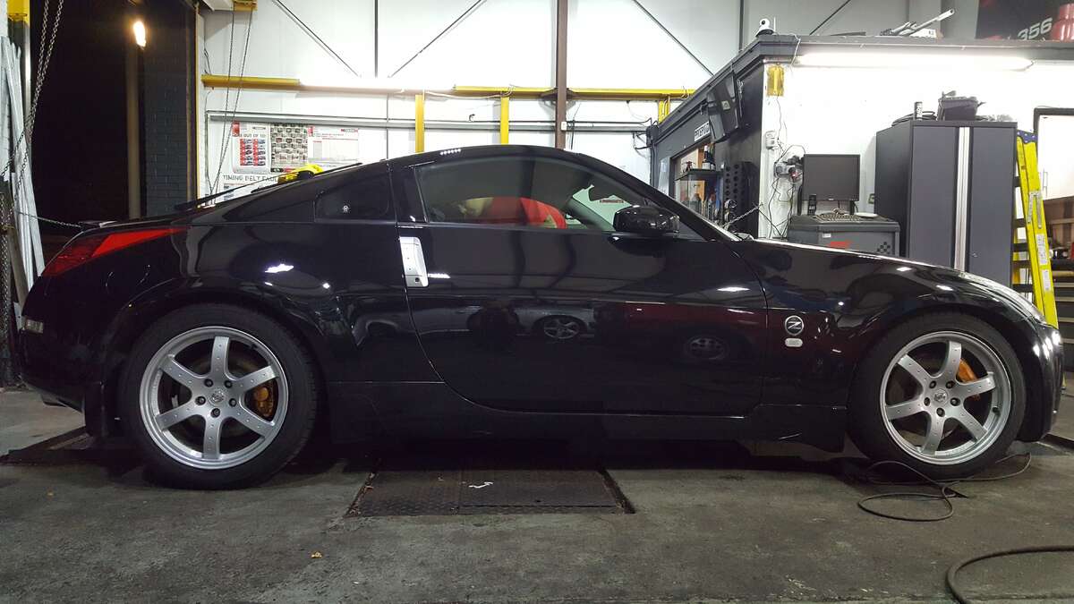

Here's the car on the day I collected it around three years ago. It was a completely standard 2006 revup model, Complete with horrendous stonechipped front end and loose wheel on the journey home due to the previous owner having a tyre fitted by an incompetent company:doh:
The day after collecting it I took it straight to the peak district to see what it was capable of and was very impressed, It's a much bigger, heavier car than the mx5 but still very agile

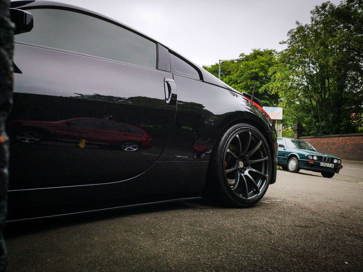

The bodyshop had to wait a few weeks though as I'd just bought a set of ultralite r5's along with a set of khumo tyres
I didn't waste any time in getting them fitted, But that ride height just wasn't cutting it, So ordered a set of -30mm apex lowering springs as I couldn't be bothered with the hassle of coilover maintenance after the mx5, I wanted something that I could fit and forget.

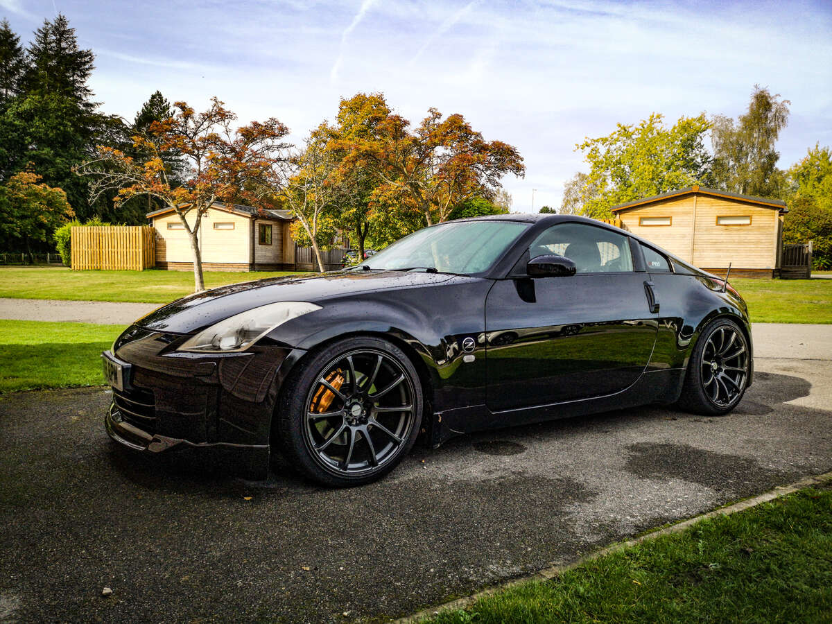

Managed to get a few pics showing the quality of the front end respray, Although there were a few flys stuck to the bumper :doh: Sorry for the crappy instagram quality photos btw
Screenshot_20200708_215352.jpg.568ad585891b86ce686e57878efa9489.jpgScreenshot_20200708_215156.jpg.8076804872ece385f733cd0d5c755e65.jpgScreenshot_20200708_215412.jpg.82b97fba940496577153c32e395a602c.jpg
To be honest, This was the car in it's best form for me. I wish it still looked like this, Simple, clean and subtle

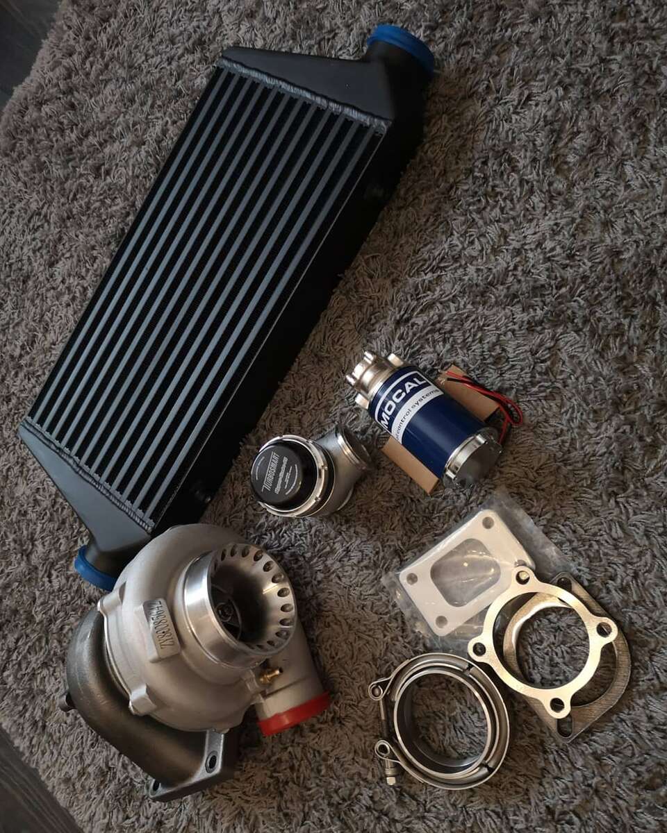

I was enjoying the 350z, But something was missing. As the show season started, My customers started booking in their skylines, 200sx's, soarers, Evos etc and I just couldn't help but get turbo envy.
So, The only thing to do was order more parts and start planning my next move.
IMG_20190415_224224_819.jpg.b9b1f28ce3ebed74a00fd97d0940527f.jpgIMG_20190501_200749_873.jpg.b0c5cead2bbb4213f5a31f592f289bd8.jpgIMG_20190501_200749_874.jpg.04bbaa524b7fae651df678a4373b4f6f.jpgIMG_20190522_201904_209.jpg.d3667d83f8f651db392ca390b8ceb1d3.jpgIMG_20190523_181026_638.jpg.4ced67cd3a386e5a9d3900cb1f35c694.jpgIMG_20190903_214736_138.jpg.85103b7e6e248bde8444a299e13694d6.jpgIMG_20190813_204551_393.jpg.f627603d5a4098738359415ad1b9bb31.jpg

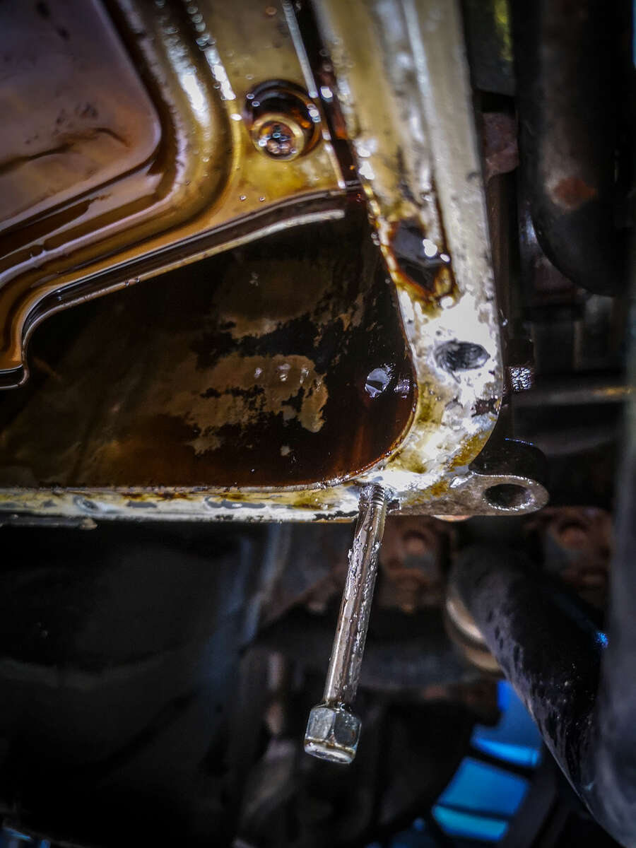

Next up was the high capacity winged sump. Unfortunately someone had previously fitted a sump pan to the car before my ownership and used silicone adhesive on the pan, Rather than manufacturers spec sealant or even RTV. This lead to three of the sump pan bolts snapping on removal :doh:
A bit of drilling, tapping and a few thread inserts later, and it was as good as new.

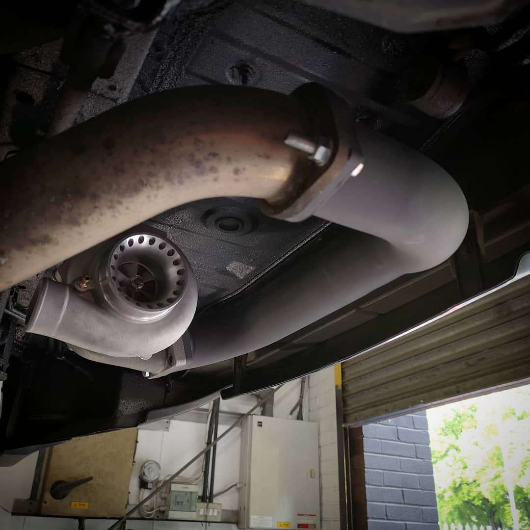

Next up I fabbed up a pipe to mount the turbo and got it bolted in position. I chose a rear mount purely based on the fact that it's a first for me, I've done plenty of conventional turbo conversions, But never rear mount so thought it would be an interesting project.
This position puts the turbo slightly off centre towards the offside of the car, Which lines the outlet of the turbo up well for the intercooler pipework.

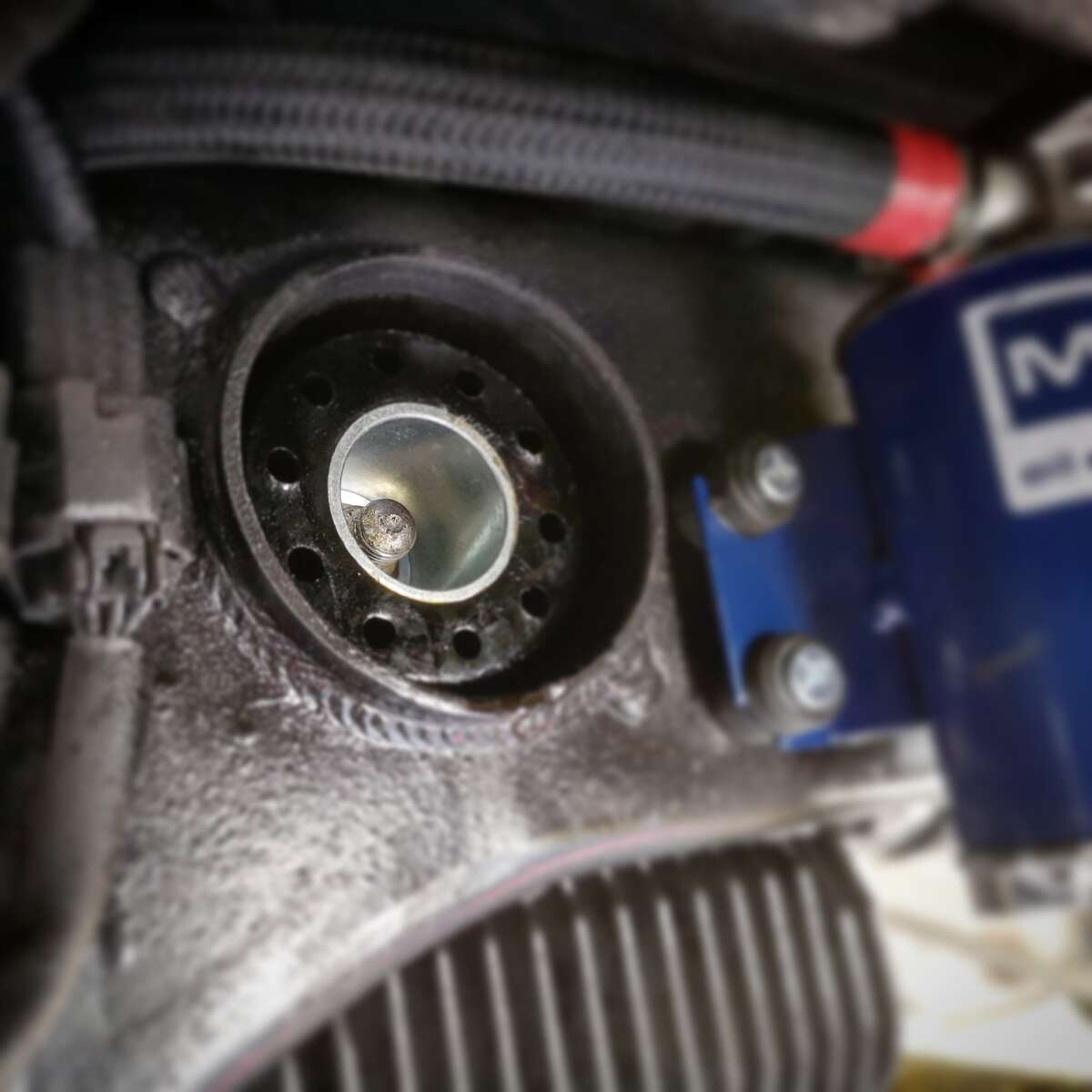

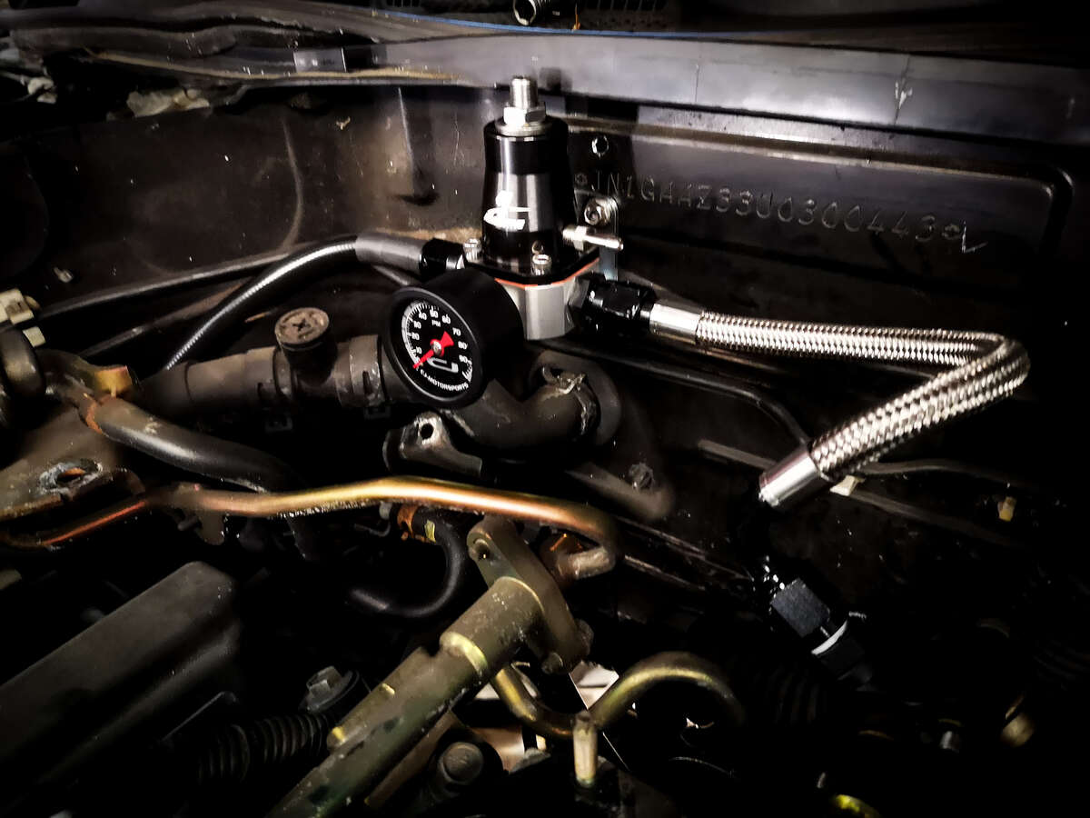

I then fitted the fuel return system and aem fuel pump to help with fine tuning the fuelling when mapping time comesLRM_EXPORT_362319233680126_20190905_000426586.jpeg.1b87bee10ff176fb7297ca2a5829d9ce.jpeg

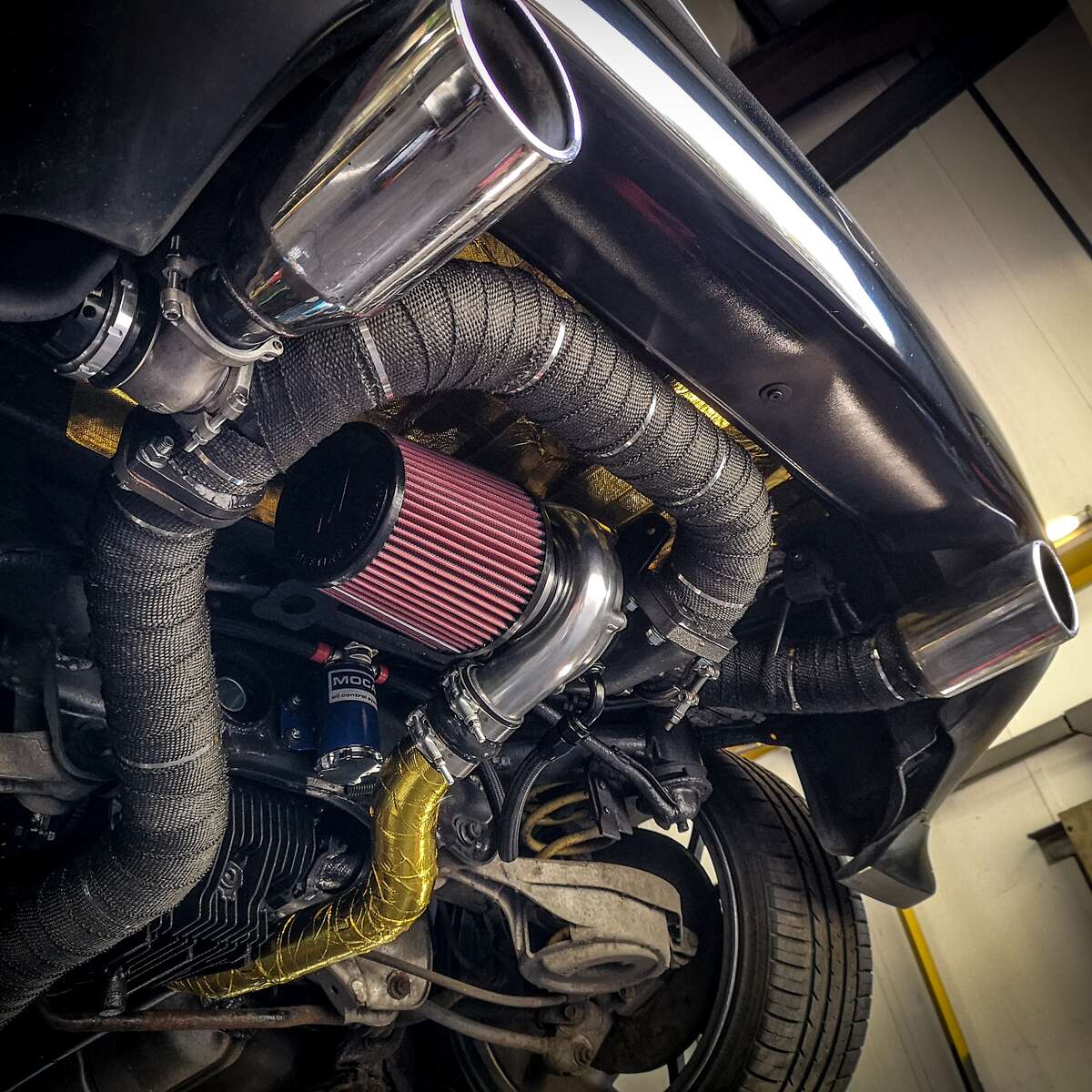

I welded the tips from the k2 exhaust onto the exhaust once everything was in position, And coated the exhaust in an ultra high temp hardened paint.

I then heat wrapped as much of the exhaust pipework as I could bare to do and fitted a proper sized air filter. This will be boxed in eventually with a stainless shield.
I also added some gold reflective heat tape for maximum scene points.
