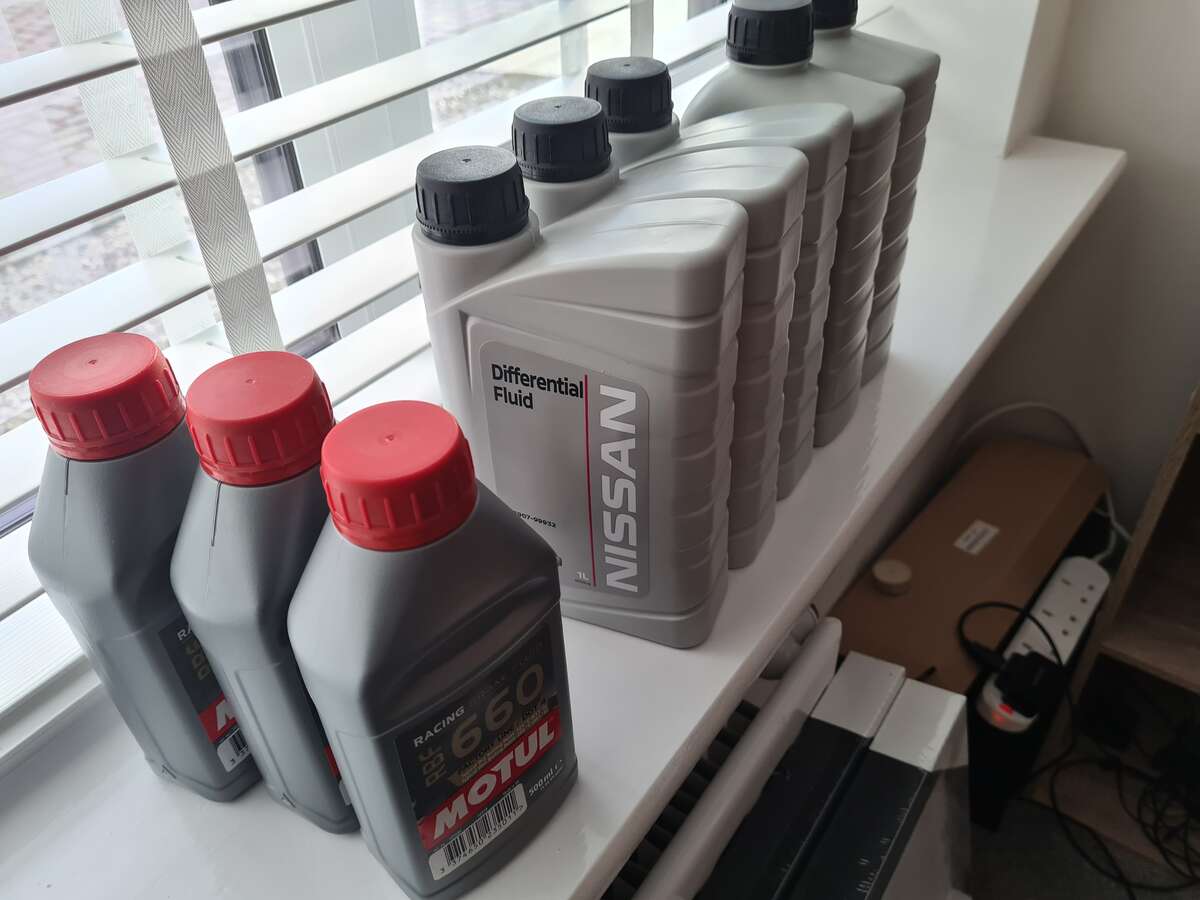

dave_7 Posted October 14, 2020 Author Share Posted October 14, 2020 Sorry, for the lack of updates with this... we had a baby so so both time and money are at a premium at the minute. Only real update is fresh gearbox, diff, brake and clutch fluid going in at some point this week. For those who are interested i give the Motul rbf660 hell and track and it never lets me down (swap it out every 4 or 5 track days) Have been toying with the idea of getting a set if 18x10.5 wheels as the square setup with plenty of tyre at the front as it would be far better for me than the 19" staggered setup. Plus more good semi slicks are available in 18" and are far cheaper, and being able to rotate tyres would be a massive bonus. Dilemma I'm having is do i sell the mk1 nismo wheels, (which i absolutely love the look of) and get something proper top shelf like some TE37s, CE28, lmgt4 Omori factory spec etc..... or do I keep the nismo wheels and get some cheaper but still light wheels like some Enkei RPF1 or Rays gramlights. I'm not sure why but i only really want to sell the Mk1 Nismo rims if they're getting replaced by something equally a cool otherwise i feel like i am depreciating the car for some reason I am in no rush to decide as i still have tyres left and there are other parts of the car that need addressing first and i don't have infinite cash money, but anyone with any useful input on this let me know Quote Link to comment Share on other sites More sharing options...

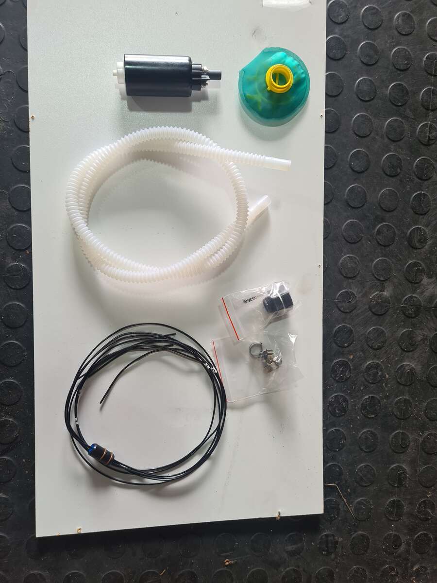

Mark@Abbey m/s Posted October 19, 2020 Share Posted October 19, 2020 On 21/07/2020 at 08:02, dave_7 said: In other news, additional fuel pump is here courtesy of @nissanman312, so i big thanks to him for sorting this out! Just need a few more bits and that will be ready for fitting and testing. All parts are from Protec, so should be no issues with quality. Short term plan for testing, I think I am just going to wire it to a 12v plug, route it to inside the armrest console and simply plug it in when at the track, before hard wiring it in with a switch further down the line. This could be controlled via Ecutek Race Rom , we can control a relay , so we could use Air flow meter voltage or Injector pulse width to control the relay that controls the fuel pump Quote Link to comment Share on other sites More sharing options...
dave_7 Posted October 20, 2020 Author Share Posted October 20, 2020 19 hours ago, ShortPaul said: https://h-dev.co.uk/our-services/servicing-and-maintenance/370z-servicing/ https://www.nissan-cdn.net/content/dam/Nissan/za/Maintenance/370Z.pdf This is what ive been working off, either way I'd say every 2 years is about right. 18 hours ago, Mark@Abbey m/s said: This could be controlled via Ecutek Race Rom , we can control a relay , so we could use Air flow meter voltage or Injector pulse width to control the relay that controls the fuel pump That's a great shout would be an awesome feature. I need to get my act together and get remapped with Ecutek soon Quote Link to comment Share on other sites More sharing options...

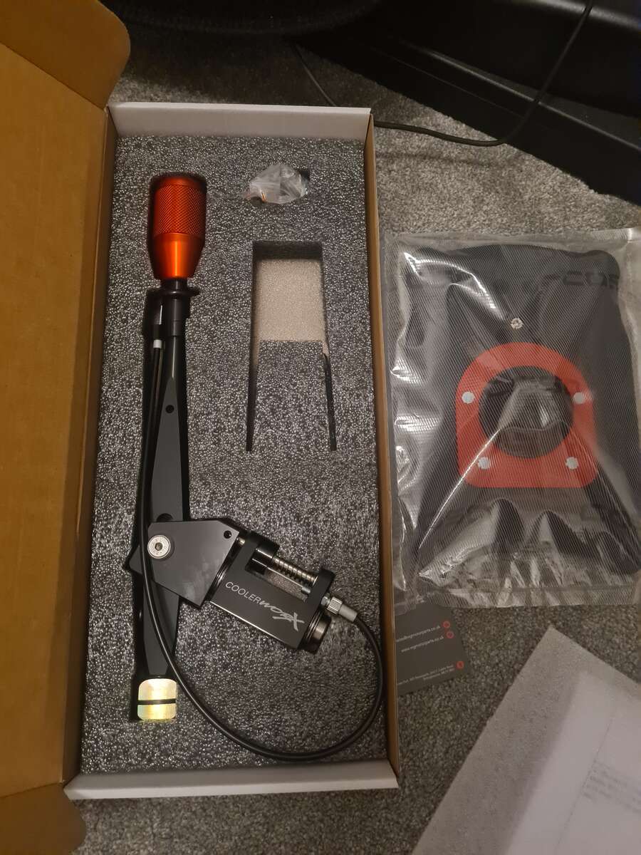

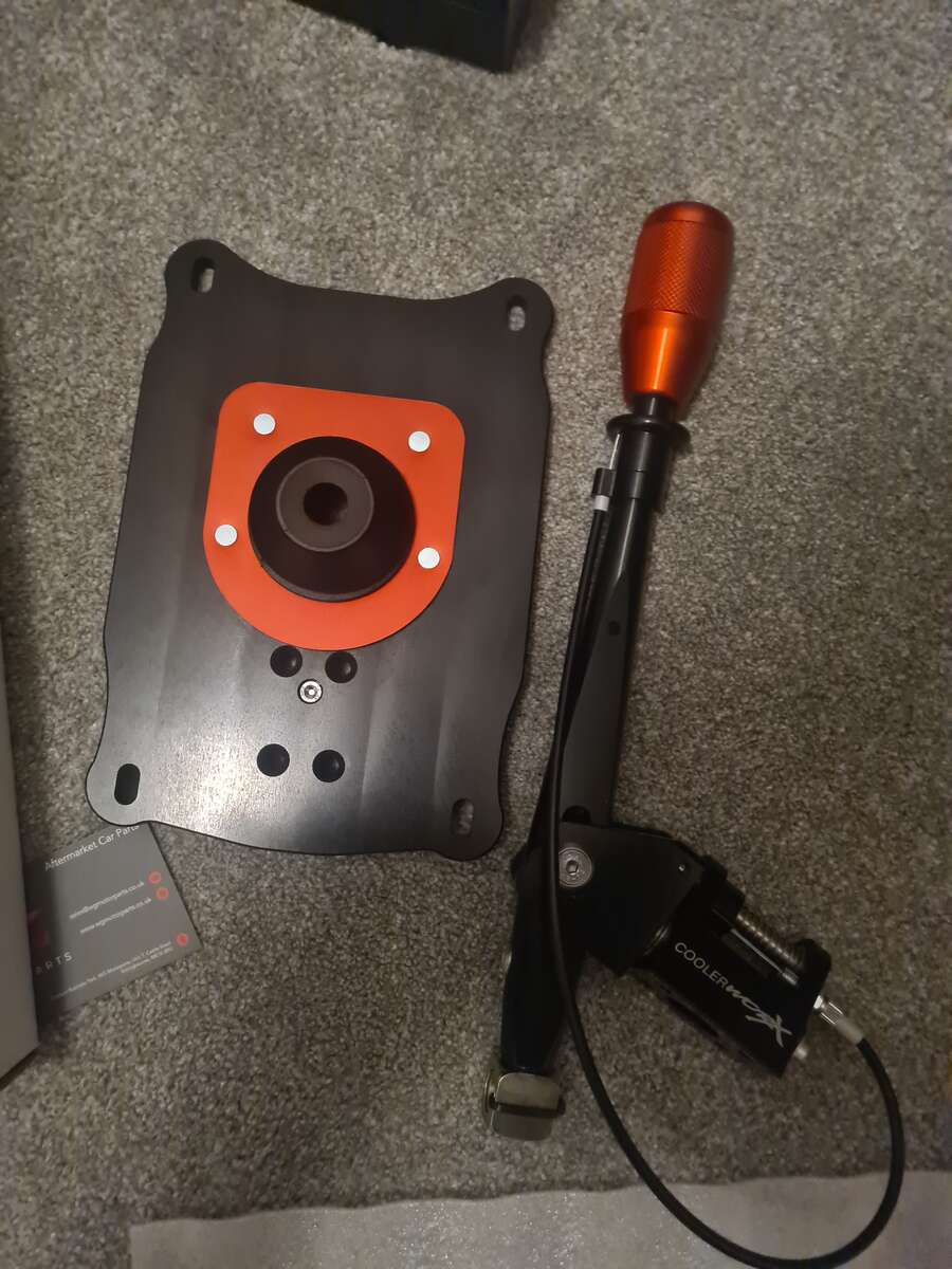

dave_7 Posted December 7, 2020 Author Share Posted December 7, 2020 First package arrived the other day. Coolerworx shifter.... the pictures don't show how nice of a bit of kit it is. Absolute x-rated filth. Cant wait to get it fitted! Most bits still to arrive yet though 1 Quote Link to comment Share on other sites More sharing options...
nissanman312 Posted December 7, 2020 Share Posted December 7, 2020 2 hours ago, dave_7 said: First package arrived the other day. Coolerworx shifter.... the pictures don't show how nice of a bit of kit it is. Absolute x-rated filth. Cant wait to get it fitted! Most bits still to arrive yet though Ohh I want to try this when you get in im tempted Just wish cae did one for us 2 Quote Link to comment Share on other sites More sharing options...

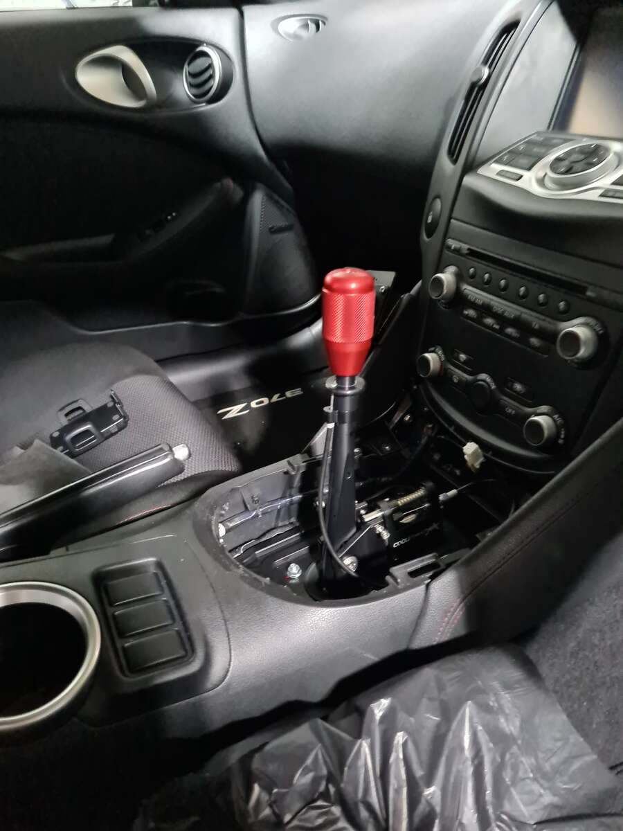

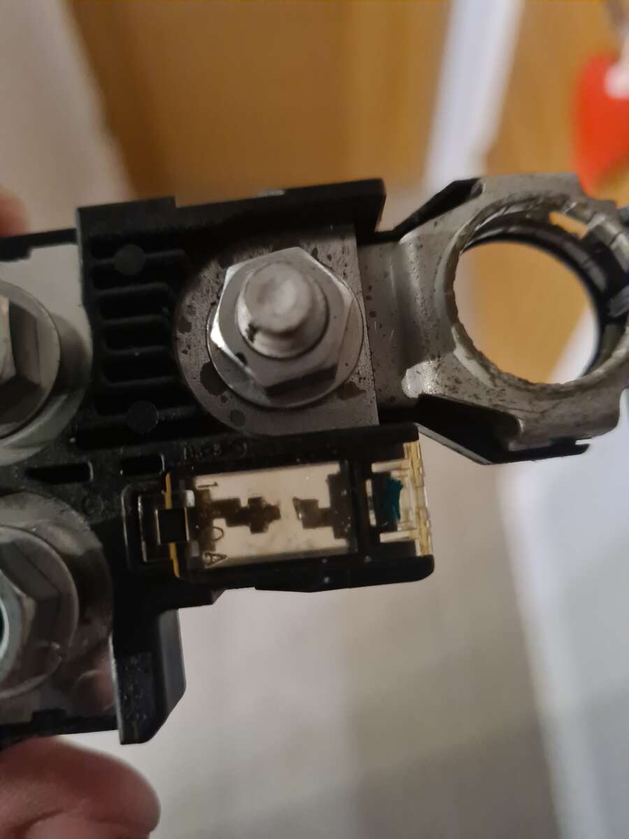

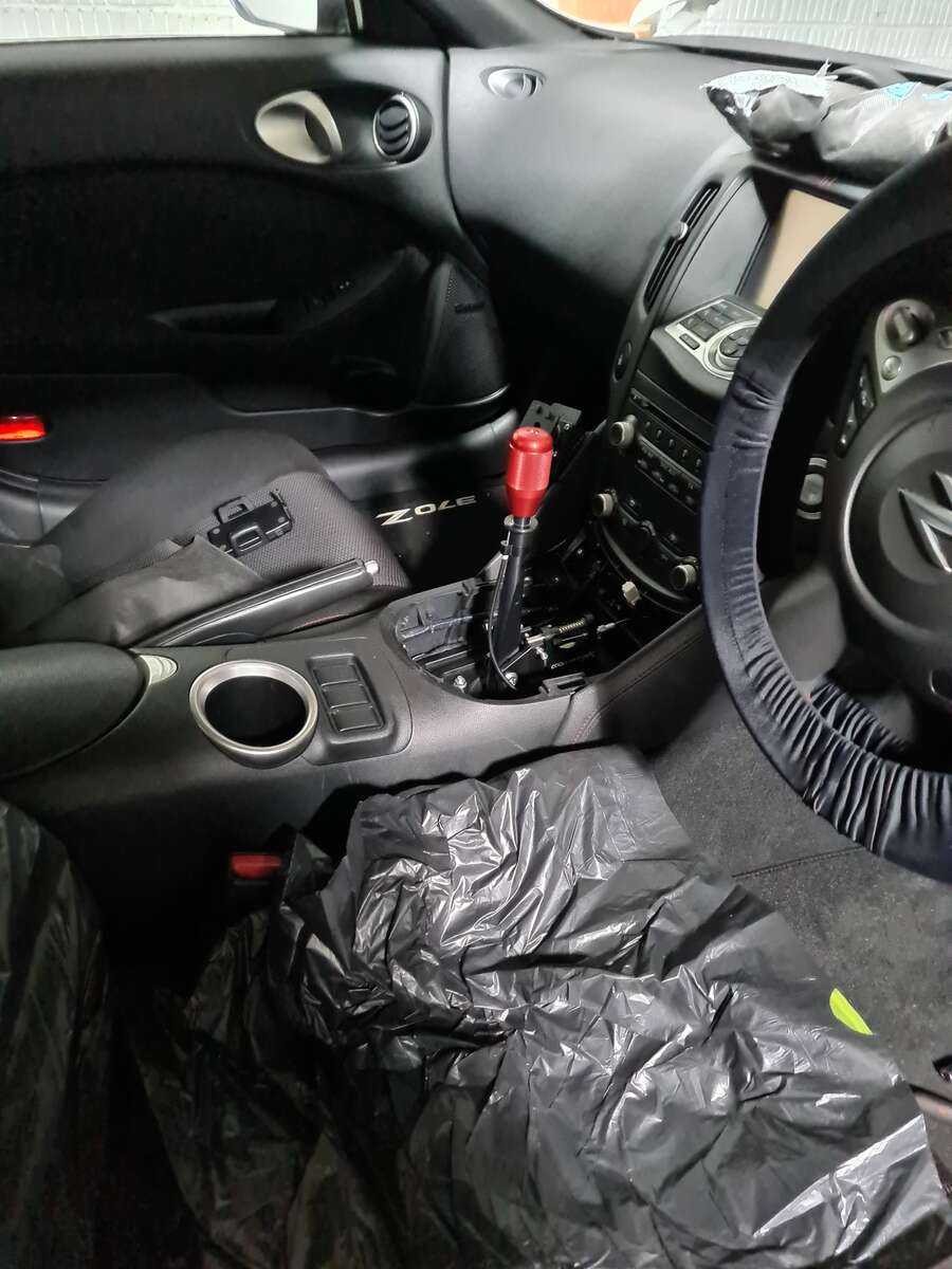

dave_7 Posted December 15, 2020 Author Share Posted December 15, 2020 little update... first off, Coolersworx shifter is fitted (excuse the missing trim from the pics). Really happy with how this looks and more importantly feels, throw is now super sort, cant wait to get it some abuse/testing. Secondly been chasing a slight electrical gremlin, somehow i managed to blow the 140A fuse in the fusible link by the battery. The fuses below it the to fuse boxes and IPDM were fine so i guess its alternator, starter motor or a batter short between terminals. Anyways after much continuity testing and poking around i count find any fault so for bypassed the blow fuse with a smaller 15A fuse just to test - i didnt want to buy the new part form nissan for 50 quid to to blow it again (check out the shonky cable tie wiring ) anyways the fuse didn't blow so i replaced it with a new fusible link and all is well again. I am guessing i may have shorting something in the engine bay while swinging spanners about in there but there is not scorch marks from a short big enough to blow the fuse or loose wiring (and believe me i searched high and low). It had a trickle charger one when it blew much is suspect but it cant be that surely! Thirdly, i have also decided not too fit the Z1 engine mounts I've got. Couple of reasons really, after fitting the new shifter and having removed the stock gearbox mount to see for myself that its an absolute saggy bag of sh*te - @nissanman312 you were 100% right on that one, i would rather sell it and use the money for a vibratechnic gearbox mount (i feel id get more benefit from it with the new shifter than engine mounts). I have also spent a bit of time weighing up the fitting out the engine mounts and i reckon its gonna be too much of a pain for me to fit with stock manifolds and heatshields still in place (I don't want to spend money having someone else do it, I am a man in his garage type and half the enjoyment is doing it myself) i just haven't got the time to be taking it on at the minute so i'm waving the white flag with it and moving on So expect to see a for sale thread with 2 brand new never used engine mount soon (or if anyone wants to swap for a gearbox mount let me know) I also took the plunge on the Zspeed aluminium undertray on their black friday deal... still made it more expensive than id have liked but its something i am in need of and its not going to get any better than 20% off. Not fitted it yet as i am waiting on other go faster parts to arrive first but its a quality bit of kit and super light weight. More parts arriving back end of the week which is going to give away my next move!! 1 Quote Link to comment Share on other sites More sharing options...
nissanman312 Posted December 15, 2020 Share Posted December 15, 2020 That shifter looks spot on pal! You won't regret that gearbox mount Paired with the shifter I would think that will be a sweet combination Did you not fancy the vibratechnics engine mounts also I believe they perform just like the gearbox mount As in max performance without the compromise on nvh levels 2 Quote Link to comment Share on other sites More sharing options...
