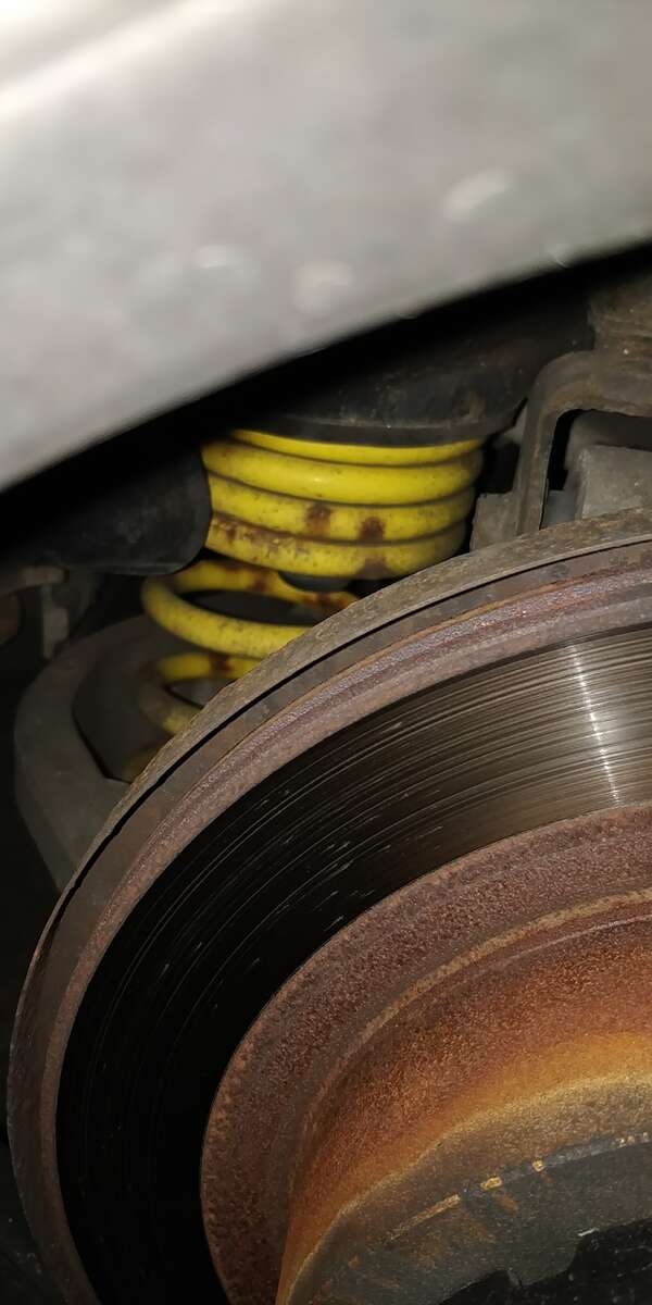

ChilledBowser Posted June 3, 2020 Author Share Posted June 3, 2020 Hi All, Thanks for the replies so far, I went out to the garage just now (needed some wood for a DIY project, that's another story) I lent over the back arches and pushed down and... nothing, I couldn't even push them down that much, like maybe a mm or two, I also got a photo... Feeling the tyres don't help me as someone put pretty much brand new tyres on it, I have a trolley jack on order and some axl stands too once they're here I can get under it for a better look. Quote Link to comment Share on other sites More sharing options...

ChilledBowser Posted June 23, 2020 Author Share Posted June 23, 2020 So I managed to get the jack and stands out over the weekend to get under the back of the car. It seems after some inspection that the springs are Apex lowering springs with some of the yellow coating split and rusted a little, the shocks look like the originals with nissan printed on them and the back left has scrappy writing on it. Should I replace the shocks and keep the springs? Quote Link to comment Share on other sites More sharing options...
ZMANALEX Posted June 23, 2020 Share Posted June 23, 2020 2 minutes ago, ChilledBowser said: . Should I replace the shocks and keep the springs? Only if they are causing the issue or if you simply just want to upgrade. Quote Link to comment Share on other sites More sharing options...
ChilledBowser Posted June 23, 2020 Author Share Posted June 23, 2020 1 hour ago, ZMANALEX said: Only if they are causing the issue or if you simply just want to upgrade. That's the thing though... I don't know if the shocks are causing the issue or the springs. I have read that lowering springs kill standard shocks. I can't see any visible oil leaks from the shock either. The ride is pretty bouncy though. Quote Link to comment Share on other sites More sharing options...
ZMANALEX Posted June 23, 2020 Share Posted June 23, 2020 Okay, then just disconnect them at the bottom and test the compression and rebound. Quote Link to comment Share on other sites More sharing options...
