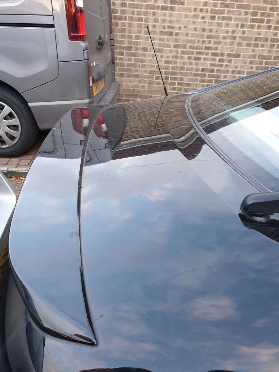

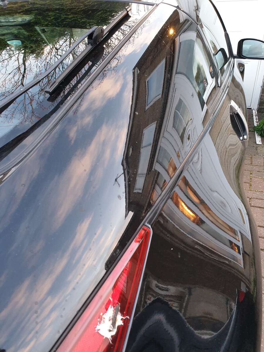

My Z has been off the road for almost 5 years, as you can imagine it's been pretty neglected in this time and has been gathering dust. (I've explained the situation on my introduction post) it's kuro black, I'd like to do a proper job on it, but my heads fried reading various forums as how best to start. So I thought I'd ask here. I want to properly clean the car, remove as many swirls and scratches as possible and get a great finish on it,
I understand people may be sick of answering such question, but if anyone can give me an idea as what steps to take from cleaning the car to the final finish, or recommend some products I would be massively grateful,

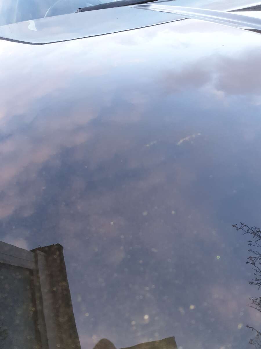

I've just nipped out to take some photos, it was quite hard to capture the swirls and scratches on camera in this lighting and where the car is parked 20200504_201016.jpg.20eb2fedbcee887cbe7e38b7311fca2f.jpg20200504_200952.jpg.80fee1b663264c18c8395c6c312bcff5.jpg20200504_201739.jpg.3cbd12583709e66a9c46ae50652a34c2.jpg20200504_200948.jpg.50f345ff778e7a5d90964a7ab1c639ec.jpg
It depends on how much time, effort and money you want to put in and what products and tools you have. Can you let us know. Ideally you want a dual action polisher for the best results when it comes to the polishing stage.
First thing you need to do is prepare the paint for correction (swirl and defect removal) which will require a thorough decontamination and clean:
