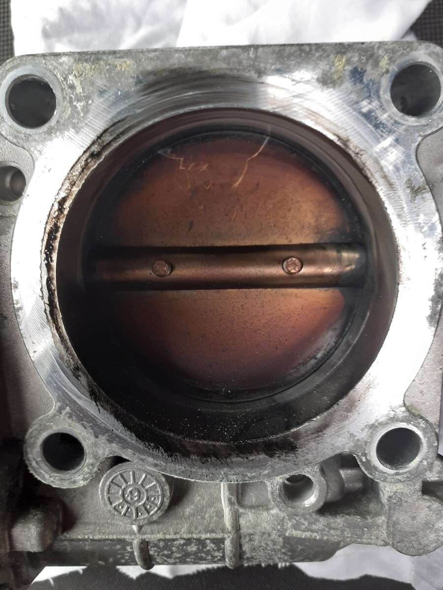

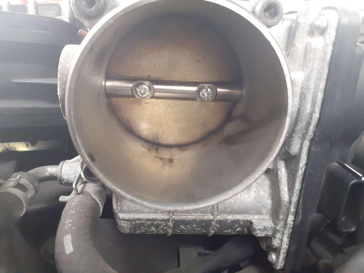

JammyJayC Posted April 29, 2020 Author Share Posted April 29, 2020 (edited) So I got bored and thought cleaning the filters and throttle bodies wouldn't do any harm. They were pretty dirty. Pics are of the nearside TB. This also seems to have addressed the stalling issues. Did a few tappy taps on the pedals and now she's idling where she should be - a nice low warble Edited April 29, 2020 by JammyJayC Pics added Quote Link to comment Share on other sites More sharing options...
