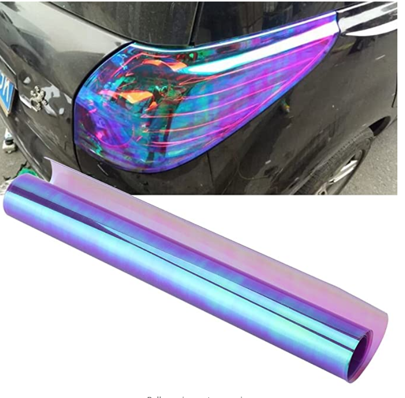

Brad350Zed Posted April 25, 2020 Share Posted April 25, 2020 Hey guys, Today looks like a great today to clean the Z I'm also going to try and use some Headlight Restorer (QUIXX) and I got some 3M Shiny Purple Vinyl to put over, fingers crossed it looks decent! seen a few Zed's with it one recently. Has anyone else Wrapped/Tinted their Headlights? Quote Link to comment Share on other sites More sharing options...
zippypooz Posted April 25, 2020 Share Posted April 25, 2020 I've done headlights, ideally you're gonna need 2 people as you're gonna need someone to hold the material as you stretch and squeegee it down. If you have a squeegee, cover it in cloth or something equivalent to stop friction and scratches. You'll need a heat gun too. Don't overheat, get it warm and keep the heat consistent across the material. Quote Link to comment Share on other sites More sharing options...

Brad350Zed Posted April 25, 2020 Author Share Posted April 25, 2020 Had a go today, was awful, not sure if it’s because tint was amazon crap, but I know it’s hard to do anyway, just creased like hell and heat gun couldn’t even get them out, I’ll try another day Quote Link to comment Share on other sites More sharing options...
HEADPHONES Posted April 25, 2020 Share Posted April 25, 2020 19 minutes ago, Brad350Zed said: Had a go today, was awful, not sure if it’s because tint was amazon crap, but I know it’s hard to do anyway, just creased like hell and heat gun couldn’t even get them out, I’ll try another day Did you take the top film off? Like a plum I applied my clear film and it looked all cloudy/ripply so I took it straight off. Later got told it was because of the top protective layer that should be removed at the end 1 Quote Link to comment Share on other sites More sharing options...
Brad350Zed Posted April 25, 2020 Author Share Posted April 25, 2020 10 minutes ago, HEADPHONES said: Did you take the top film off? Like a plum I applied my clear film and it looked all cloudy/ripply so I took it straight off. Later got told it was because of the top protective layer that should be removed at the end Possibily mate! Tbh it wouldnt even stretch very good, even with the heat gun, and ended up burning some small holes in the vinyl -_- I will try again another day, this was with two people as well hahaha 1 Quote Link to comment Share on other sites More sharing options...

zippypooz Posted April 25, 2020 Share Posted April 25, 2020 4 hours ago, Brad350Zed said: Had a go today, was awful, not sure if it’s because tint was amazon crap, but I know it’s hard to do anyway, just creased like hell and heat gun couldn’t even get them out, I’ll try another day I've used these guys in the past, good stuff. Worth a shot? http://www.ebaystores.co.uk/vtcust0ms Quote Link to comment Share on other sites More sharing options...
