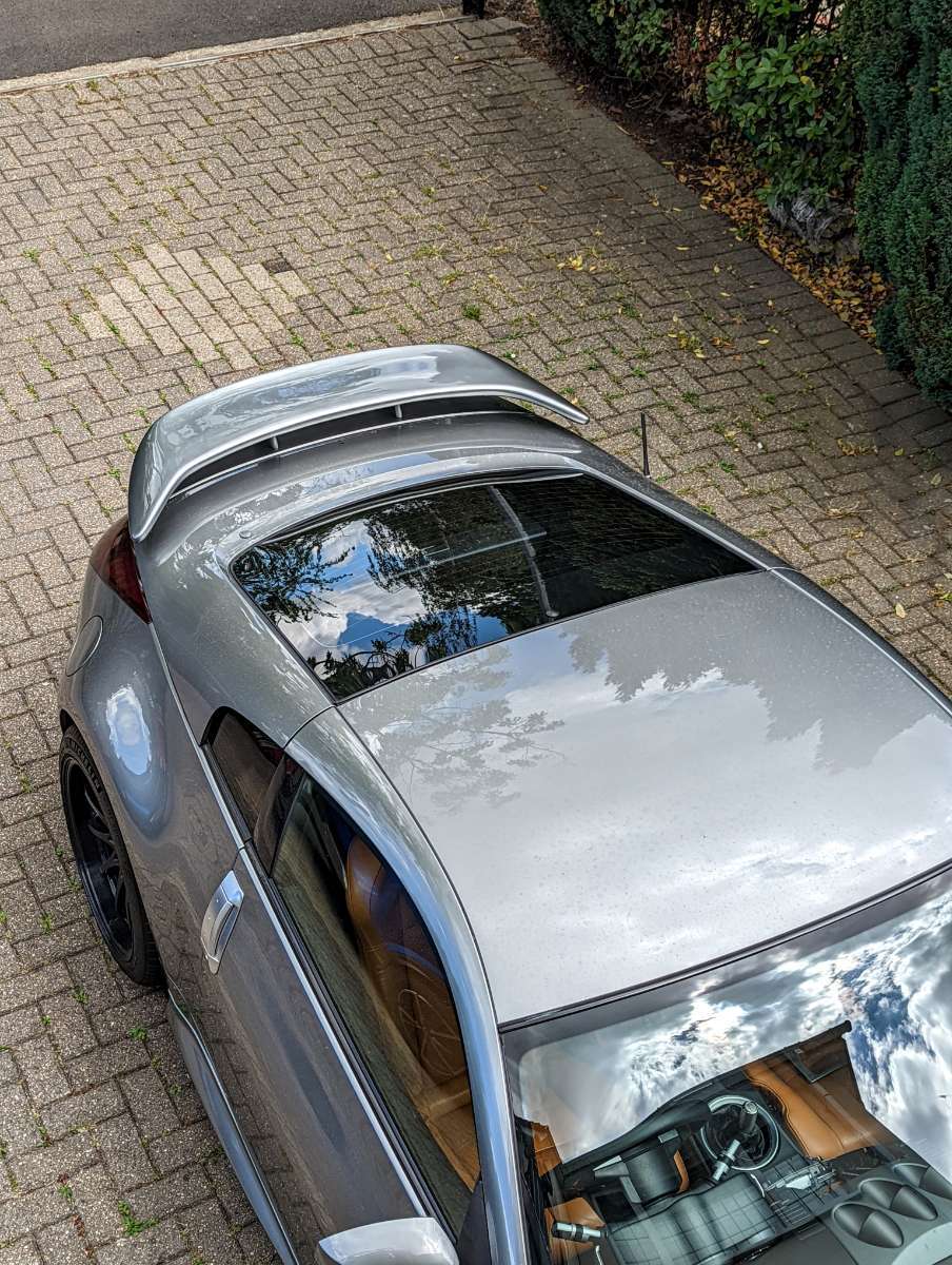

Spoiler time. Finally decided on a spoiler i like after ages deliberating. Its a Strosek style one without the metal brackets which are not my cuppa. (June 22)
Very happy with it

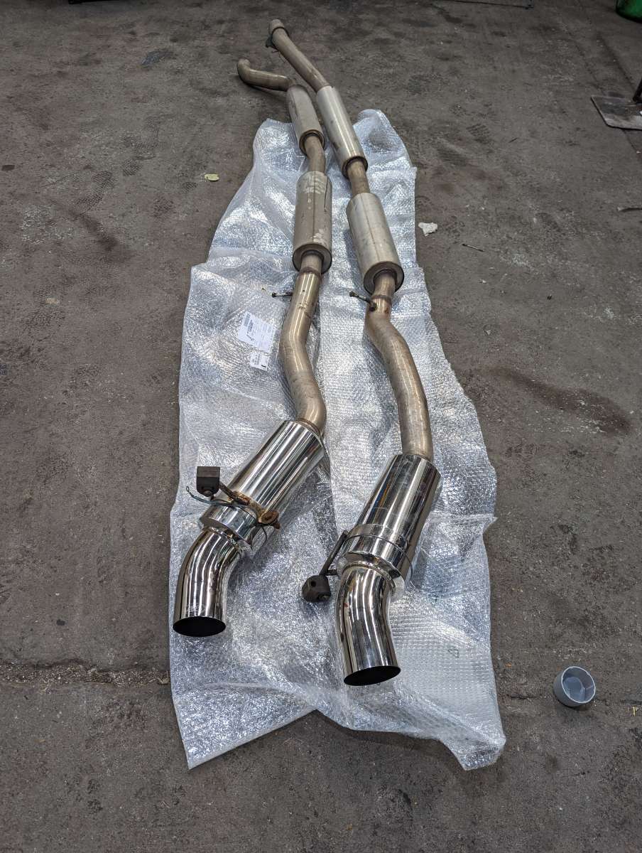

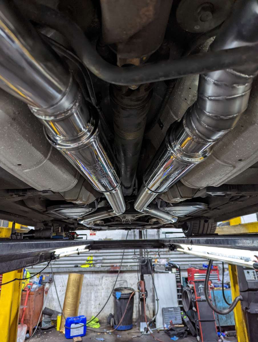

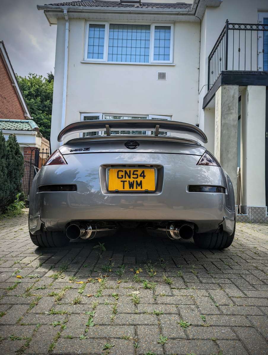

Forgot i didnt add this. Bit of an odd one but i have a true dual APS 3" exhaust. It was extremely loud as it basically only had the rear silencers. I used to daily the Zed and was too much. So years ago i had the diameter reduced and extra silencers added
Fast forward to Feb 2022 and it hasnt been my daily for a while so decided to open it back up. Full 3" again with a high quality profusion silencer on each bank so its not as raspy as it was originally.
Heres how it looked when we removed it. Just before the mid boxes it drops to 2.5" and has two silencers.PXL_20220226_155646807.jpg.9c7c9f4aca664bdeb60c09633832211e.jpg

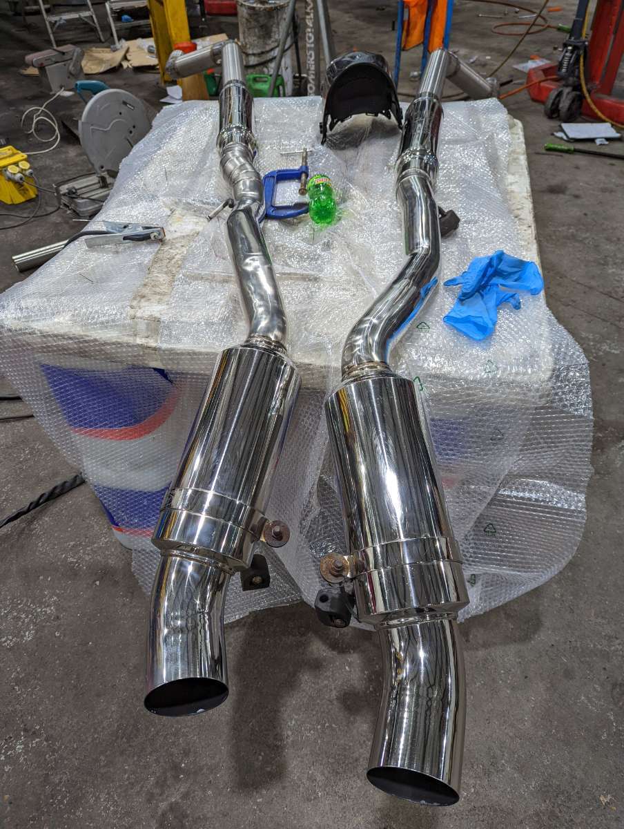

Heres a look at the new 3" profusions. Really nice quality. I wanted one good mid silencer so it wasnt overly loud.

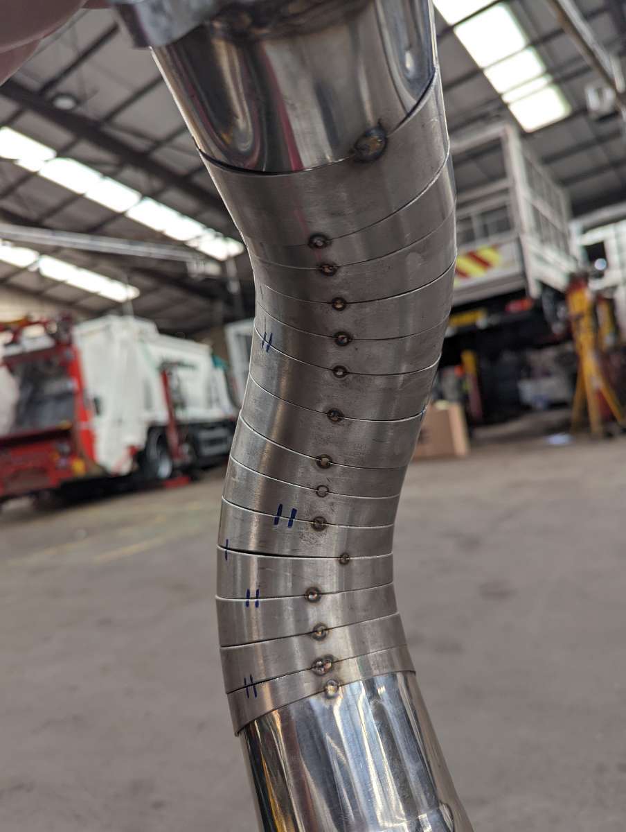

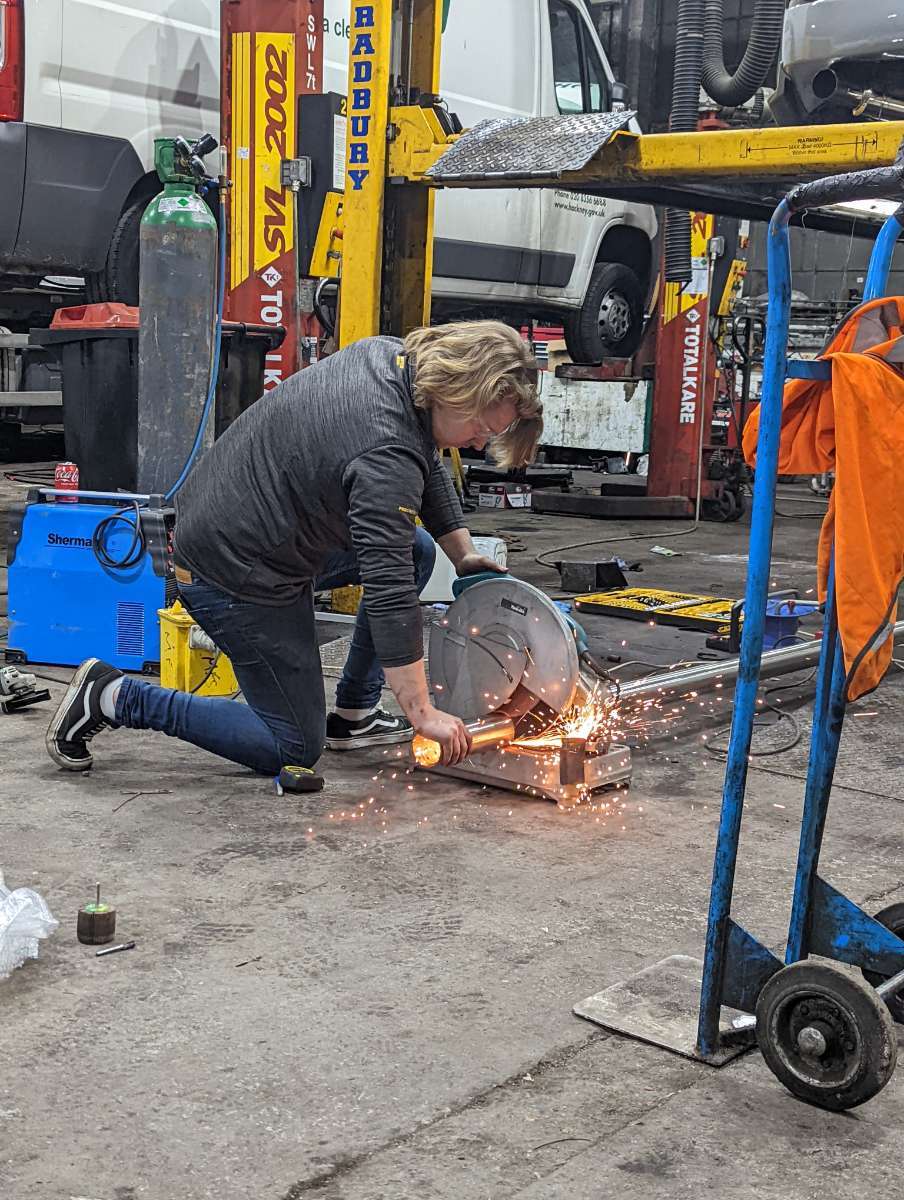

Needed to weld a pie cut section to get around the rear ARB as its not designed for two pipes back there ofc
My fabricator Ben at work

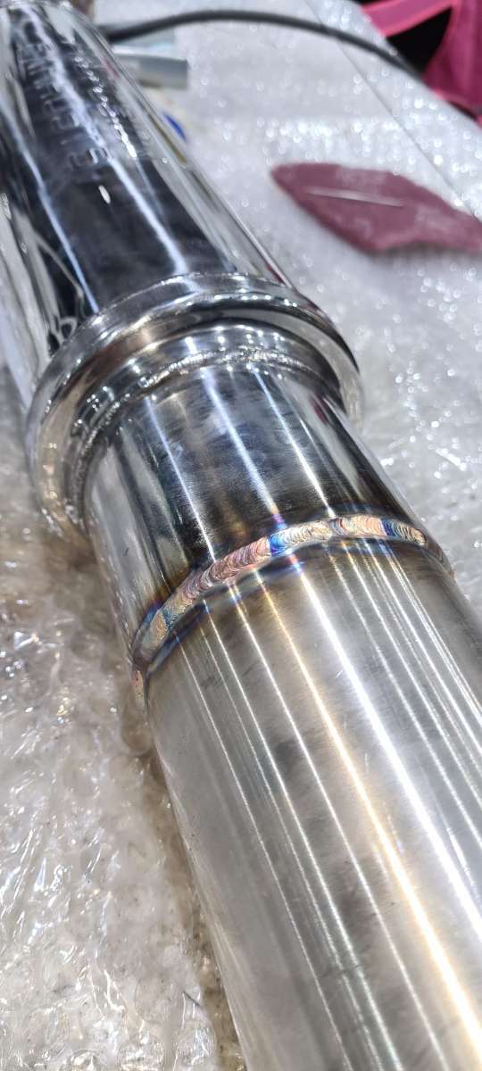

New high grade 3" stainless welded in to replace the 2.5 section
Here they are all back to their former glory. 3" all the way.
Shot of it on the car
Old one again for comparison
Very pleased with this one. Love the sound . Now that its mainly used as a weekend car and fun drives its perfect. Very deep and a great rumble.

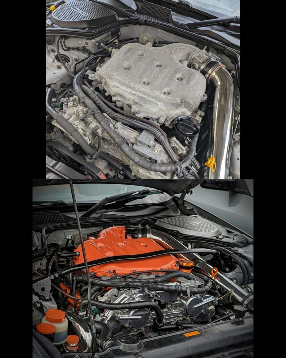

More engine bay dress up.

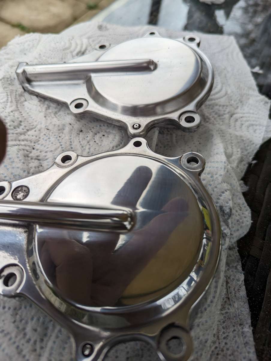

I decided to ditch the plastic engine cover. But the timing chain cover was very oxidized.
So i used a product called alubrite to get rid of it.
Worked it in and washed away. Repeated a couple times on trouble spots. Came up nice and clean.
Then came a very very laborious process of sanding the aluminium from 180 grit.
All the way up to 1500
Then i polished it with some compound which also took ages.
Came out pretty decent.
Did the little covers too
Then i also sprayed the reservoir caps to match the other orange bitsPXL_20230131_121102072.jpg.50b717e87ecca6e027c4943a5f990259.jpg
Tbh i want a better solution to these. Something billet or such.

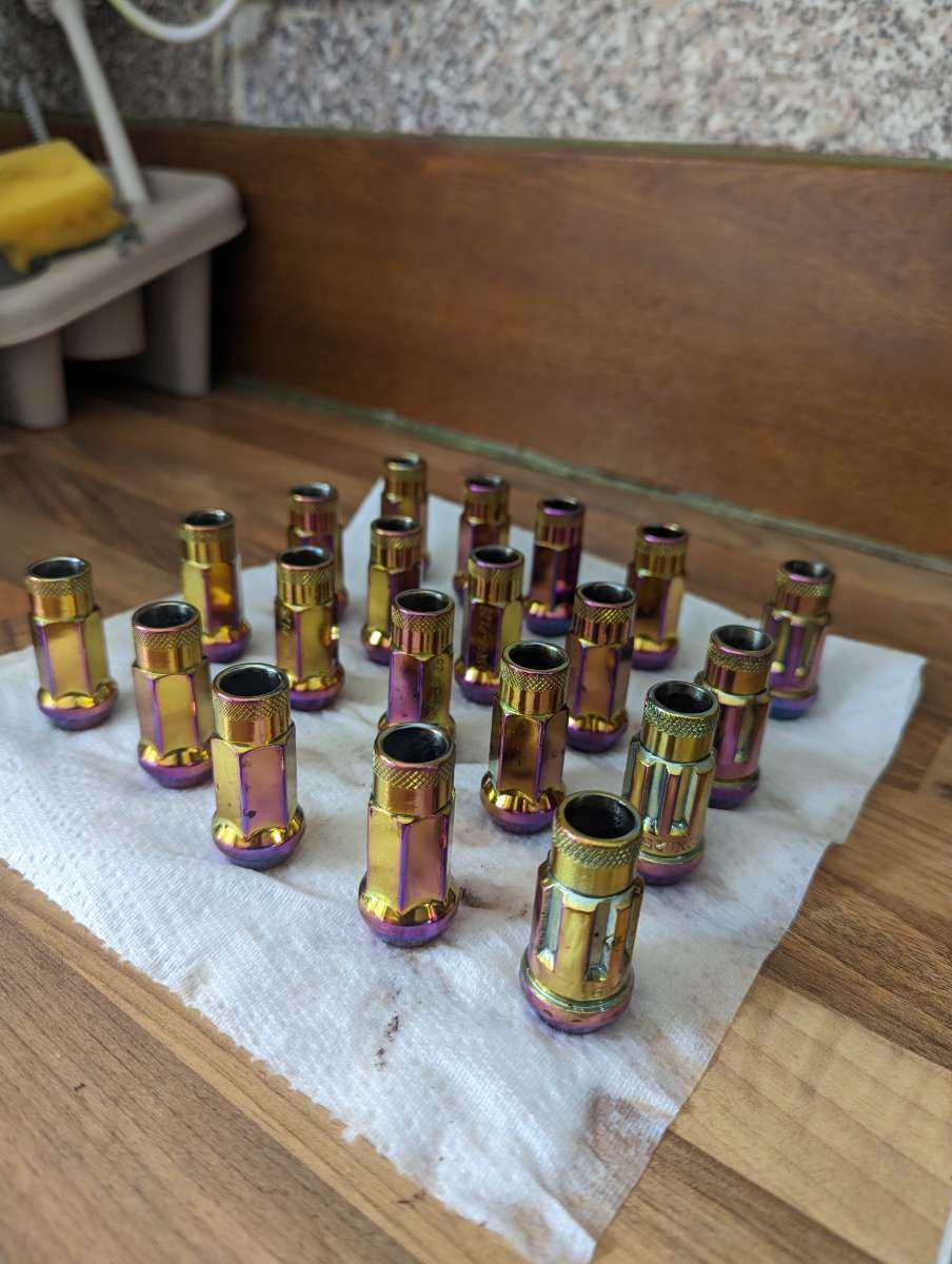

Also bought some dress up bolts. Before on left, after right.
Heres a before and after of all the work

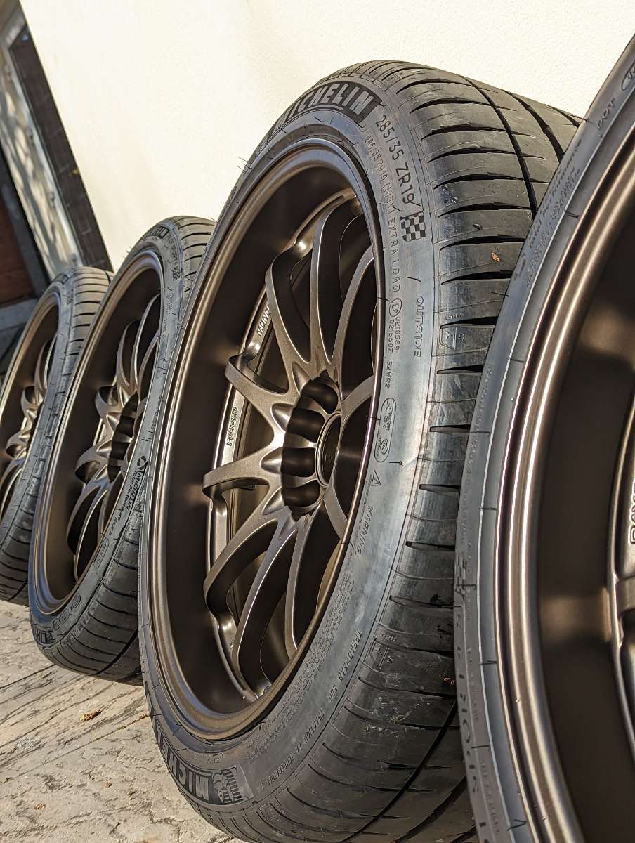

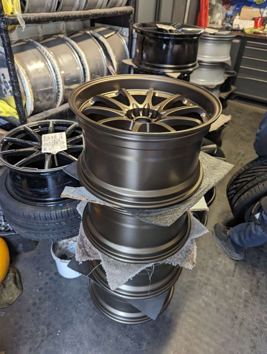

Wheel colour change and refurb.
Had gloss black wheels for years and was tired of it. After visiting a few places and looking at various options i decided on this bronze.
So it was goodbye to the black
Hello to the bronze
PXL_20230418_105610780.jpg.a75602bae3a6ba36ee196f45482415c6.jpgPXL_20230418_112356601.TS_exported_66.jpg.2c037f33488b262171ab5f59e67f668a.jpg
PXL_20230418_114119734.jpg.6a96b8c37bbbd41fb22a6fa80ea0dd74.jpgPXL_20230419_151236486.jpg.ce32298013fa0d34119de40b4d73db75.jpg
Very pleased with the way these turned out. Love the new colour and the service from First Aid Wheels in Finchley was excellent.

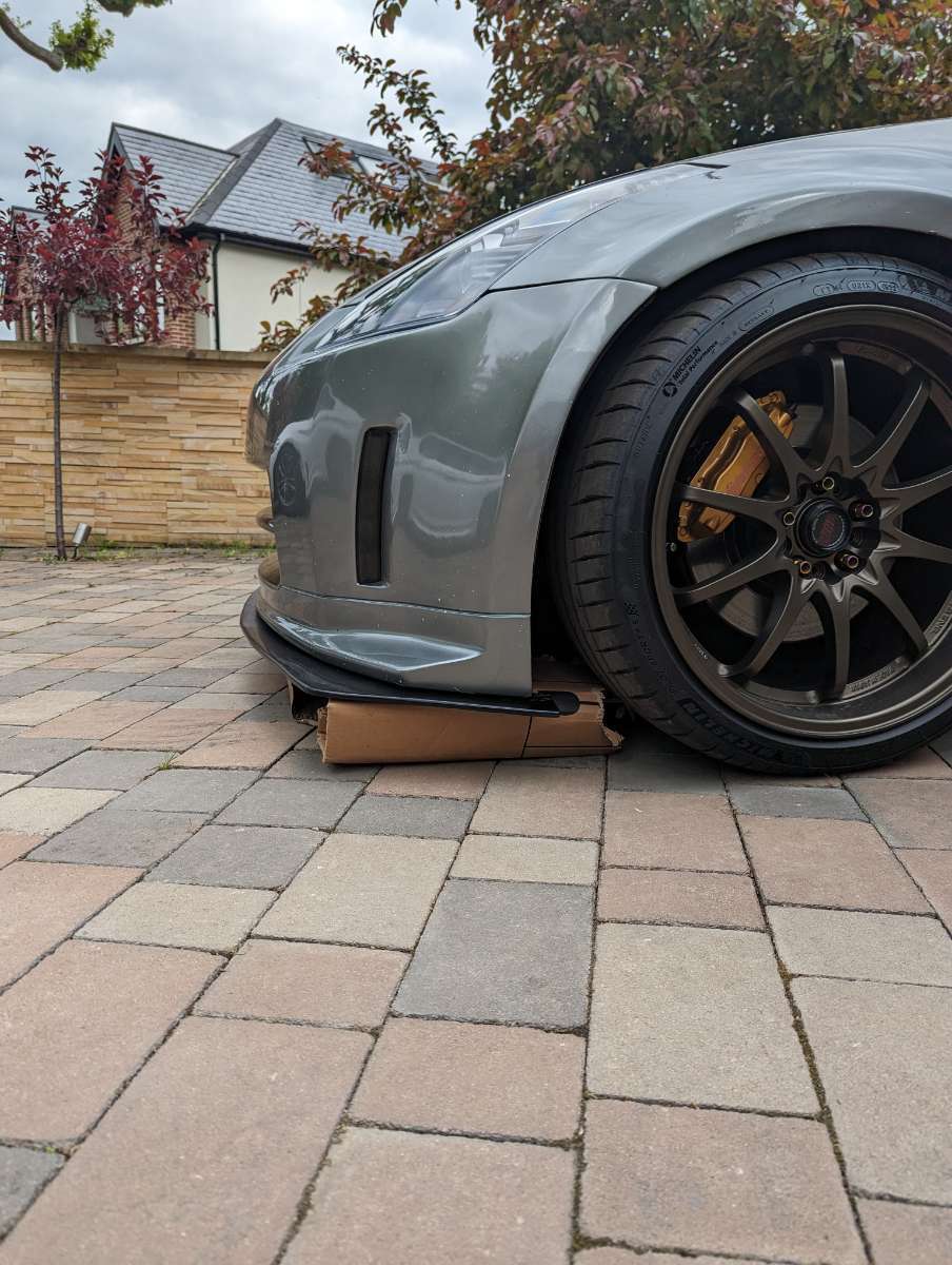

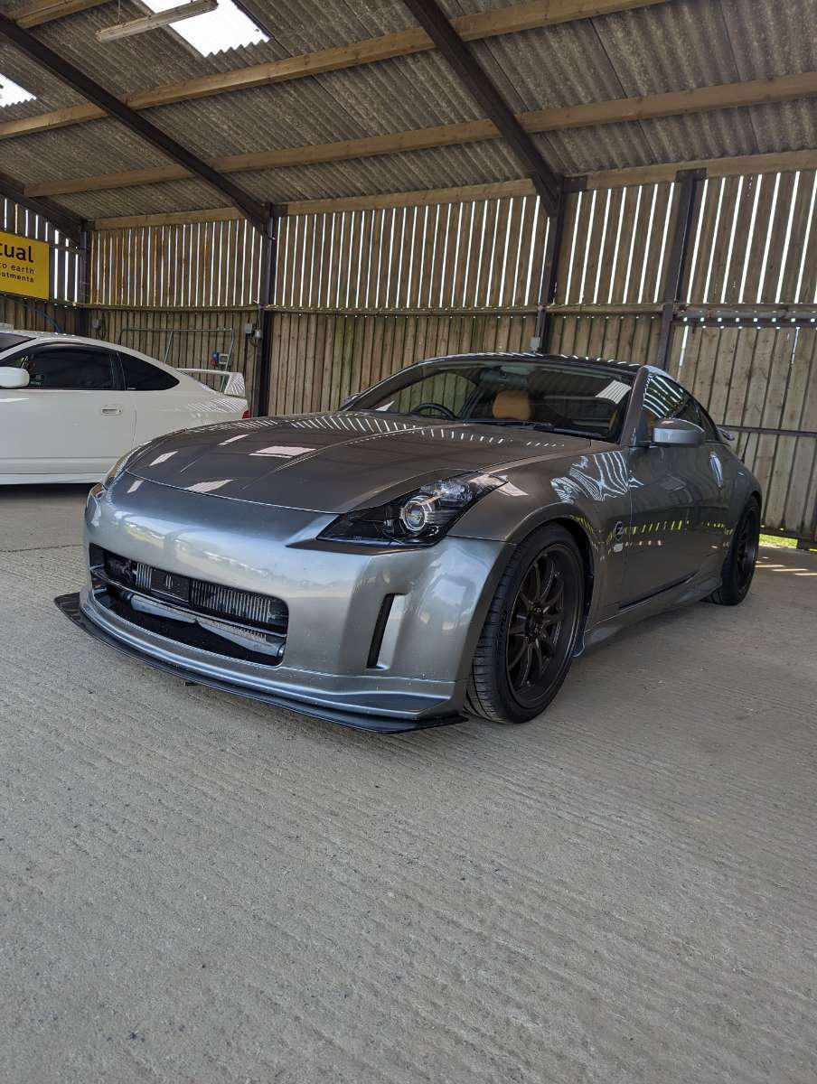

Front splitter for Nismo V1 bumper.
Fancied having a splitter but never found one designed for my bumper. Once i finally happened across one i snapped it up and fitted it.
I propped it up on some cardboard to see how far i wanted it sticking out etc
Once i decided on that i cut off the excess
Then it was a tricky part of drilling holes through the splitter and bumper for lots of nuts and bolts to clamp it in place. Took a while but its been on a year and still holding fine.
I wasnt sure at first but its grown on me and now i cant see it without.

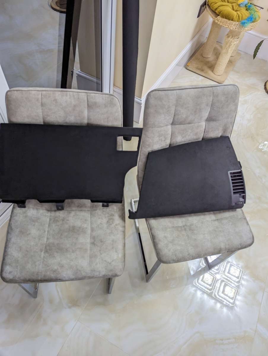

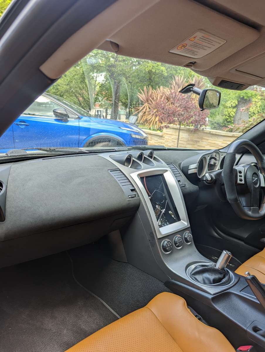

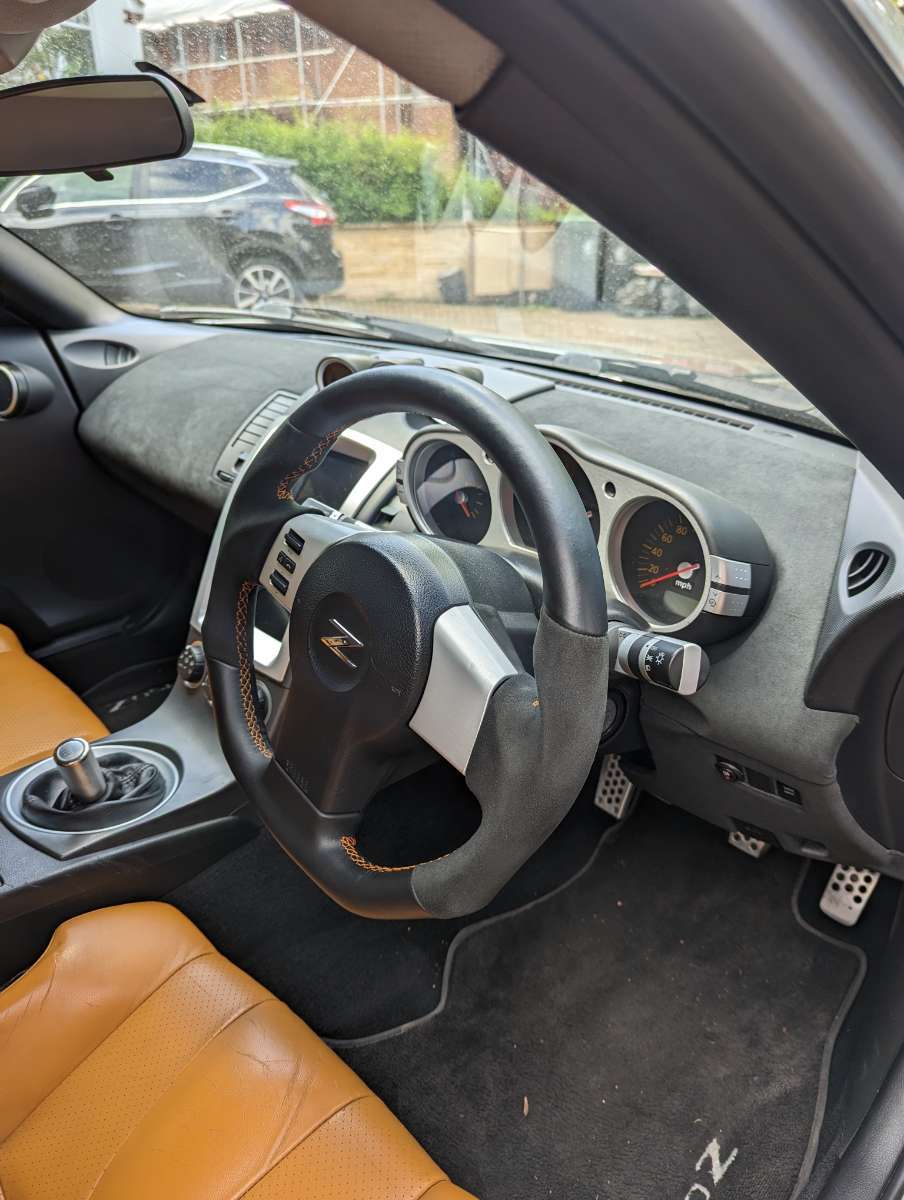

Interior upgrades.

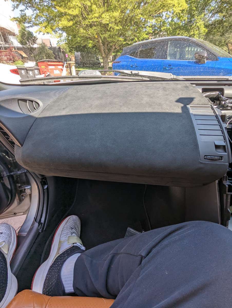

I decided to purchase some genuine alcantara and skin some of the panels in the Zed. Was tricky work as the material has no stretch and its tricky to work with the glue without contaminating the surface
Stripped out the panels
Lots of measuring and planning as the material is pretty expensive
A finished panel passenger lower)
This is the fabric glue i used
All fitted back in
PXL_20230524_091840007.jpg.59c561ecb017cdc3f0cfe94651ff339b.jpgPXL_20230524_133744848.jpg.178143724719bdb4772b024ad035381e.jpgPXL_20230524_133756636.jpg.df64b5bc533c5e76576a19bacd2b6bd5.jpg
Was done last June and its held up just fine so far. Going to do some more bits soon

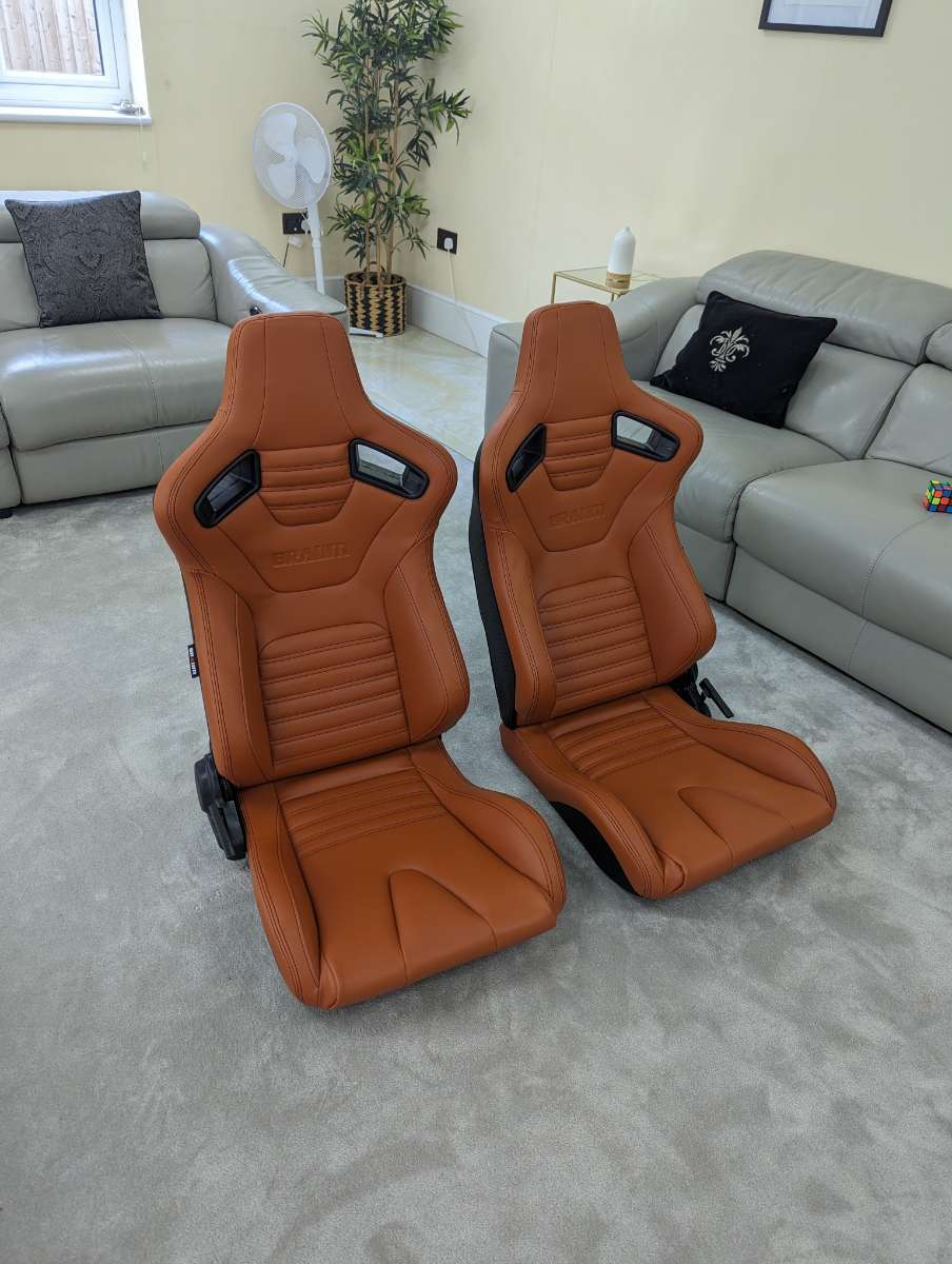

New seats!
Everyone knows how well the oe Zed seats wear, despite how careful i was with them. So its time for a replacement. I was looking for something with more support to so im not sliding out of my seat all the time.
After lots of searching i decided to get these:
Braum Elite X
Sitting on Planted seat brackets.
In my 'all the way back' driving position the driver seat rubbed on the door a little and made a constant noise while driving so i modified the bracket a little to give me more room
Now its just fine.
Despite buying the 'low' seat brackets it has raised my driving position a little. Im 6ft 2 and now im a finger gap from top of head to roof.
Im very happy with these overall. They look the part imo. And are comfortable, ive been on long drives a few times and no problems at all. And they hold me in better than OE. Longevity remains to be seen.
Couple of glamour shots:
Alongside the other interior mods ive been doing, screen, steering wheel, alcantara etc, its a nicer place to be.

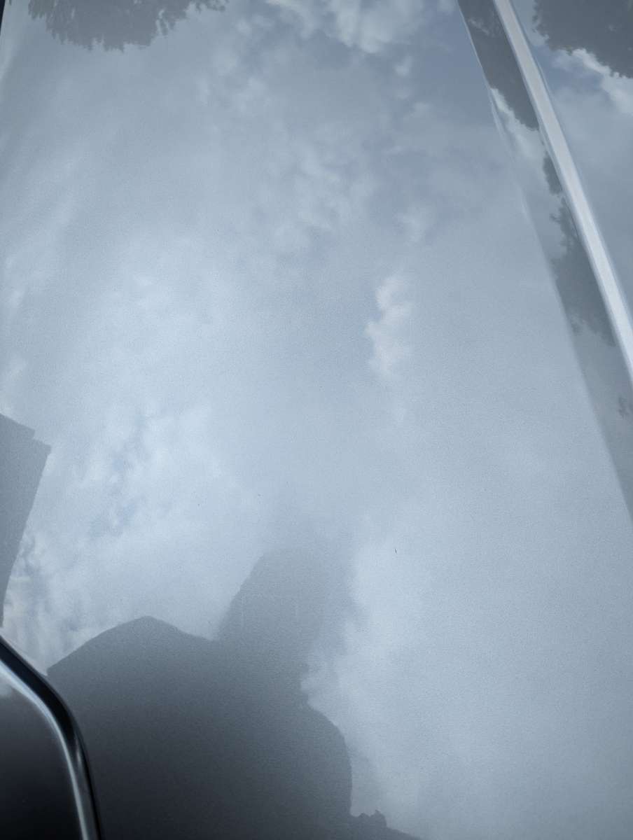

Yearly paint correction this May
Before i started paint still looked fine and plenty of gloss when clean, but still 😁
Thorough clean and decontamination with fallout remover and clay. Both from Bilt Hamber.
Wasnt really any contamination, very little reaction from the FO remover and very little picked up by the clay so i must be doing something right
Paint was free from swirls etc so just used some Rupes finishing polish and a medium pad on the Das Pro DA. Followed by some Bilt Hamber double speed wax for prtection.
Before
After
All done
Took pics from the same angle to try to capture the difference.
All done for the year i rekon apart from maintenance washes and protection.
