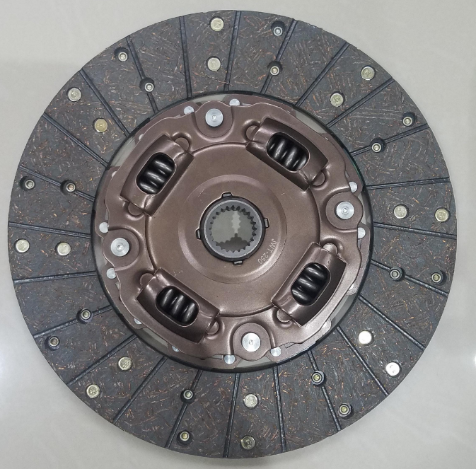

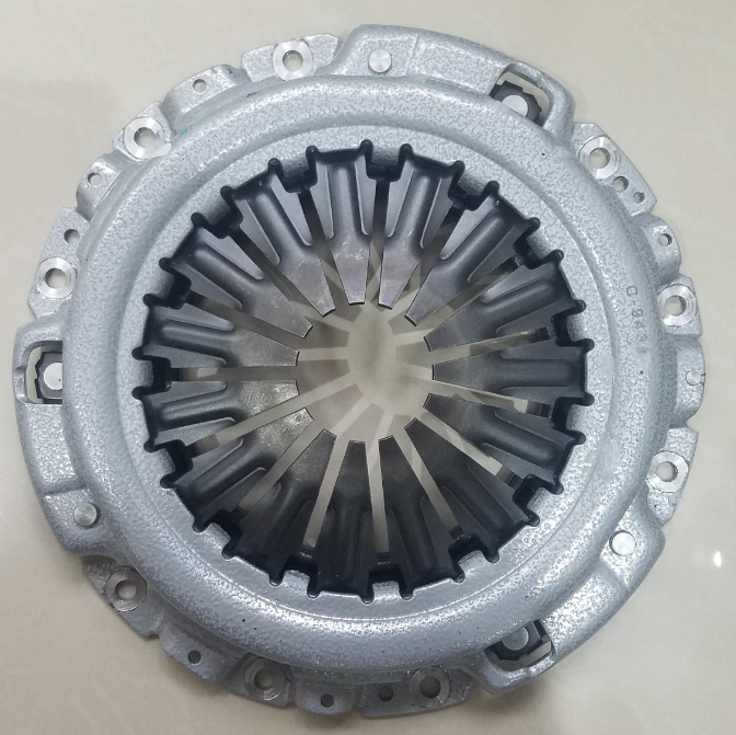

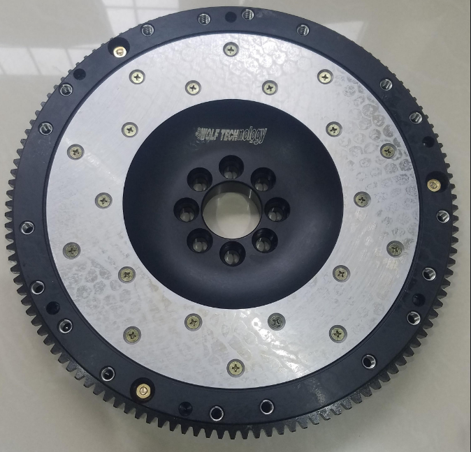

ballistic Posted August 6, 2021 Author Share Posted August 6, 2021 Update to the above: Clutch was slipping: As you can see here So time for an upgrade! I went with the JWT high clamping force clutch pack (1200kg Clamping force good for 600ft lbs of torque) and the 14lb single mass flywheel. (OE is 28lb dual mass). Still bedding in, but the clutch pedal is actually alot lighter and has a strong bite and nice feel. Biting point is low at the moment. Had an issue with the slave cylinder during install, so will be replacing that and installing the stainless steel clutch line at the same time soon. The kit was purchased from Torqen, who were very helpful as always. I used some RBF660 brake fluid too. The single mass flywheel is noisier than standard as expected, but doesn't bother me at all, the added responsiveness is very nice. Will add more details once its bedded in Looking forward to some dry weather 2 Quote Link to comment Share on other sites More sharing options...
davey_83 Posted August 7, 2021 Share Posted August 7, 2021 Jim Wolf Tech stuff is top stuff, very nice fella. What makes the single mass flywheel result in extra transmission noise? Quote Link to comment Share on other sites More sharing options...
ballistic Posted August 9, 2021 Author Share Posted August 9, 2021 @davey_83 Thats a good question. The short answer afaik is; The dual mass heavier flywheel is better at 'absorbing' the transmission rattle caused by engine torque at low rpms. So far i must say im happy with it. The pick up and responsiveness feels great, Car feels more urgent and lighter somehow. No real downside apart from chatter at low revs in high gears. 1 Quote Link to comment Share on other sites More sharing options...
davey_83 Posted August 10, 2021 Share Posted August 10, 2021 That makes sense, even the 911 R when fitted with the option lightweight flywheel gets a transmission chatter. Quote Link to comment Share on other sites More sharing options...

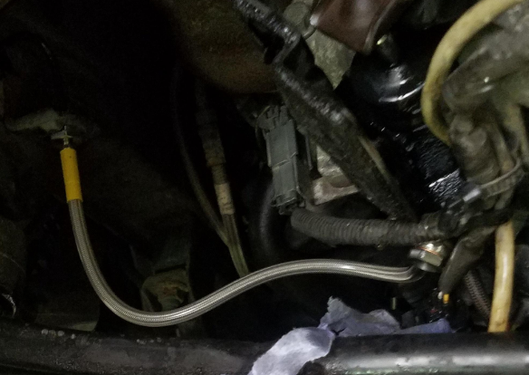

ballistic Posted August 14, 2021 Author Share Posted August 14, 2021 Fitted the braided clutch line and uprated slave cylinder (from Torqen). Clutch feels a little less spongy and more consistent feel/biting point going through the gears? Pedal feels a little heavier, but im not sure about that last one. Also changed oil and filter, engine immediately sounds a quieter. Also diagnosed a knocking noise, new passenger wheel bearing needed it seems. Quote Link to comment Share on other sites More sharing options...

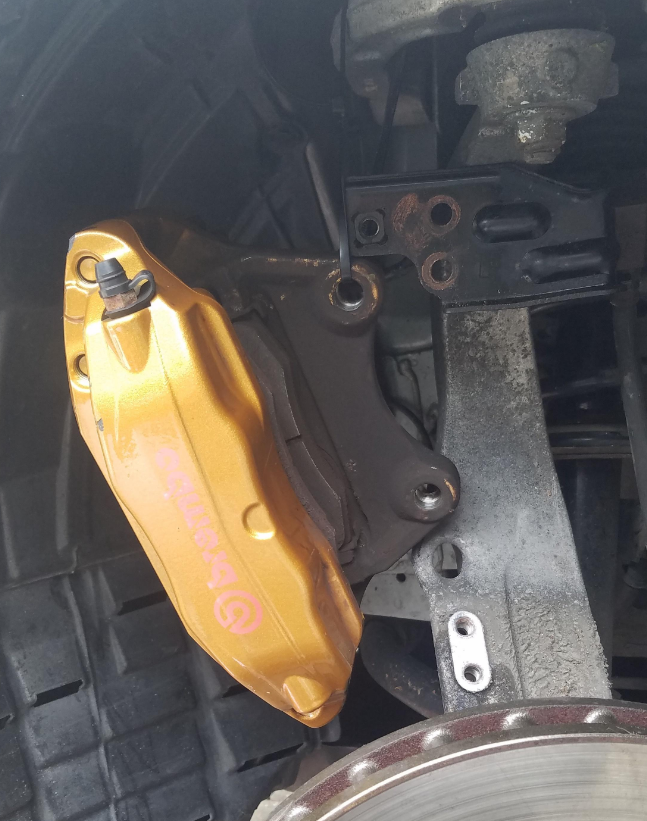

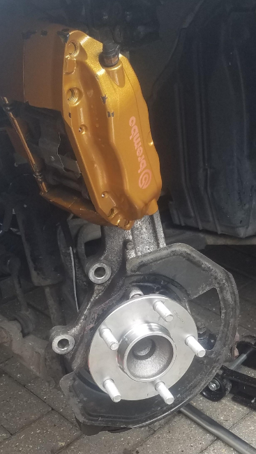

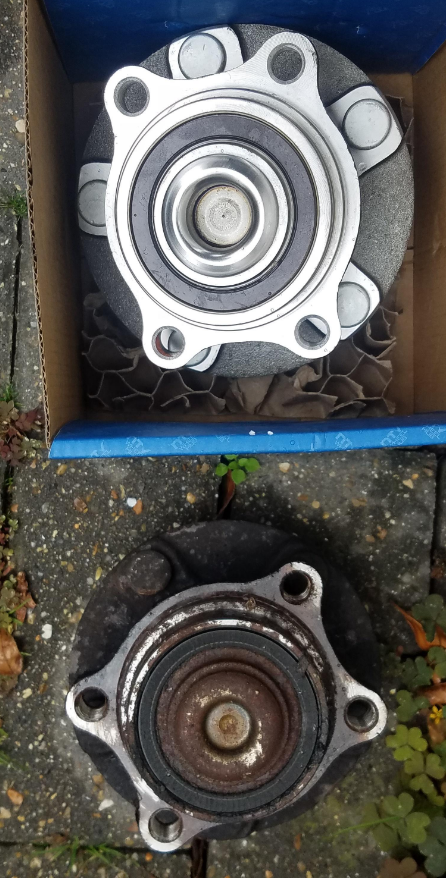

ballistic Posted September 6, 2021 Author Share Posted September 6, 2021 Had wubwubwub noise that sped up with vehicle speed. I diagnosed it as passenger wheel bearing by jacking the car and spinning the wheels. Fitted new one courtesy of Zman of course. Just tie the caliper out of the way. 2 caliper bolts and 4 hub bolts. The bottom one is tricky, but unwinding a little lock allows you to get a socket on it Not a particularly difficult job. No more horrible noise 2 Quote Link to comment Share on other sites More sharing options...
