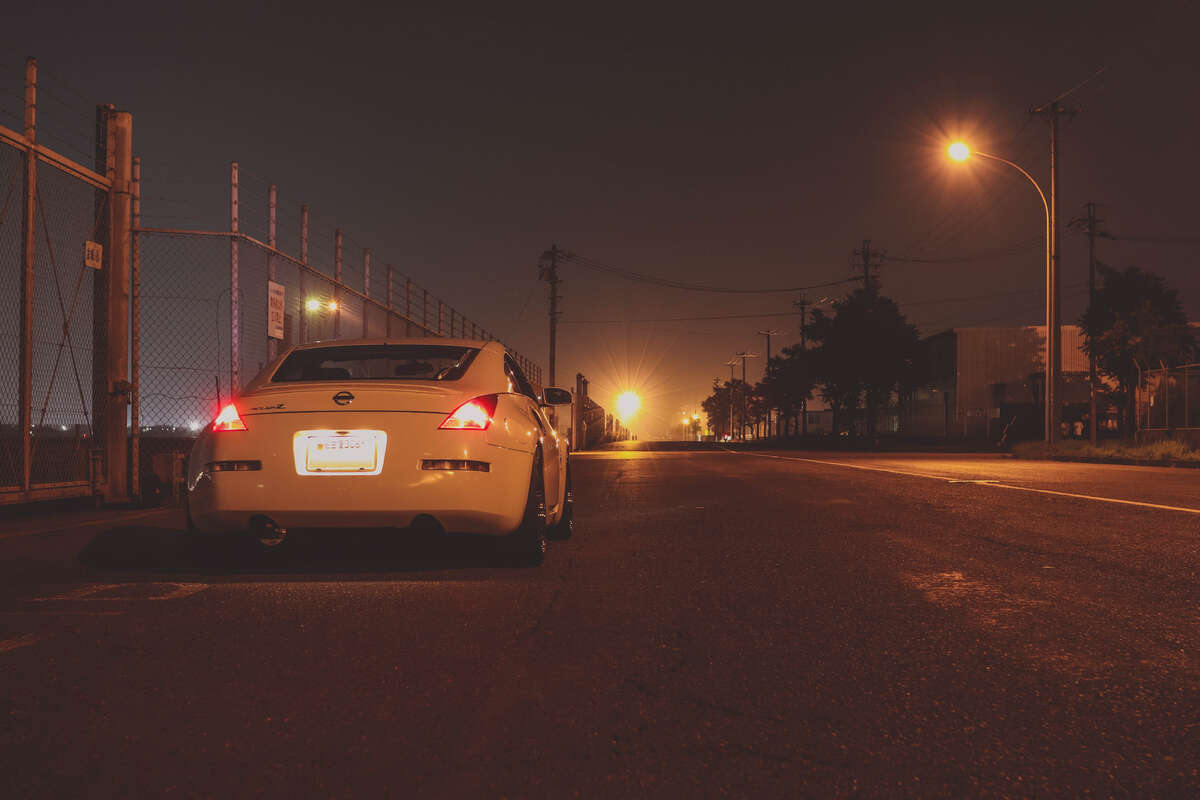

GoHashiri Posted August 8, 2020 Author Share Posted August 8, 2020 Further update: today i managed to install the wing, a couple of new door hinges and the bumper; which takes the mend to near completion. I still need to get the chassis brace and probably a power steering cooler of some kind. I've noticed it now rubs a tiny bit. I was too tired to figure out which corner it's rubbing on but I did manage to take some pics with my new camera (which i don't really know how to use, so excuse the ISO). 6 Quote Link to comment Share on other sites More sharing options...
davey_83 Posted August 8, 2020 Share Posted August 8, 2020 Back where she belongs, looks really sweet Quote Link to comment Share on other sites More sharing options...
alexgv1 Posted August 8, 2020 Share Posted August 8, 2020 Looking great! White is growing on me Quote Link to comment Share on other sites More sharing options...
GoHashiri Posted August 8, 2020 Author Share Posted August 8, 2020 8 hours ago, davey_83 said: Back where she belongs, looks really sweet Almost! Should be back at the track at the end of the month. I want to get a roadtrip into the mountains in before potentially stacking it again. 17 minutes ago, alexgv1 said: Looking great! White is growing on me Cheers pal 1 Quote Link to comment Share on other sites More sharing options...
Luigi350z Posted August 11, 2020 Share Posted August 11, 2020 (edited) On 08/08/2020 at 15:28, GoHashiri said: Uau..beautiful! Which city of Japan is this? Edited August 11, 2020 by Luigi350z Quote Link to comment Share on other sites More sharing options...

marzman Posted August 11, 2020 Share Posted August 11, 2020 These pictures are great. Quote Link to comment Share on other sites More sharing options...
msitpro Posted August 12, 2020 Share Posted August 12, 2020 Stance so on point - might have to change my 265/35 285/35 setup for 255/40 275/40. I'm low but gaping arch gaps! Quote Link to comment Share on other sites More sharing options...
GoHashiri Posted August 12, 2020 Author Share Posted August 12, 2020 (edited) On 11/08/2020 at 18:57, Luigi350z said: Uau..beautiful! Which city of Japan is this? Thanks Luigi, it's Nagoya, Japan. Lots of race tracks in this area too if you're ever to visit. 15 hours ago, marzman said: These pictures are great. Thank youu! 50 minutes ago, msitpro said: Stance so on point - might have to change my 265/35 285/35 setup for 255/40 275/40. I'm low but gaping arch gaps! Hell to arch gaps! Seriously though, check camber as well because I was considering an offset of +5 before my alignment, it's +15 currently. Chunky tyres will mask some arch gap too Edited August 12, 2020 by GoHashiri Quote Link to comment Share on other sites More sharing options...
