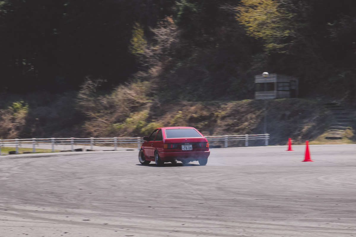

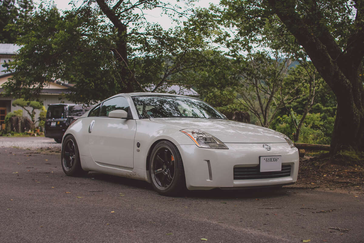

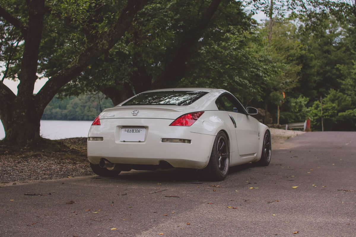

GoHashiri Posted April 18, 2020 Author Share Posted April 18, 2020 (edited) Last weekend i headed to the local circuit with some friends. I wasn't really keen on participating due to the dire condition of my tires. Seeing as the cherry blossoms were in full bloom, on the way home i took the scenic route up to Mt Ena and then down to the Yahagi dam. The latter area is popular with sports cars and bikes thanks to the technical roads which run up the side of the mountain and around the dam. Picked up a new exhaust and some tires this week and am shopping for wheels at the moment. I'm undecided whether to go with a 10" or 10.5" rear; I'm thinking 9.5" +15 front and 10" +25 rear, then use spacers to push it out a bit if necessary. Edited July 12, 2020 by GoHashiri wrong offset 5 Quote Link to comment Share on other sites More sharing options...

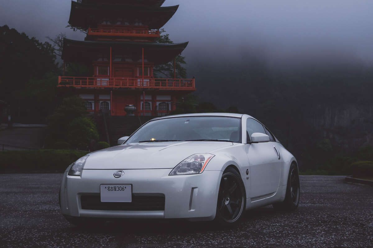

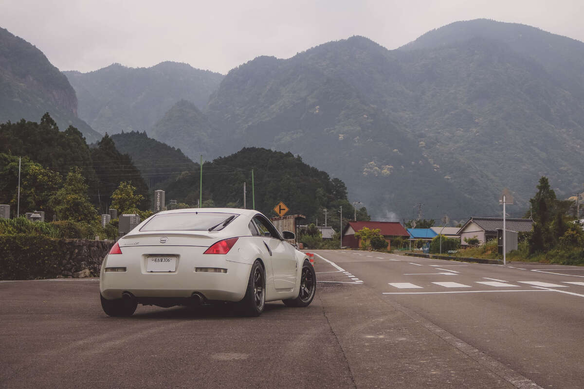

GoHashiri Posted May 3, 2020 Author Share Posted May 3, 2020 Finally got the wheels and new tyres mounted - had a mare of a job rolling the arches. There was a patch of rust in the corner where the fender meets the bumper which cracked the paint most of the way around the arch. I'll need to get a body shop to fix this up shortly. Still haven't got the new exhaust mounted as the stock one needs to have the bolts cut off at the Y pipe. Wheels: TE37SL - 18x9.5, +22 (F); 18x10, +20 (r). Tyres are Hankook V12 Evo2 255/40, 275/40. Headed about 3hrs out of town this weekend to the Kumano Kodo Pilgrimage Trail: 11 Quote Link to comment Share on other sites More sharing options...
GoHashiri Posted June 13, 2020 Author Share Posted June 13, 2020 I've actually had this exhaust on for a couple of months now: Fujitsubo Power Getter. I'll try and get some videos of the sound at some point, the thing is pretty quiet up to 3k - only marginally louder than stock at idle, +2db iirc 2 1 Quote Link to comment Share on other sites More sharing options...
HEADPHONES Posted June 13, 2020 Share Posted June 13, 2020 Really love your zed in that photo^ 1 Quote Link to comment Share on other sites More sharing options...
Ian Posted June 13, 2020 Share Posted June 13, 2020 Definitley need a sound clip of that exhaust Quote Link to comment Share on other sites More sharing options...
Luigi350z Posted June 13, 2020 Share Posted June 13, 2020 4 hours ago, GoHashiri said: Lovely pic! Quote Link to comment Share on other sites More sharing options...
GoHashiri Posted June 13, 2020 Author Share Posted June 13, 2020 (edited) On 13/06/2020 at 20:17, Ian said: Definitley need a sound clip of that exhaust I'm sure my mate has a mic for his camera so I'll try and get a few drive-bys with that down at the docks. Edited July 12, 2020 by GoHashiri Quote Link to comment Share on other sites More sharing options...
GoHashiri Posted June 13, 2020 Author Share Posted June 13, 2020 4 hours ago, HEADPHONES said: Really love your zed in that photo^ 1 hour ago, Luigi350z said: Lovely pic! Cheers guys Quote Link to comment Share on other sites More sharing options...

GoHashiri Posted July 12, 2020 Author Share Posted July 12, 2020 Sorry all, it's been a while since I've posted here. Whilst I've been waiting for my engine to grenade itself (it's still working fine with its 5psi oil pressure btw), I've picked up a few things. I managed to get my mits on a beautiful set of Recaro SR3s in Le Mans confetti. TBH, I'm finding them a bit annoying, particularly on longer drives. The bolsters are a bit better, the height is basically the same as stock if not a smidge higher. I also ran my first grip day recently, whilst I was waiting for the track to open up for the drift sessions. One thing that held me back was the fear of my lugnuts breaking and sending me into one of the many nearby trees. I was running on halfords-equivalent nuts, so I bit the bullet and picked up some RAYS nuts. Also dropped the car another CM as I felt it was a bit high and installed a switch for the VDC. 2 Quote Link to comment Share on other sites More sharing options...
GoHashiri Posted July 12, 2020 Author Share Posted July 12, 2020 Also, here's a couple of videos from a recent blast at Mikawa Motorland: Grip: Drift: 3 Quote Link to comment Share on other sites More sharing options...

marzman Posted July 13, 2020 Share Posted July 13, 2020 Awesome videos, that looks like a great little circuit!! 1 Quote Link to comment Share on other sites More sharing options...
GoHashiri Posted July 14, 2020 Author Share Posted July 14, 2020 14 hours ago, marzman said: Awesome videos, that looks like a great little circuit!! Mikawa is a banger, being open pretty much every day for free practice you can easily secure a quiet track - trees are the danger though 1 Quote Link to comment Share on other sites More sharing options...
marzman Posted July 14, 2020 Share Posted July 14, 2020 5 hours ago, GoHashiri said: Mikawa is a banger, being open pretty much every day for free practice you can easily secure a quiet track - trees are the danger though free as in, you dont pay for it? Quote Link to comment Share on other sites More sharing options...
GoHashiri Posted July 14, 2020 Author Share Posted July 14, 2020 6 hours ago, marzman said: free as in, you dont pay for it? I meant free to select what type of driving you want to do. Costs are: JPY 2,500 (£19-ish) for 1 hour drift JPY 4,500 (£32-ish) for 1 hour grip It's pretty much the going rate at any of the smaller tracks Quote Link to comment Share on other sites More sharing options...
