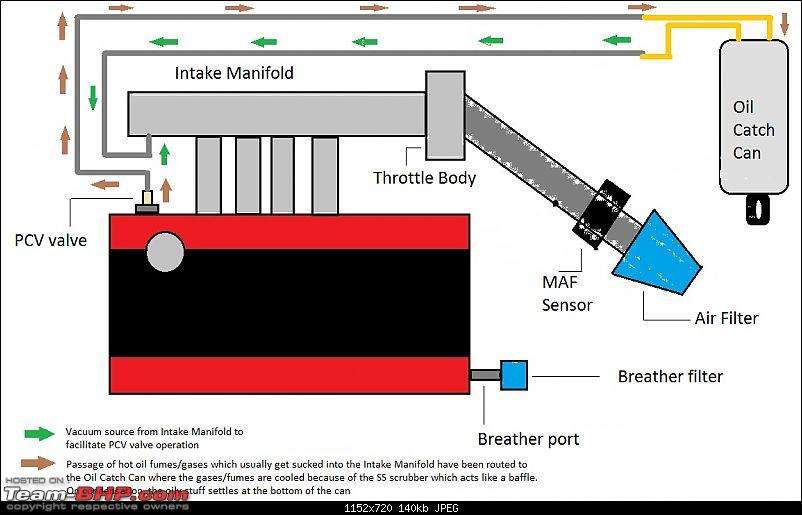

davey_83 Posted March 8, 2020 Share Posted March 8, 2020 (edited) Be sure you're not looking at a boosted setup. The n/a OE set up is a closed system utilising the engines vacuum to draw out the oil vapour re burning it. The catch can plumbs into this closed system catching the oil vapour, therefore venting to atmosphere doesn't draw out the crankcase pressure nearly as good as a closed vacuum set up. Same principle for our VQ35's using a 2 port unit. Edited March 8, 2020 by davey_83 1 Quote Link to comment Share on other sites More sharing options...
Dicky Posted March 8, 2020 Author Share Posted March 8, 2020 (edited) Thanks so much for your efforts Davey, now I get it and the diagram really helps. I’ve had my car for 15yrs now and it’s probably to late but thought I might fit one just to help the old gal along a bit n her old age. Luv that car!! ps: just had a thought you may be able to advise on. im thinking of running a tube from the PCV and one from the tube which currently connects to the air intake pipe just before the Throttle valve, th t ”teeing” them together into the in port of the catch can, then a tube from the out of the catch can to the plenum vacuum pipe. Do you see any problems with this? Edited March 8, 2020 by Dicky Quote Link to comment Share on other sites More sharing options...
