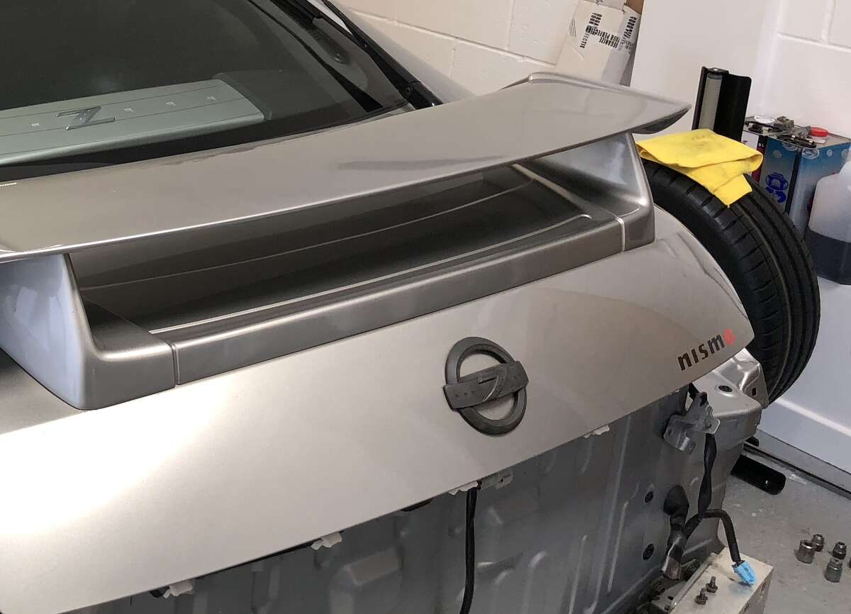

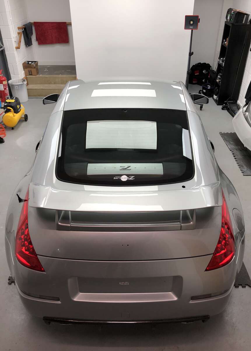

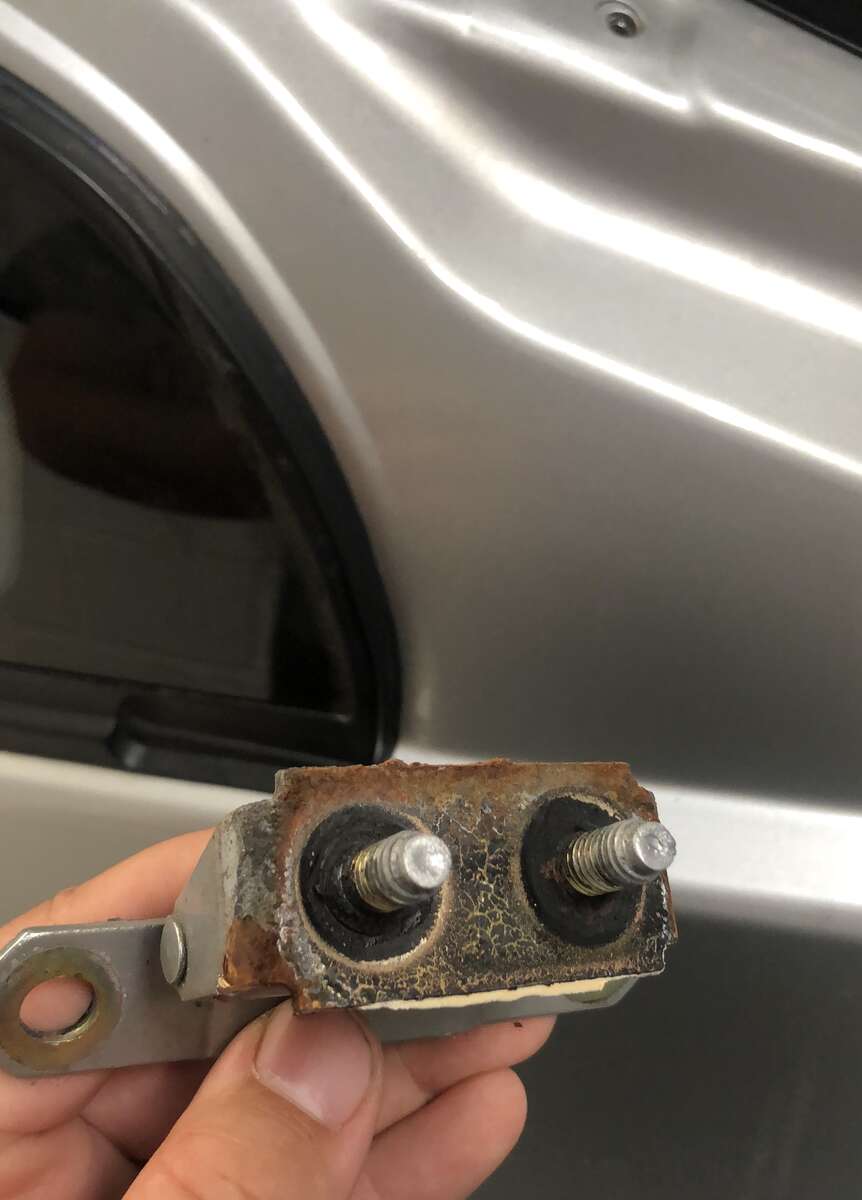

New tailgate now on, cleaned up the hinges, have also sealed them now too.

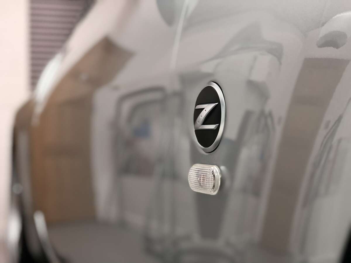

De badged the rear, also had to wet sand out a deep mark where you could see the previous owner had damaged the paint by de badging the original. Makes me cringe when I see people do it in correctly. So a bit of heat with the heat gun to soften the glue, then using fishing wire take the badge off using even pressure so you have 'a clean slice through' and you're not pulling one side of the badge away from the surface as the other side will go the opposite way and dig into the paintwork, this is where the damage is usually done. The using Tar and Glue remover and some cotton pads let the product soak into the left over residue, once soaked its as easy as peeling off, no need to scrape, scratch and rub unnecessarily. Once done the surface is machine polished to take away any ghosting if any.

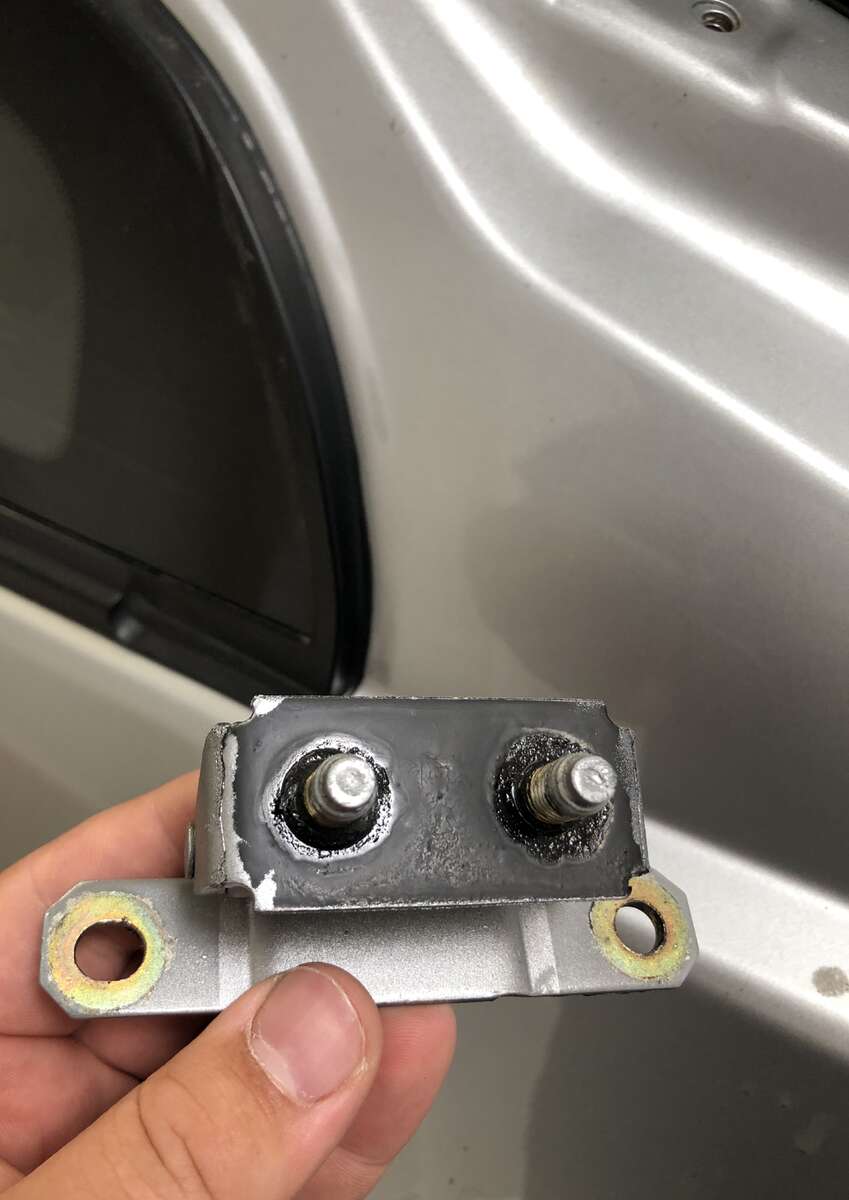

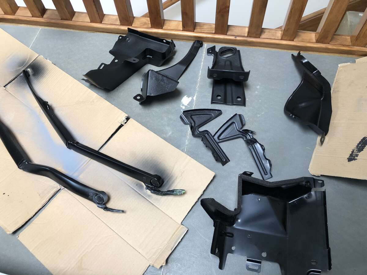

Window wiper stalks refurb was completed (after running out of paint previously haha), all ready to go back on.

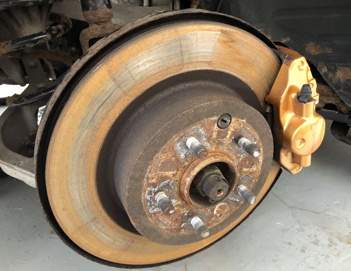

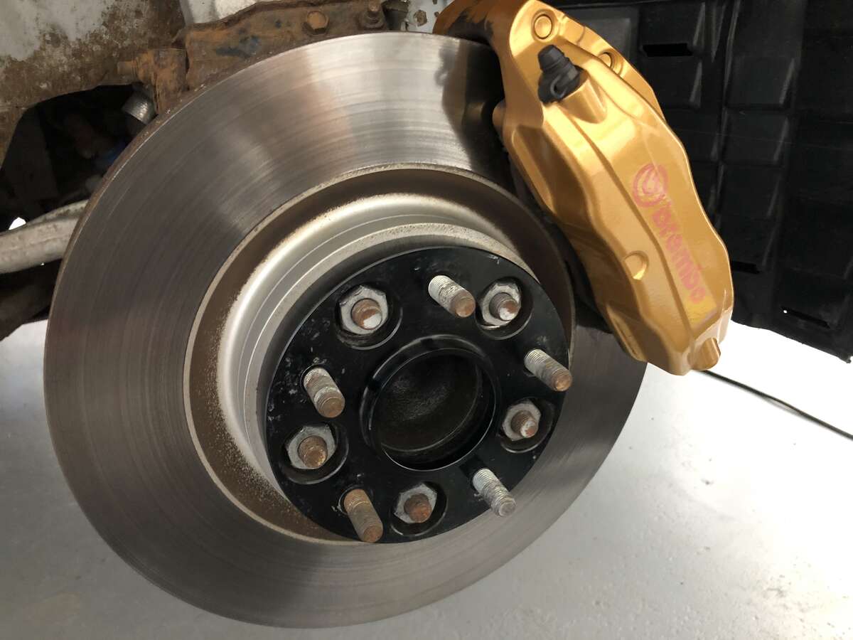

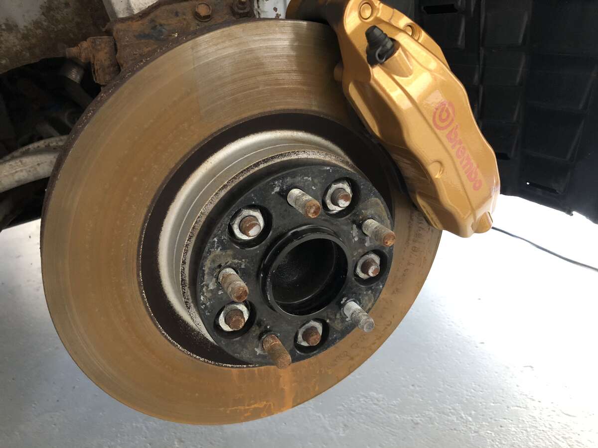

Rear Brake hubs sanded down and painted, as you can see they were pretty bad! Front Hubs were okay so just cleaned those up using some wire wool. Rear spacers to go on the back.

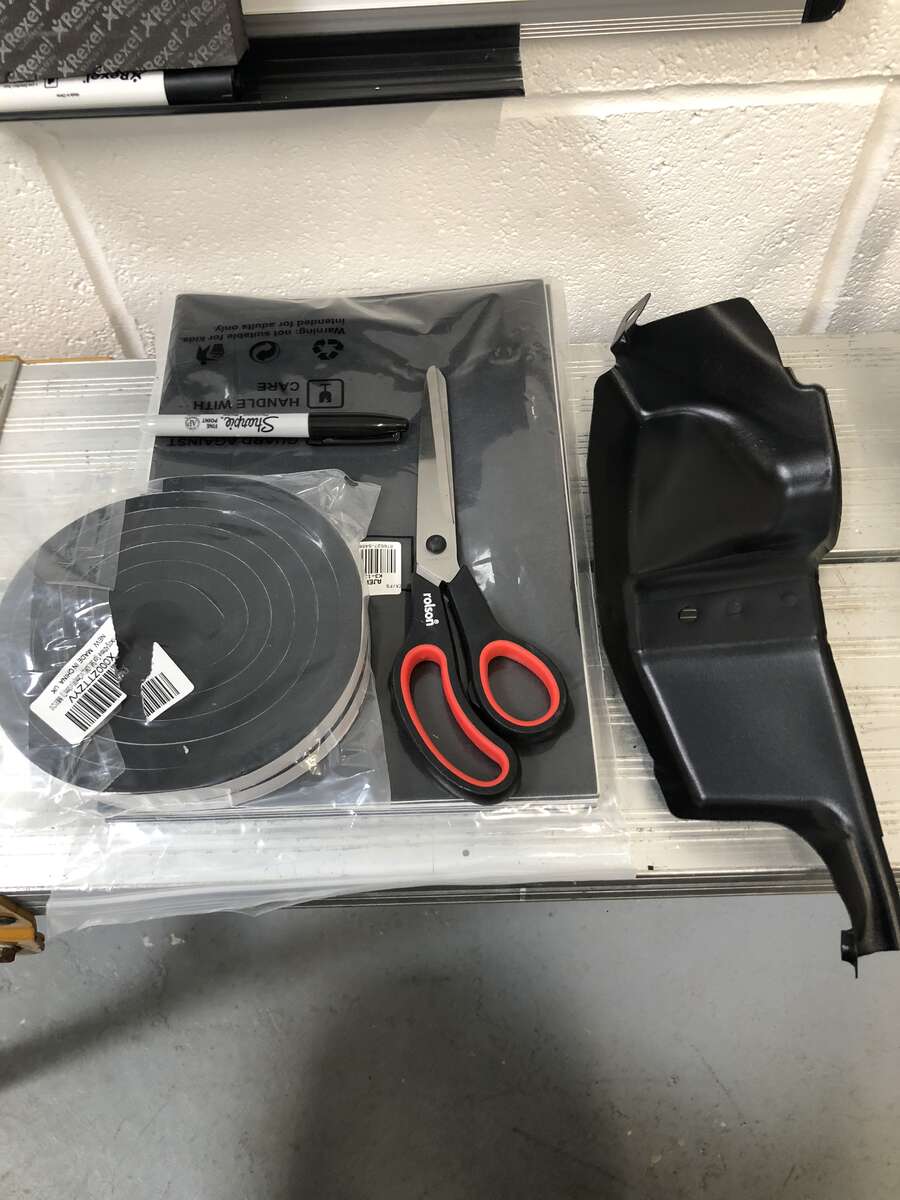

Cleaned the plastic retainers up that were okay to re use. Bought a packed of new ones as a few of they snapped when taking off the car due to how old they are.

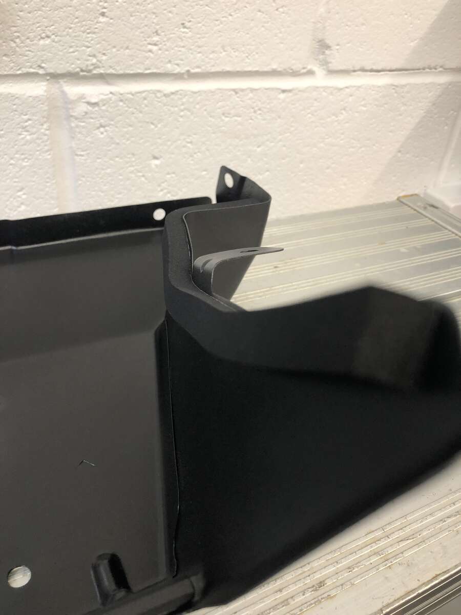

All new weather stripping for the rear fender guards and brackets.

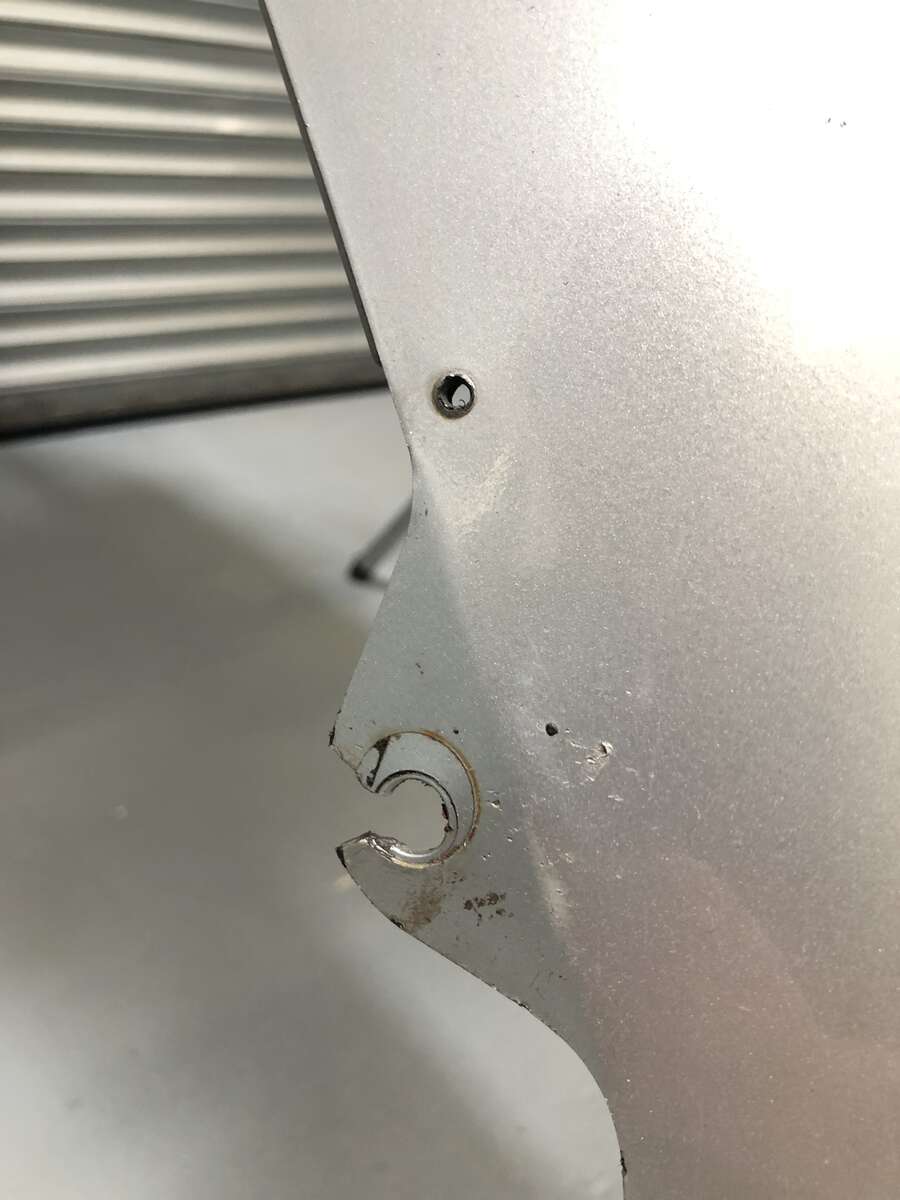

Some plastic welding on the bottom of the bumper and side skirts, not very neat but has done the job (will not see it anyway)
Rear arch lining and fender guards re assembled. Looking so much better now, well worth doing! Is solid now, no rust, no missing bolts or retainers.

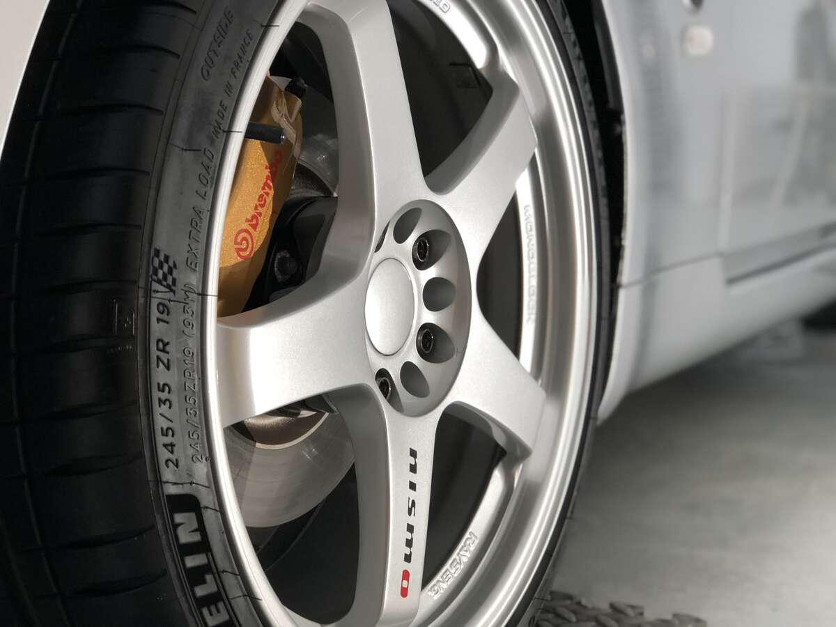

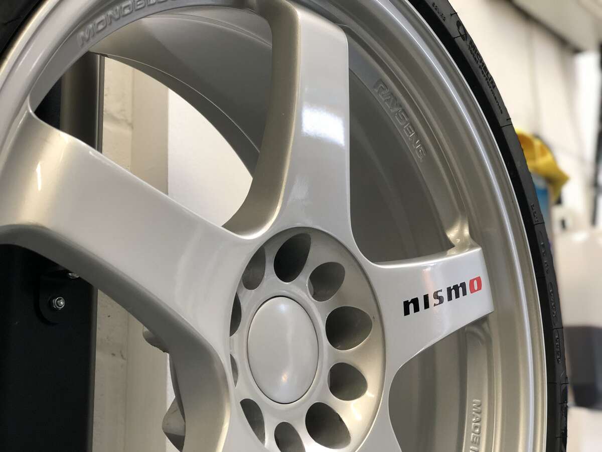

Final part of the detailing has been started. Wheels cleaned, decontaminated and ceramic coated. Also as you can see I ended up going for a new set of Michelin Pilot Sport 4s all round B)

So car should be done today, Bumper, side skirts and wheels are going back on, paintwork is being refined and waxed. Then just the little bits and its ready to be back on the road! Can't wait :yahoo:

Lush fella SUPER update as per and those boots should last you a decade :lol: for the front discs, ideally needed to have painted the entire centre boss as you did with the rears.
Yup hopefully! Yes agree with you with the front hubs but painting the hubs wasn’t on the list at all, was lucky to be able to find the time to do the rears. Need to get my car out the way, got customers cars booked in!
Great work Lewis!
What did you paint the wheel hubs with? Mine are in a similar condition. I added spacers purchased from Napp which were silver, they are on the car now and they draw my attention to the state of the hubs!
2 hours ago, Mikey_S said:
Great work Lewis!
Thank you. I used Hammerite Silver spray paint, also used one of those spray gun triggers that goes over the top of the can so you can get a better even coverage. I made sure I sanded off near to all the rust so it would last. Then two coats of Hammerite, 4 hours drying time between each.  I know there is better products out there then Hammerite but I had a can to use up.

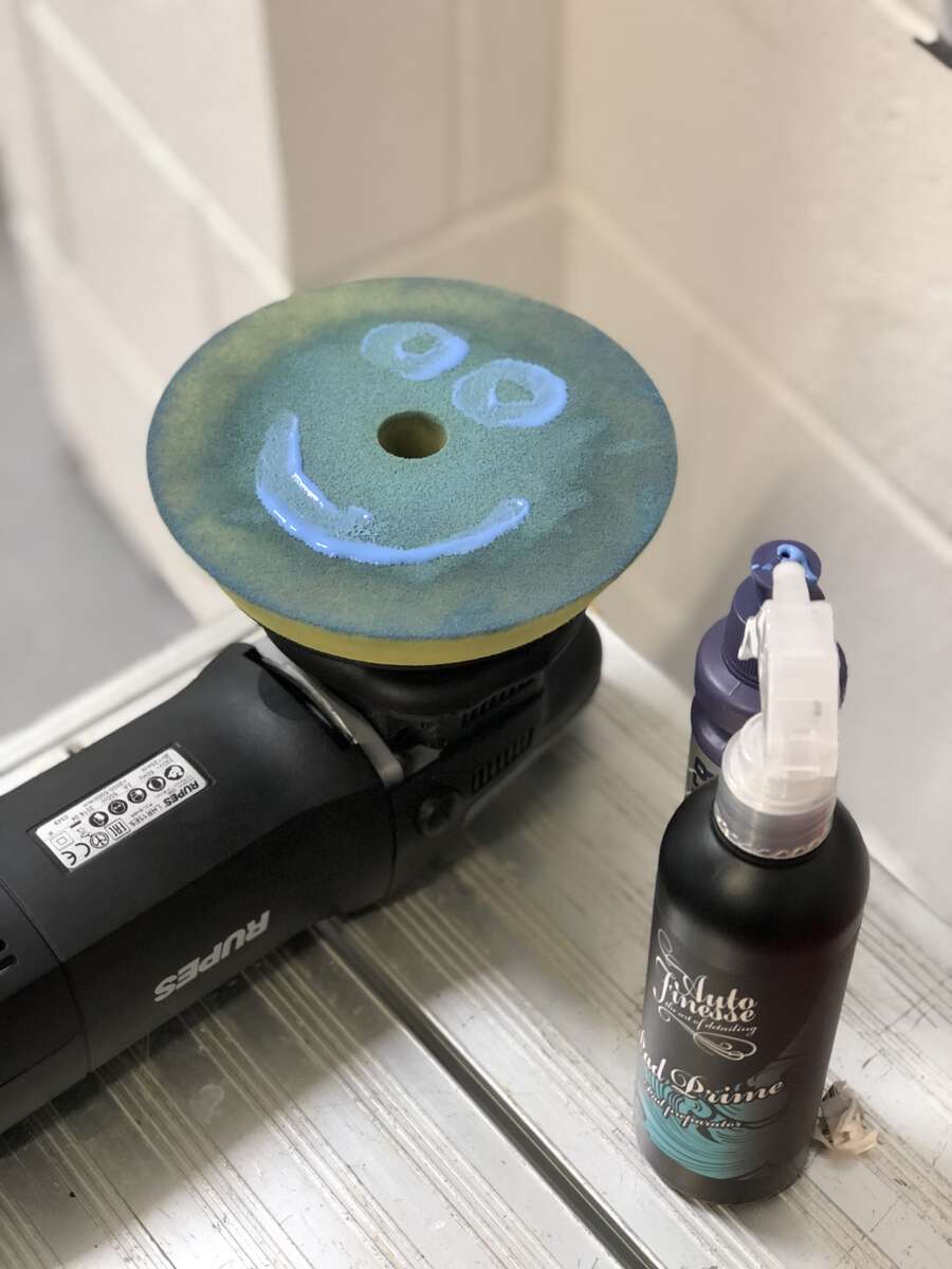

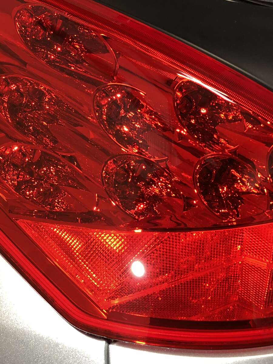

Rear Lights were cut and refined, had not cut these as knew it would be easier once back on the car, yellow Rupes pad with Koch-Chemie H8 followed by Gyeon Primer.

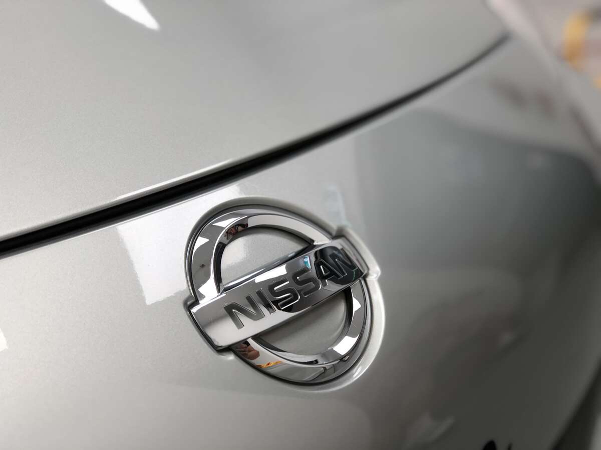

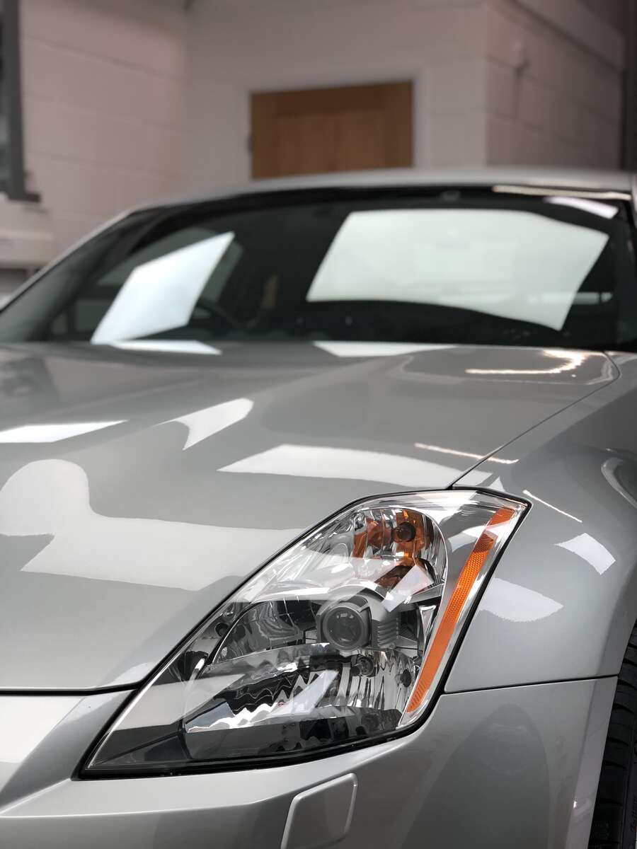

Onto the paintwork refinement, now this is where all the hard work ties in and for me is the most rewarding stage, although the Medium Cut I had done before had refined down really well, it never fails to surprise me just how much gloss you can achieve by a further refinement even when you think you could get away with not doing another step (obviously I would never actually not refine unless it was just a single stage detail). So the original plan was always to use a wax to finish off instead of a ceramic coating as with the future plan of the NSM bodykit going on and painted it would need to be detailed again after that anyway. So I have some Angel Wax Fifth Element that I was looking forward to using so I thought it would be great to use Gyeon Primer to refine and leave it on the car overnight as it creates a nice layer of SI02, a perfect base for the wax to go onto. So thats what I did....but I had ran out of time and my car needed to be out of my unit as I had the electrician coming in the next day :headhurt: Managed to polish the glass with CarPro Ceri Glass and coat with Carbon Collective Platinum Glass as well.
So car was refined, glass coated, wheels coated, ready to lay down some wax but was now outside...not ideal.
JUST MY LUCK it rained of course :dry: So the car was dusty and car had water spotted in places.
So got the car back in once electrician was done and gave it a quick wipe down with Meguiar's Wash & Wax. Now I could of then taken the water spots out with water spot remover then gave it a coat of wax and it would of been fine. But it didn't feel right plus there was a chance I had marred the paint whilst wiping it down. So decided to refine it all over again, by this time I had changed my mind and wanted to use a light ceramic instead of wax so no primer was needed. So Rupes White (diamond) polish was used. I then treated all the rubber seals with Swissvax Seal Feed (great product nothing else on the market quite like it). Then wiped down the car with IPA to prepare for coating. Car Pro CQuartz Lite was my product of choice, a 'light ceramic' that has great hydrophobicity and will last 6+ months, just what I need.

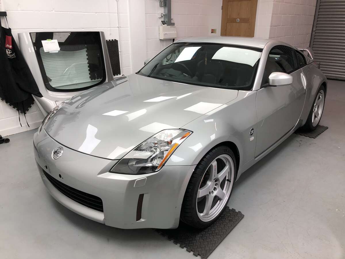

Just need to fit my front window wipers and the plugs for the wiper delete on the back, plates on then MKS Customs is coming over and wrapping the front lip black then the car is completely finished. Phase 1 COMPLETE. Car looks mega now, such a good feeling when its your own car. Nice to be in my customers shoes for once thats for sure!
Enjoy the finished photos, any questions please feel free to ask away!

You can sit back, relax and enjoy knowing she's been cleaned, refined and protected from head to toe. These look like Nissan brochure imagines from 2005!!! The plan now is to never hand to machine polish again, no matter how much you want too. Easier said than done no doubt id say. I still feel the DE headlights looking as fresh as these do, look every bit as good as facelift ones.

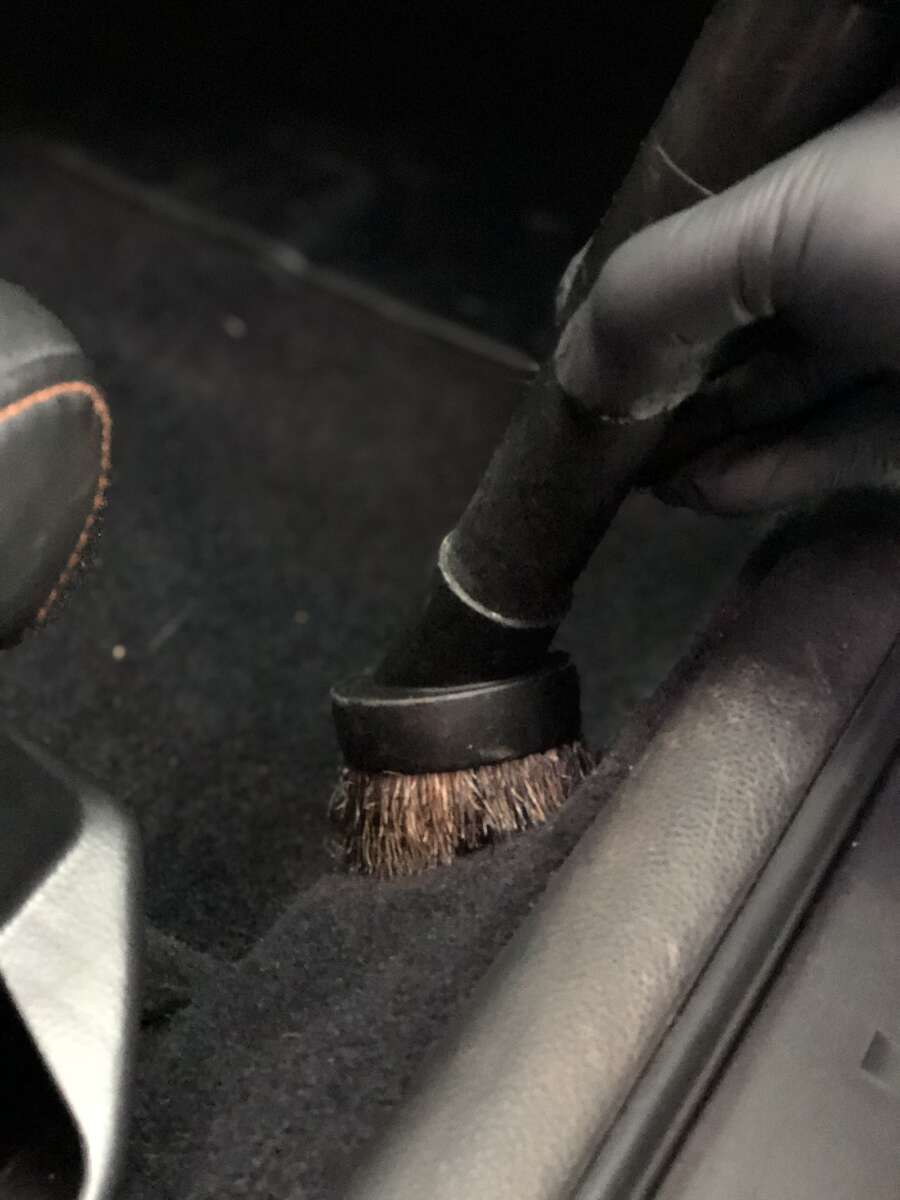

Managed to do my interior 'properly' minus taking the seats out which I will do another time.
Interior was probably the worst part about the car when I got it, one of the first things I did was give it a good vacuum and wiped all the surfaces down. Then at a later date I gave the steering wheel and seats a deep clean.
So yeah at surface level it wasn't that bad meaning I've only driven it a handful of times since doing the previous cleaning but today I spent time really focusing on the small details. Interior is now looking and smelling fresh, about 90% to where I want it to be, like I said taking the seats out will make up that other 10%.
Work completed:
All carpets and surfaces vacuumed

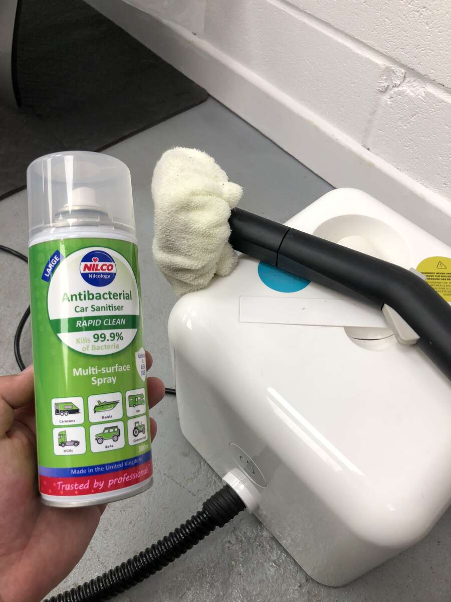

All surfaces wiped down with anti-bac solution
Headliner Steam Cleaned
Steam used to kill bacteria within ventilation system
All plastics cleaned with KochChemie MultiInterior cleaner

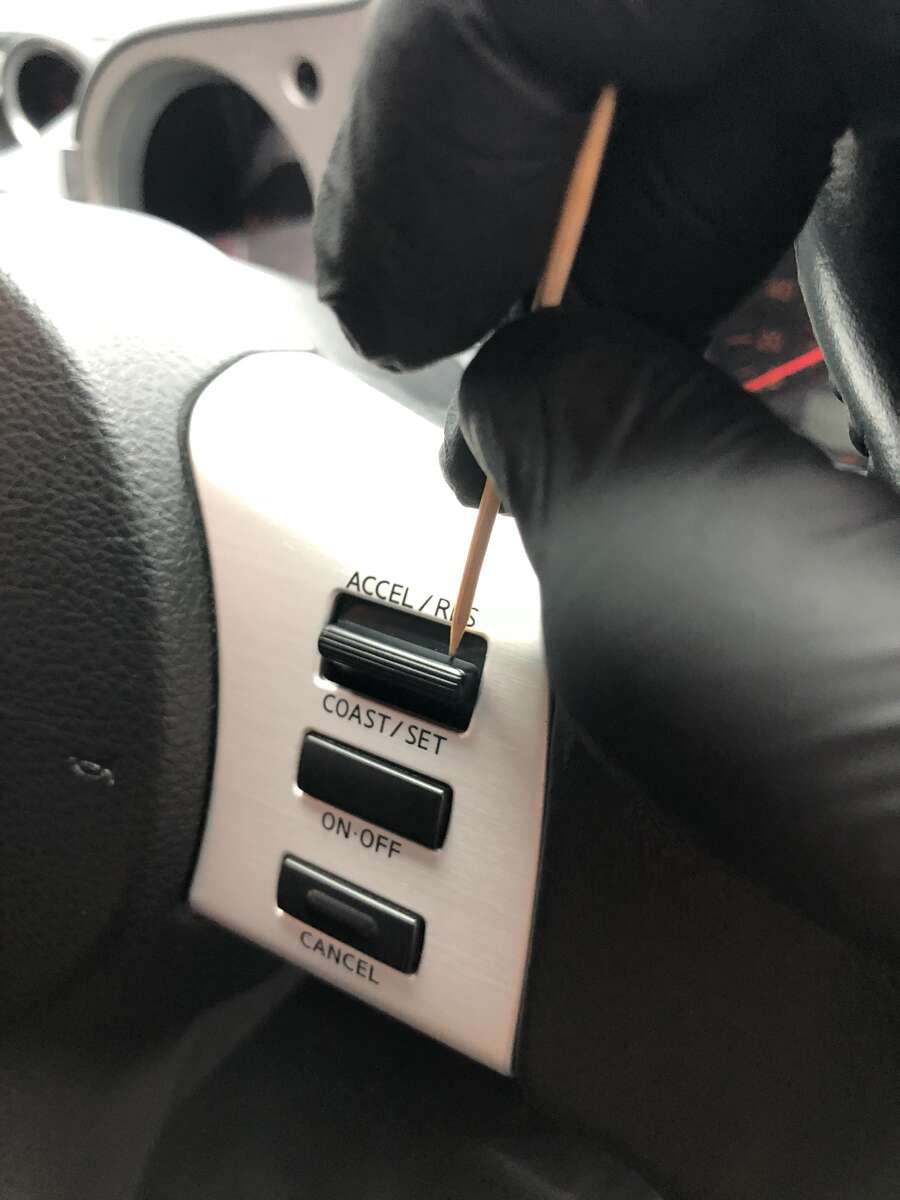

'Tooth pickery' carried out
Steering Wheel & Seats deep clean using Hog Hair brush and Angel Wax Heaven for Leather
Leather treated with Gtechniq L1 Leather Guard
Final quick vacuum
New Air Freshener
