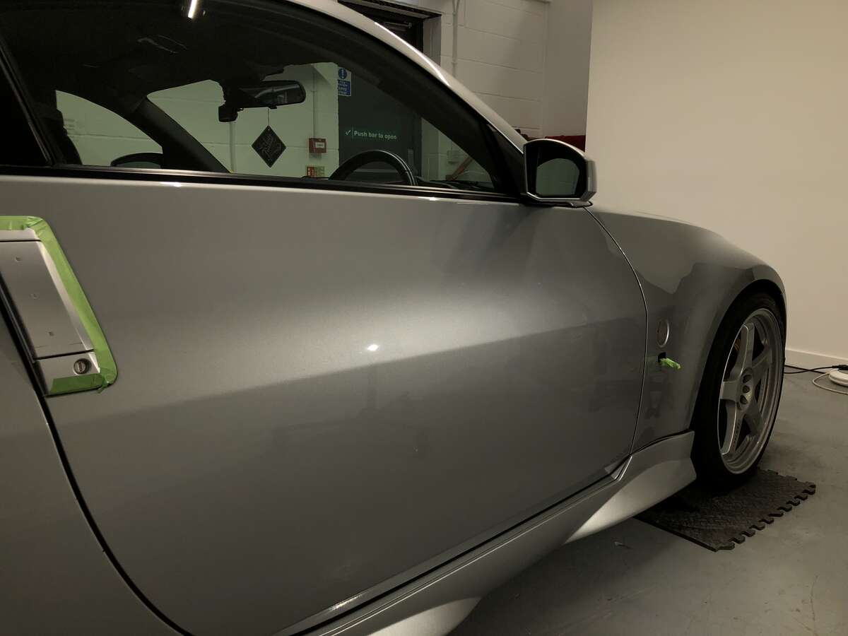

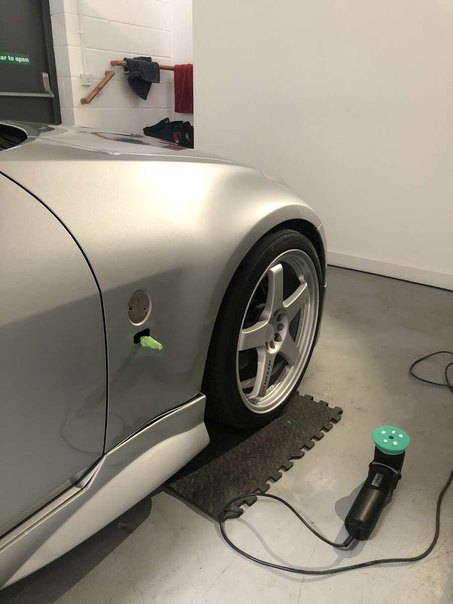

Overall a massive improvement, silver is one of the best colours at hiding defects so all lights off and Scangrip Multimatch's on for this one! Green Rupes pad and polish used with the Rupes machines. Found this combo works well on the softer paint thats on the 350z. Refinement still to go but that will be done once all the 'dirty' work is complete.

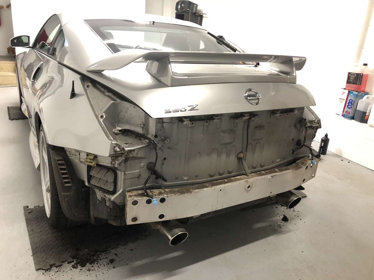

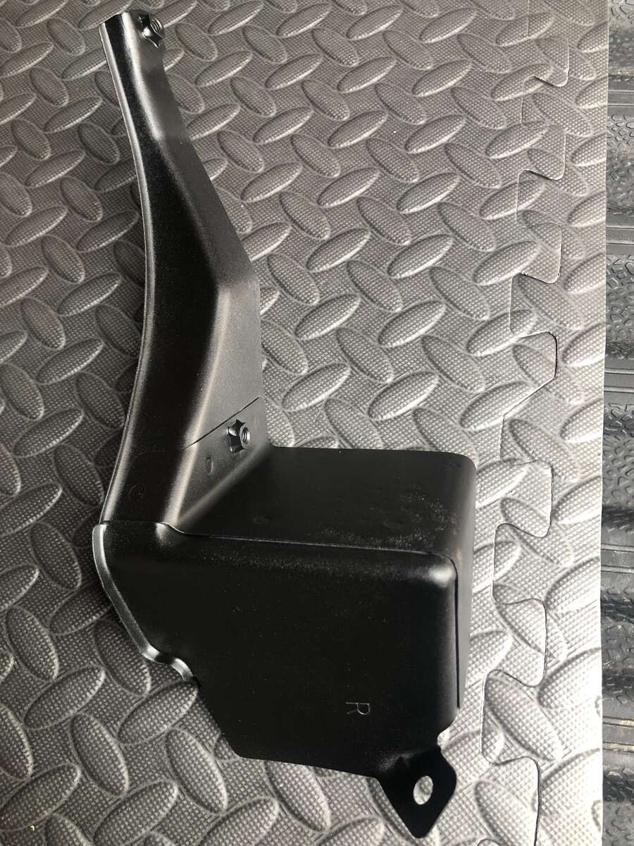

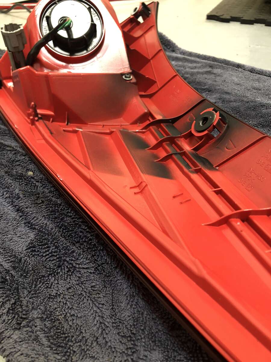

Back bumper has been taken off, underneath cleaned. Its crazy how much dirt was under here. Also the bumper was sagging down where it meets the rear fender on the drivers side. I managed to find the problem as one of the plastic retainers had been snapped so wasn't holding up. So another order with Torqen for a replacement. Back bumper dismantled and cleaned. Rear lights and back indicator lights cleaned and polished.

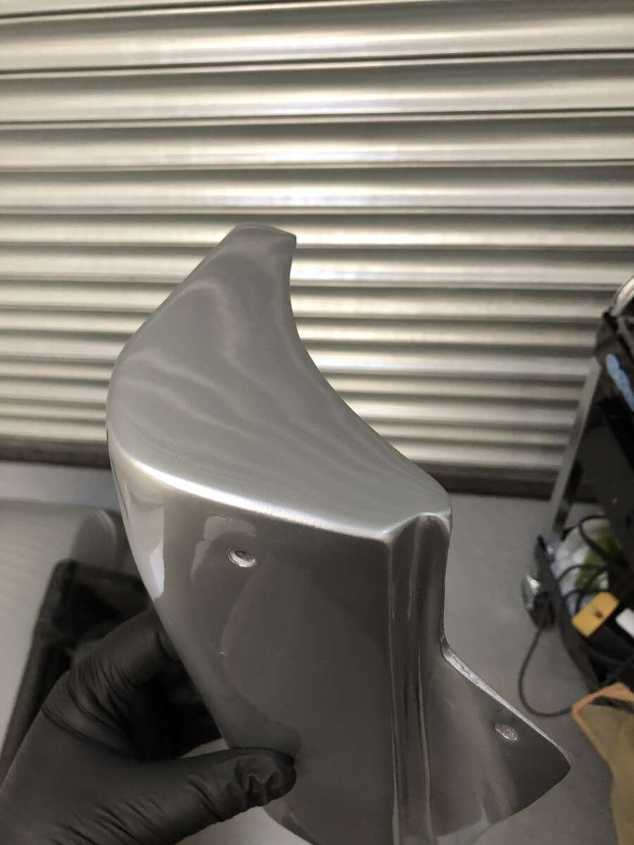

As I stripped the rear spats off they were in pretty bad shape, I thought it would be a shame to throw them away, so even though they were not going back on the car I had them professionally re done and painted. Rear carbon diffuser is also damaged but too far gone. Its been badly fitted so leaving it on the car would be better then revealing the mess it has probably made underneath.

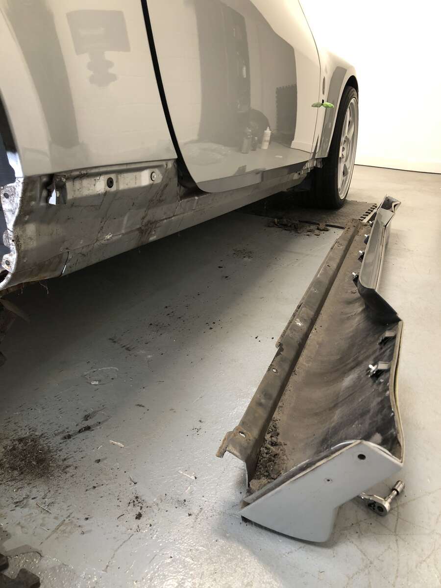

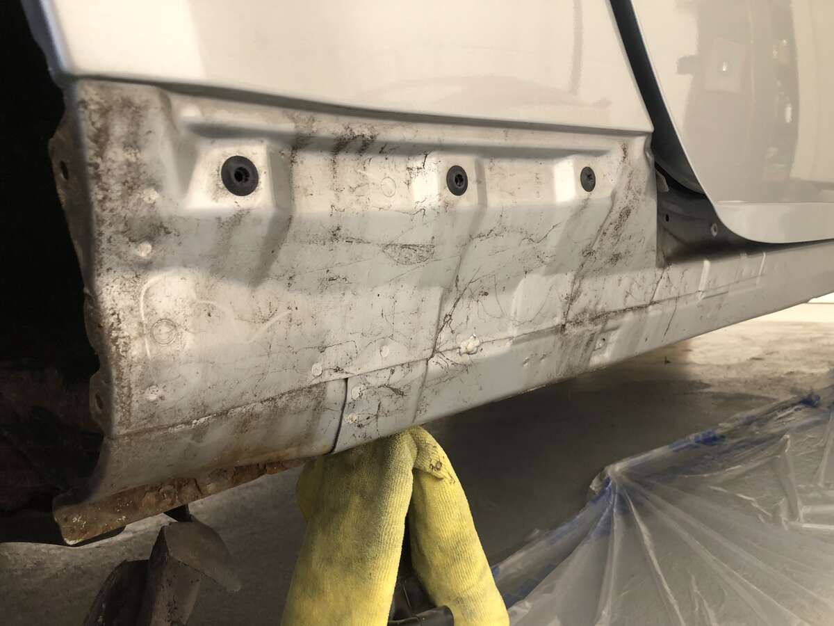

Side skirts have also come off. Again the amount of dirt that has been trapped and just sitting is unbelievable. I'm so glad that I'm able to get underneath all these parts that you wouldn't be able unless you stripped the car because I can't imagine its doing the shell any good in terms of rusting! 3D Carbon side skirts will come off and originals back on. I was able to take the side skirts off without snapping too many grommet clips :fool:  I did snap a whole tab off and a couple of the grommet clips will need to be replaced...better load up the Torqen website hey! :lol:

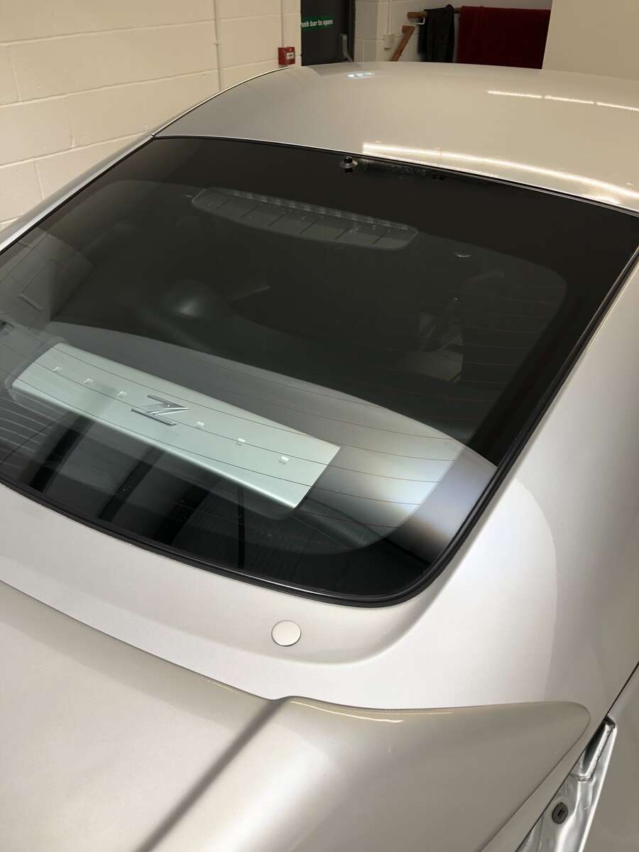

Rear wiper delete done, found a company in the states that do custom metal plugs and they colour code them as well. Still need to do the washer for anyone that is wondering.

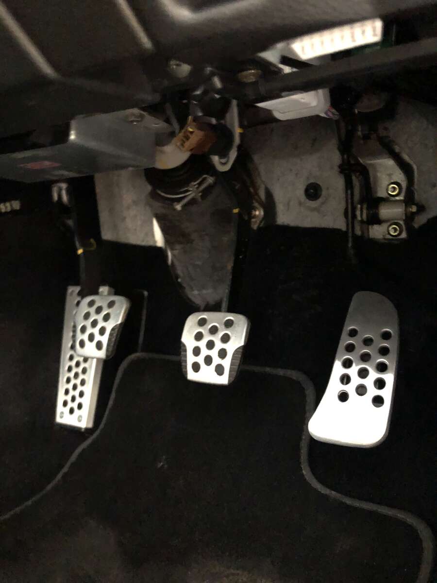

380RS pedal installed, this wasn't a planned purchased but one came up on one of the Facebook selling pages and it was still new in packaging so thought why not! I watched a couple of install videos on YouTube and I quickly found out my pedal clip was different to the videos I watched. Left me wondering wether or not it was because their cars were American or if it was a DE/HR thing. Didn't take photos so can't show you but basically the main clip behind the pedal is apart of the same moulding as the stopper where the ones I was watching in the video the clip was separate and the stopper was apart of the metal framing that the pedal plate attached too.

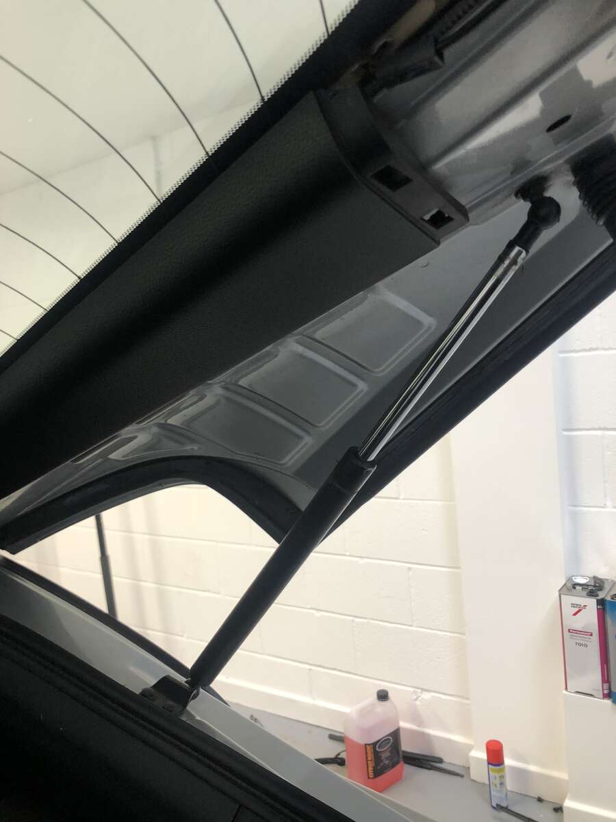

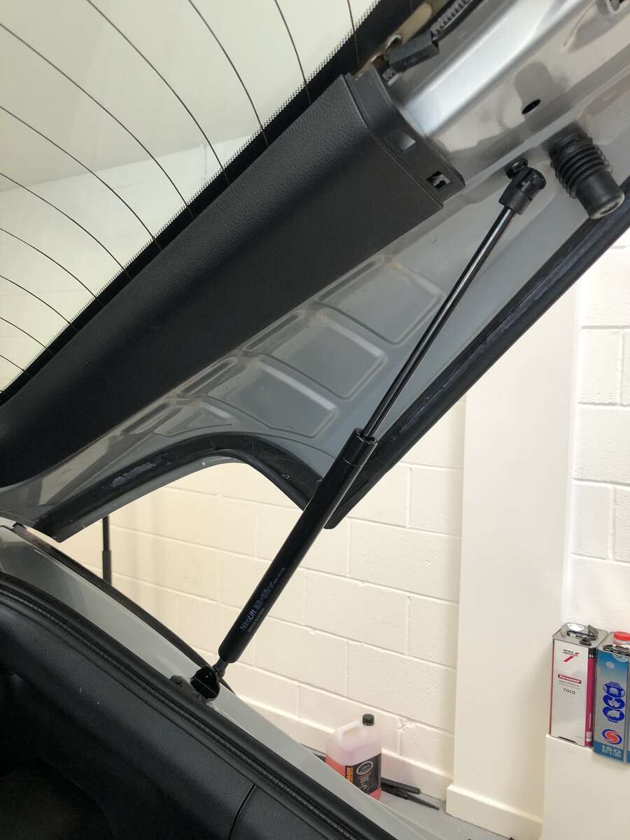

Boot struts replaced, nothing exciting but another job ticked off the list!

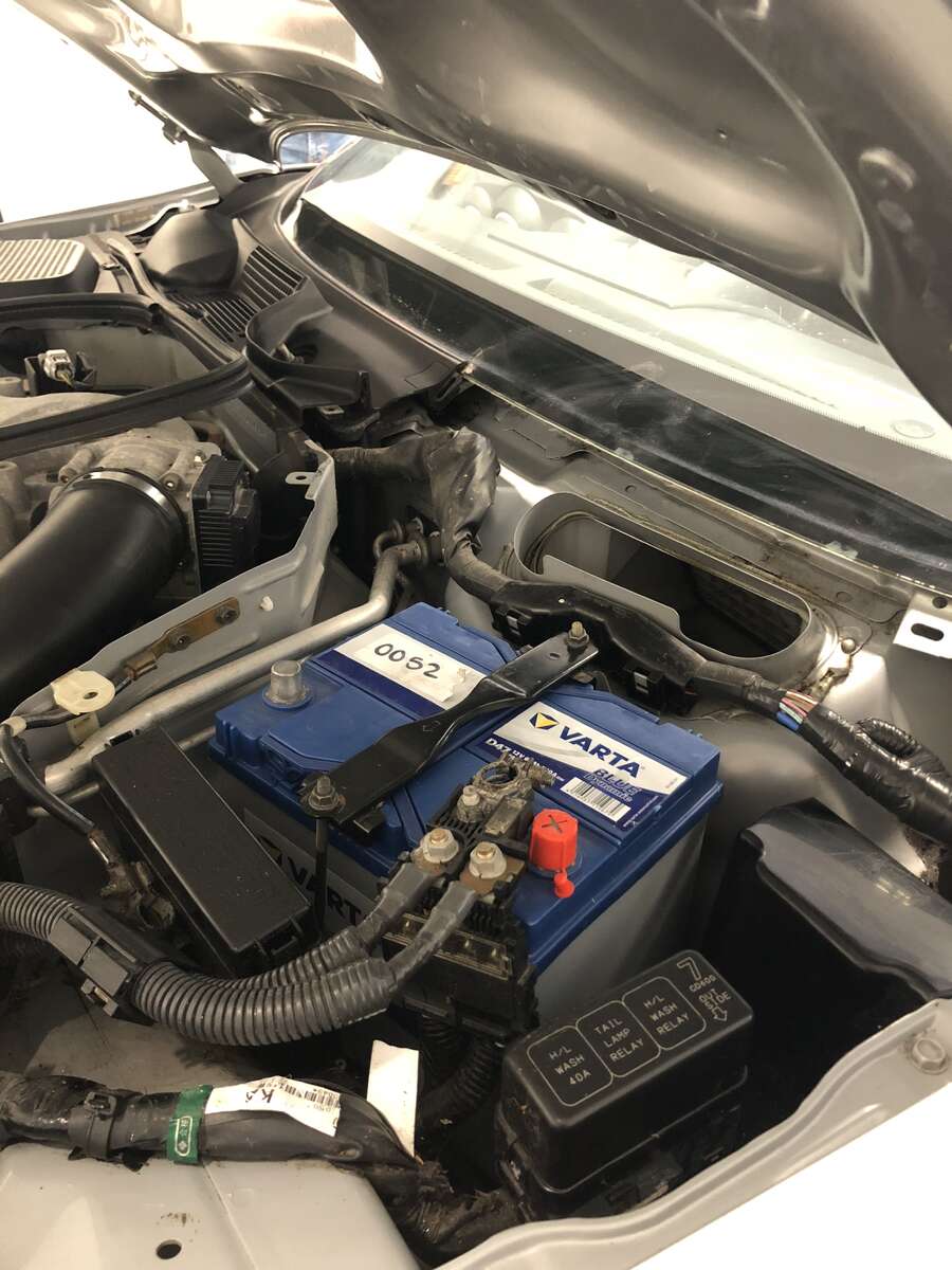

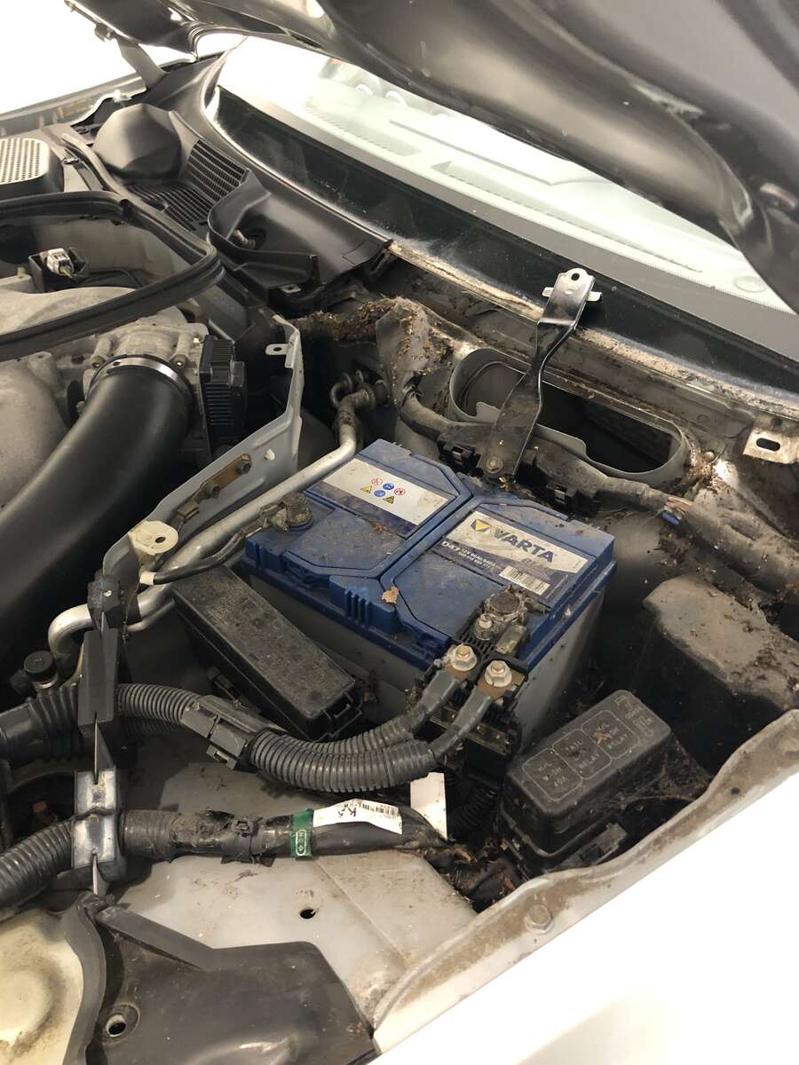

Finally had to replace the battery as I made the stupid mistake of forgetting to disconnect it whilst it was sat with the tailgate on the latch all this time :doh: an expensive mistake for sure. Gave me a chance to strip surrounding plastics and clean though!

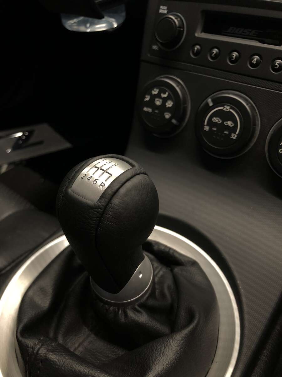

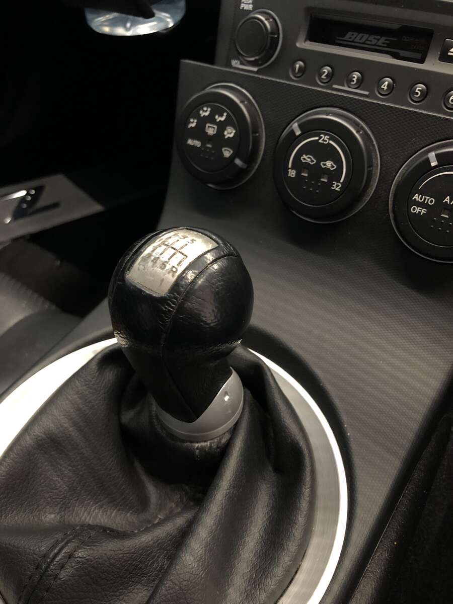

New gear knob fitted, not a fan of the aftermarket ones so OEM this time around. Looks super fresh now. Protected with Gtechniq L1 Leather guard

Great work Buddy.  Nice to see your Zed is getting the love, which is more than I can say for mine a the moment As it’s sat in the garage gathering  dust !
When I saw you’d got the boot held up, I was gonna say new struts time but you’ve got that covered :thumbs:
One thing my eagle eye did notice though with your new ones is that you’ve fitted the bracket at the bottom of the struts to the car upside down, if you compare the before and after pics. Which leads to the boot not closing flush to the roof. A very common  mistake when changing the struts  :thumbs:

Hi mate how did you detail the pedals?
Place Microfibre cloth on floor mat below pedals. Spray pedals with APC, I used Bilt Hamber Surfex this time around. Agitate with Hog Hair brush or old tooth brush would do the job. Then spray water to rinse off. All residue should fall onto the microfibre cloth so it doesn’t run down onto your floor mats. Then wipe pedals dry with clean microfibre.
Cheers buddy thanks for the tip

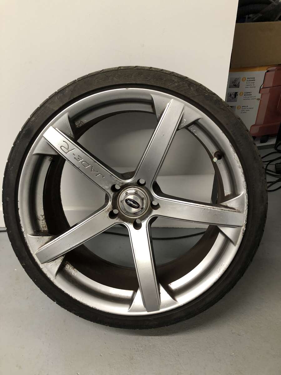

Side Skirts taken apart, front lip off too. Wheels, spats & side skirts sold. Original side skirts are at the paint shop as they have been damaged from poorly the fitted aftermarket extensions.

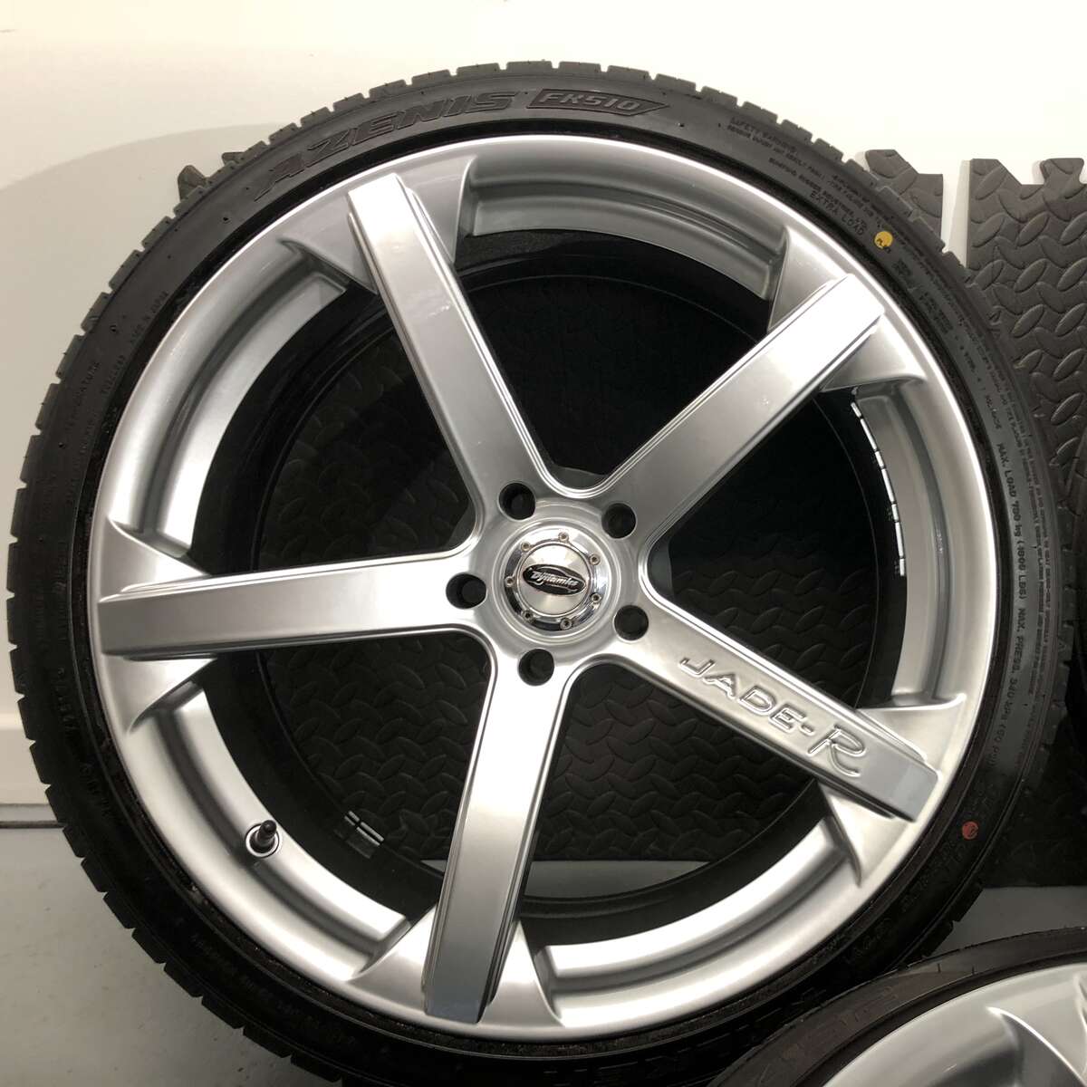

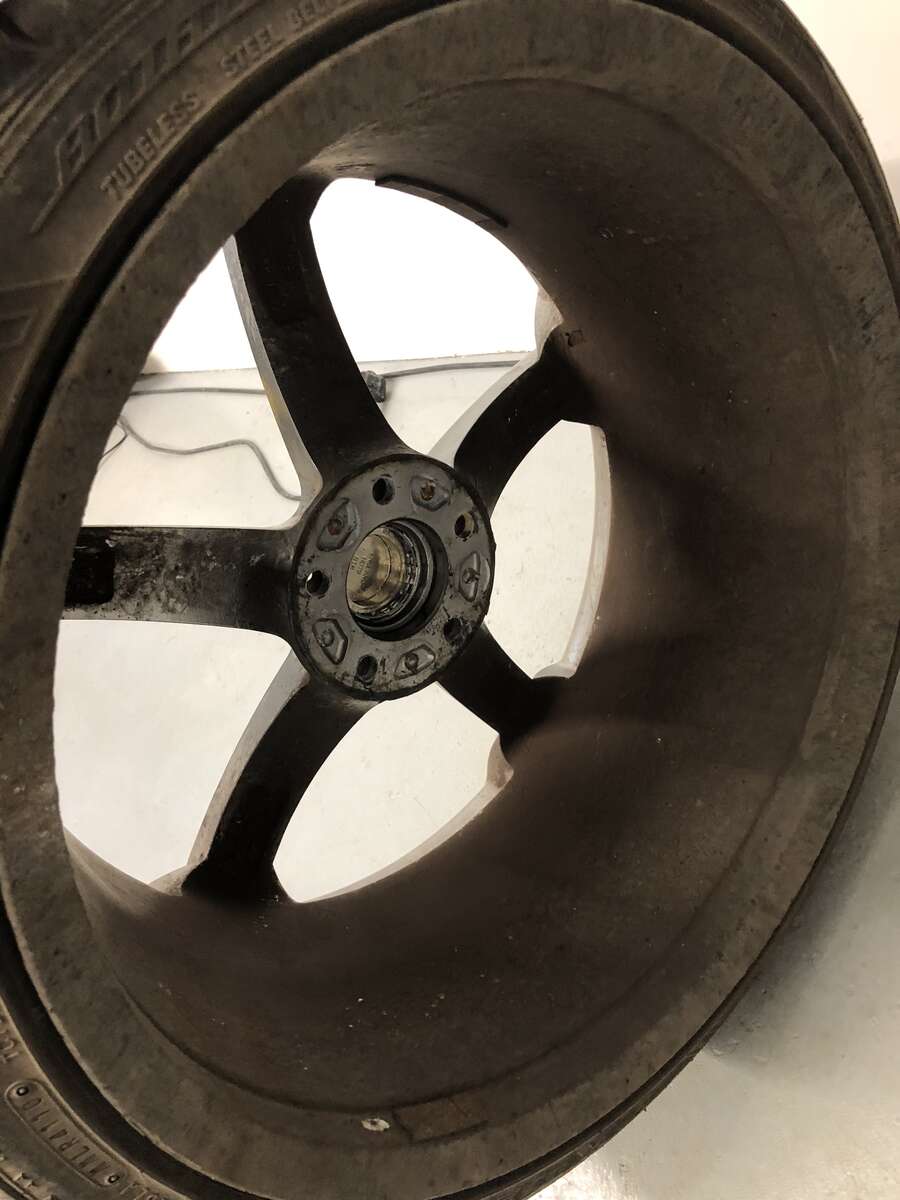

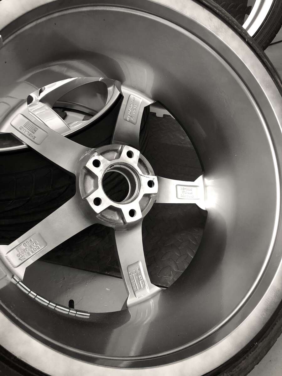

Here is some satisfying before and after photos when I got the wheels refurbished. New owner was very happy to say the least! Centre caps were a bit worse for wear but I did my best to try to save them, new owner put his own centre caps in anyway I think.
2106718459_Photo09-05-2020172312.jpg.10588956e9cf078448f3076d614c4976.jpg1409060405_Photo20-05-2020153702.jpg.1565a47894b46979b0f64a1a568dfc21.jpg
1417818368_Photo09-05-2020172217.jpg.cc8bf2ce2846f75939f8f9931359b300.jpg420347570_Photo20-05-2020154307.jpg.ca84d9663f2d3ec094c9824c7c592198.jpg

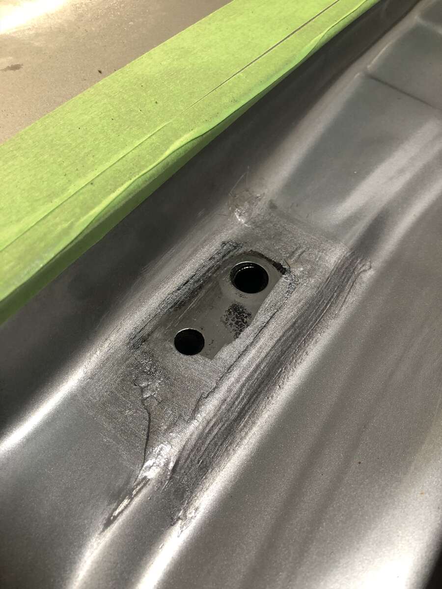

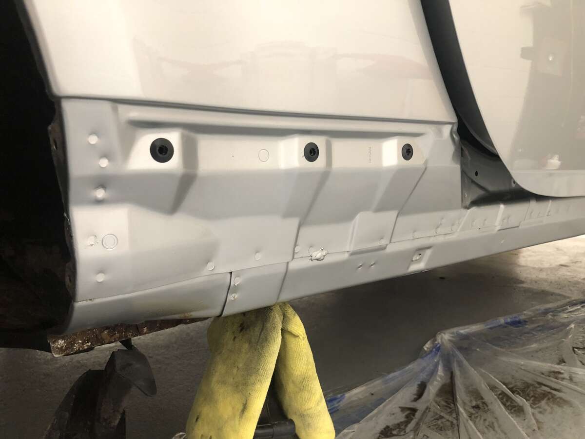

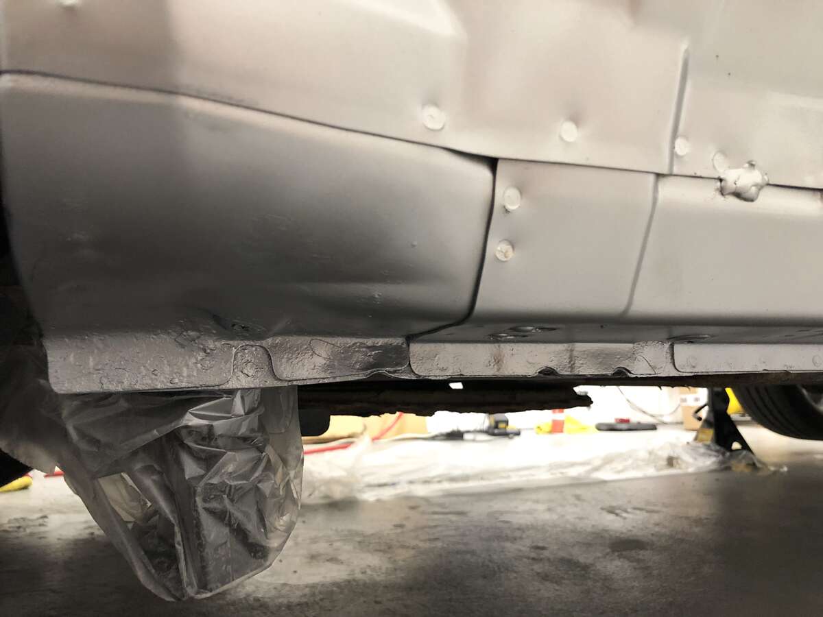

Cleaned under the side skirts, used Bilt Hamber Surfex HD with Hog Hair Brush and steam cleaner. Then proceeded to remove the rust from the lower sills. Used a wire wheel to grind rust away down to the metal, smoothed with sanding block, degreased then used grey primer and KY0 Silver to finish off, very pleased with the results!
380380163_Photo22-05-2020165325.jpg.bf1e98ffb9b11e462e630c9b28a309ca.jpg401485762_Photo22-05-2020173040.jpg.969e61ca9a5022d7c9e8481b8bf7f3e0.jpg

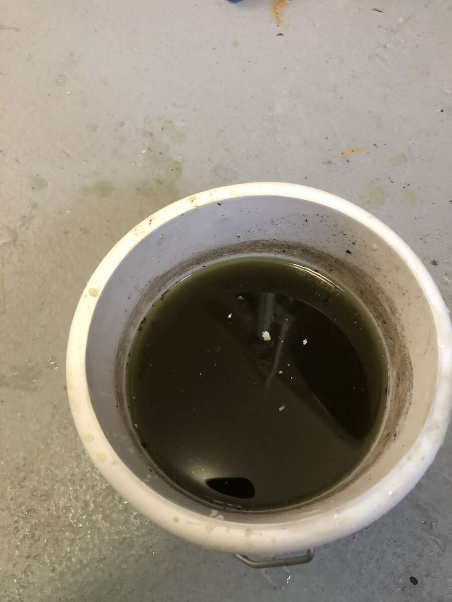

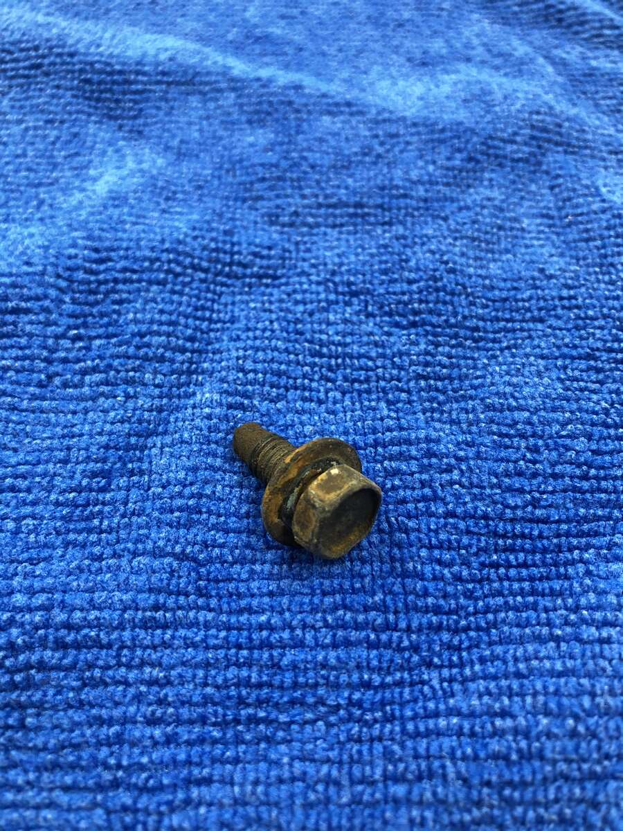

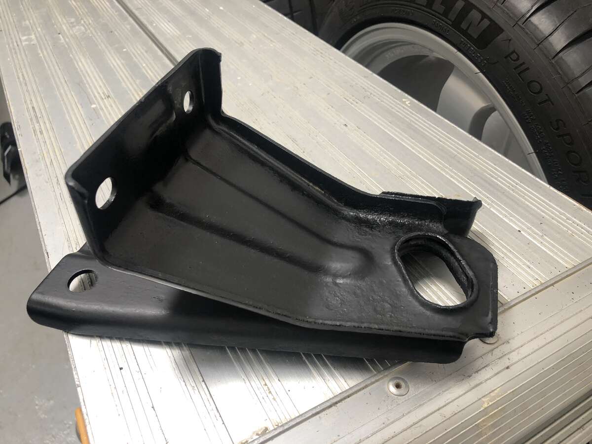

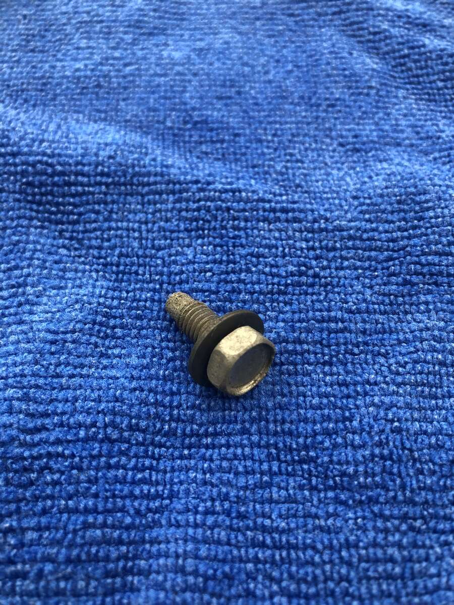

Have also refurbished every bolt that I have taken off the car (probably around 30-40 at this point) I let them sit in a bowl of Bilt Hamber Detox-C. Wasn't expecting miracles as some bolts seemed too far gone but miracles I got! Couldn't believe how good the product was! Left over night and pretty much stripped all the rust off every bolt leaving them looking like new.

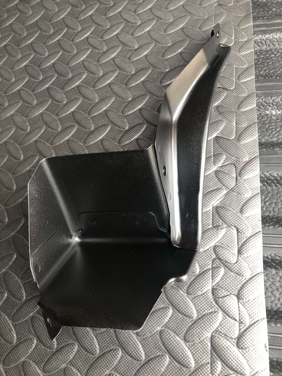

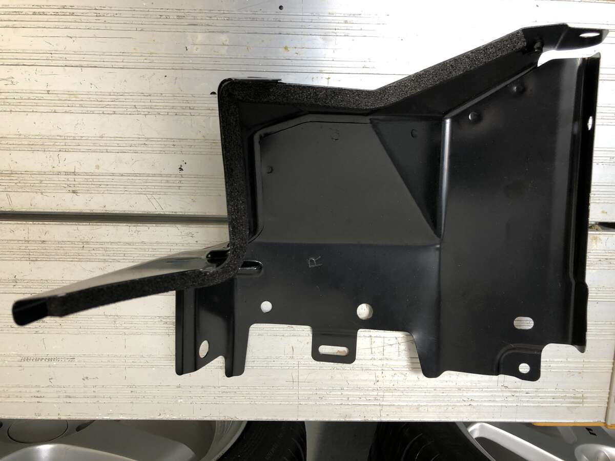

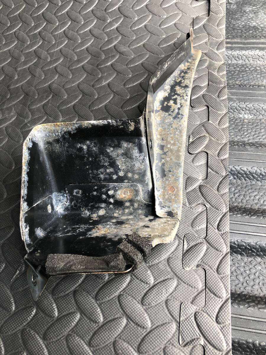

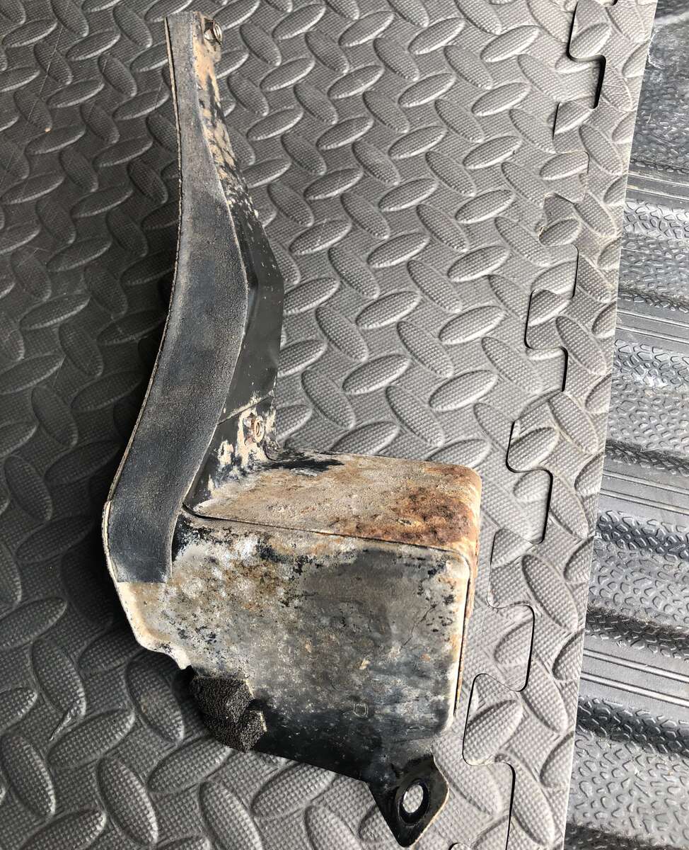

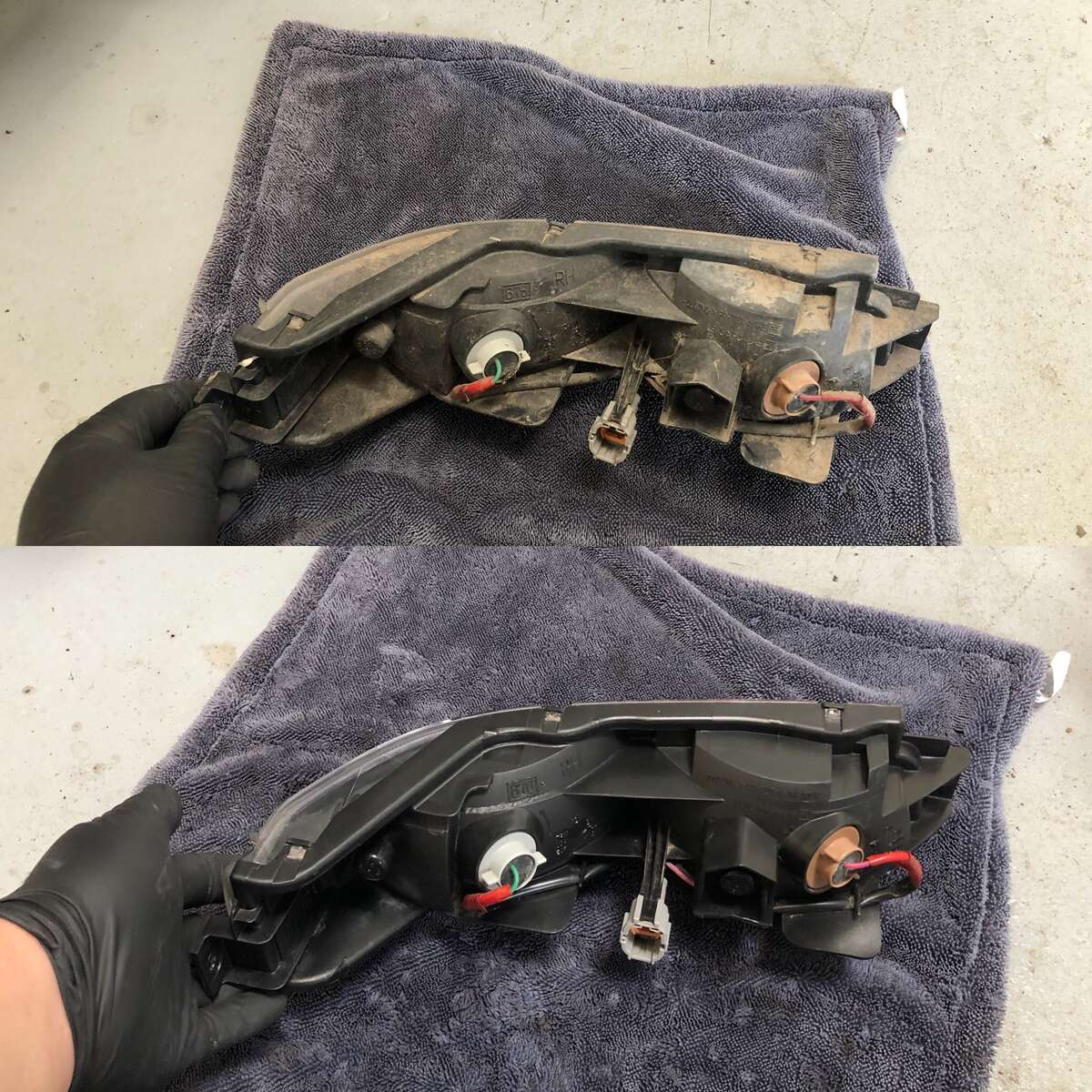

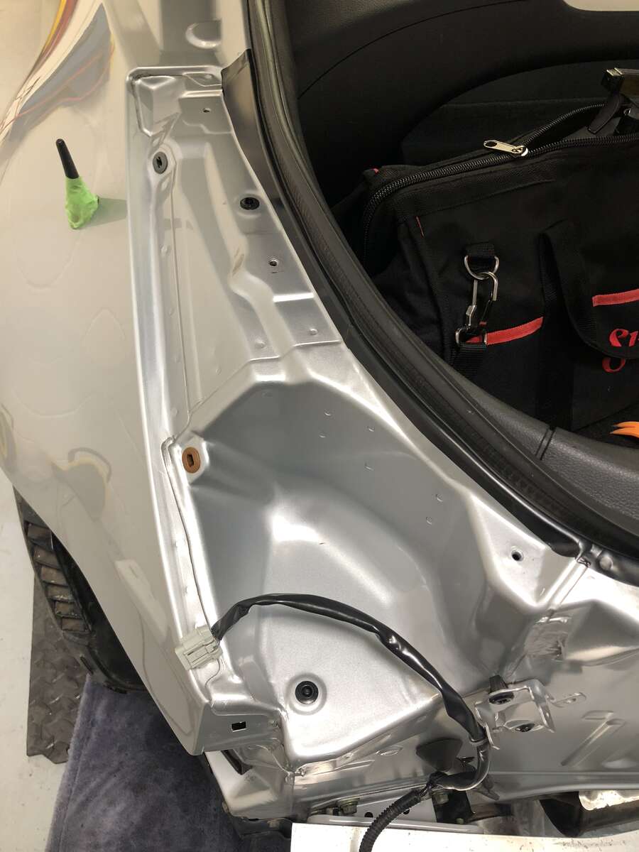

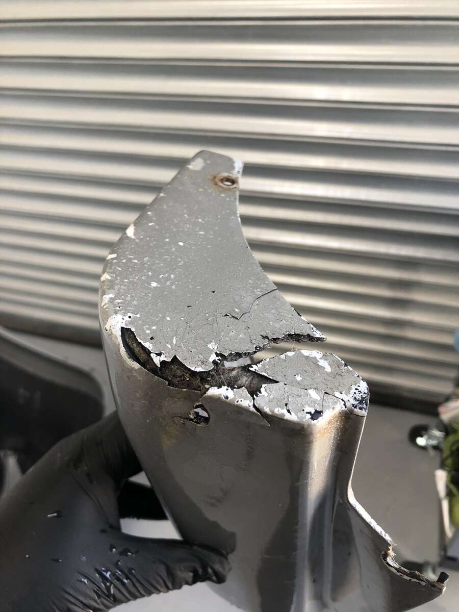

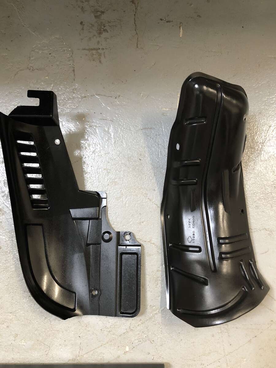

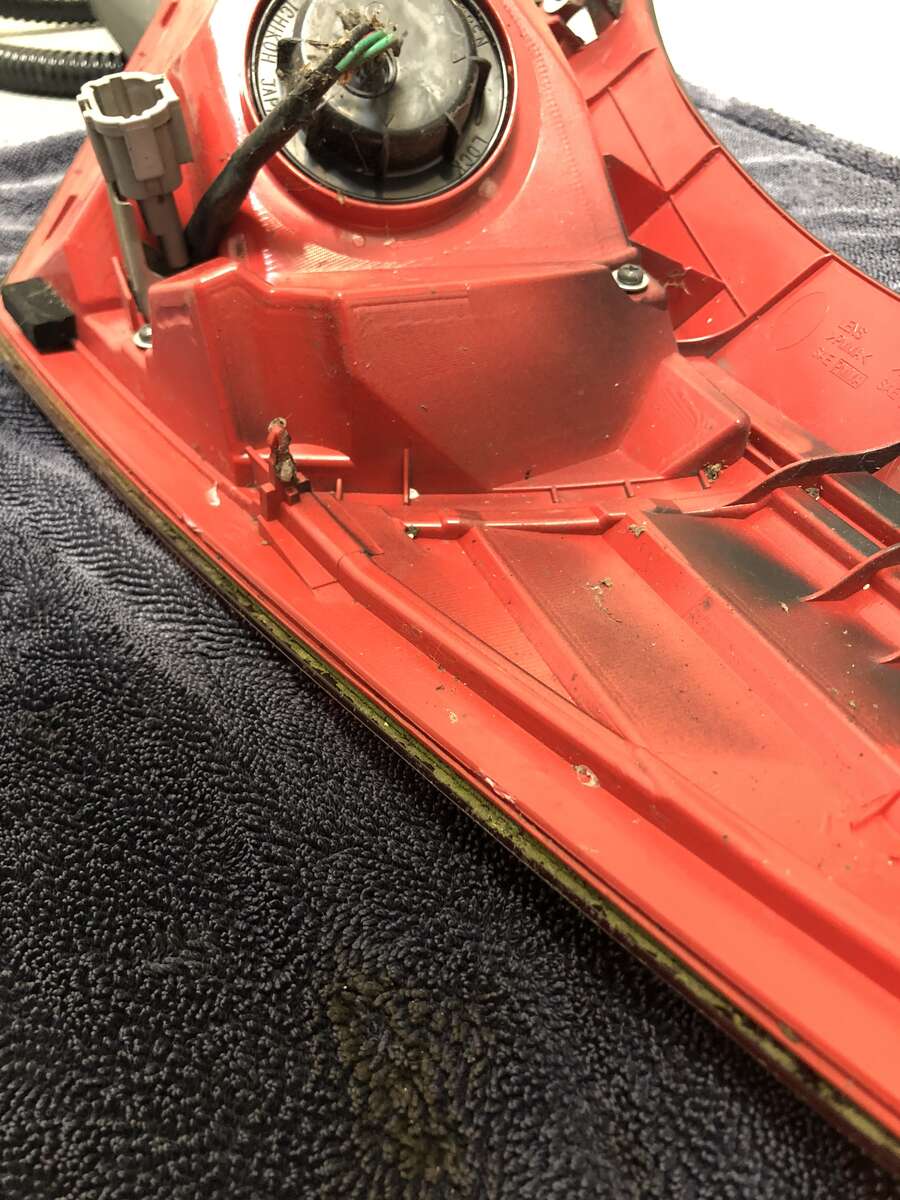

Rear arch liners and fender guards removed, now after seeing how must dust rust removal creates when using the wire wheel I decided to leave the wheels arches for another day, the whole underneath needs doing at some point so no point making a mess in my unit, anyway breaking down the fender guard supports and arch liners gave me access to clean the fuel filter neck and other areas I couldn't before. Arch liners, cleaned, de tarred and coated with trim coating.
All the rear arch liner supports and fender guards themselves were badly corroded along with the bolts that held in place the arch liners which are connected to the supports, so much so that I had to hack saw them off and drill out. Dismantling these rear sections just makes you realise how badly designed they are. 1. Why are plastic arch liners held in by plastic retainer clips in most areas and then metal bolts in others. 2. The fender guards and lower arch liners sit flat which allows build up of everything that the wheels flick up causing bad corrosion and rusting. Anyway rant over :lol: have now made so that arch liners are only held in by plastic retainers to avoid having to hack saw rusted bolts off again. Drivers side fender guard was replaced (thanks Adrian) and the passenger side fender guard and all supports were sent off to be sandblasted.  They were then painted (Grey Primer and Satin Black) on the bits that sit flat I gave a base coat of POR-15 Rust prevention paint to give good protection. Here are a few before and after photos of a couple of the bits that were done (weather strips to be added)
