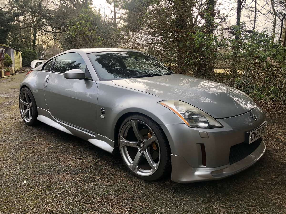

So on Sunday I travelled up North to England/Wales border where I went to view a fellow forum members low milage silver 55 plate Z.
Now I had my heart set on a HR but for the price, low milage and all original paintwork I couldn't resist!
So here it is 350z DE Silver, one owner from new with 31,000 miles on the clock!

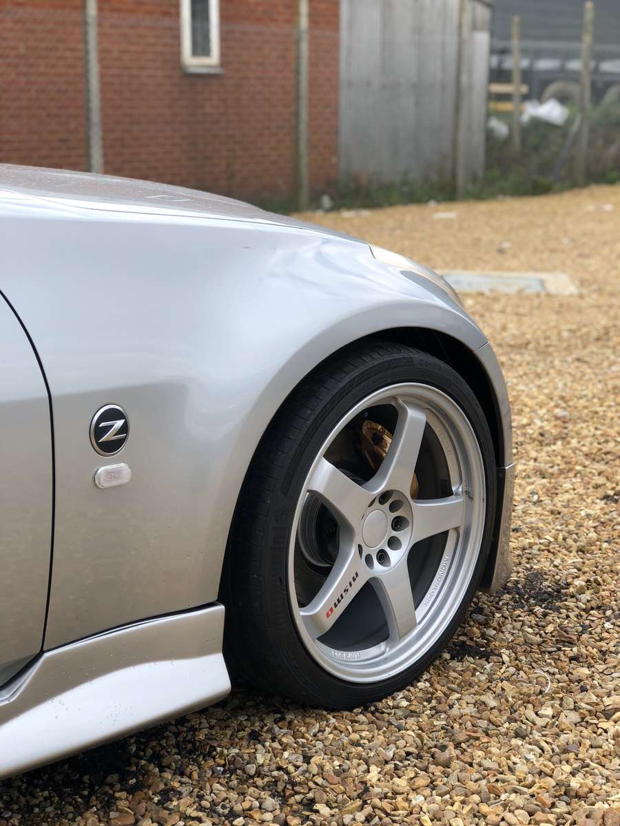

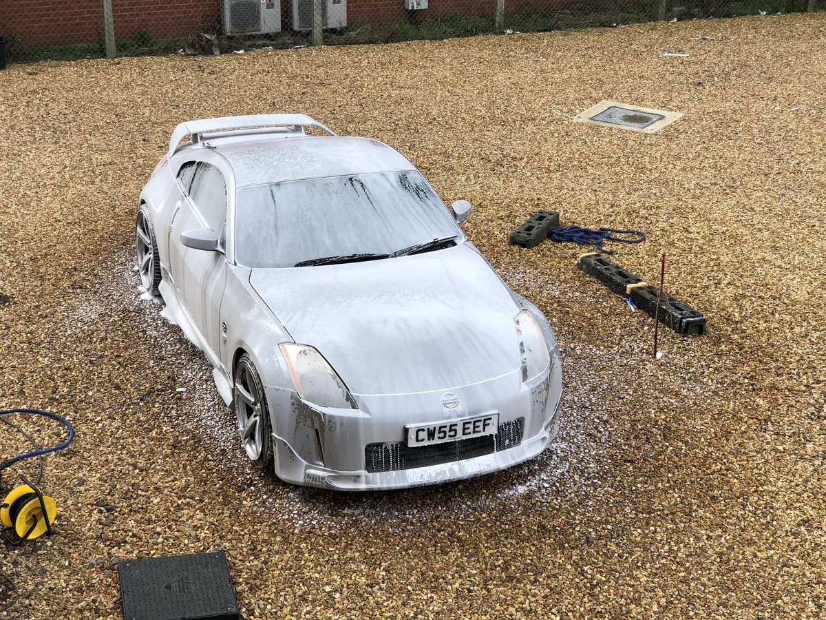

So had a few spare hours today so decided to just get the bodywork cleaned and decontaminated. The wheels are beyond saving but I've got my LMGT4's to put on anyway B)
Car was pretty bad due to being sat on a driveway surrounded by tree's, a lot of moss and build up in every crack and crevice but nothing I couldn't sort out. Procedure was as follows.
Citrus Pre Wash
Snow Foam
Rinse
Hog Hair brush & APC - Boot Shut, Door shuts, Petrol Cap, Weather strips, all rubber trims, wing mirrors, badges, front grill & light surroundings
Rinse
Snow Foam
Hog Hair brush and APC steps repeated
Wheel Arch flush
Rinse
Two Bucket Method Wash
Rinse
Iron Out Decontamination
Clay Bar
De Tar
Snow Foam
Rinse
Gyeon Wet Coat applied
Rinse
Hand Dried with Drying Towel

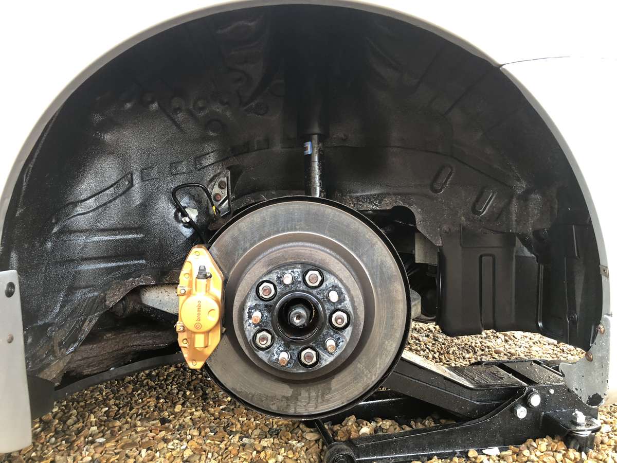

Had Friday to myself so time to do some more deep cleaning on the Z.
I had flushed the arches out when I did the clean and decontamination but knew it needed wheels off to properly get them clean. Huge chunks of mud had gathered onto pretty much everything, especially on the back arch lip, as many of you know dirt and moisture sits on this lip and thats what causes the rear arches to rust so was important this was seen too.
Procedure was as follows:
KKD Citrus pre wash
Jet Wash flush
KKD Ferrum Iron Fallout
Agitate all components with Hog Hair brush
Rinse
Surfex HD Degreaser, agitate with Hog Hair Brush
Rinse
Auto Smart Tardis
Rinse
Hand Polish Calipers w/ Auto Finesse Tripple
Chemical Guys Bare Bones Undercarriage spray
Pleased with the outcome, I will do them again at some point and see to the surface rust and treat it with Hammerite but makes sense to do that when I'm changing the brake lines
Put my LMGT4's on as well, absolutely love the silver on silver, looks even better then I envisioned

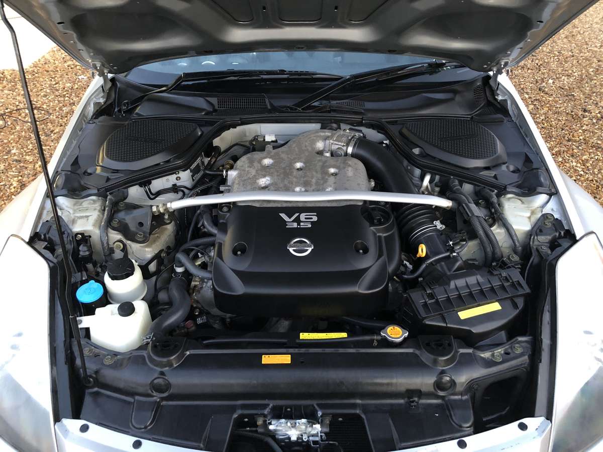

Next job was the engine bay, did that whilst I snow foamed and rinse the whole car just to take the dust the rain water had left the day before.
Procedure for this:
Surfex HD Degreaser
Hog hair and EZ Detail wheel brush to agitate
Jet wash rinse
Blow dried with MetroVac Air force blaster
Hand dried with Microfibre towel
All plastics treated with Auto Glym Vinyl & Rubber care
Again only a moderate clean always room for improvement!

I've only ever cleaned my bay with cloths being apprehensive about hosing or jetting.
Age old question.
What did you cover to rinse the zed bay off with your pressure washer.
I've only got a weak portable Worx pressure washer so it'd be a fraction of the power of a proper one, but being a bay rinse virgin I'm still a bit nervous :lol:

In regards with pressure washer and engine bays. Most modern engine bays are ok to jet wash as long as you don’t go silly like putting the lance right close up against a plug. Steam cleaning is a more ‘safe’ way of doing it but as you could see mine was so bad and with a lot of debris and dirt in the side crevices so needed pressure to flush out.
