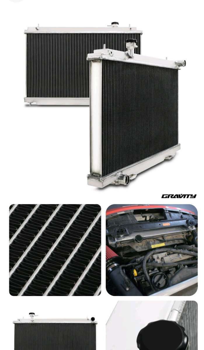

Nismoandy Posted February 28, 2023 Author Share Posted February 28, 2023 (edited) These are the new radiators reasonable easy to install the japspeed water radiator fit's in the original 350z mount, and the oil cooler i mounted in front of the water radiator with some aluminium plate in a previous photo with a finger pointing at it Edited February 28, 2023 by Nismoandy More information 4 Quote Link to comment Share on other sites More sharing options...

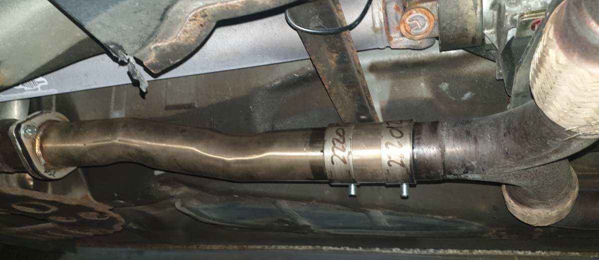

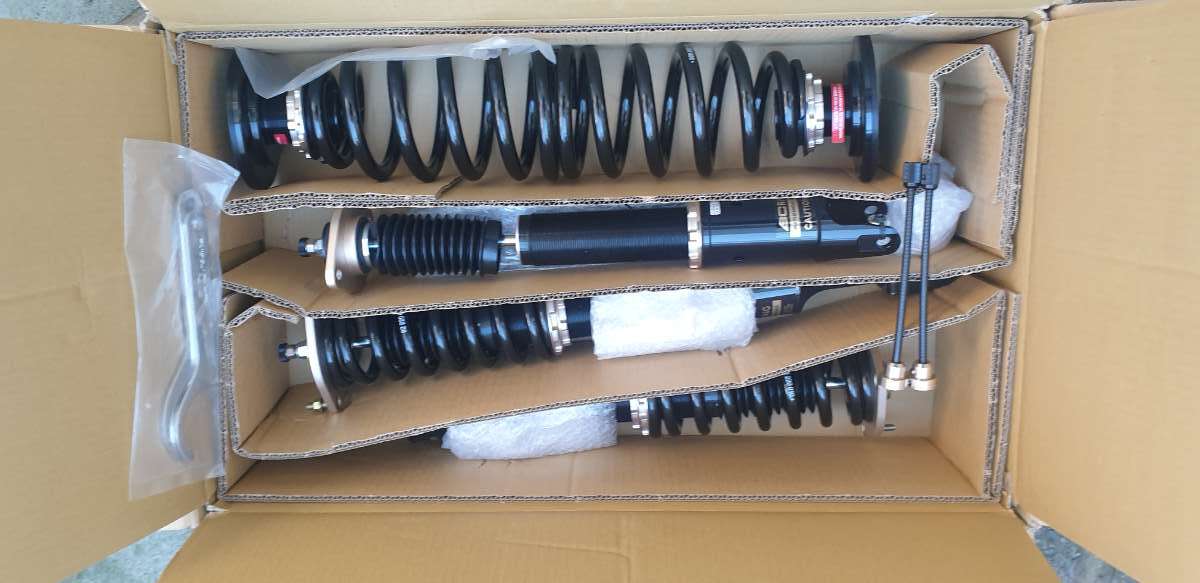

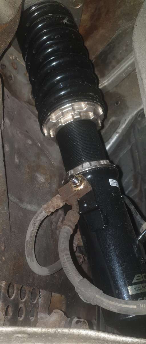

Nismoandy Posted April 21, 2023 Author Share Posted April 21, 2023 So I have been cracking on with the build and have installed a very nice set of bc coilovers and I'm really pleased with them, they are BR series, comfort springs, reusing the existing spring bucket at rear and uprating the front . Also have done a small change to the wiring as the start crank sensor was wired incorrectly, also rerouted the Air intake to the grill for better consistent air temperature . Also have tidy-up the exhaust under the car. 5 Quote Link to comment Share on other sites More sharing options...
davey_83 Posted April 21, 2023 Share Posted April 21, 2023 Fantastic additions, you lasted well on standard shock absorbers with all that power. That exhaust looks alot cleaner than the previous bypass set up. Drycharger I can recommend one of these with the filter behind the grill, better safe than sorry. 1 Quote Link to comment Share on other sites More sharing options...

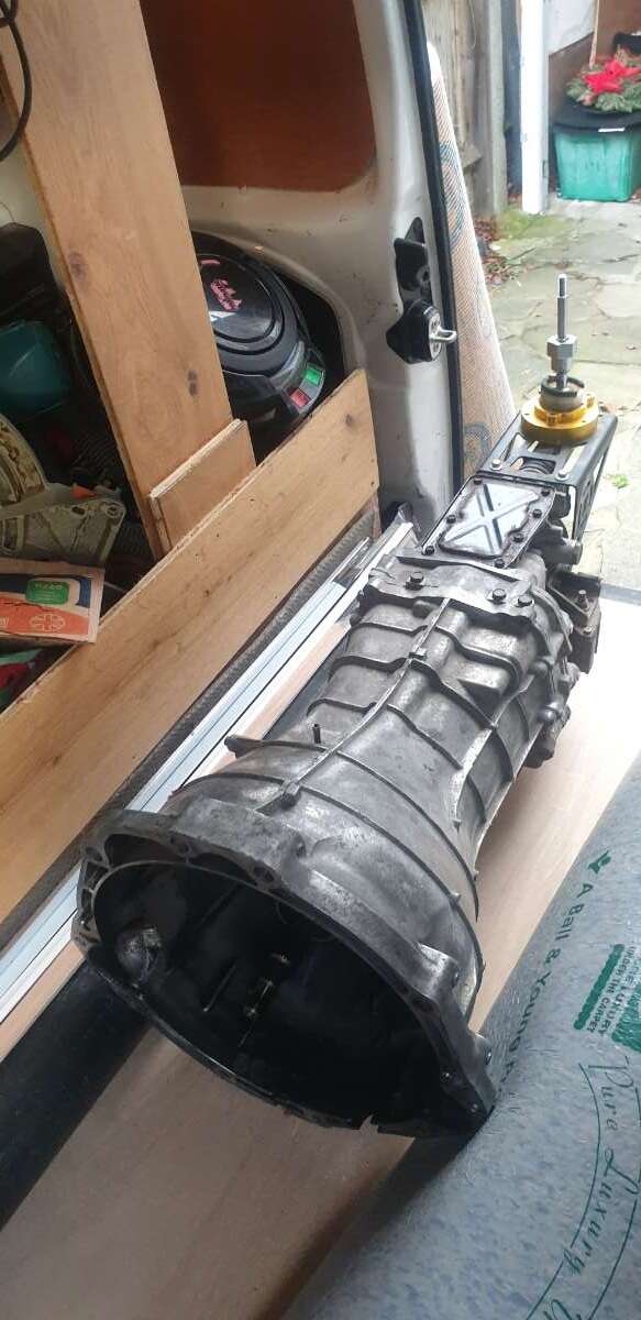

Nismoandy Posted March 27, 2024 Author Share Posted March 27, 2024 Correct again, I took the gearbox out, and down to my local specialist helicoil s,e, London. They were very good they found the selector was in two gears, so they replaced selector fork and some bearings and cleaned. The cost was very reasonable under £400. Quote Link to comment Share on other sites More sharing options...

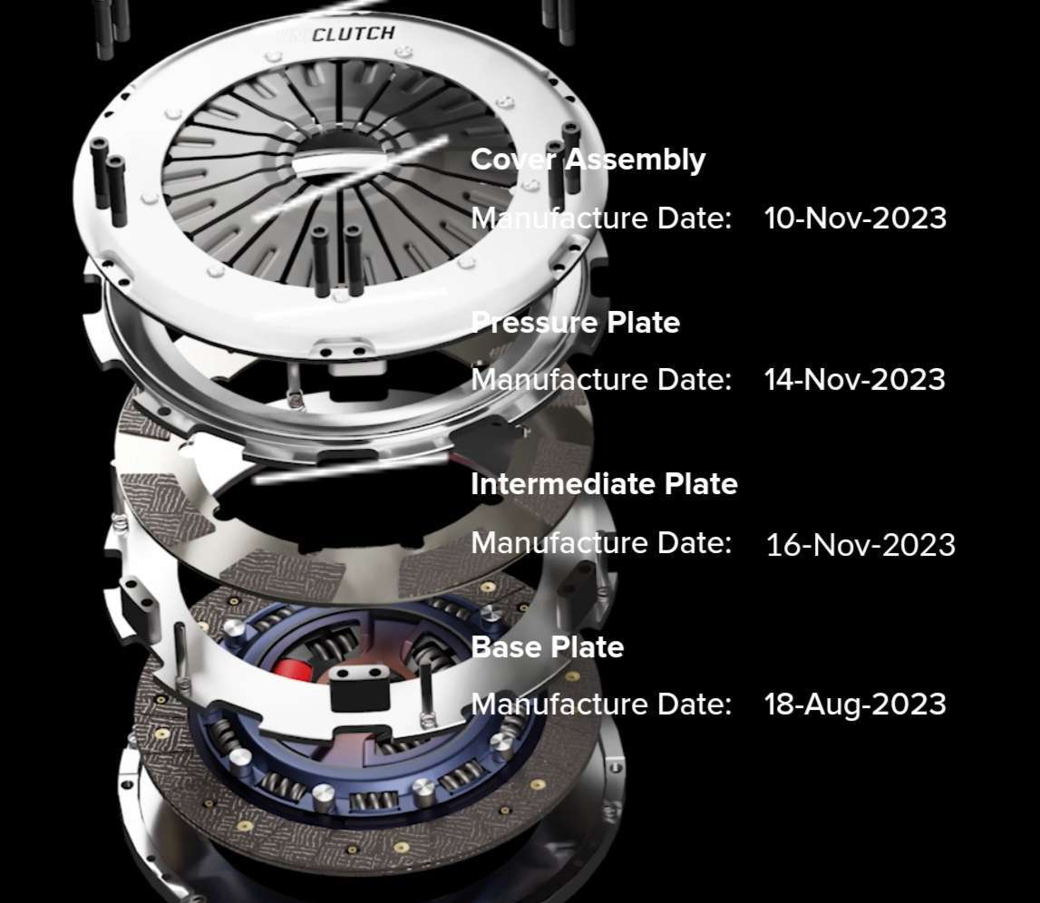

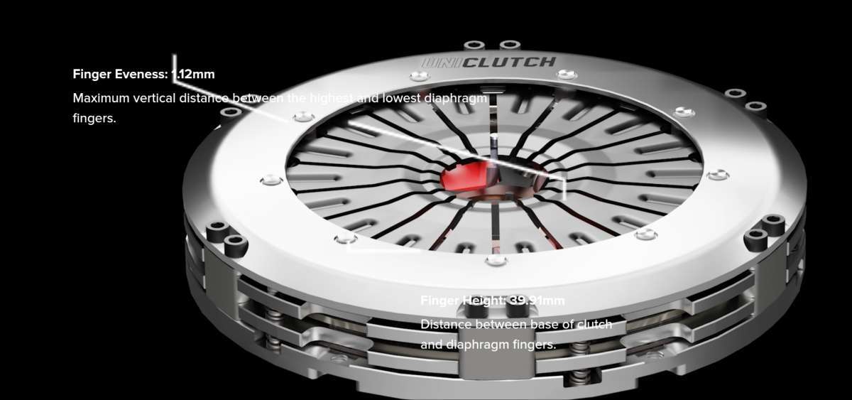

Nismoandy Posted March 27, 2024 Author Share Posted March 27, 2024 (edited) Time has passed with the car not being on the road, so I've done some investigation into a new clutch as the old one was a stiff sprung clutch and hardly any slip just on or off so not the most pleasant experience, so I'm going invest into a Uniclutch , these will fit both 350z and 370z they have a light pedal feel and a high capacity for torque , I'll pop a link so that you can see the difference between single and twin plate clutch plus other points Edited March 27, 2024 by Nismoandy 2 Quote Link to comment Share on other sites More sharing options...
Nismoandy Posted March 27, 2024 Author Share Posted March 27, 2024 Well save me going on about these clutches i recommend that you watch the video! Very interesting . Quote Link to comment Share on other sites More sharing options...
Nismoandy Posted April 4, 2024 Author Share Posted April 4, 2024 Well small update have installed the clutch new pilot and thrust bearing just struggling to get the gearbox back in 1 Quote Link to comment Share on other sites More sharing options...
