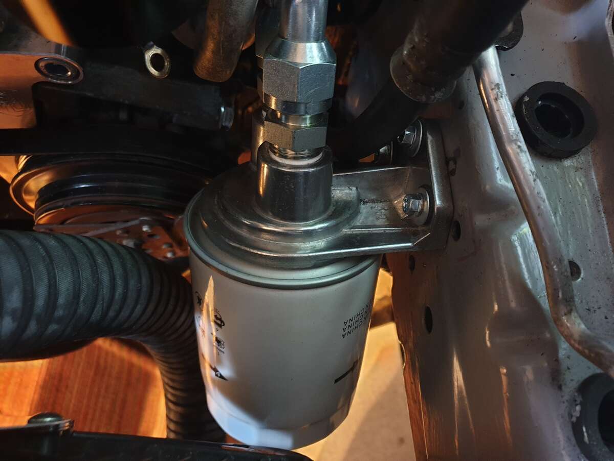

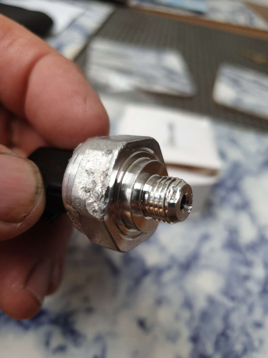

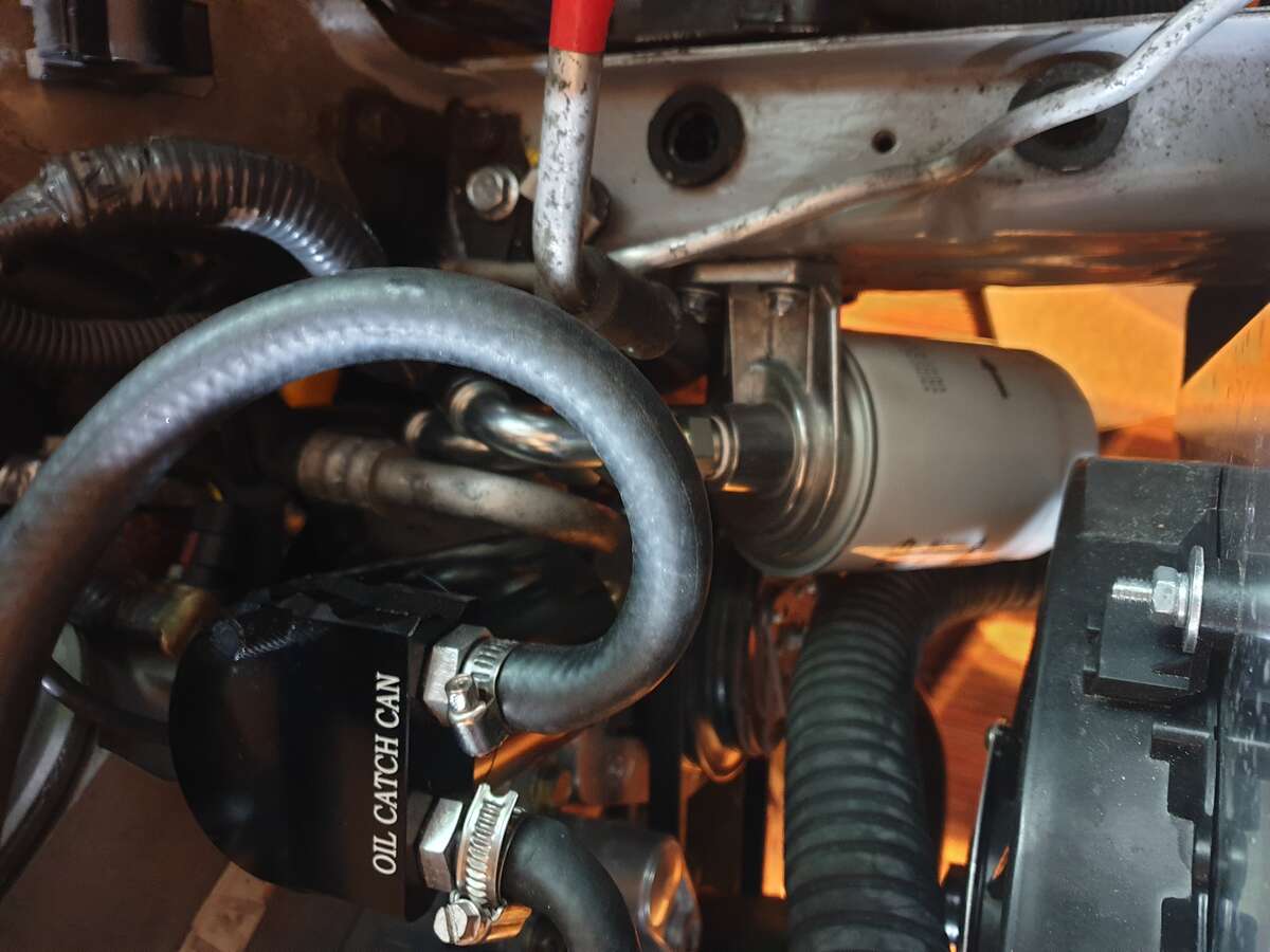

Nismoandy Posted January 1, 2021 Author Share Posted January 1, 2021 Hi everyone just getting a much welcome break after Christmas, and getting back to working on the 350z, we're I'm happiest. Just before I stopped on the billd before Christmas, I Had a problem with the oil pressure not registering on any instruments, So while I was working i tryed to figure out what it was, anyway it came down to either the oil pressure sensor or the oil relocation kit, so instead of doing one and then the other because we all know whatever we do first it's always the other part that requires replacing so I just done both, and I'm pleased to say that it has solved this problem . There's a couple more things but nothing serious 3 Quote Link to comment Share on other sites More sharing options...
Nismoandy Posted January 1, 2021 Author Share Posted January 1, 2021 (edited) The oil pressure sensor above was replaced with ome part. https://youtu.be/m8_H3hIKFSI Edited January 2, 2021 by Nismoandy 1 Quote Link to comment Share on other sites More sharing options...

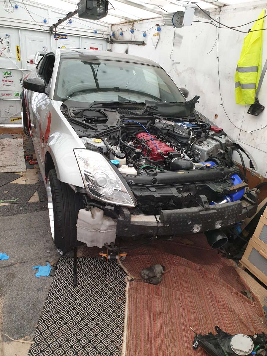

Nismoandy Posted January 3, 2021 Author Share Posted January 3, 2021 I'm on a roll at the moment so wanted to check the car outside the garage to get a better idea of what is okay and what is going to need to alter before I get it to the m.o.t. center and back on the road. So had to finish off loads of bits and pieces plus tidy up the garage, before we got it out the noise when I am turning the steering wheel is the power steering pump needs bleeding 4 Quote Link to comment Share on other sites More sharing options...
Nismoandy Posted January 3, 2021 Author Share Posted January 3, 2021 So the conclusion is that the exhaust is too low needs alterations to bring it up off the ground power steering fluid needs bleeding and other small bits Quote Link to comment Share on other sites More sharing options...

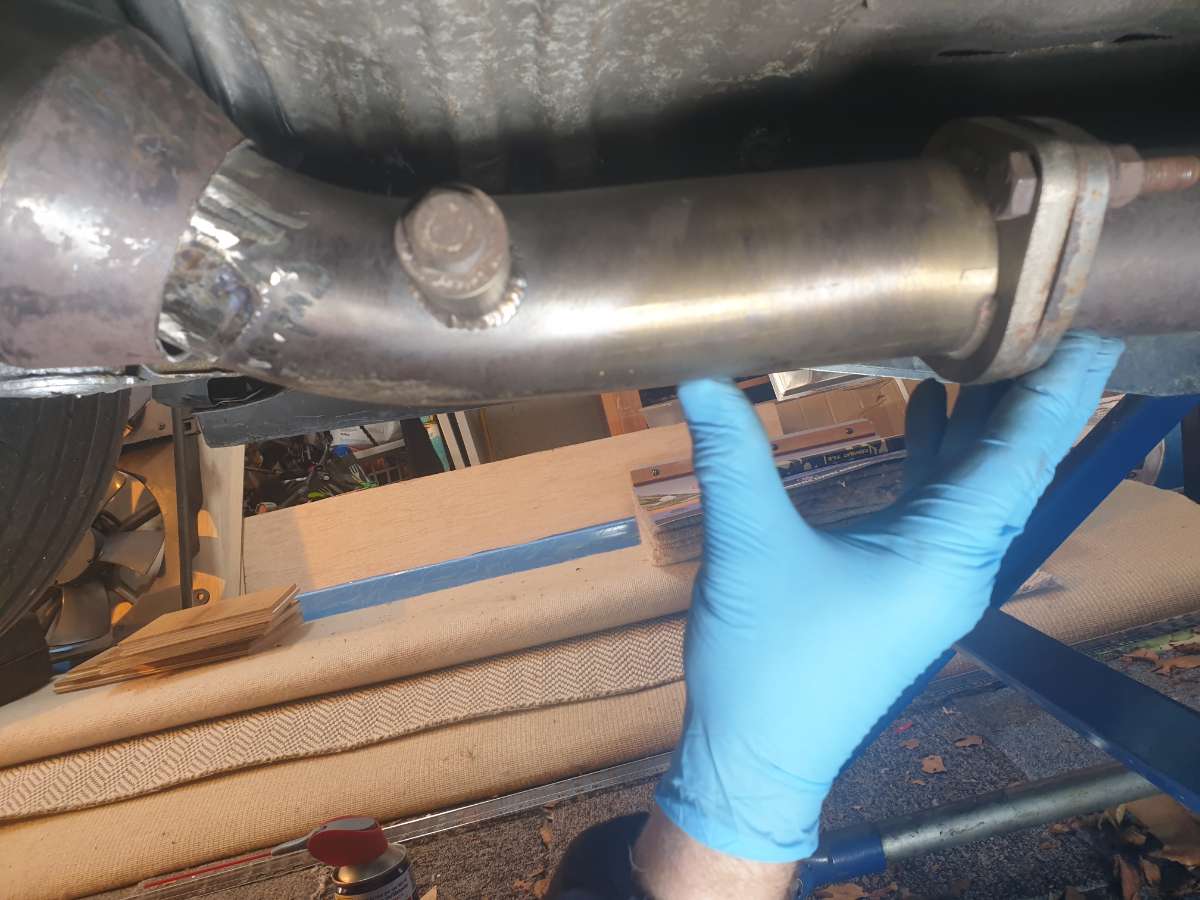

Nismoandy Posted February 13, 2021 Author Share Posted February 13, 2021 (edited) Small update it been cold outside in the garage so us southern softy are rubbish with the cold , but I have rehashed the cats to lift the exhaust off the floor. I have ordered up and received the loj fuel pump and pressure regulator Edited February 13, 2021 by Nismoandy Quote Link to comment Share on other sites More sharing options...

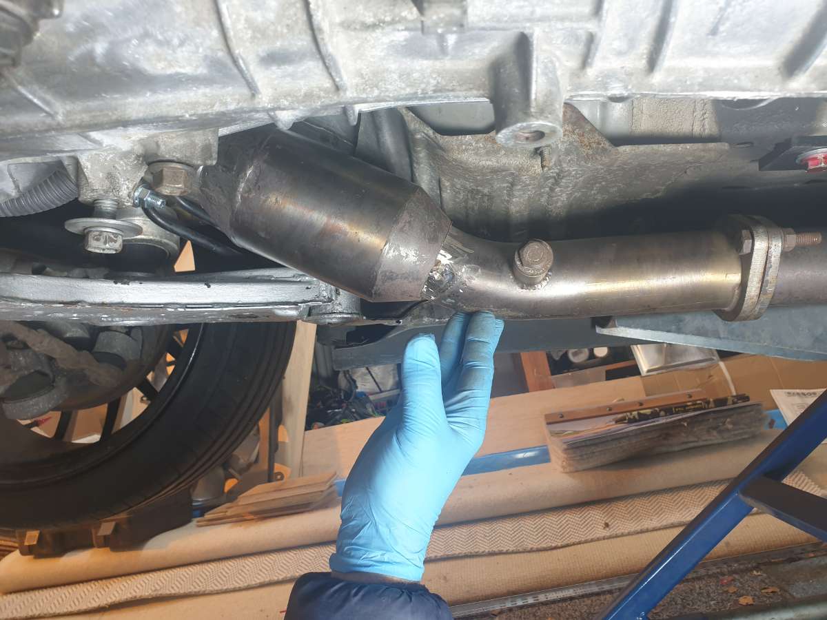

Nismoandy Posted February 13, 2021 Author Share Posted February 13, 2021 Above you can see that the exhaust is too low photo below that I disconnected the y pipe from the front part and you can notice that it is lower Quote Link to comment Share on other sites More sharing options...
Nismoandy Posted February 13, 2021 Author Share Posted February 13, 2021 So I've taken the cats apart at the seems made up a new end with 2.5 pipe on it and slid the cats over the top bolt both ends back on ,then tack welded up so as to get the correct positions for both cats 2 Quote Link to comment Share on other sites More sharing options...
