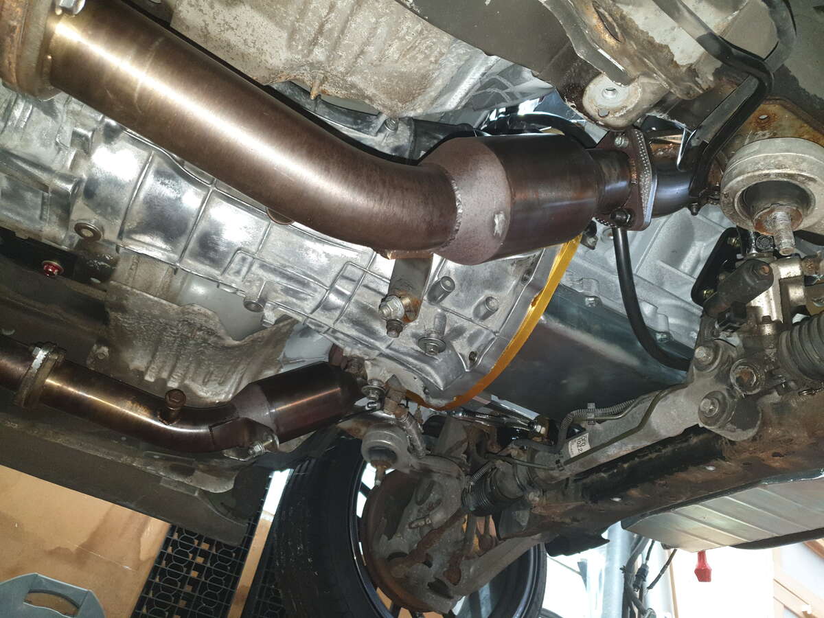

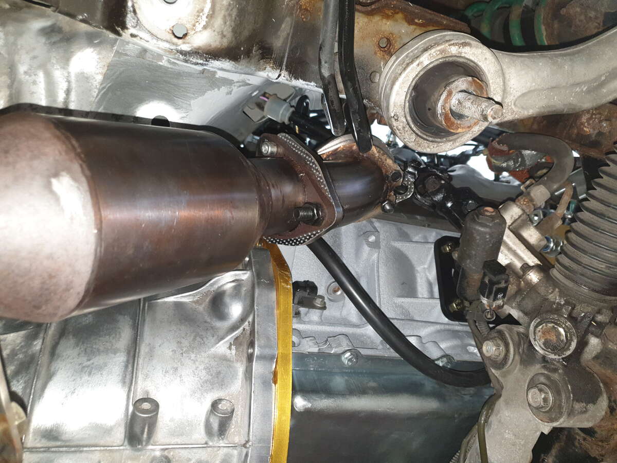

Nismoandy Posted August 15, 2020 Author Share Posted August 15, 2020 Finally finished off with the exhaust front to back with. Most of the wiring is in waiting for a few sensors then a start up !!!!!! Then check for all oil leaking etc 4 Quote Link to comment Share on other sites More sharing options...

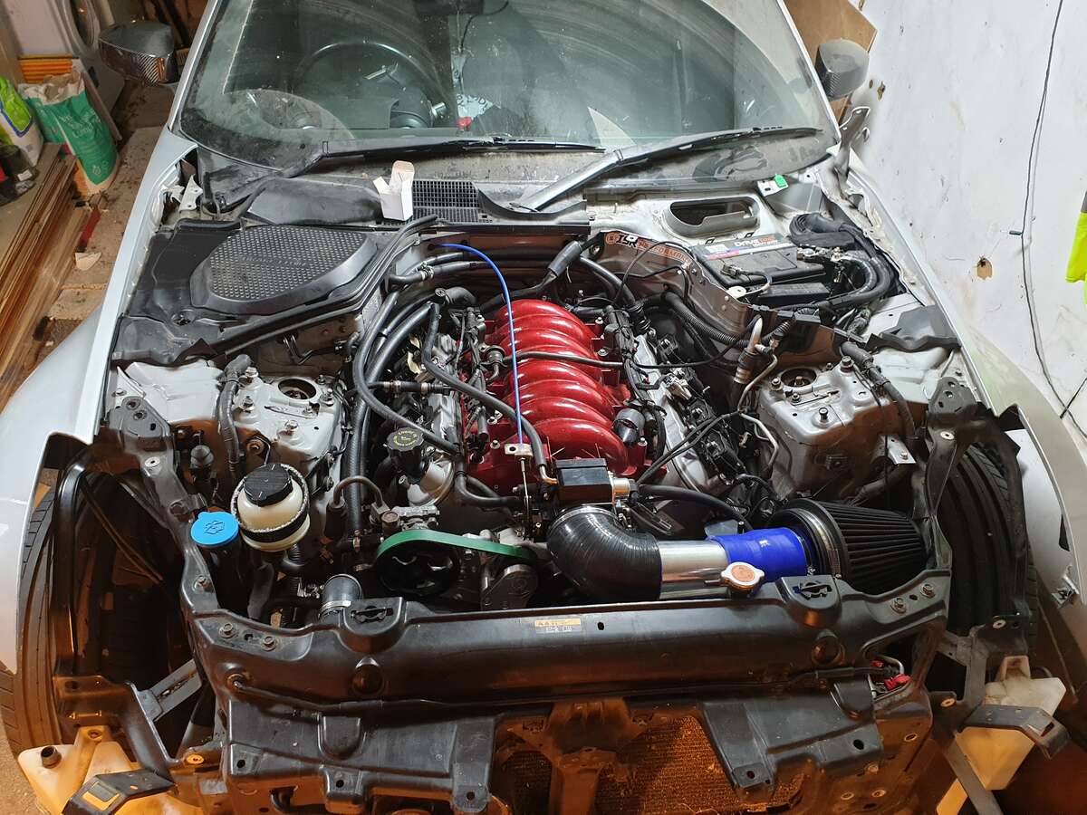

Nismoandy Posted August 20, 2020 Author Share Posted August 20, 2020 (edited) Hi everyone everyone finally finished off the wiring and check systems oil in and ,power steering fluid installed. We're going to try a short start up to see if it will run . The 1st time that we put power into the system the starter motor was permanently engaged so quickly sorted starter motor to make sure it worked correctly . OK . So we turned it over and nothing just a strong smell of petrol anyway took one of the spark plugs out and checked to see if we've got a spark yes OK so checked over the engine again to see if I've missed anything the only thing that is not working at the moment is the MAF , and air intake temperature sensor. So back to the drawing board and head scratching so had a cuppa tea with a shortbread biscuits , tried the car again and came to the conclusion that we probably had a mixture of old fuel condensation build up and flooding the engine. A few minutes later Hurray successfully managed to fire up with a little help from a friend . Video to see what happened Edited August 22, 2020 by Nismoandy update Quote Link to comment Share on other sites More sharing options...

Nismoandy Posted August 20, 2020 Author Share Posted August 20, 2020 Kept checking for faults and leaks etc 3 Quote Link to comment Share on other sites More sharing options...
Nismoandy Posted August 20, 2020 Author Share Posted August 20, 2020 At the end of the evening success was sweet and the engine is very healthy but still more work before it's back on the road 7 Quote Link to comment Share on other sites More sharing options...

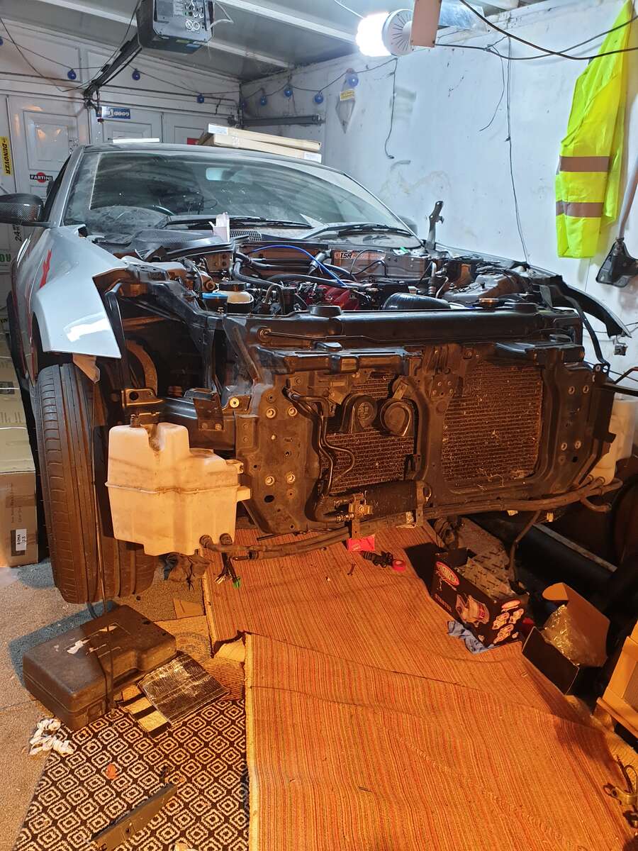

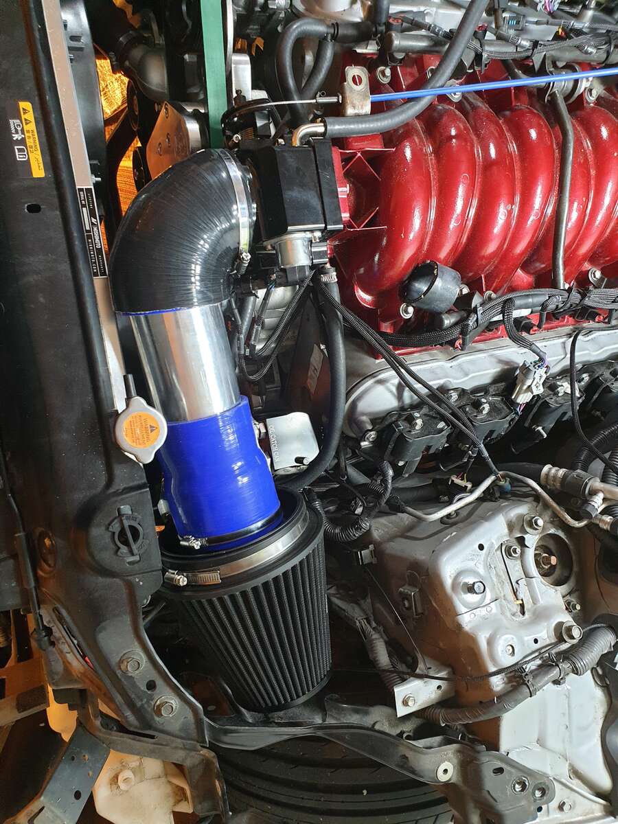

Nismoandy Posted August 26, 2020 Author Share Posted August 26, 2020 (edited) Bit more progress coming together now and the engine bay is looking tight. I have changed the stock fans to Mishimoto it also helps with extra cooling and clearance, for the air intake i probably will change the size of the intake and colour of the pipes? Not sure yet I'm just concentrating on getting this up and running still waiting for a few parts but not many Did have a play with the running and seems to be working nicely Edited August 27, 2020 by Nismoandy update 1 Quote Link to comment Share on other sites More sharing options...

itsLeon Posted August 31, 2020 Share Posted August 31, 2020 On 27/08/2020 at 01:12, Nismoandy said: Bit more progress coming together now and the engine bay is looking tight. I have changed the stock fans to Mishimoto it also helps with extra cooling and clearance, for the air intake i probably will change the size of the intake and colour of the pipes? Not sure yet I'm just concentrating on getting this up and running still waiting for a few parts but not many Did have a play with the running and seems to be working nicely If you ever get heating problems, change the mishimoto fans back to OEM (if its fits) because my experience with them is that the OEM perform better. 1 Quote Link to comment Share on other sites More sharing options...

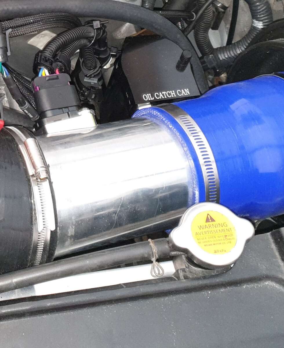

Nismoandy Posted September 5, 2020 Author Share Posted September 5, 2020 (edited) Hi everyone small update have managed to finish off the MAF sensor and the intake air temperature sensor which has been installed into the aluminium intake Also I have installed a cold air intake for the 350z this can be used for any 350z there's a video on the next page showing how! Edited September 5, 2020 by Nismoandy update 2 Quote Link to comment Share on other sites More sharing options...
