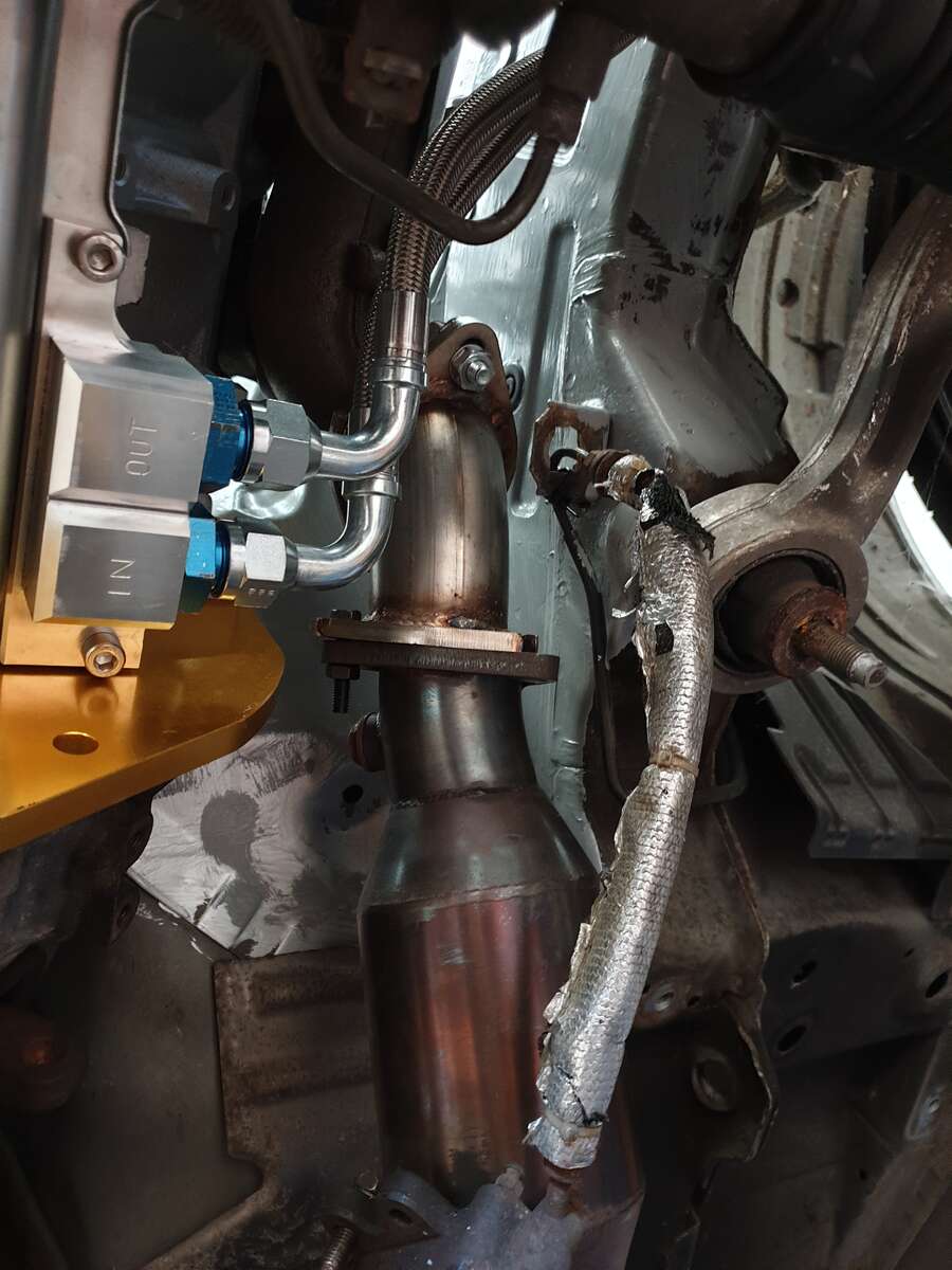

andy james Posted June 12, 2020 Share Posted June 12, 2020 Very nice. Loving that alloy bracket. 1 Quote Link to comment Share on other sites More sharing options...
Nismoandy Posted June 12, 2020 Author Share Posted June 12, 2020 Hi Andy me to ,but mostly it will make the installation a bit easier as i can reuse the power steering and air conditioning line's from the car which is a big bonus Quote Link to comment Share on other sites More sharing options...

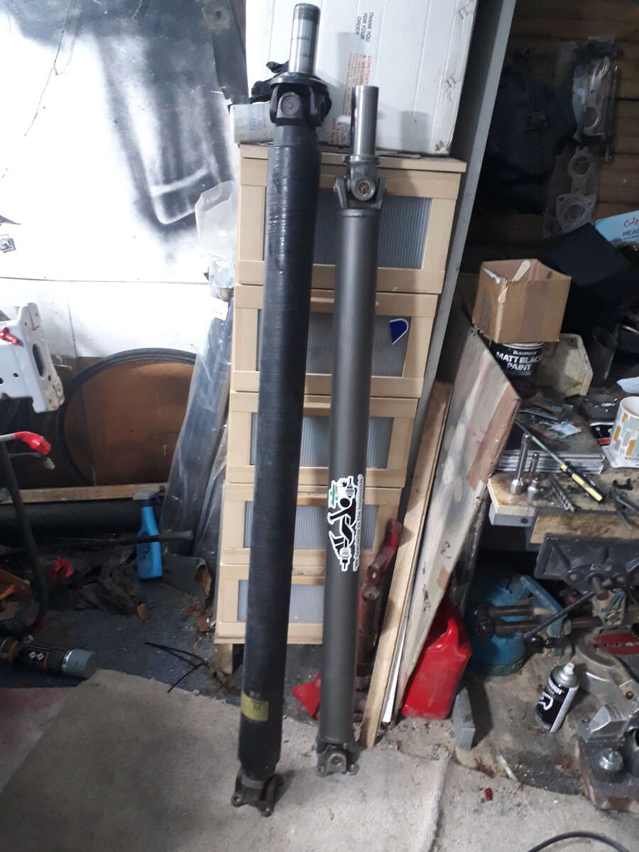

Nismoandy Posted June 17, 2020 Author Share Posted June 17, 2020 (edited) Quite a lot of the mechanical side of the build has been done. The prop shaft is going to be installed just a photo to show the difference in length of the the original 350z carbon fibre to the new shorter prop shaft. I have purchased water pipes and vacuum lines ,and intend to get them install in around two weeks time but first I will be tackling the wiring, with some help as I hate wiring Edited June 17, 2020 by Nismoandy 3 Quote Link to comment Share on other sites More sharing options...

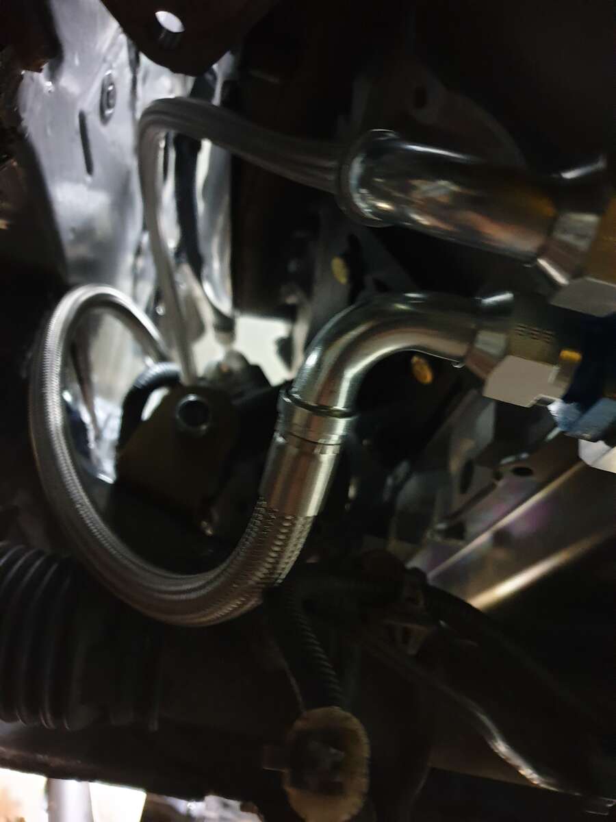

Nismoandy Posted June 18, 2020 Author Share Posted June 18, 2020 (edited) On 18/06/2020 at 04:40, KuroKiddo said: Good job so far! Are you running the Wiring Specialities loom? Also what are you doing for the exhaust manifolds? So the wiring, is a stand-alone, so the ecu and engine wiring is completely separate to the ECU in 350z, lighs etc so yes Wiring Specialities loom ,quite amazing stuff to be honest I will try to explain when once we have some progress on the wiring but I'm no expert. Ps. (I'm expect the dashboard to light up like a Christmas tree)who said wiring wasn't fun. The exhaust manifold and starter motor and steering rack which is positioned on the driver side has been a challenge as there is not much room for clearance on all three items to work properly without interfering with each other it would have been better if the starter motor had been positioned on the passenger side but the kit does not allow for this. I have managed to find and enough room for this to work without interferences with each other. I will try me best to put some photos to show when I have finished install. Edited September 7, 2020 by Nismoandy Info Quote Link to comment Share on other sites More sharing options...

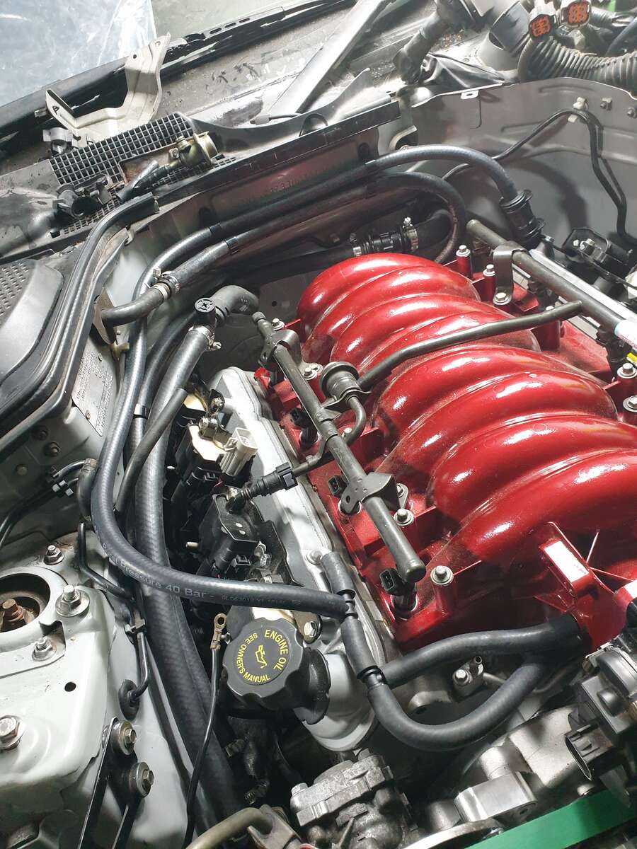

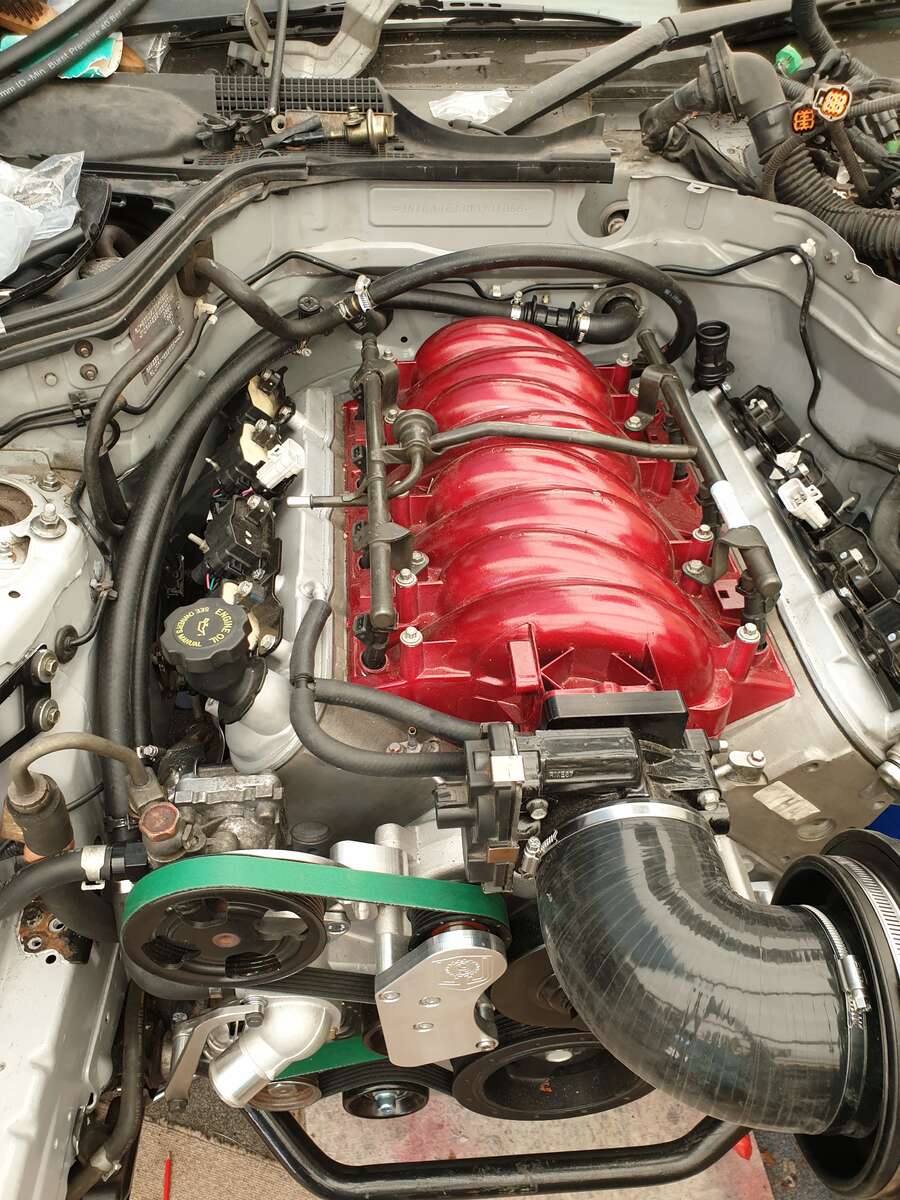

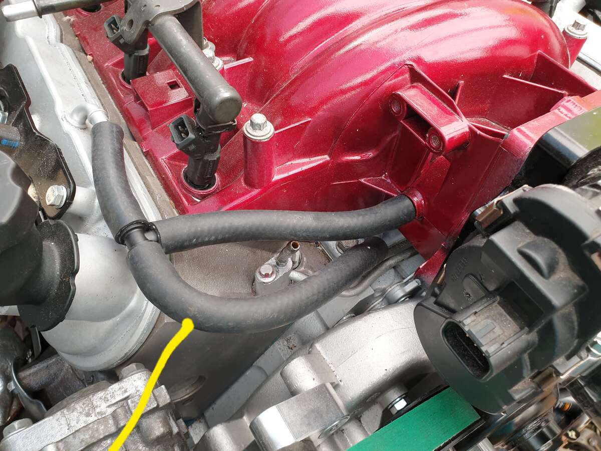

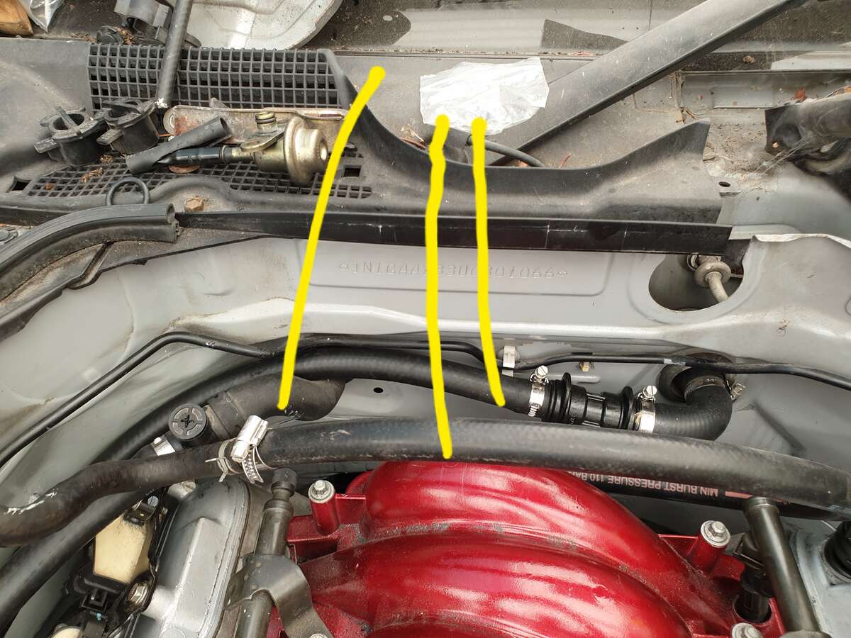

Nismoandy Posted June 26, 2020 Author Share Posted June 26, 2020 (edited) Small update the vacuum pipes and water pipes installed and just waiting on a few more parts to carry on Edited June 26, 2020 by Nismoandy 3 Quote Link to comment Share on other sites More sharing options...

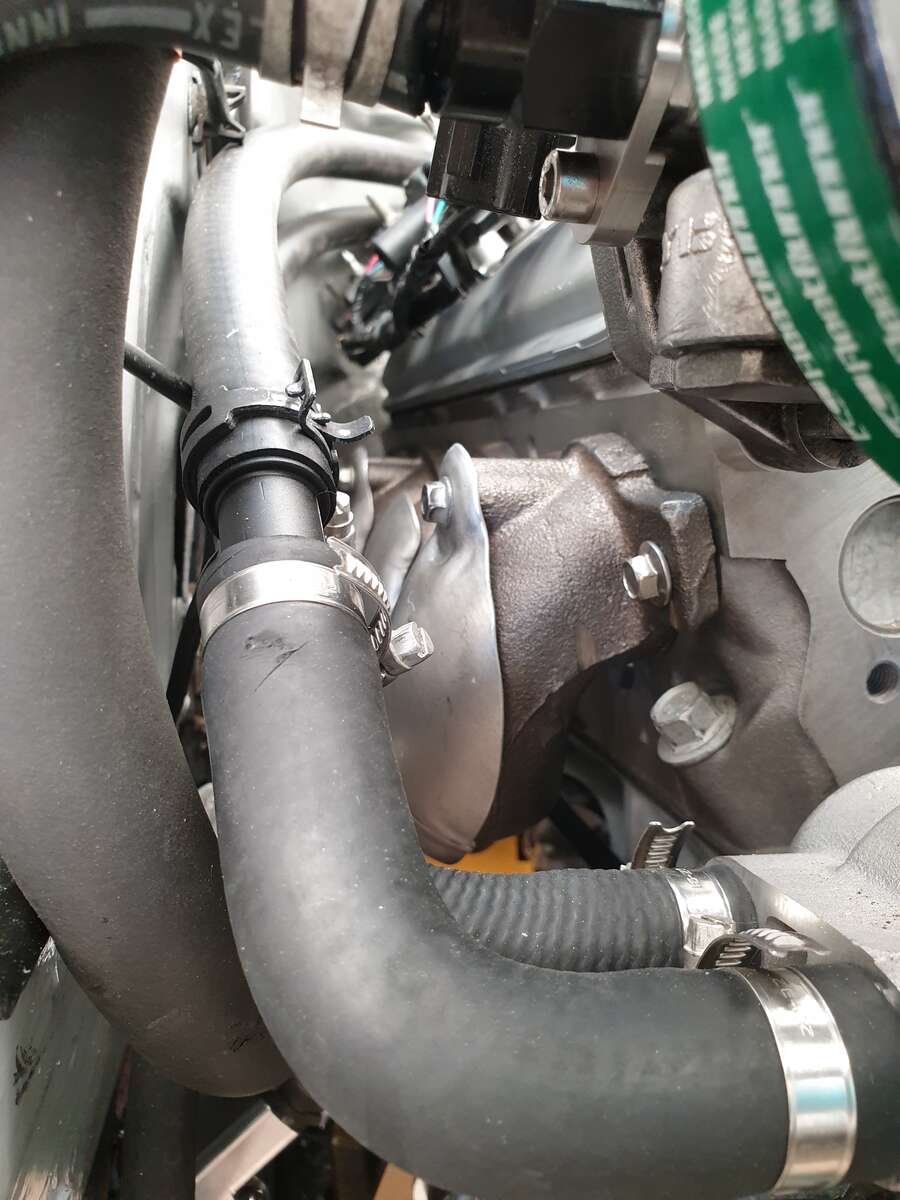

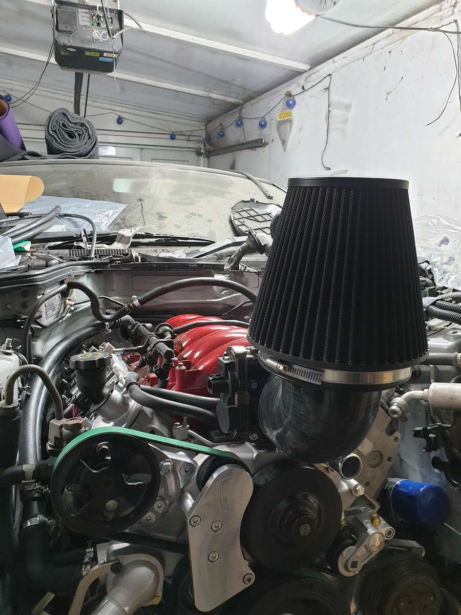

Nismoandy Posted June 29, 2020 Author Share Posted June 29, 2020 Been tidying up the pipe runs and in some places secured them , so as they can not to rub on anything that might damage them . Also I was mucking with the air filter . 3 Quote Link to comment Share on other sites More sharing options...

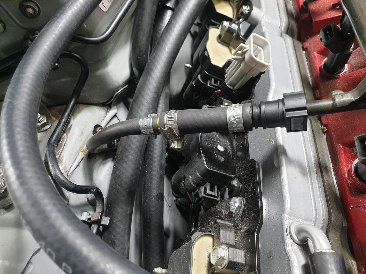

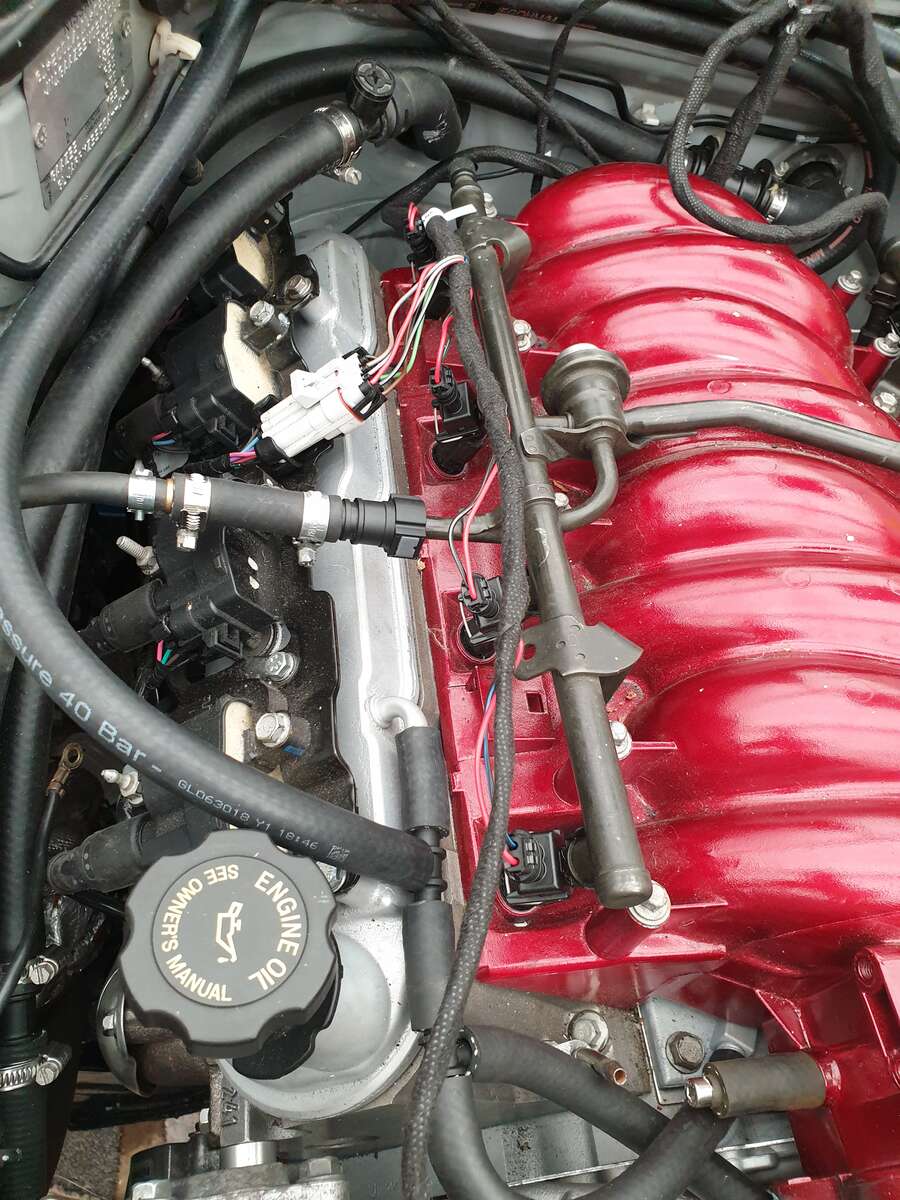

Nismoandy Posted July 2, 2020 Author Share Posted July 2, 2020 (edited) Installed the oil filter relocation kit from sikky . Also Connected the fuel pipe to Ls fuel rail, Surprisingly, a standard Nissan click on fuel connection works Edited July 2, 2020 by Nismoandy 5 Quote Link to comment Share on other sites More sharing options...

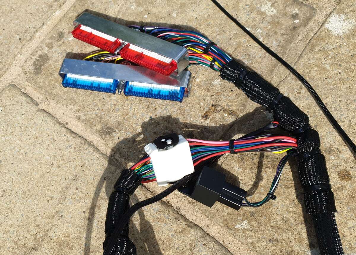

Nismoandy Posted July 4, 2020 Author Share Posted July 4, 2020 (edited) Onto the next stage now with the wiring , this is stage where there's not a lot to show you but here's a couple of photos to give you a rough idea and it will take a while to complete so I probably won't post for couple of weeks ( just a note to everyone this part of the wiring loom has now been updated with a different version from wiring specialists) Edited January 9, 2023 by Nismoandy update 3 Quote Link to comment Share on other sites More sharing options...

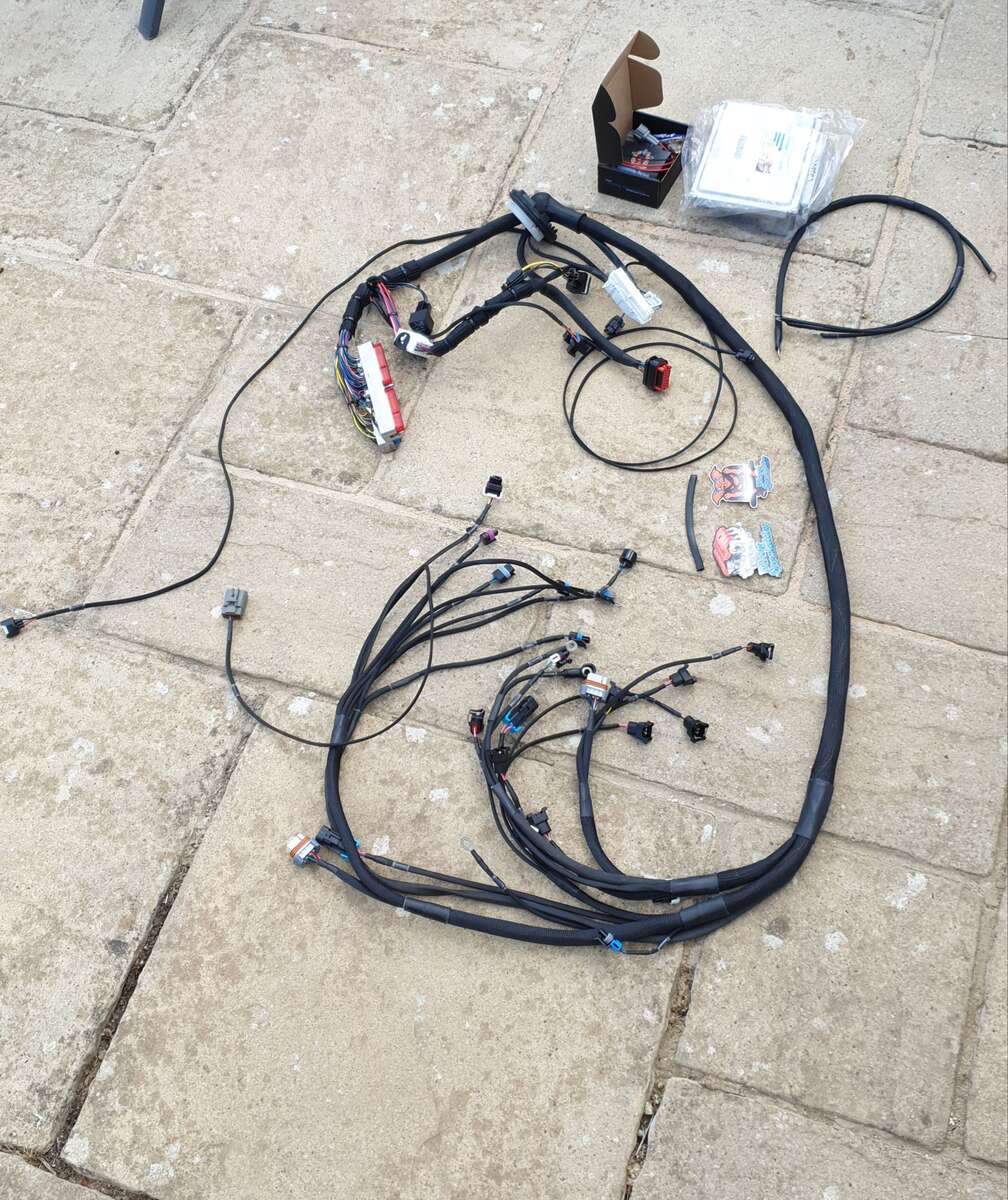

Nismoandy Posted August 4, 2020 Author Share Posted August 4, 2020 Had Some good news today . The wiring has turned up So cracking on with the build Very pleased with the quality of the wiring loom 3 Quote Link to comment Share on other sites More sharing options...
