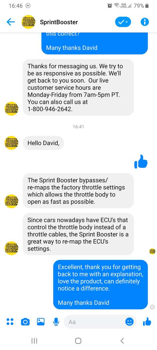

Dave6188 Posted January 10, 2020 Share Posted January 10, 2020 In the first three gears on these cars the butterflies on the throttle bodies are limited to how fast they open even at full throttle they are restricted which is what gets removed when the car gets mapped. Throttle controller also gets rid of the same restriction in the first three gears so you get full power as apposed to progressive power waiting for the butterflies to open. PM Sprintbooster on Facebook, they were happy to explain it all to me. Quote Link to comment Share on other sites More sharing options...
coldel Posted January 10, 2020 Share Posted January 10, 2020 (edited) It would be interesting to see what they said - could you just copy and paste what they told you here? Edited January 10, 2020 by coldel Quote Link to comment Share on other sites More sharing options...
coldel Posted January 10, 2020 Share Posted January 10, 2020 Reading back what you said Dave, it is exactly what I said. That in the lower gears the standard throttle input is lazy, but thats deliberate as most likely 99% of the time you will be in traffic in and around town so you dont want the car being very jumpy in lower gears. Makes sense really. All the sprint booster does, iike the blitz / D1 Spec etc boxes that came before it is compress the inputs going into the ECU so that laziness in effect feels like it goes away as the signal going to the ECU is higher than it would otherwise be. As I understand it (and again happy to be told otherwise there are much smarter people on here), there is a misconception about the 'lower gear' thing on 350z's. You can get 100% power in lower gears without a box, you simply put your foot to the floor and the throttle will be fully open. The shape of the input curves from the pedal to the ECU are like an exponential curve whereas the throttle controllers make them much steeper in terms of getting to 100% - what isn't true is that these boxes open up extra power in lower gears. We should really be asking the likes of Horsham Dev on here, pretty sure they could clarify rather than an amatuer like me! Quote Link to comment Share on other sites More sharing options...
Dave6188 Posted January 10, 2020 Share Posted January 10, 2020 (edited) 7 hours ago, coldel said: It would be interesting to see what they said - could you just copy and paste what they told y There you go, proof enough? My car is auto and it has been tuned, I turned the Sprintbooster off when it was getting tuned so it wouldn't effect anything, came out and the car felt great but the box felt lazy still, turned the Sprintbooster back on and the box responsiveness is just ridiculous on the Sprintboosters auto setting, that coupled with the tune and it seriously sharpens up the car. Imagine doing roll or dig races and having a setting that can give 100% throttle at the first tiny touch of the pedal, gives you a split second advantage that makes a difference. On track you want control so switch it off. Daily driving mine is set mid way and it's a pleasure to drive, I daily my car in traffic, no jumpyness and Z feels lazy otherwise. I've taken it to a garage for work and even though my car has valet mode mapped in I still set the Sprintbooster up to restrict the throttle to 55% so it doesn't get abused. At night I set the 3 digit code on it to pedal lock the vehicle so if it gets broken into you get no power from the throttle whatsoever. Cost me £120 off this forum. No brainer in my opinion even if it's just for the security of your car. Edited January 10, 2020 by Dave6188 Quote Link to comment Share on other sites More sharing options...
coldel Posted January 10, 2020 Share Posted January 10, 2020 (edited) Thanks Dave, yes it does confirm it does what I said, it basically brings forwards the throttle position that goes into the ECU. So when you turn it on and you put your foot in say 30% of the way instead of the throttle signal saying 'give 20% throttle' to the ecu its saying 'give 50%' hence the responsiveness feel of the throttle. Actually Ekona's 'thin soled shoes' comment is very relevant here, as the Sprint Booster just brings forwards the throttle signal, if you have good throttle control you can do exactly the same thing by pushing the throttle say 70% of the way down which would also give you 50% - you are getting exactly the same power and acceleration but in an easier to manage way. If you want 100% throttle in lower gears, you can get it without this box, you just make sure the pedal is pretty much to the floor - with this box it brings it forwards and spread the curve so its easier to control if you want to be really putting the hammer down - but I stand by my comment, you can do all of what they claim without the box by just putting your foot in more. The security aspect is a nice touch I will give them that, a potential thief that has gotten past the alarm and immoboliser might not check under the pedal for this box (I presume to disable it you just unplug it) and if the control box is hidden from view they wont check to where it leads to. Edited January 10, 2020 by coldel Quote Link to comment Share on other sites More sharing options...
Dave6188 Posted January 10, 2020 Share Posted January 10, 2020 You still don't quite get it. Your half and half right and I've lost the will to try and explain lol. Don't take offense to this. Quote Link to comment Share on other sites More sharing options...
Ekona Posted January 11, 2020 Share Posted January 11, 2020 Col does get it, his explanation is spot on. Throttle controllers are actually very simple devices, which is a good thing. Quote Link to comment Share on other sites More sharing options...
coldel Posted January 11, 2020 Share Posted January 11, 2020 (edited) 17 hours ago, Dave6188 said: You still don't quite get it. Your half and half right and I've lost the will to try and explain lol. Don't take offense to this. Not offended, but nothing that guy from SB said is any different to what I said, it just changes the throttle signal. I guess its that thinking they do anything more than what I have observed so far is actually misleading to anyone buying one of these devices (be it D1 Spec, Blitz, SB etc). They change the throttle signal to the ECU, nothing more. Sprint Booster has a few additions to the others i.e. security, but in terms of its core function, its the same as what came before. When I put mine on years ago, it was a bit like a woah factor, but then you realise all its done has moved where 80%-100% throttle is on the pedal travel further up, no performance gain to be had. To be honest, if anyone is considering throwing £200 at a device like this I would save a bit more money and go into remap territory which accesses a dozen or so data tables in the ECU and does proper adjustments to create a faster, more responsive drive, removes flat spots etc. Edited January 11, 2020 by coldel Quote Link to comment Share on other sites More sharing options...
