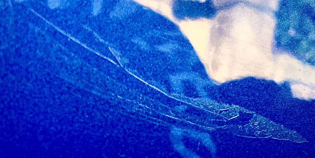

Stutopia Posted January 3, 2020 Share Posted January 3, 2020 Doing a big winter detail and came across this. I had to mess about with the image a bit to show it but it’s a pretty fair reflection of what it looked like. It was on the bottom 3 inches of the passenger door, about half way down. Around 8 inches long, running from front to back. It looked like the residue from a sticker or decal, but I’ve never had one there. It had no discernible different “feel” from the surrounding area, when running my fingers over it (that is to say it felt smooth like the paint). Neither neat APC nor a BH auto clay bar touched it. In the end I broke out the Rupes and shifted it with a yellow pad and fine polish. Anyone seen anything like this before? Quote Link to comment Share on other sites More sharing options...
G1en Posted January 4, 2020 Share Posted January 4, 2020 Complete guess but could possibly be something like brake fluid or fuel thats splashed up from the wheel and sat there for a while so eaten slightly into the clearcoat? when i spilt a little brake fluid onto barrel of an alloy wheel and left it i was suprised how it went through the gtechniq C5 applied and made a similar thing to your pic. Quote Link to comment Share on other sites More sharing options...
Stutopia Posted January 4, 2020 Author Share Posted January 4, 2020 Decent shout that Glen, could be a goopy sort of spill. Quote Link to comment Share on other sites More sharing options...
ilogikal1 Posted January 4, 2020 Share Posted January 4, 2020 If you couldn't feel it, it looks like liquid etching in, and trapped moisture under, the clear coat to me - likely caused by something acidic splashing up the door and sitting for a bit. My suggestion would have been a light polish and report back, but you've beaten me to that already. Quote Link to comment Share on other sites More sharing options...
Stutopia Posted January 4, 2020 Author Share Posted January 4, 2020 1 hour ago, ilogikal1 said: If you couldn't feel it, it looks like liquid etching in, and trapped moisture under, the clear coat to me - likely caused by something acidic splashing up the door and sitting for a bit. My suggestion would have been a light polish and report back, but you've beaten me to that already. I treated myself to a Rupes LHR 75E Mini not so long along ago, but haven't had the combination of good weather and free time required to do the whole car. Naturally I've been itching to have a play with it, so this seemed like an opportune moment to have a bash. There was no way it was going to make it look any worse!!! Quote Link to comment Share on other sites More sharing options...
