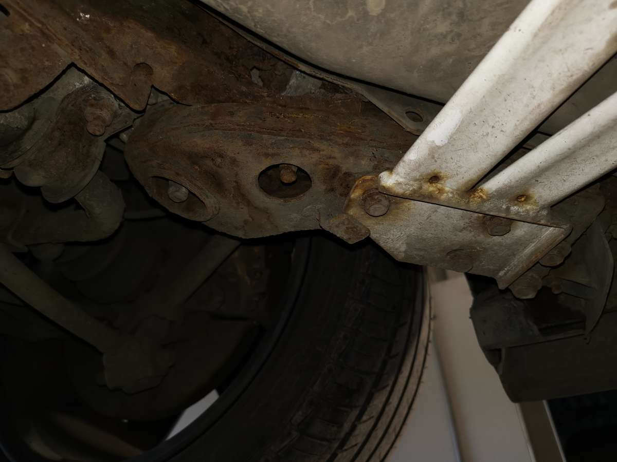

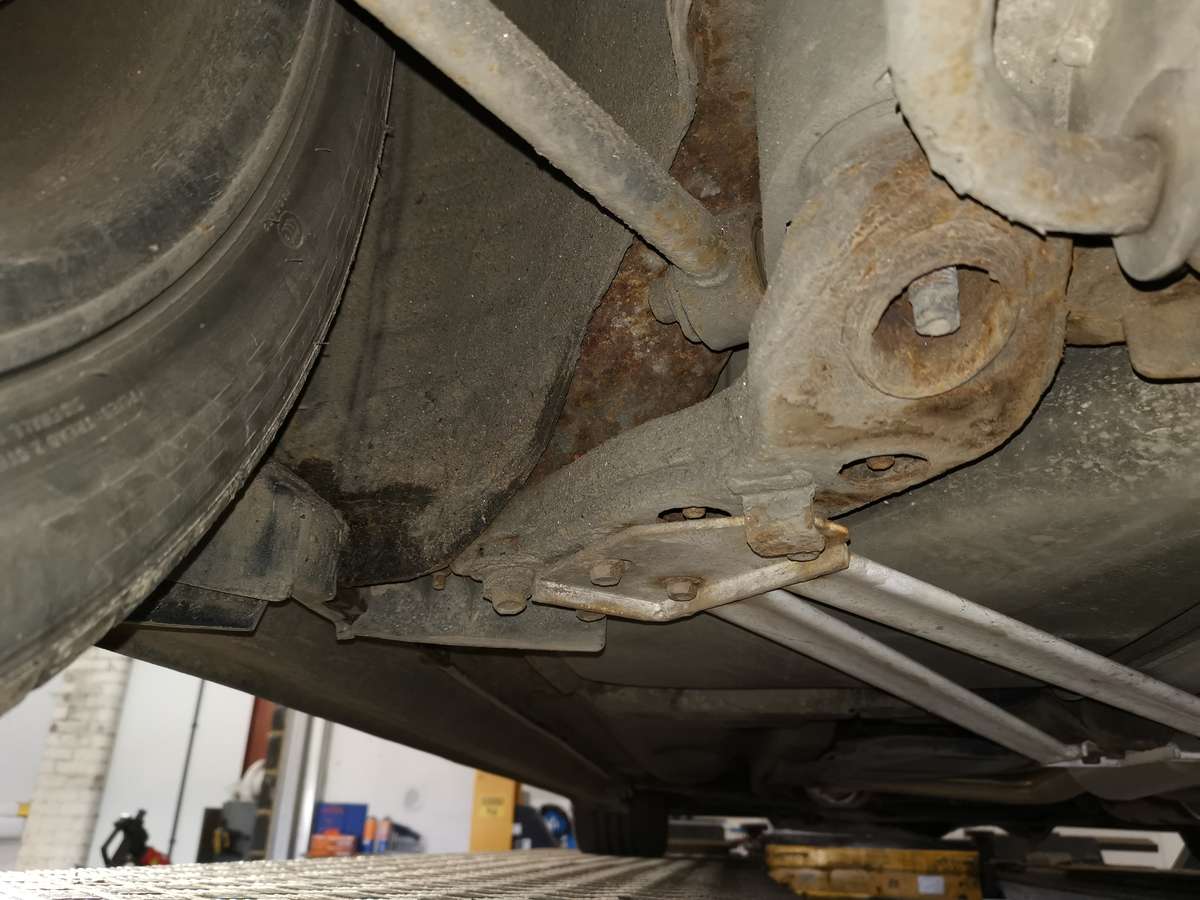

veeg33 Posted December 9, 2019 Share Posted December 9, 2019 (edited) Just failed MOT this morning, this parts needs fixing or replacing. Anyone had similar problems and how do you sort it out? Was it a big job (sub-frame out, exhaust out, etc) or something as simple as replace the part (without removing other parts) ? Passenger side has corroded, driver side still OK but if they can be replaced, I think both needs replacing at the same time. @ZMANALEXdo you have parts if it can be replaced? Edited December 9, 2019 by veeg33 Quote Link to comment Share on other sites More sharing options...

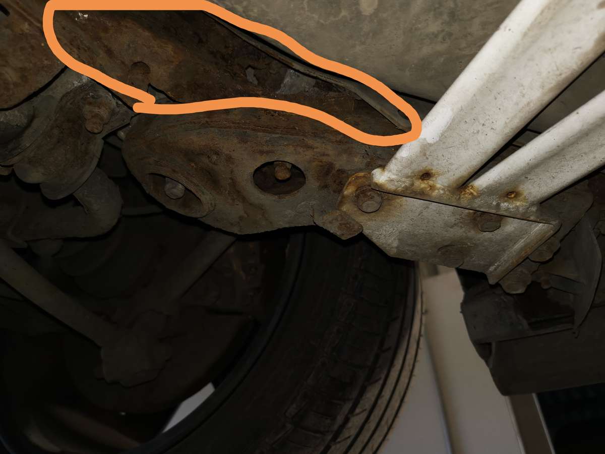

veeg33 Posted December 9, 2019 Author Share Posted December 9, 2019 Pic highlighting what has corroded Quote Link to comment Share on other sites More sharing options...
veeg33 Posted December 9, 2019 Author Share Posted December 9, 2019 (edited) Having done some google search, looks like that's a kidney braces? and the part i need to replace is the one above is board assembly - rear floor? Would be great if you guys can confirm how easy it is to replace these 2 items? I have access to tools and ramp to replace the if they are easy enough? Probably the toughest will be the rusty bolts and nuts. Edited December 9, 2019 by veeg33 Quote Link to comment Share on other sites More sharing options...
ZMANALEX Posted December 9, 2019 Share Posted December 9, 2019 All parts are in stock and good to go same/next day. If the kidney brackets are corroded then they will have to be replaced, however from your image it appears to be the panel that runs behind the petrol tank that is corroded and if that is the case, just remove it as it serves very little purpose. IMHO, this panel should not be an MOT failure as it is not structural However I have the panels in stock if you wish to replace. Kidney brackets are also in stock. Alex Quote Link to comment Share on other sites More sharing options...
veeg33 Posted December 9, 2019 Author Share Posted December 9, 2019 24 minutes ago, ZMANALEX said: All parts are in stock and good to go same/next day. If the kidney brackets are corroded then they will have to be replaced, however from your image it appears to be the panel that runs behind the petrol tank that is corroded and if that is the case, just remove it as it serves very little purpose. IMHO, this panel should not be an MOT failure as it is not structural However I have the panels in stock if you wish to replace. Kidney brackets are also in stock. Alex Many thanks Alex. I'll see if I can talk him to accept this is not structural and can be removed without replacing. Quote Link to comment Share on other sites More sharing options...
ZMANALEX Posted December 9, 2019 Share Posted December 9, 2019 33 minutes ago, veeg33 said: Many thanks Alex. I'll see if I can talk him to accept this is not structural and can be removed without replacing. If he plays hard ball, just remove the rusted panel and go to another testing station. 1 Quote Link to comment Share on other sites More sharing options...
veeg33 Posted December 9, 2019 Author Share Posted December 9, 2019 2 hours ago, ZMANALEX said: If he plays hard ball, just remove the rusted panel and go to another testing station. Garage has accepted this and gave a pass. 1 Quote Link to comment Share on other sites More sharing options...
