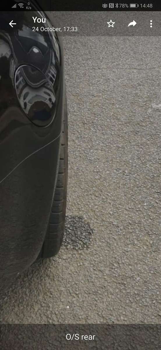

TobeZ350 Posted October 27, 2019 Share Posted October 27, 2019 Hi Iv fitted 50s to the rear on my 350z and the nearside hangs out of the arch more than the offside, never seen this before. I have had it all checked out and there's nothing bent or buckled and it sits square and runs fine but its not right. The offset of the wheels are the same and I just can't get my head round the problem, has anyone had this before? I have since taken them off and put 30mm on and its not as noticeable but still not right. Any info would be gratefully appreciated thanks all. Pictures of the problem Quote Link to comment Share on other sites More sharing options...

TobeZ350 Posted October 27, 2019 Author Share Posted October 27, 2019 Yeah it settled a bit but the pictures are a from a few days after, it's very strange. There's no sign of damage in any way but that's not to say something could have moved from previous ownership, to look at nothing is bent and the rim is fine and like I said it's been lasered and tracked up and it sits sound. Coil overs are on and it's ok but I no the problem is there so I'd like to sort it just I think I might cost a bit to find. Quote Link to comment Share on other sites More sharing options...

TobeZ350 Posted October 27, 2019 Author Share Posted October 27, 2019 I haven't but iv put the 35mm on the back and it still sits proud on one side, It looks like someone's drifted into a kerb and it's pushed the wheel in over at the bottom hence being proud at the top but there's no sign of damage at all. Quote Link to comment Share on other sites More sharing options...

ATTAK Z Posted October 27, 2019 Share Posted October 27, 2019 Just a silly thought ... are you sure you haven't got a front wheel on the back ? 1 Quote Link to comment Share on other sites More sharing options...
TobeZ350 Posted October 27, 2019 Author Share Posted October 27, 2019 27 minutes ago, ATTAK Z said: Just a silly thought ... are you sure you haven't got a front wheel on the back ? Il double check that but I believe the geezers at the garage measured them but that's defo worth another look.. Thanks Attak Z Quote Link to comment Share on other sites More sharing options...
Tauvp Posted October 27, 2019 Share Posted October 27, 2019 Are you on stock suspension arms or are they adjustable? Quote Link to comment Share on other sites More sharing options...
TobeZ350 Posted October 27, 2019 Author Share Posted October 27, 2019 4 minutes ago, Tauvp said: Are you on stock suspension arms or are they adjustable? Stock and I have read about adjustable arms.. That was the route I was heading if I can't find anything bent after a more thorough inspection. They should adjust the cambre yeah and pull the top back into place? Quote Link to comment Share on other sites More sharing options...
Umster Posted October 27, 2019 Share Posted October 27, 2019 1 hour ago, ATTAK Z said: Just a silly thought ... are you sure you haven't got a front wheel on the back ? Definitely got to consider this - sounds plausible If you've had it checked and its sat flush/no vibrations etc. then go get it aligned at a specialist? Quote Link to comment Share on other sites More sharing options...
TobeZ350 Posted October 27, 2019 Author Share Posted October 27, 2019 33 minutes ago, Umster said: Definitely got to consider this - sounds plausible If you've had it checked and its sat flush/no vibrations etc. then go get it aligned at a specialist? I'm picking it up tomorrow from the garage tomorrow after having the coil overs fitted so il throw all these ideas at them cheers Quote Link to comment Share on other sites More sharing options...
ATTAK Z Posted October 27, 2019 Share Posted October 27, 2019 Don't know if you're aware - there's a lug on the front hubs to prevent the rear wheels being fitted on the front, but of course that doesn't prevent vice versa. Maybe a rear wheel was damaged and someone put a front wheel they had kicking around on the rear to save money before you got the car ??? Quote Link to comment Share on other sites More sharing options...
TobeZ350 Posted October 28, 2019 Author Share Posted October 28, 2019 7 hours ago, ATTAK Z said: Don't know if you're aware - there's a lug on the front hubs to prevent the rear wheels being fitted on the front, but of course that doesn't prevent vice versa. Maybe a rear wheel was damaged and someone put a front wheel they had kicking around on the rear to save money before you got the car ??? Yeah that could easily of happened I guess, il check today make sure thanks Quote Link to comment Share on other sites More sharing options...

TobeZ350 Posted October 28, 2019 Author Share Posted October 28, 2019 the car has had all suspension dropped and checked.. Been advised to get a full N/S suspension arm hub and bushes ( everything) rather than fault finding what's bent. Is there breakers on here that may have such parts for me to source.. Nightmare Quote Link to comment Share on other sites More sharing options...

ATTAK Z Posted October 28, 2019 Share Posted October 28, 2019 24 minutes ago, TobeZ350 said: the car has had all suspension dropped and checked.. Been advised to get a full N/S suspension arm hub and bushes ( everything) rather than fault finding what's bent. Is there breakers on here that may have such parts for me to source.. Nightmare Time to 1 Quote Link to comment Share on other sites More sharing options...
